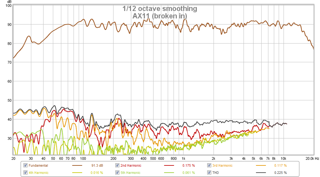

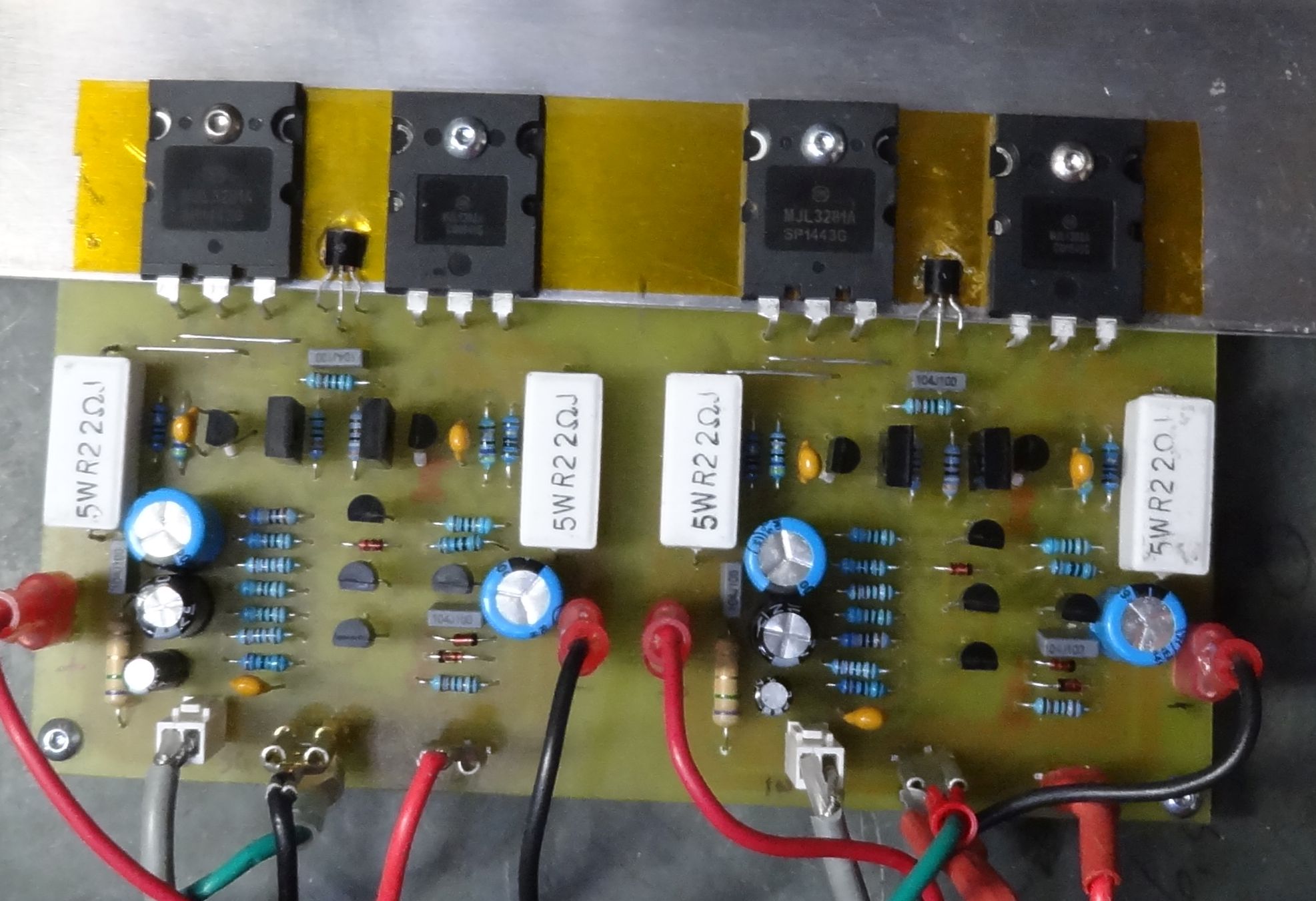

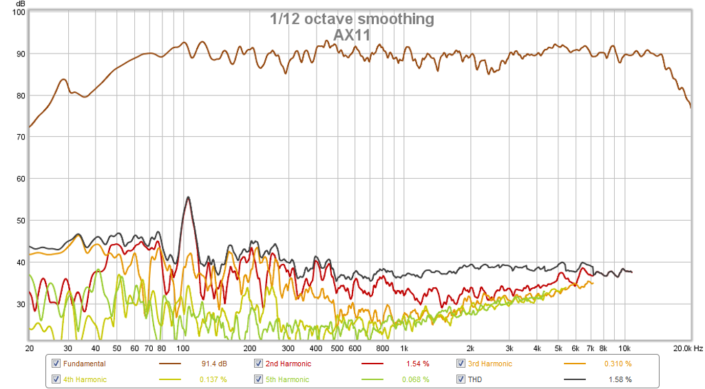

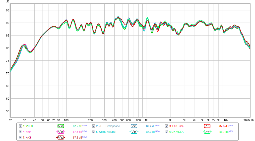

I pulled the two output transistors off from the 1st amp that is not working and installed it on the second amp. This one is built as designed - no LED's and all resistor values are as shown on silkscreen including 47R for the VAS transistors. Fired it up and adjusted bias to 100mA. It is playing now but I would say it does not sound clean. Like very audible distortion. So I took a frequency response measurement with my speaker using same setup used in this thread and there is a sharp 1.54% H2 distortion peak at 104Hz when everything else is typically 0.2% to 0.4%.
But at least that terrible scratchy popping is gone. So I just need to go through and replace all the actives on the first amp and go back to stock resistor values.
Here is measured distortion from speaker:
In comparison to other amps:
DC offset is good at -3mV.
Edit: maybe there is something to burn-in or breaking in, after playing for good 30 minutes, the 104Hz H2 peak is gone now...
