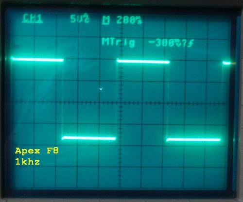

+/-50mV offset fluctuacions is ok without DC servo... can you post scope measurements?

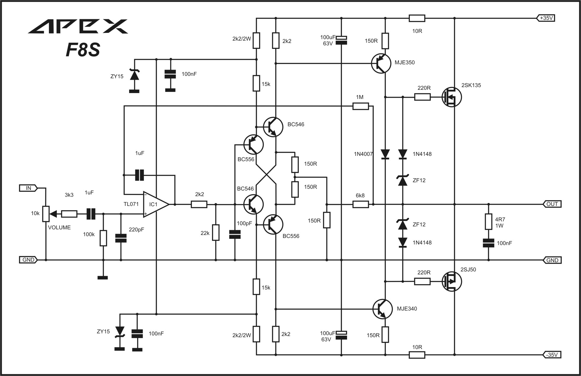

Hi Mr Miles is there any chance to be able to drive ALF16N16W/ALF16P16W (double die lateral mosfet) through FX8? The deal is to drive 4 ohms speakers with +/-35Vdc rail

Yes you can drive 4 ohms speakers with +/-35V rail.

Just to be clear : with using ALF16 (double die latmosfet) instead SK1058/SJ162?

Yes ALF16 is SK1058/SJ162 pair in same case.

No, Mile, ALF16 are double dye, but same polarity, there are ALF 16N and ALF 16P. You can choose TO264 or TO3, 160V or 200V.
16 is the number of Amperes.
I made my FX8 with ALF08NP, both N and P type in same case, but they are rated at 8 Amperes.
Yes a i missed that ALF16 are double die = 2 same transistor type in one package...so i would be same situation as 2 output paires instead one

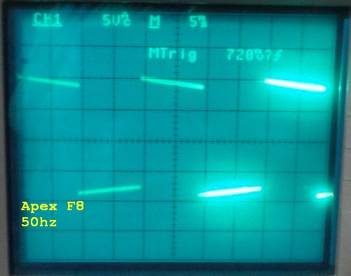

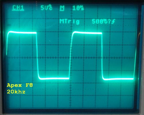

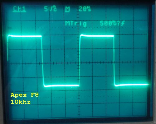

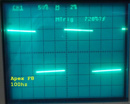

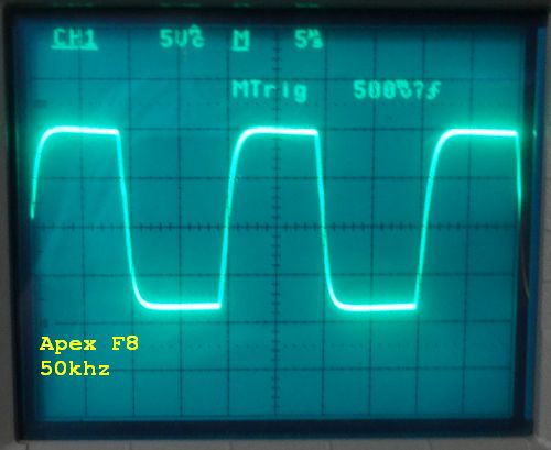

Regards
I converted the second channel. I have taken some scope shots and am posting them below. I also played about 12 songs through it. It really sounds quite lovely. Whoever complains about the bass from lateral MOSFETs needs better speakers. This amp goes deep and the bass is tight. Really, really nice sounding amp.
I also monitored the offset more closely and it is actually quite acceptable.
Still4given, is this the conversion that you did to the second channel?
I pulled the trimmer and installed two 150R SMD resistors in its place. Then I pulled R5 and replaced it with a 25k trimmer.
