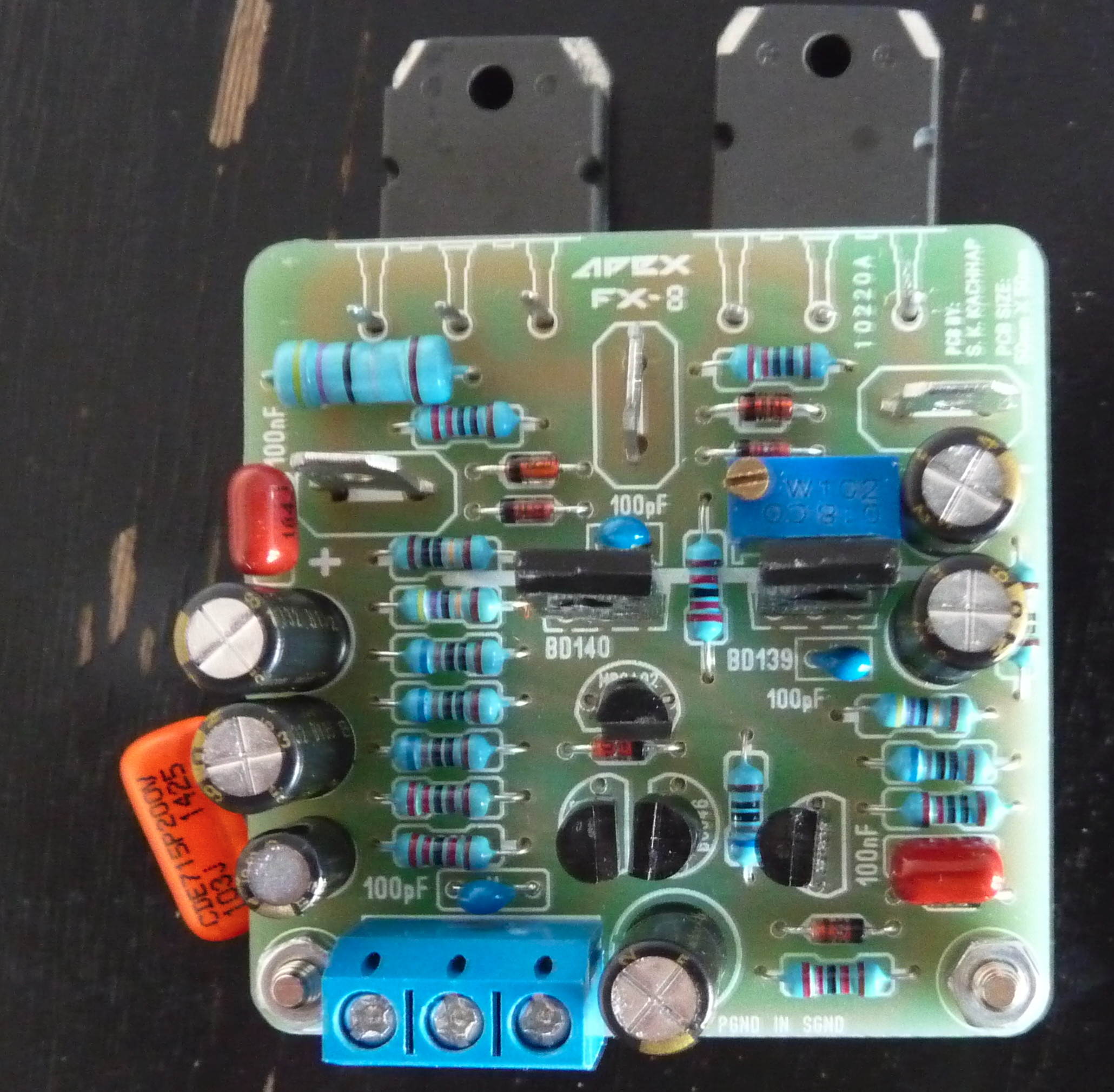

Pic of my board
Look like you put BC546 instead MPSA92

indeed, I put a A92 instead a MPSA92....
Higher gain, and higer voltage saturation
Ok hope I have MPSA92 in stock
many thanks for this comment
A92 is same as MPSA92. Just double check pins if using 5401.
