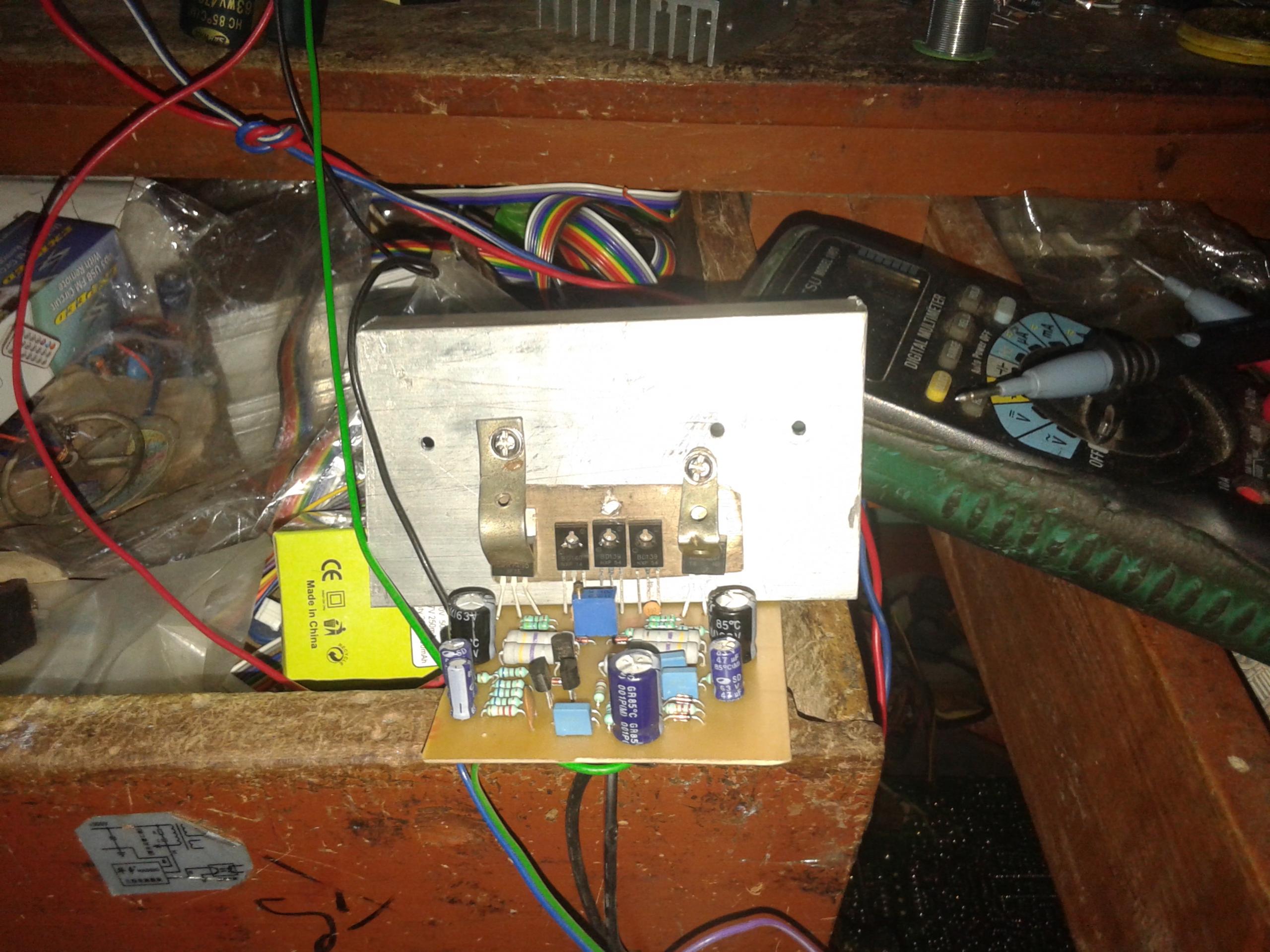

I just built this simple little preamp (first desribed in this thread). It works really well - clean sound and just the right amount of gain for my Pass M2 class A amp that has only 14dB gain.
Schematic (as shown is about 10dB gain):
Note that I am using 100R vs 82R for the output stage and 100pF vs 82pF caps. I also added 100uF smoothing caps on PS rails (25v).
Here is the amp on veroboard (one channel only):
Here is measured response and HD at the speaker (mic measurement) vs a commercial preamp (cursor at 1000Hz):
Apex preamp:
Midiman 18 channel micromixer console as preamp:
Note that I witnessed burn-in again as initial measurements were a dissappointment in HD:
So my takeaway is to let an amp run for a while to work out it's magic (maybe something with the caps?).
I agree. It's a gem - like many of Apex designs. With a PCB it would go very fast. As veroboard took some time to figure out how to get things to fit. I am using straight input via 680R vs a 100k input volume pot.
I think Vargasmongo had a PCB. Maybe he can share the Sprint file or Gerber with us? It would be good to get a really compact version sans power supply.

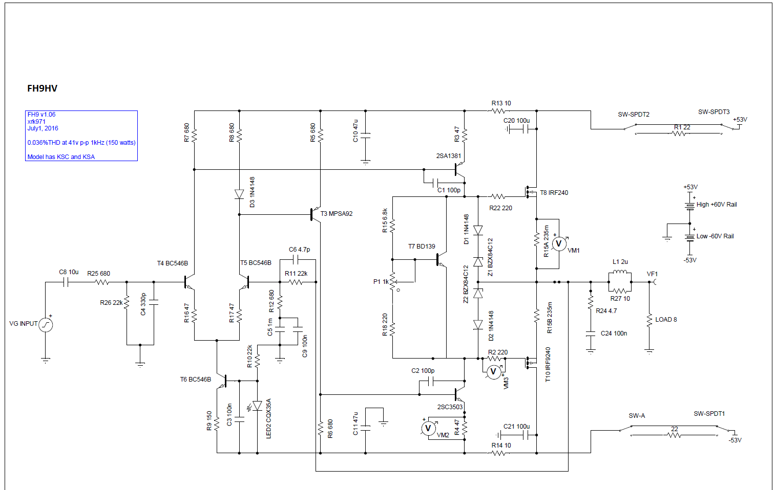

FH9HV Schematic and PCB files
X, please, add the schematic used
It's in the Apex Directory thread. But that one is the standard version with BD139/140 drivers.
http://www.diyaudio.com/forums/solid-state/292226-directory-apex-audio-amplifiers.html
Here is updated schematic with KSC/KSA drivers (note that this is a slightly later version with LED on CCS for LTP - as used on FH11/12 so that is proven to work. Without it works fine too - just no visual indicator it's powered up):
Gerbers and layout here:
http://www.diyaudio.com/forums/soli...imate-fidelity-amplifier-746.html#post4718422
Just replace BD139/140 drivers with KSA/KSC parts and make sure all elco's can handle higher rail voltages.
