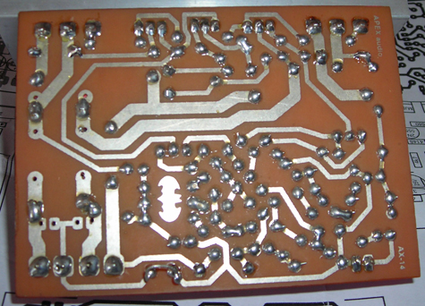

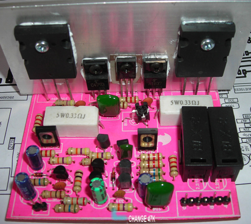

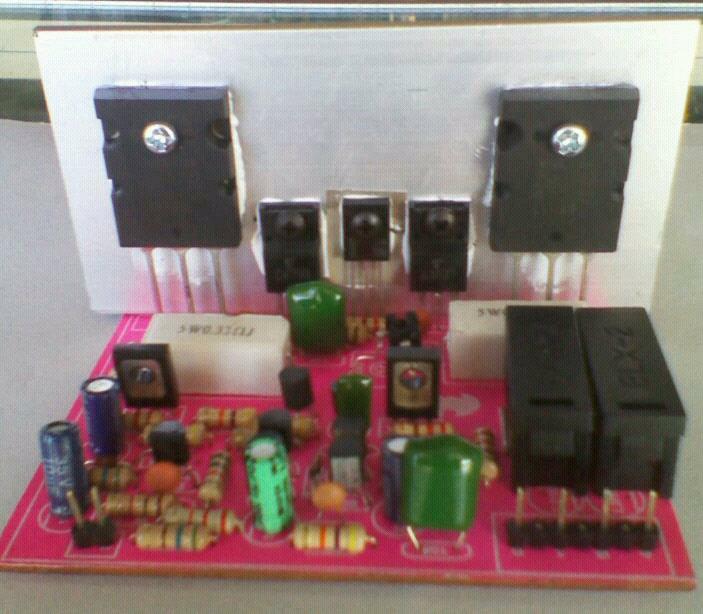

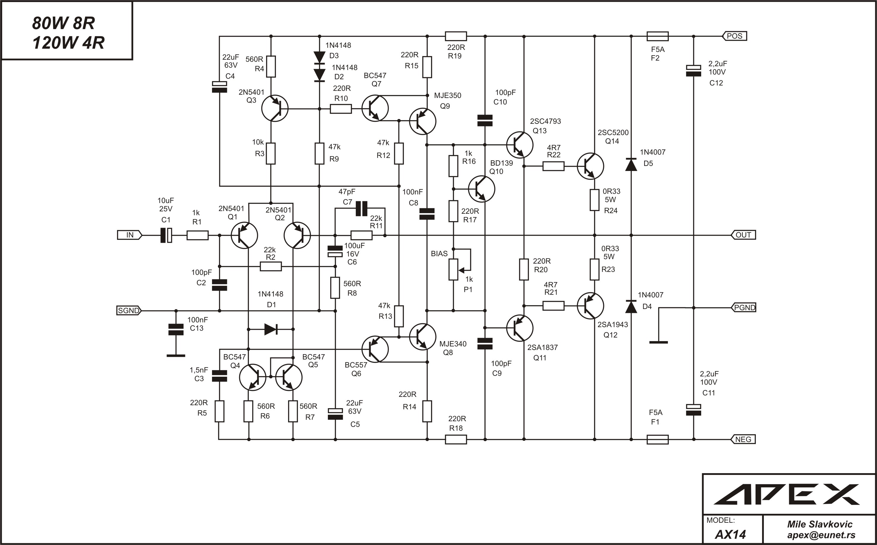

got a question: if i parallel lets say 3 pairs of outputs on this ax-14, do i need to put 1n4007 diodes on collector-emitter of the other pairs? and 4.7k resistor connected to emitter of driver and base of outputs also of the other pair?? any idea?
IN4007 near final transistor must be removed...
im a bit confused, because if you look at the parts layout on pcb, the diode is placed before the .33 ohm resistor. thats why im thinking if i will be putting another diode to another output pair. by the way what is the job of the 2 1n4007 diode there?
can you post some pics of your ax-14 project with 2 or more outputs.
