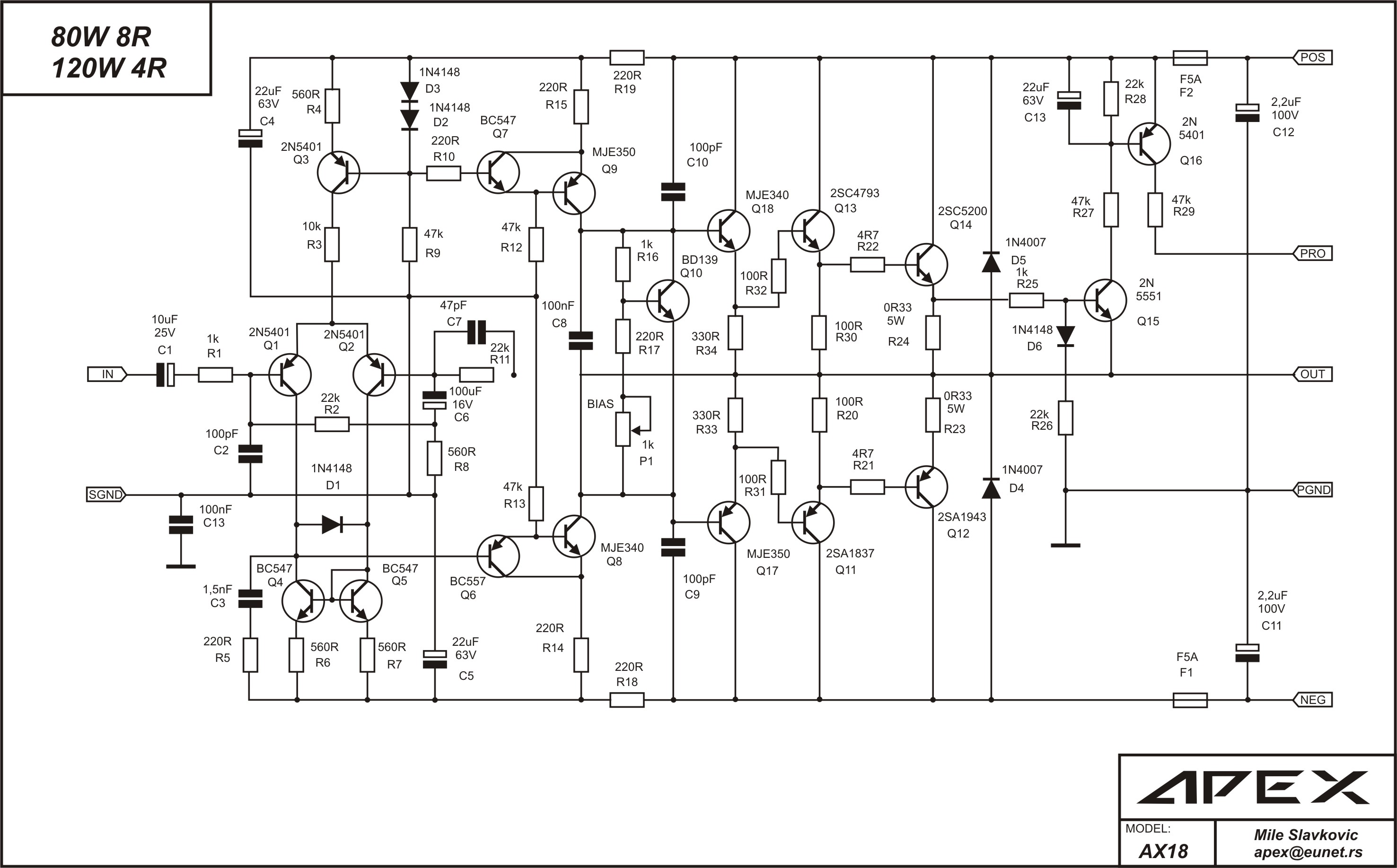

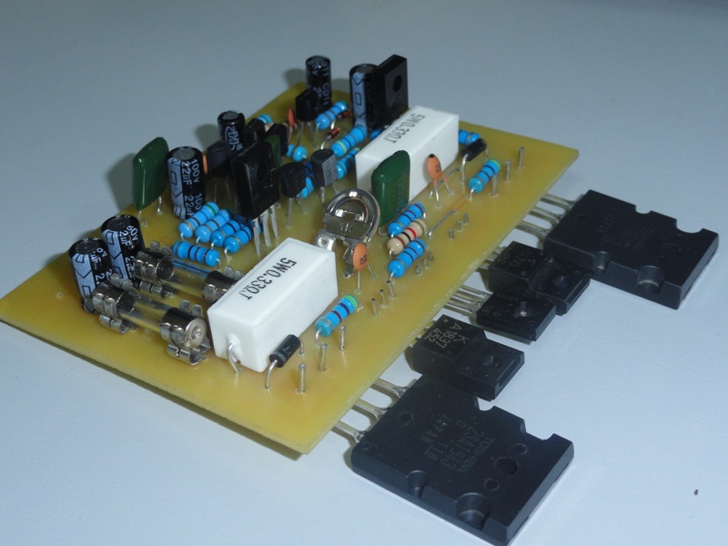

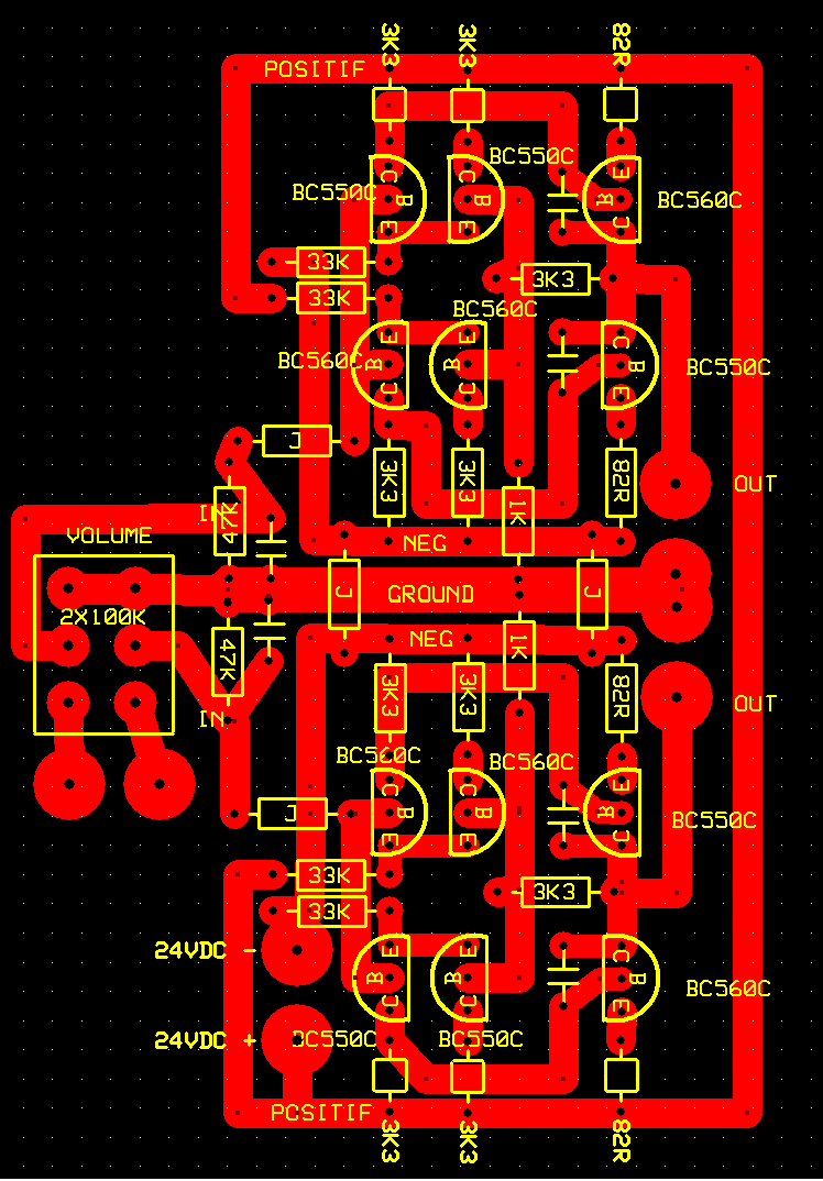

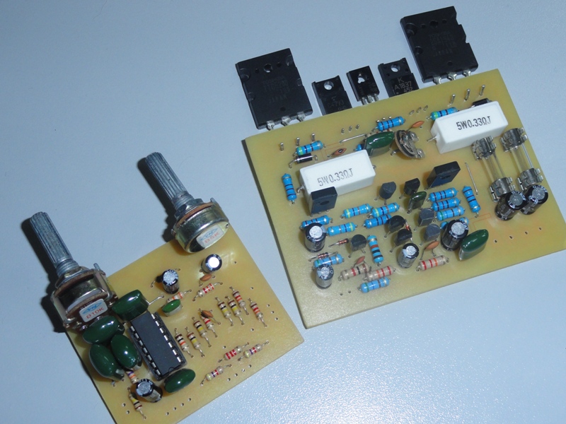

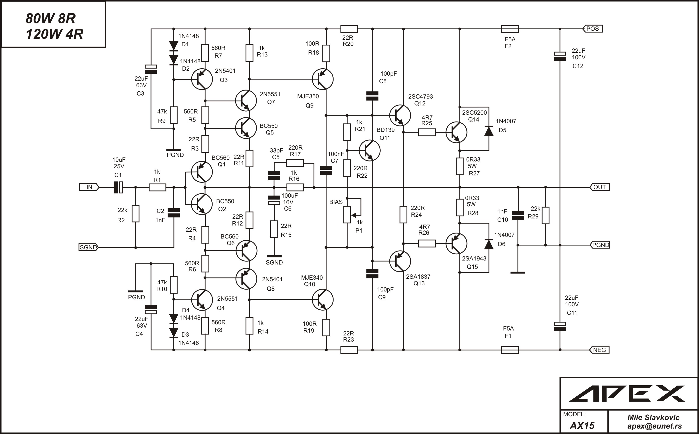

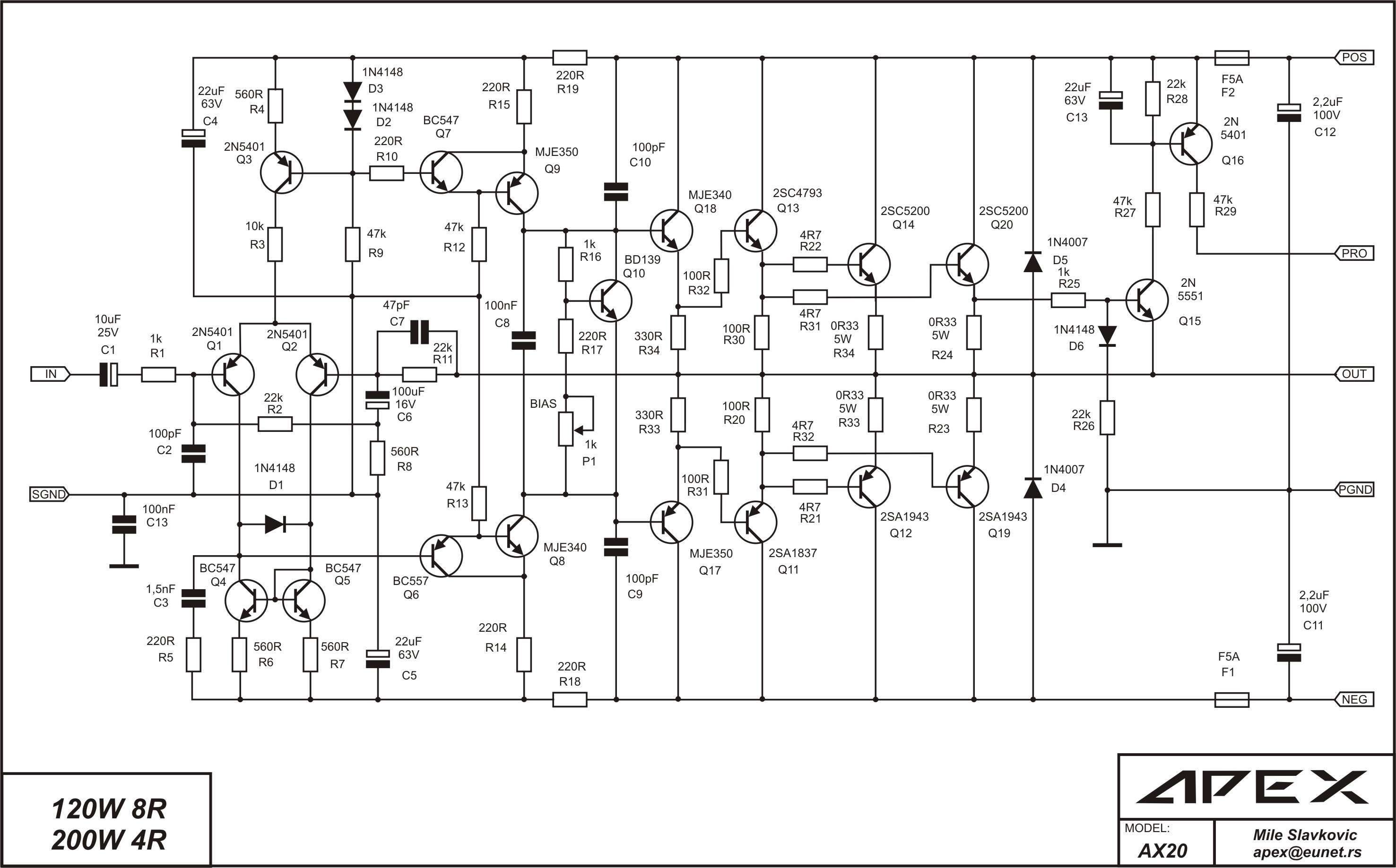

Hi Sir Mile heres my ax-14 and sub controller. ready for testing...

Emitter Follower outputs require a voltage bias rather than a current bias to maintain the minimum of crossover distortion.
The Emitter resistor is the place to measure the bias voltage.
Most recommend between 15mV and 25mV across this resistor for optimum ClassAB output bias.
The actual current then depends on the value of Re that is fitted.
eg. a 0r1 for Emitter Resistor with 15mVre of bias would pass 150mA of output bias current for each output pair. With a 25mVre bias voltage the current would be 250mA/pr.
If Re=0r47 then the range of bias current would be 32mA to 53mA
But, first you must identify the Vre for optimum distortion performance.
