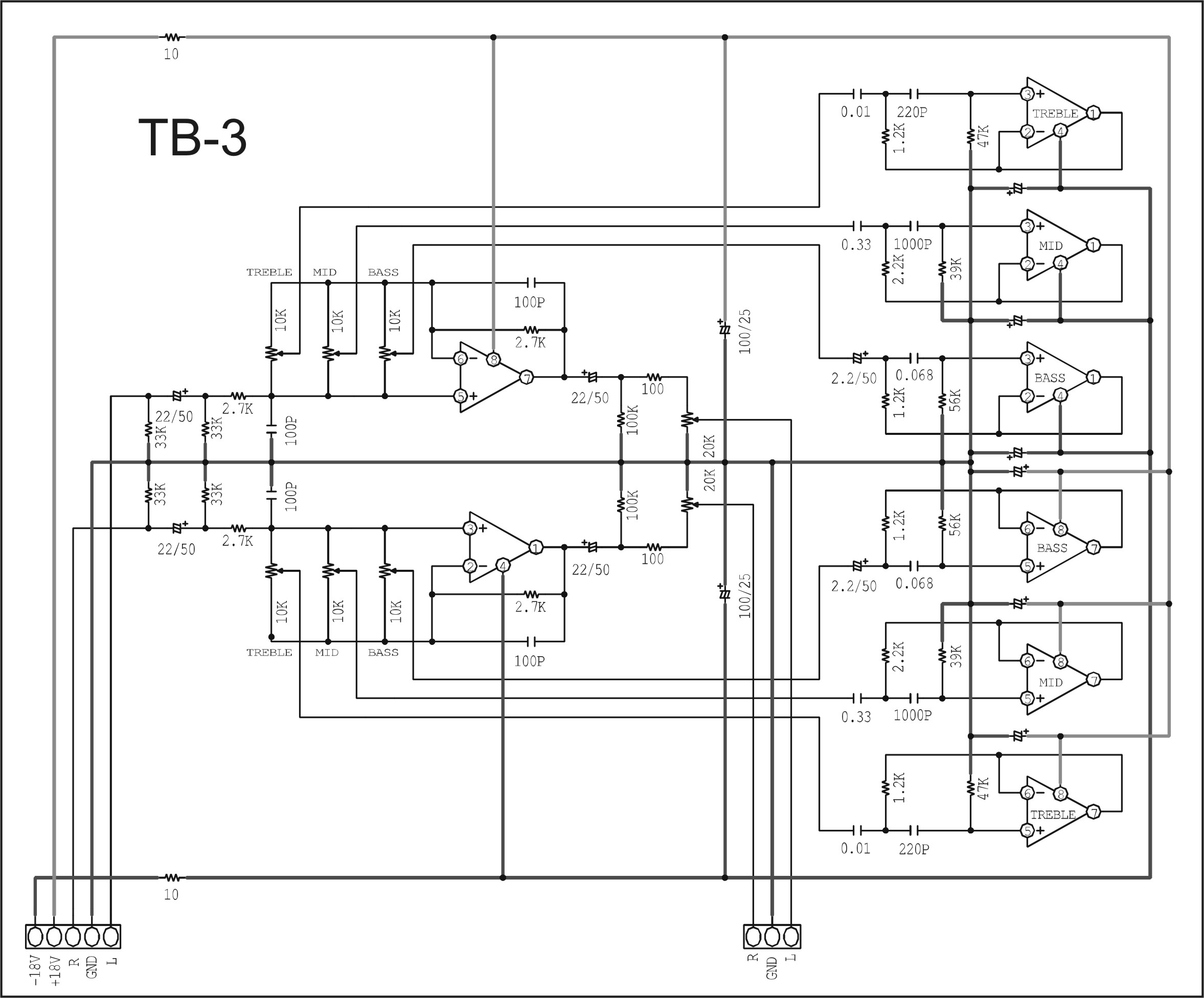

Mile, is there a schematic for the TB3?

TB3 Schematic

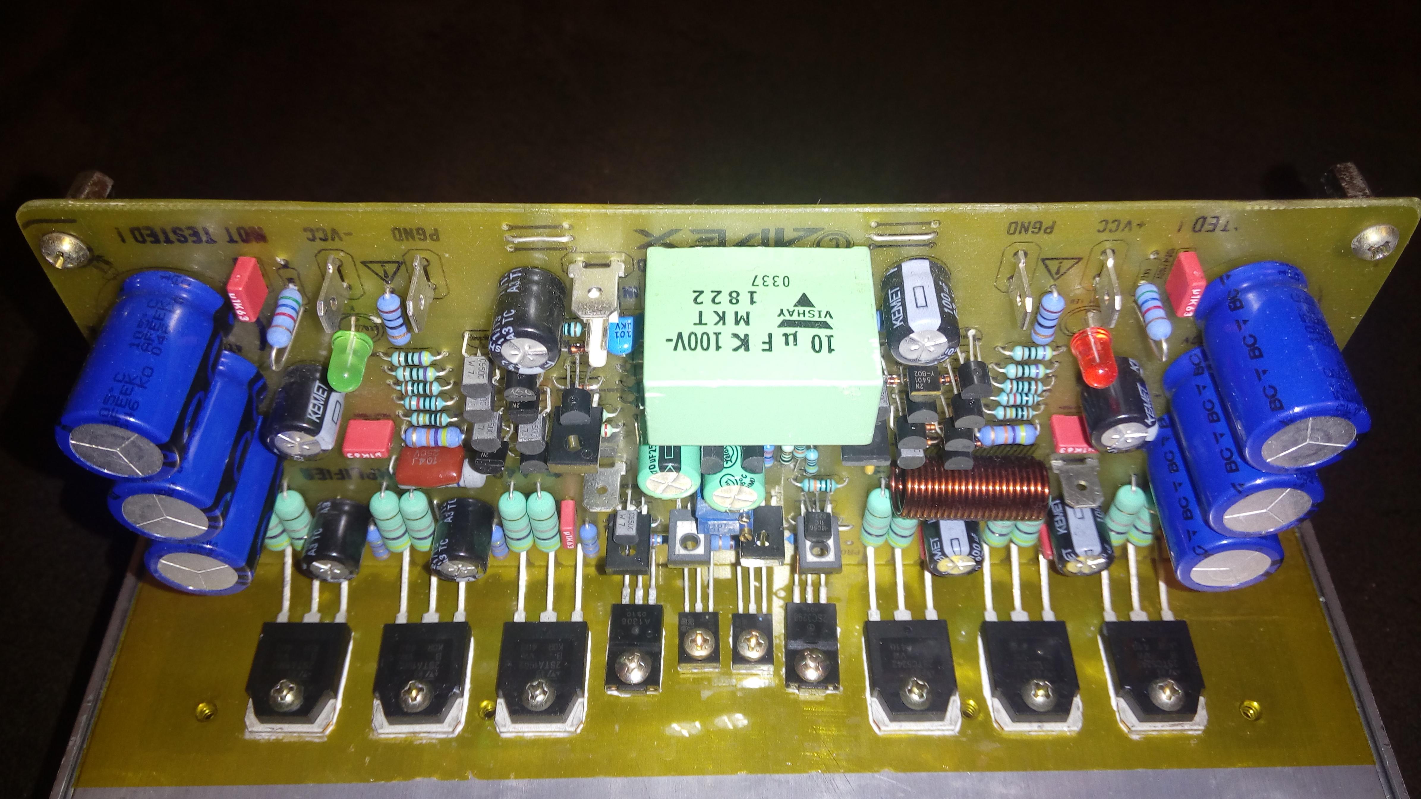

this is a stereo apex ax-14P that I've made recently.
It has very clear sound.
I've made very amp heretofore, but this one is one of the greatest amp that I've ever made.
but when amp clipping occurs, the relay goes to Continuous off/on that destroys the sound.
Best Regards.
Nice work, what is rail voltage and what is voltage on relay coil?

Hi.
PCB was Ok.
the cause of the problem was transformer voltage drop. I fixed it by replacing transformer with another one. Now everything is Ok.
