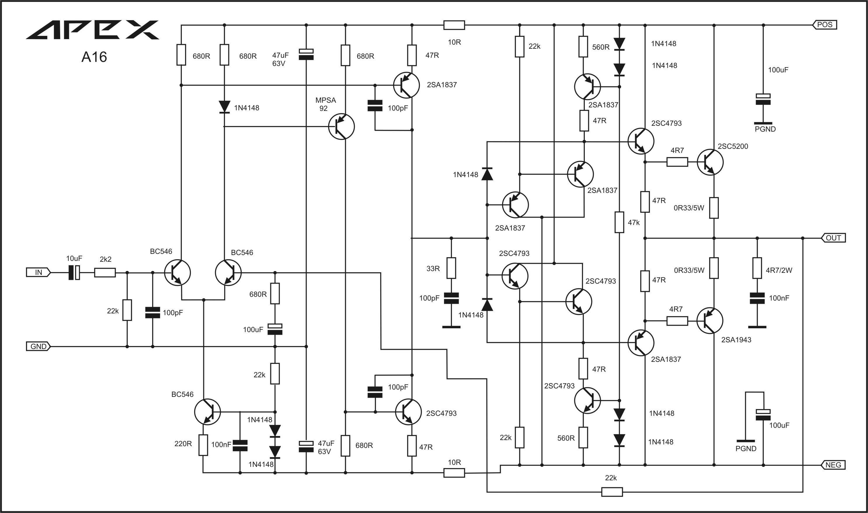

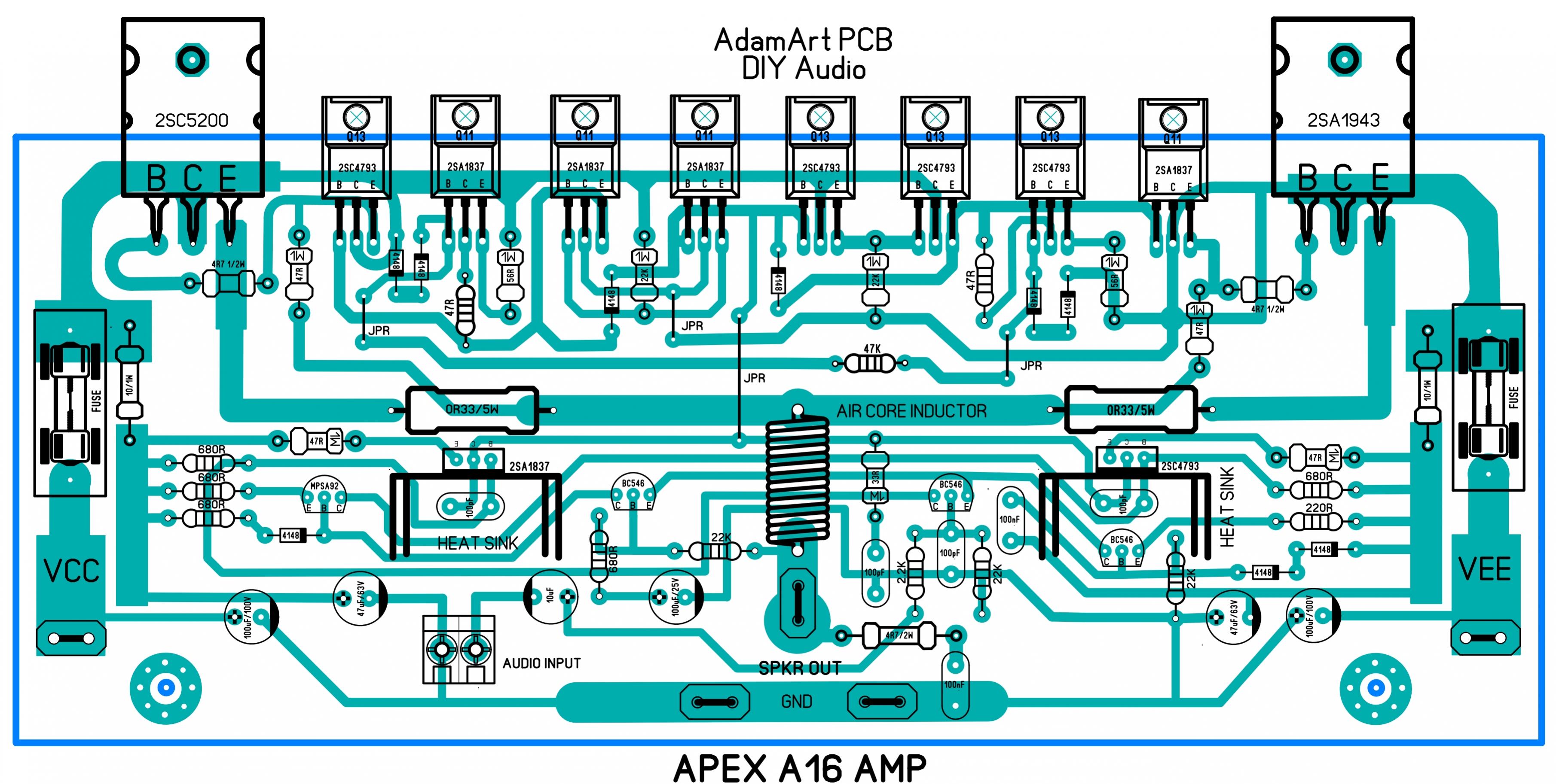

hi sir apex here is your A16 amp i try to layout PCB sorry for possible error correct me if i am wrong I'm still learning![]()
Nice work but all 2SA and 2SC transistors must be on main heatsink... this is schematic with correct 56R instead 560R.
Regards
Hi Miles, could you advice about what transistor must be on heatsink please?
Marc
Yelow on heatsink and Red on main heatsink.
Regards

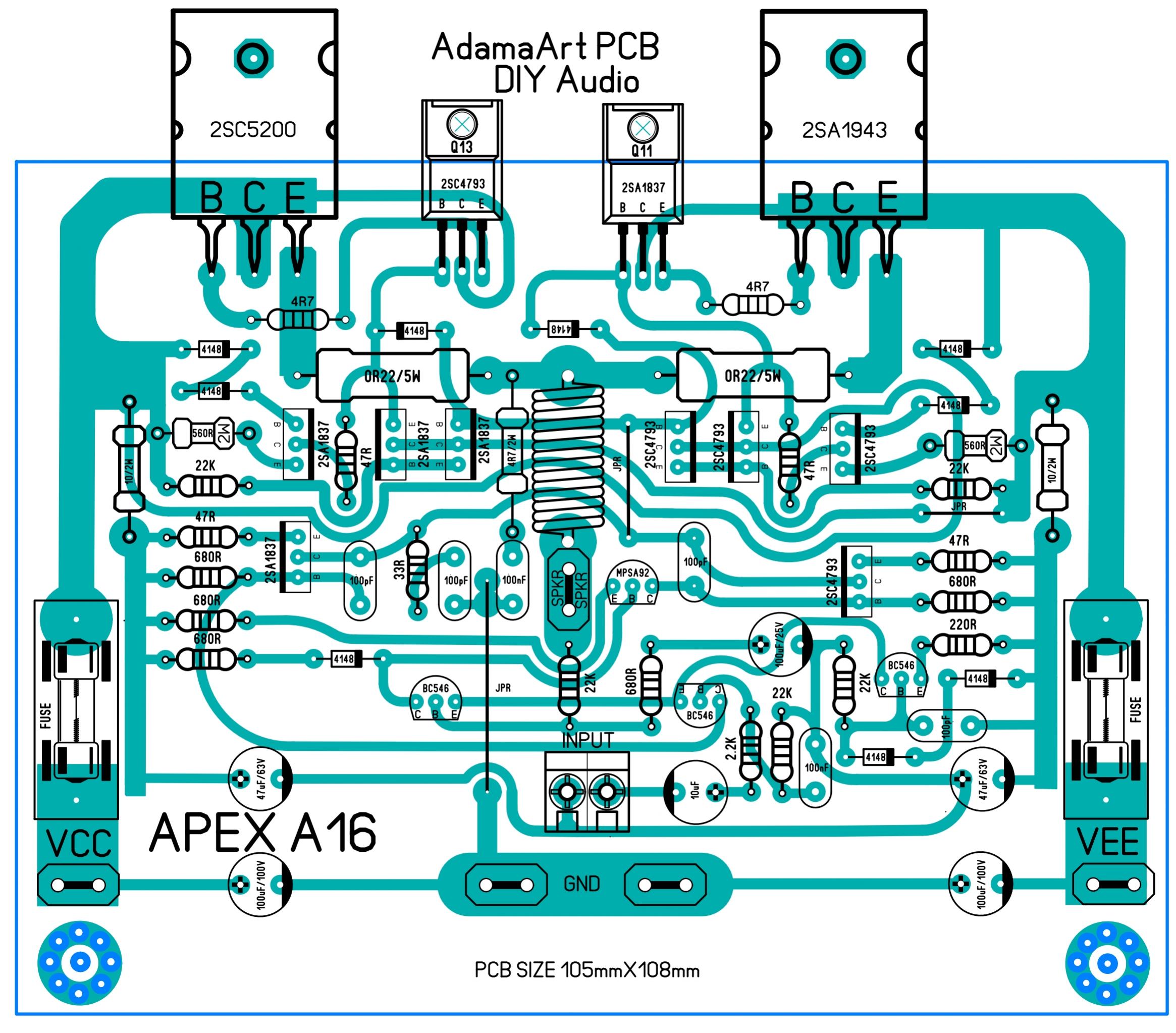

hello sir apex may be like this layout? all 2SA 2SC transistor mounted in heat sink except those 2 separated from main heat sink hope no error.. I'm still learning electronics
Nice pcb, LTP BC546 can be thermaly coupled, what is pcb size?
Regards
