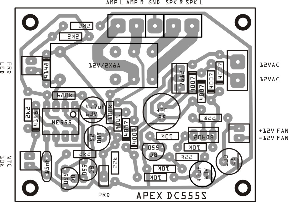

Stereo Protect PCB

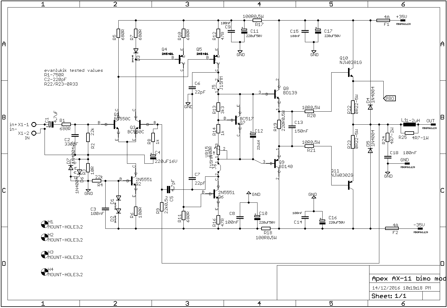

Mr. Miles, will i be ok to use +/-48V PSU on AX-11 bimo mod with Sanken o/p devices. what other transistor needs to be changed?
http://www.diyaudio.com/forums/soli...imate-fidelity-amplifier-828.html#post4794009 .
sch attached. can i simply replace Q1/Q3 and Q7 with higher voltage capable transistor like 2N5551 with legs bent/ reversed ?
i will never use this amp at full power. are there any other components that need upgrade other than voltage capacity like resistor values and wattage, etc..
i have a 35-0-35vac trafo. and that is the only transformer i have available right now:eek:.
reg
Prasi
Replace 47R resistors with 100R no need to made any other changes.

The two input transistors and the two drivers are both rated correctly for ±35Vdc
But both will be overloaded when changed to ±50Vdc.

Please change:
Q5 = 2SA1381
Q6 = 2SC3503
Q8 = 2SC5171/2SC4793
Q9 = 2SA1930/2SA1837
Q1 and Q3 = 2SC1845
It may improve it.

Hi Bimo,
Thanks for your suggestion. I am not looking so much for improvement but for replacement components that can sustain the +/-48VDC PSU. Also 1381/3503 and 4793/1837 are not available with me right now. I do have many MJE15032/33 for Q8 and Q9. can I use those?
ofcourse even with sanken 2SA1216 /2SC3264, I wont drive it to clipping level. its just for small home HT set-up.

Here is what i would like to do.
1. Q1/Q3 2N5551 with orientation opposite to silk, as it is handy at the moment.
2. Q5/Q6 (EBC)- I may have KSA1381 and KSC3503. will try and see. or as Mr. Mile suggested use 100R or even 150R for R12/16.
3. Q8 and Q9- MJE 15030/31 orientation opposite to silk.
I want to use small to-220 PCB mount heat sink for drivers (MJE15030-31). will it be sufficient? this will help in avoiding leg twisting due to differences in pin between BD139/140 and MJE15030/31.
i want to use whatever is available right now rather than order new components for a quick build.
