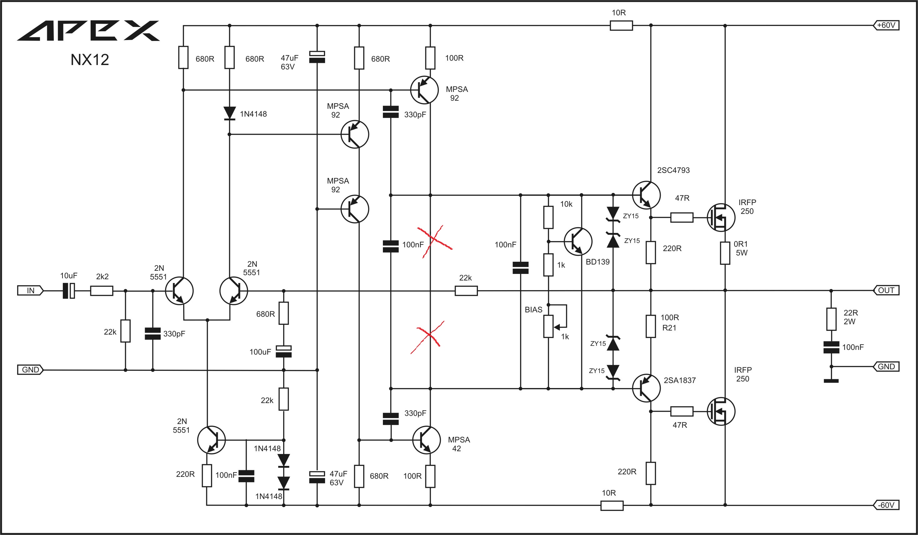

Miles, there is error in schematic could you post corrected one.
Here it is.

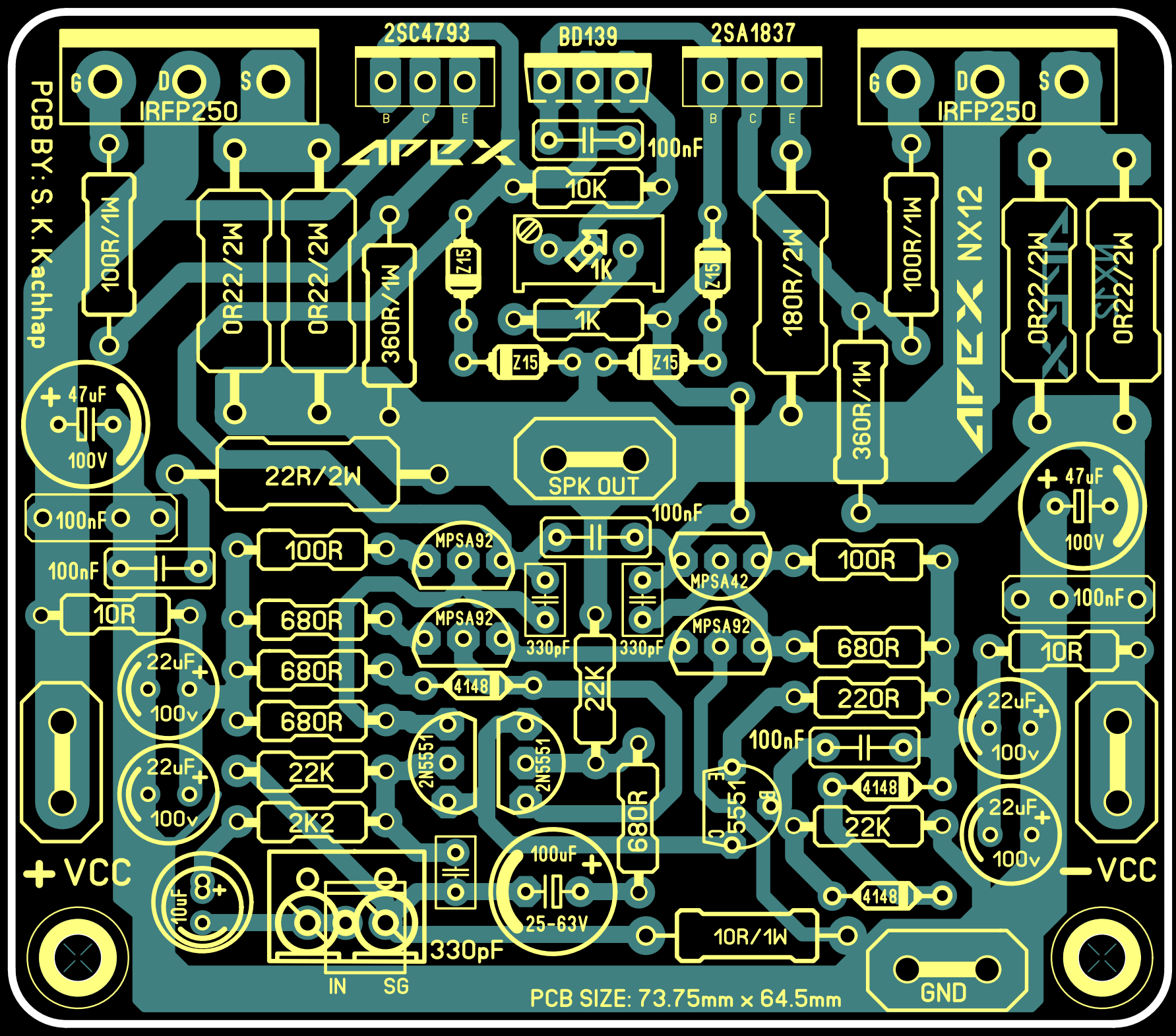

+- 60V for nx12??
Yes

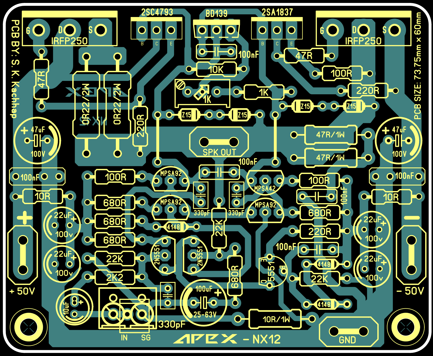

Layout for NX12.
very nice , hats off!
Layout for NX12.

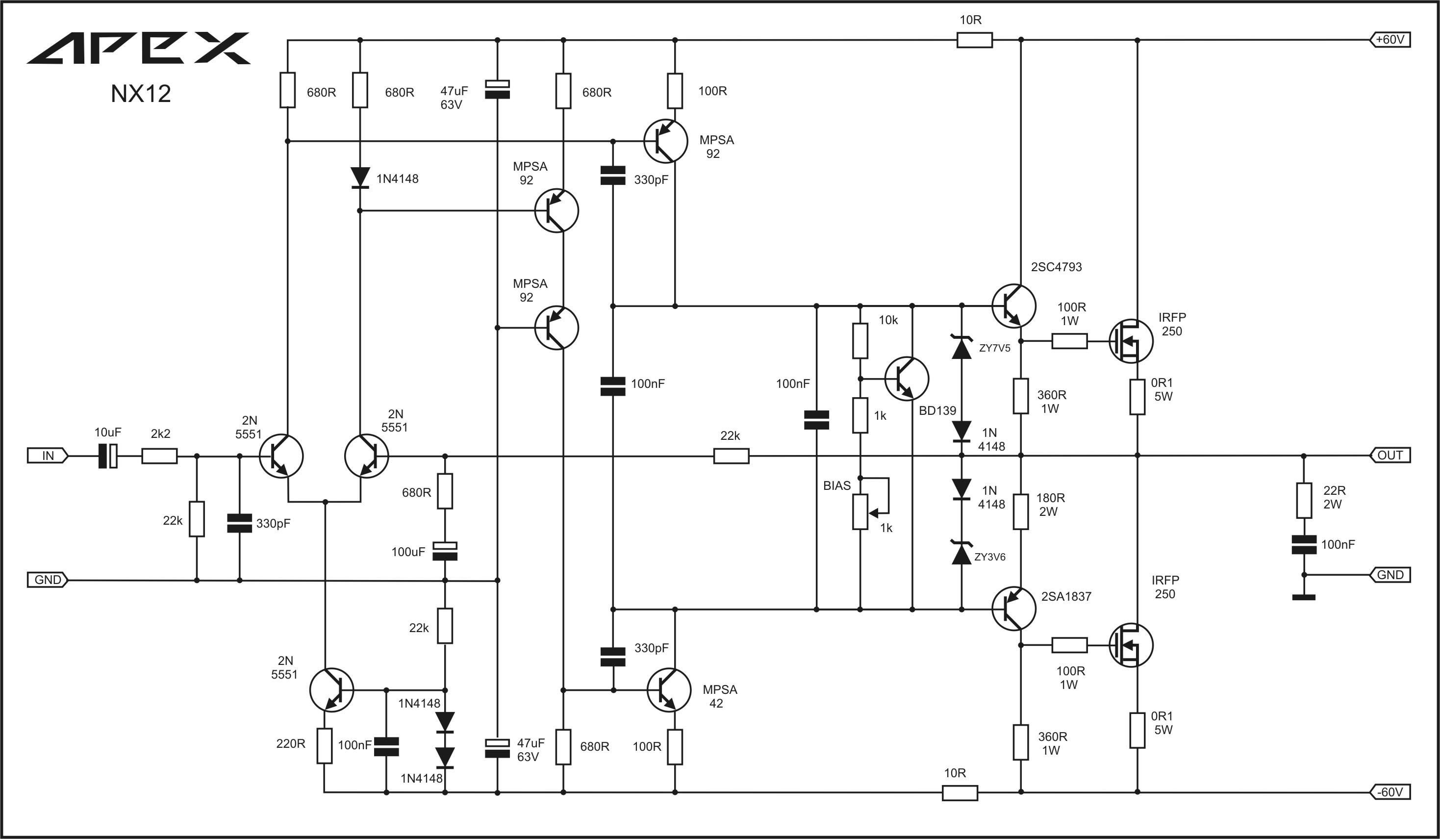

Nice pcb but use final schematic from post #9731
Regards

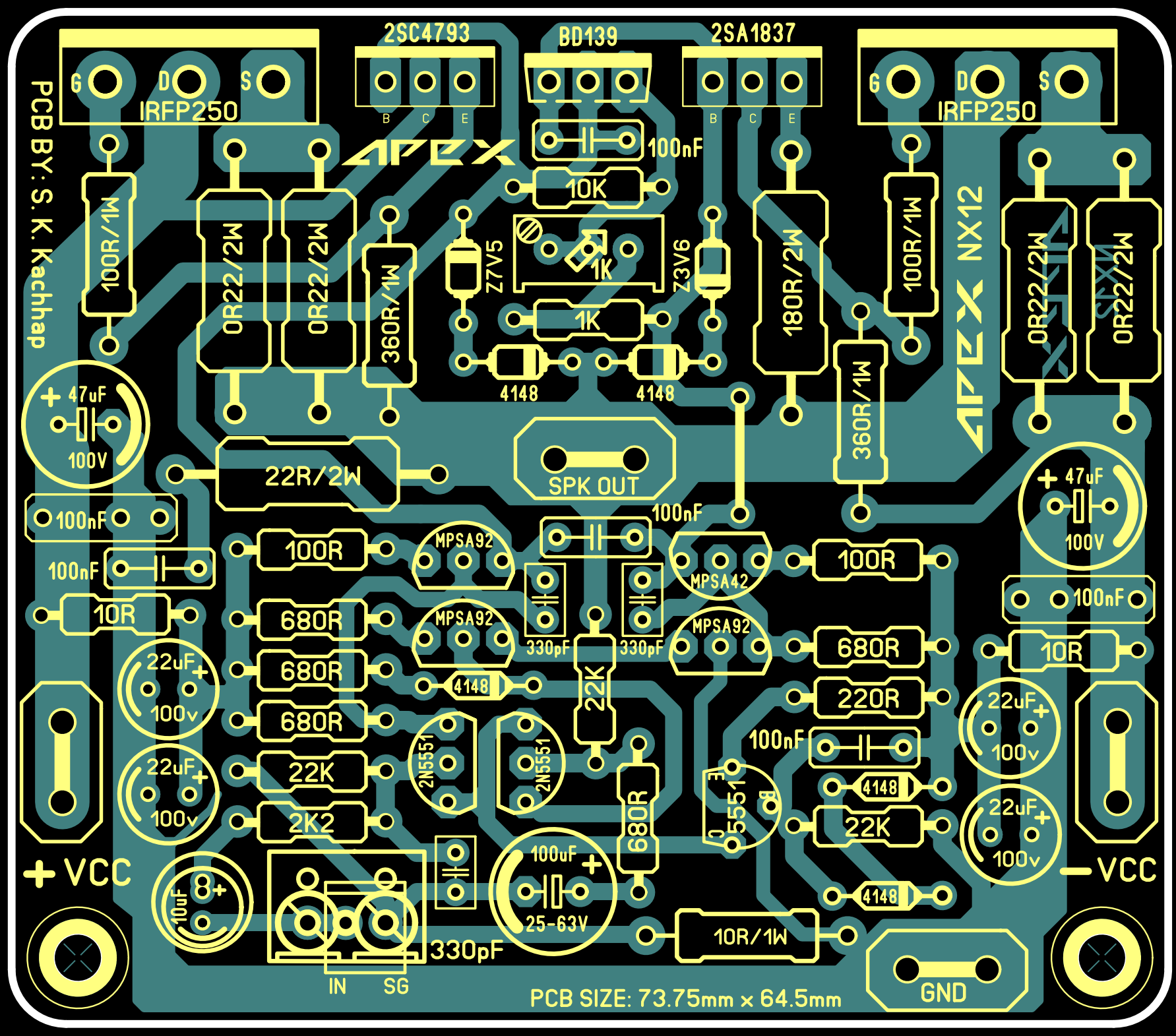

Revised NX12 layout using final schematic from post #9731.
P.S. I deleted last post because of error in layout.
Replace 15V zeners with 1N4148 and 3,6V 7,5V zeners...
