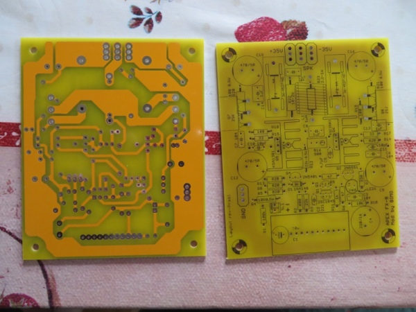

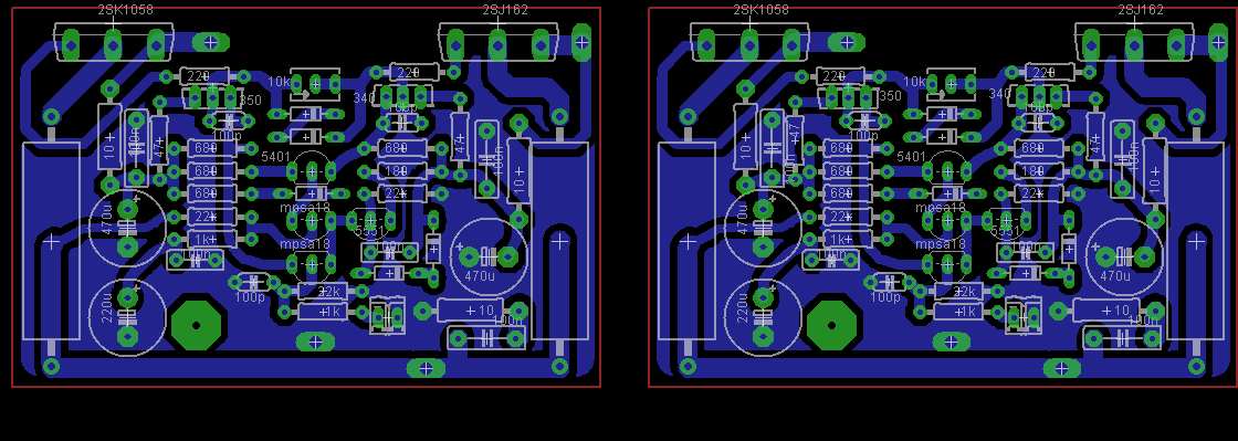

I build and tested fx8..I use 2sk1058 & 2sj162 lateral mosfets..no need thermal comp.
I m used 2x 1n4148 for bias current.(you can add 5-10k trimpot if you want).about 130ma each channel..bd139-140 for driver..mpsa18 for IPS.
Sound is nice..stable for any frequance.
http://www.diyaudio.com/forums/atta...5627-100w-ultimate-fidelity-amplifier-fx8-png
hi caglarm . nice board design , please post the schematic file .sch

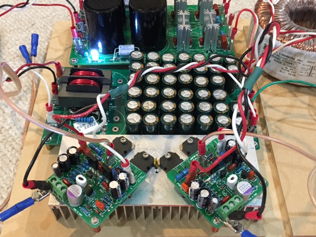

That's the FX8 Bimo mod - very nice. I just connected my FX8 Sonal 50mm x 50mm edition last night. PSU is the Project16/Prasi CRC board followed by a low ESR 20x1000uF cap array. Replaced the ceramic input cap with a 10uF 35v Elna Silmic II. Listening to it all day now. Very sweet sound. Surprisingly powerful for such a tiny amp.
