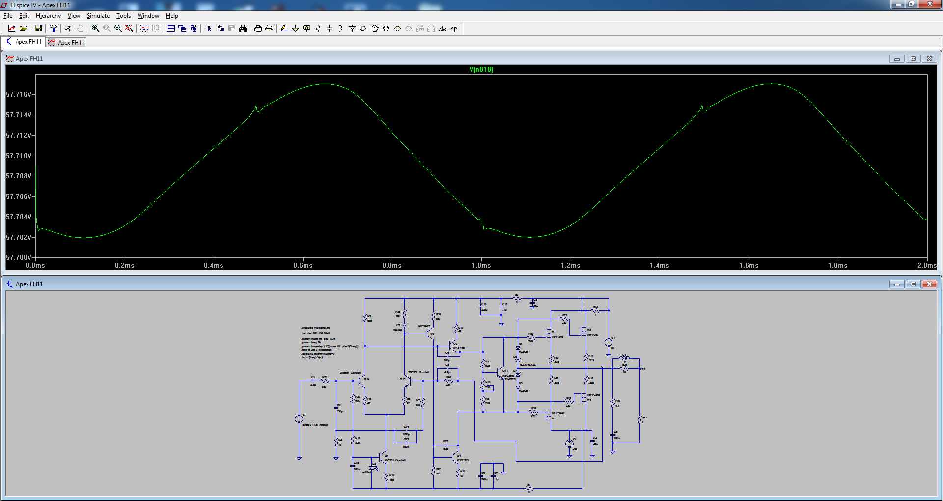

It was set at 10mV over the gate resistors![]()
OK, that would mean around 40mA on each resistor. Fine. I had overbiased it to 59mA.
Anyway, I'm getting this glitch on the sinusoid using 1KHz. This is not the first time I see glitches on the LTP out, and it usually gets right after the VAS.
I can send the asc file for you to check if I'm doing something wrong.

mosFET output stage do not have the equivalent to BJT optimal ClassAB bias.OK, that would mean around 40mA on each resistor. Fine. I had overbiased it to 59mA.
MosFETs start with lots of crossover distortion when bias is very low, reducing to some crossover distortion when bias is high and gets to very low crossover distortion when the bias is getting near ClassA. Only at full ClassA do BJT and FET output stages have zero crossover distortion.

BTW, I had another look at the pdf file, and it does spec 148w @ 8 ohms. Which is what I got on my sim when I increased the input level.
For those that know LTSpice: how is it possible that output result when the supply is just +/- 60v?
I ask this because I did get similar results with other amps. Is LTSpice showing fake results?

It is not a 148W/8 ohm maximum, but THD at 148W/8Ohm.
For mosfet model, please use Bob Cordell model with sub-kthreshold in some where in this forum.
For safety reason, I suggest to use +/- 56V PSU.

What does it exactly mean "THD at 148w/8ohm"?
If that output is not possible with the actual amp, which should be clipping with that input level and such a supply, how should it be interpreted? A fantasy output?

a 230:dual 40Vac transformer operating on a UK supply of 240Vac gets a 3pair output stage to ~ 37.3Vac (52.7Vpk or 105.5Vpp)Bimo,
As I said, this is not the first amp I found that shows such results.
This is equivalent to 174Watts into 8ohms, from a PSU+quiescent amp that idles @ ~ +-58.5Vdc
This same amplifier (Leach Lo Tim) managed 49.9Vpk into 4r0, clip free.
With 60Vdc you should be able to get even higher clip free output.

In simulation, I use power supply with zero output impedance or in reality it use regulated power supply.
P = V x V / R, P = power, V = Voltage, R = load impedance
148 = V x V/8
V = 34,4 rms
V peak = 34,4 x 1,414 = 48,6V.
Because it is not using bootstrap at VAS then V peak max for PSU 60VDC is about 52V. Then 48,6V is below clipping.
Of course if you use non regulated PSU, clipping voltage must below 52V. Maybe clipping voltage is around 47V because voltage drop on PSU.

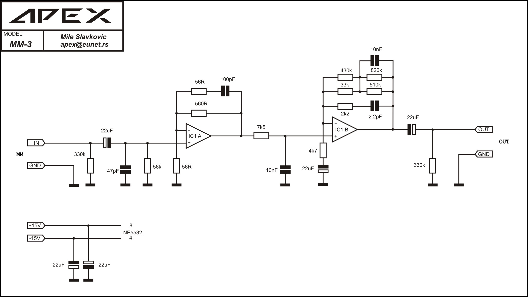

Here you are RIA phono pre by Apex.
Hello.Can you post some phono preamp schematics ?There were some schematics posted by APEX using opamps and discrete but i cant find the posts.
thanks .and any other discrete?

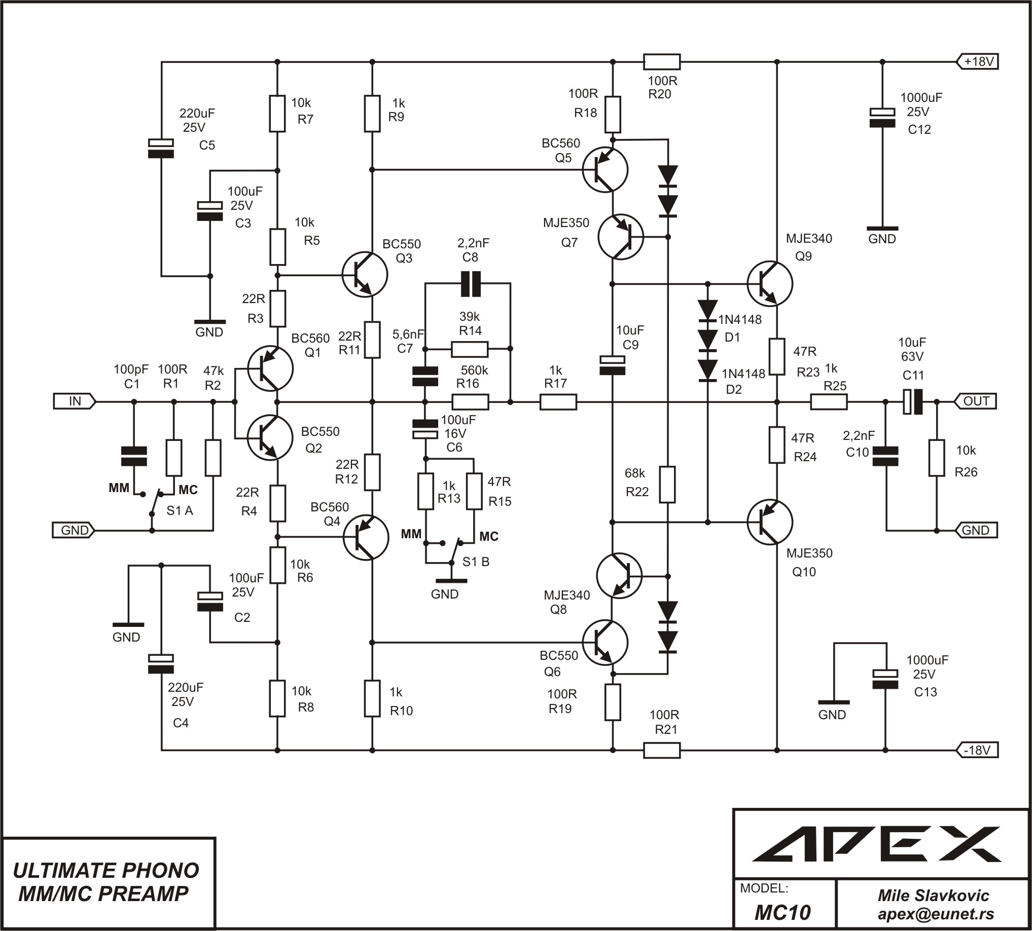

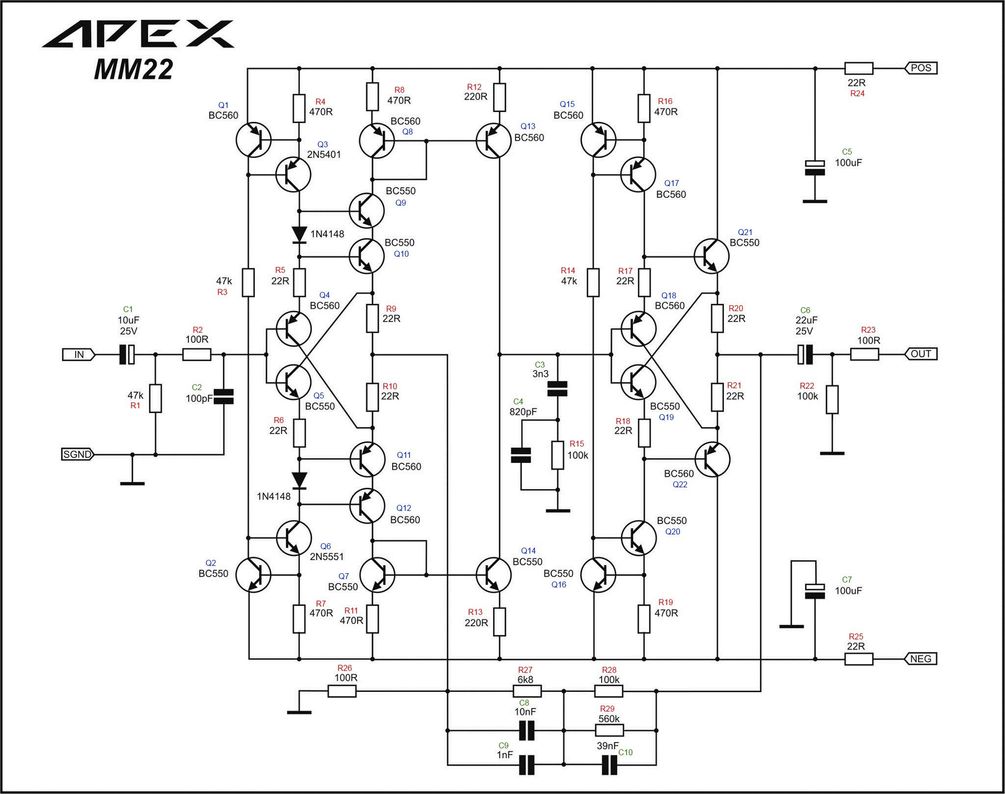

There is MM28, MM22, MM4, MC4, MC10... in this thread

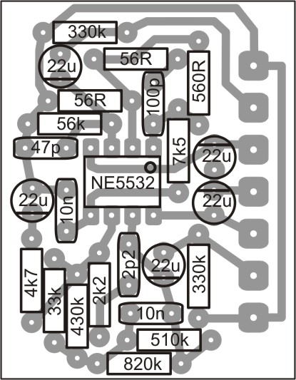

Thank you.I found them all.MM28 and MM22 use many parts.Is there a PCB layout for MC10 and MM4?
Which one do you prefer among all the designs?Which one sounds better?
