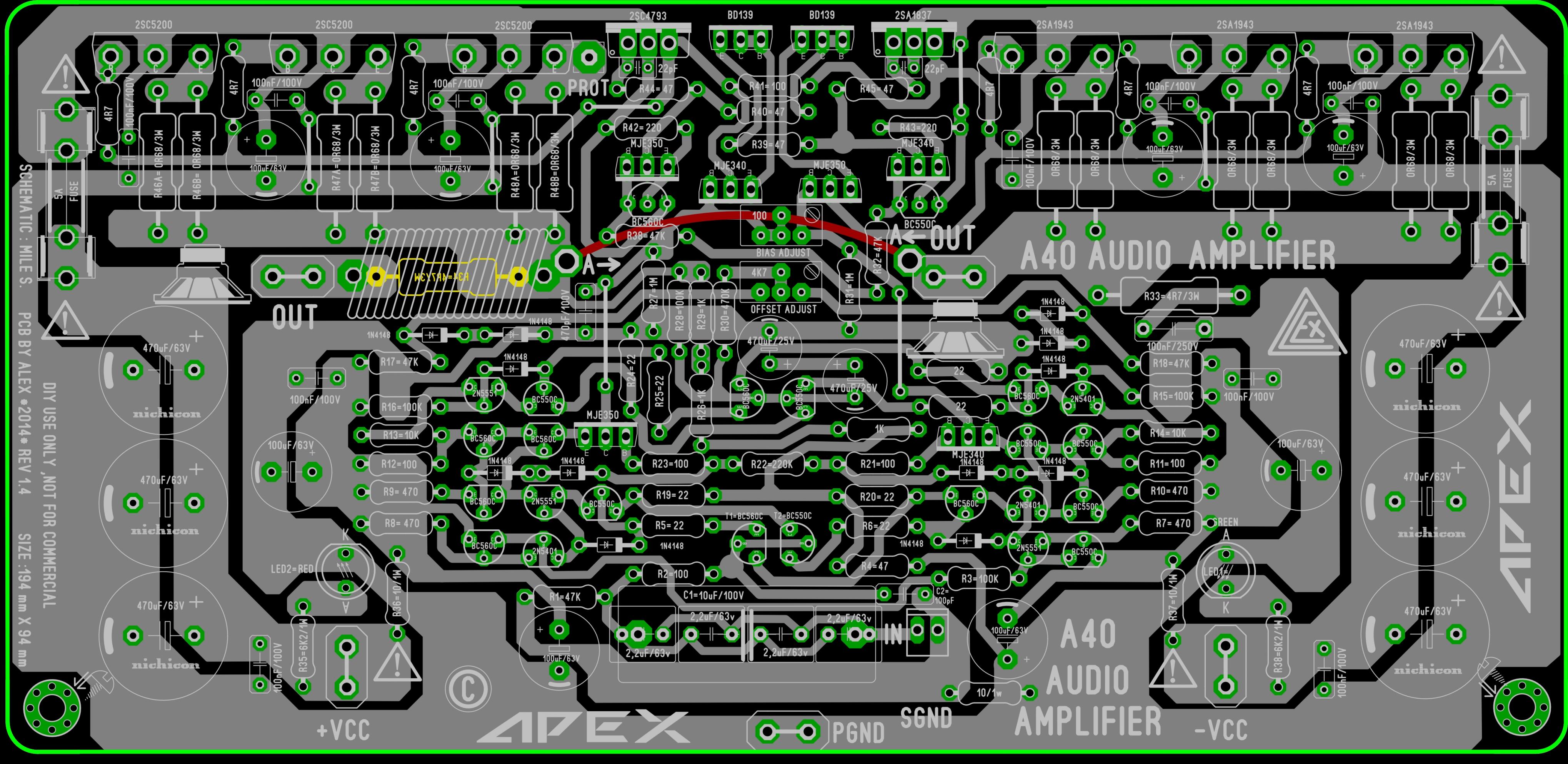

Yes it's my PCB design ....uff...it was from alex mm , but don´t know exactly![]()
Yes it's my PCB design ....![]()
one of the most complicated designs done into 1 side PCB, well done, admirable work

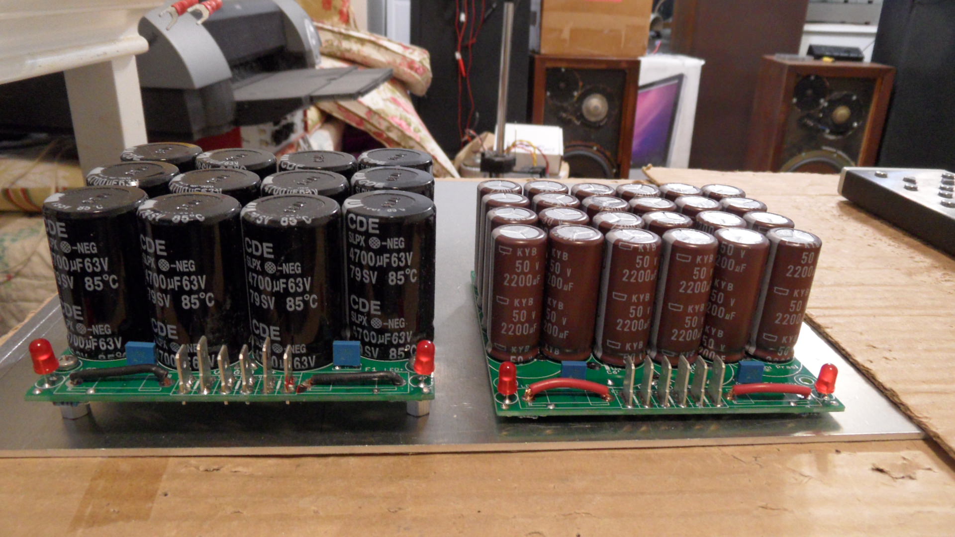

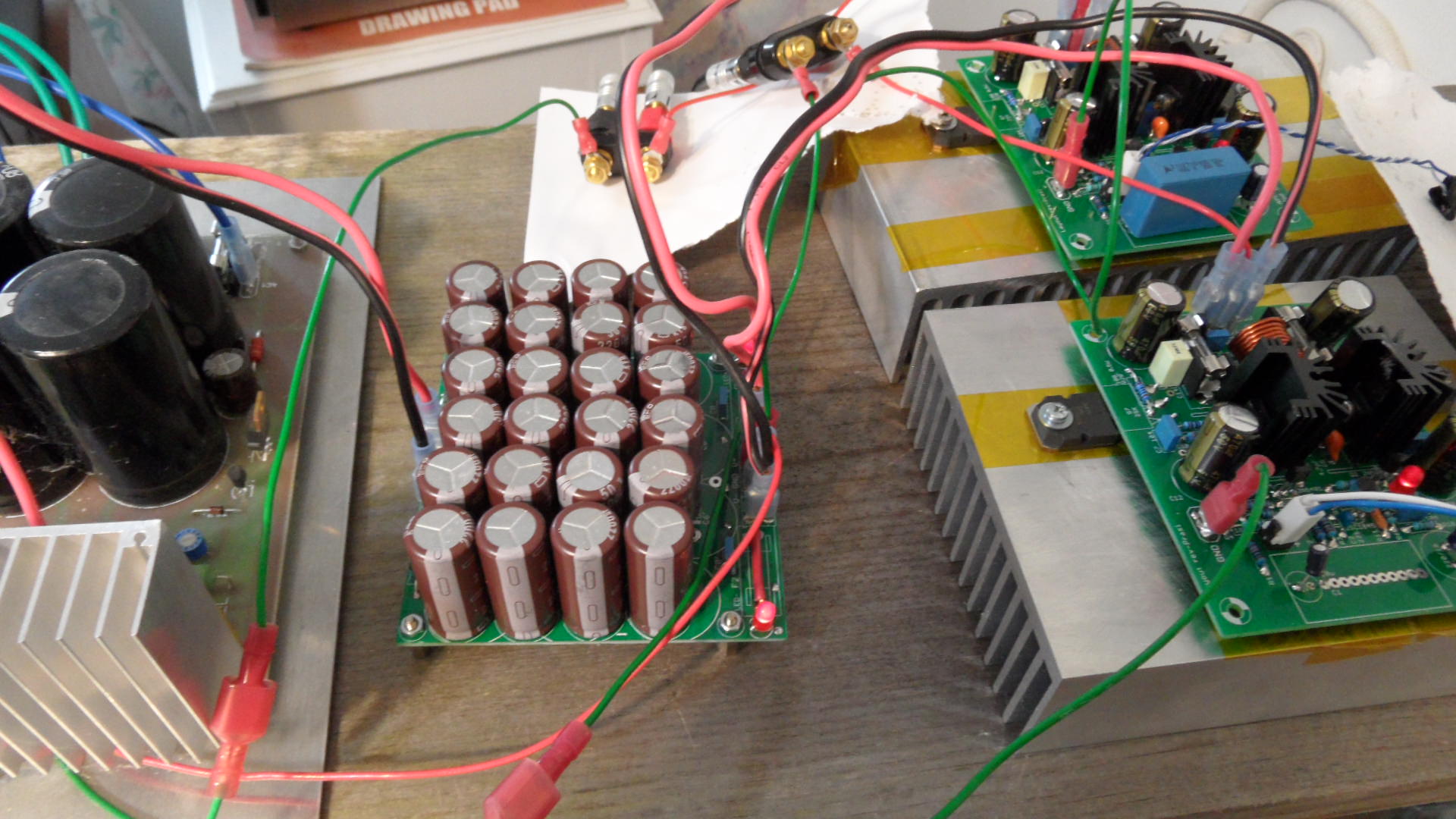

1 with 4700u63V and another with 2200u50V.
What is the End application?

Great! COngratulations on successful build of fx-8. Do post if you observe any improvements with cap bank.Prasi,
1 is for V4H PeeCeeBee, the other is for FX-8 Bimo Mod & any other i might like to try it out on. BTW the FX-8 Bimo Mod is also from your Gerber files. Thanks again, the FX-8 is currently singing minus the Cap Bank.

It is singing sweetly. The cap bank does help with all the music i have tried. it seems to me to help most with orchestral music that swells up. Gives it more body if that makes sense to you.
Anyway, thanks again.
Rick

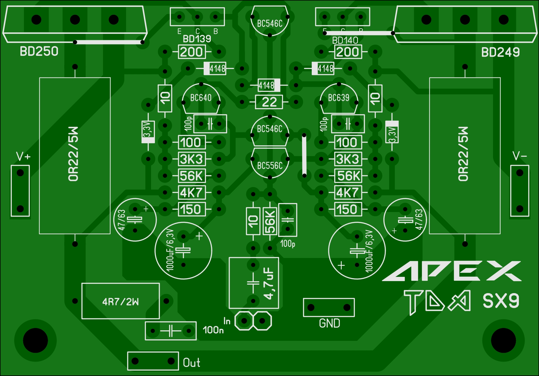

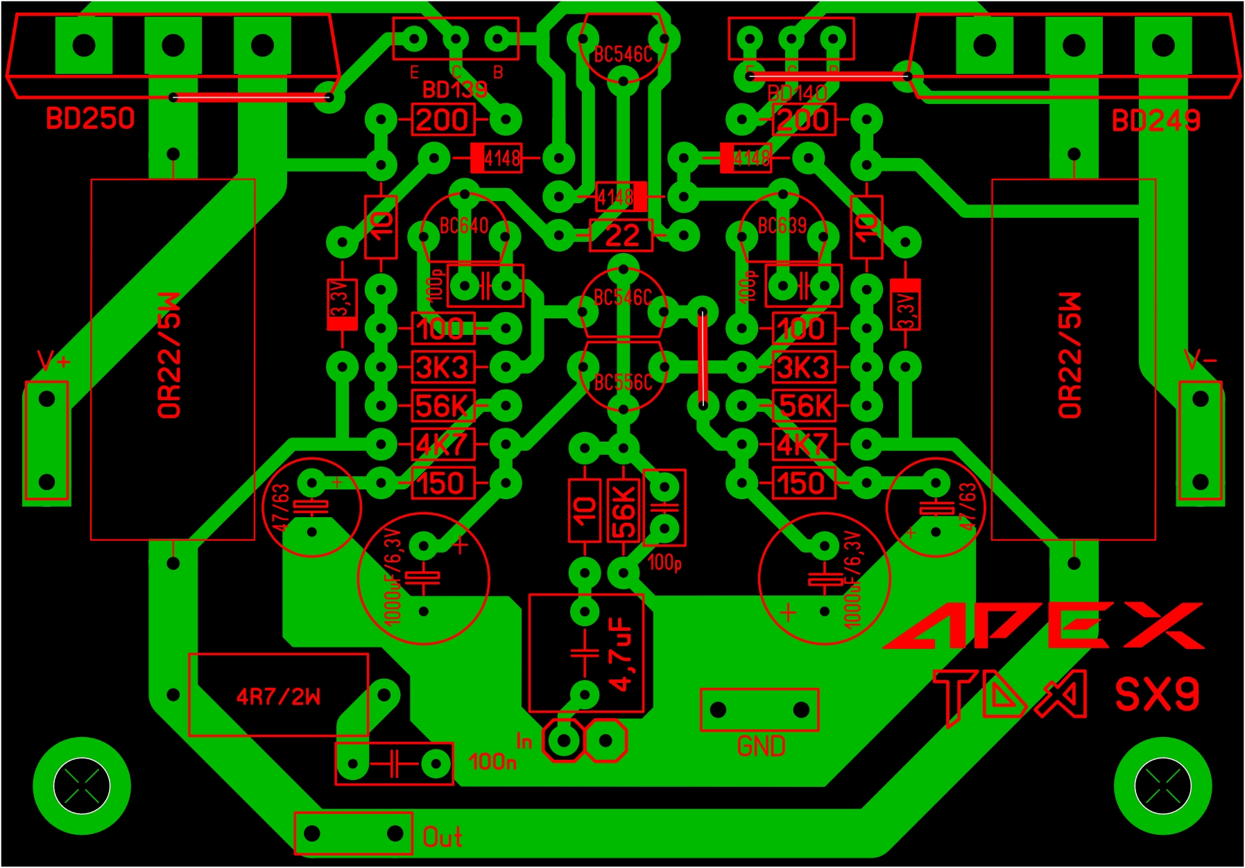

And PCB.
NOT TESTED
Zener diode polarity is reverted...
And PCB.
NOT TESTED
How about trying to avoid as many straps as possible? Especially those carrying more current...
