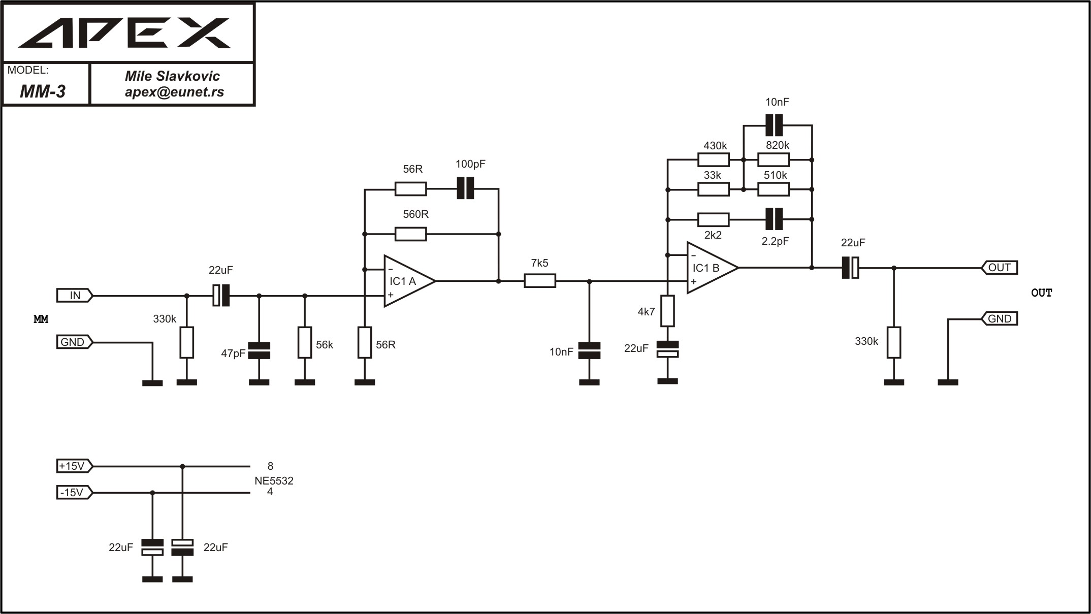

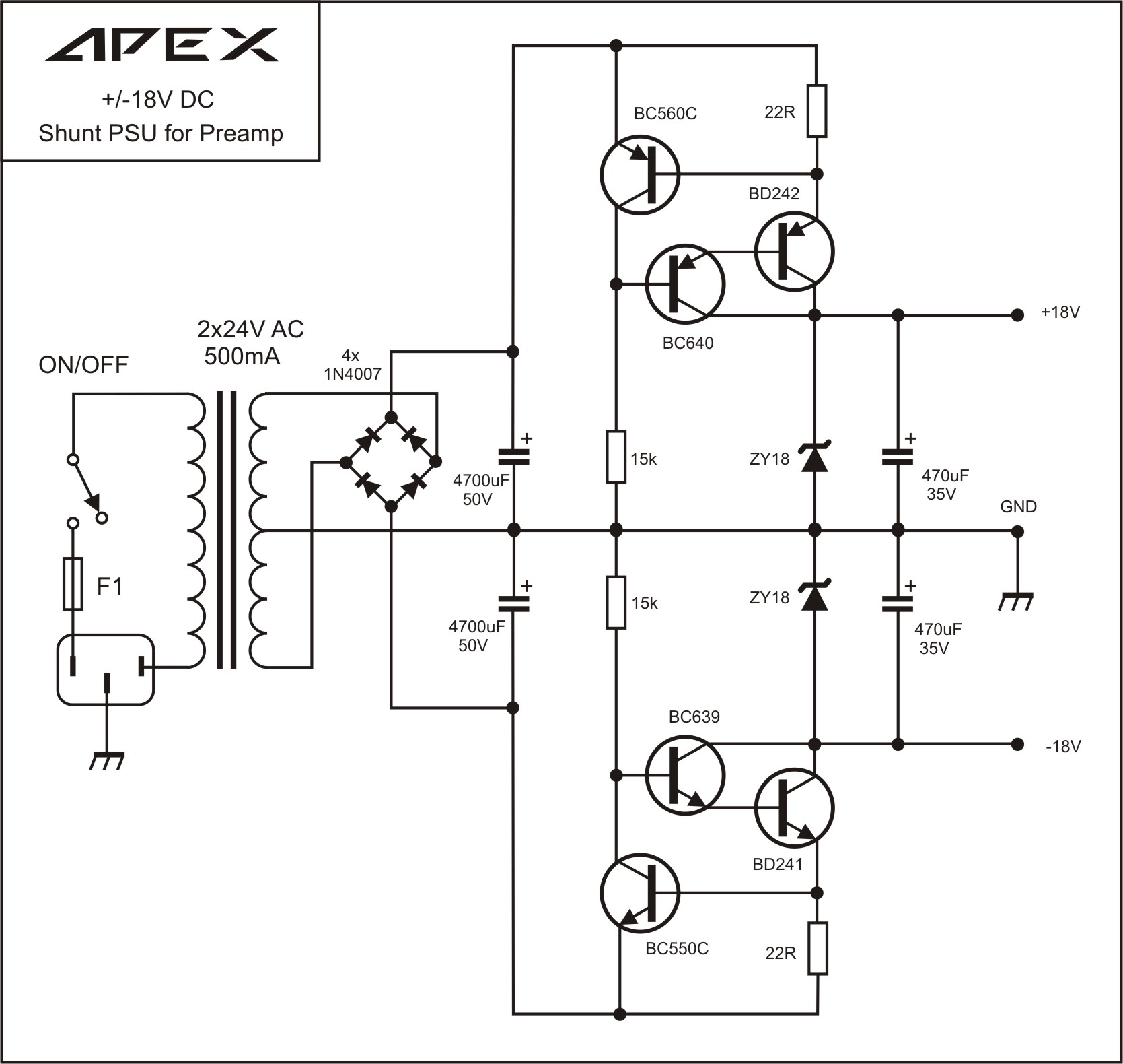

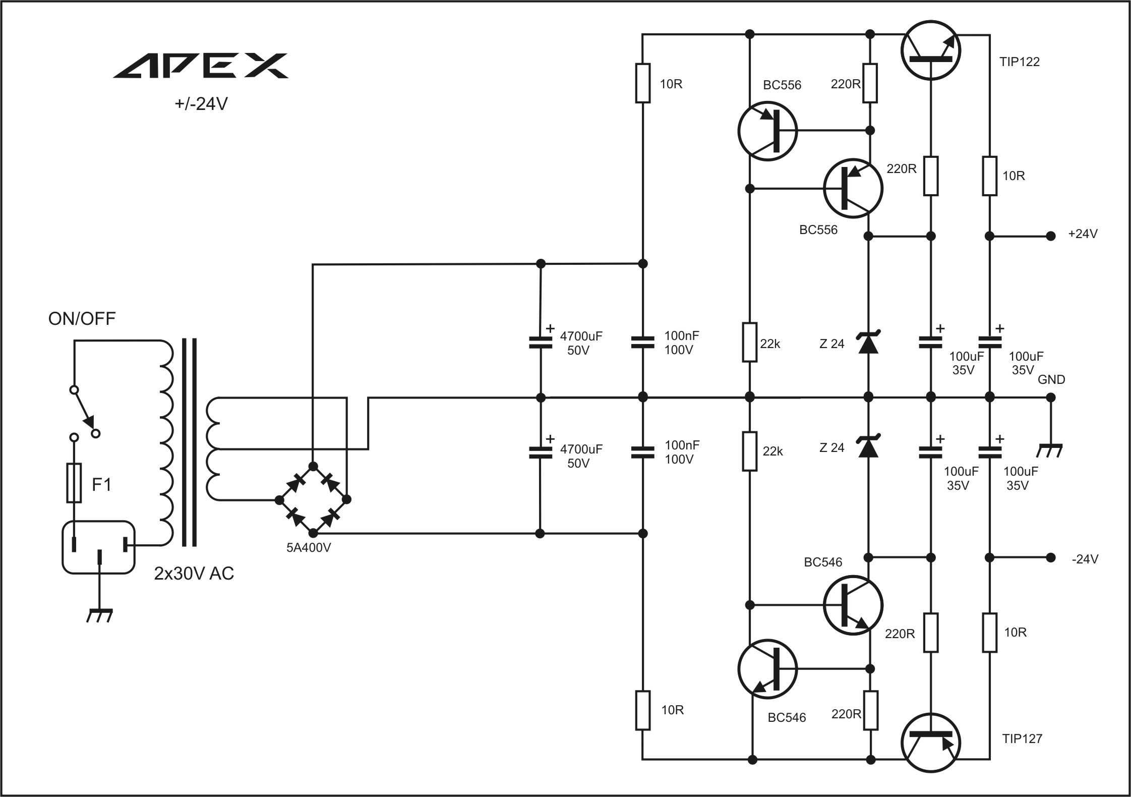

Hello Apex.What power supply do you suggest in using with MM3 and MM4 phono preamps? One based on LM317-337 or something else like the ones below,series PSU, shunt PSU ?

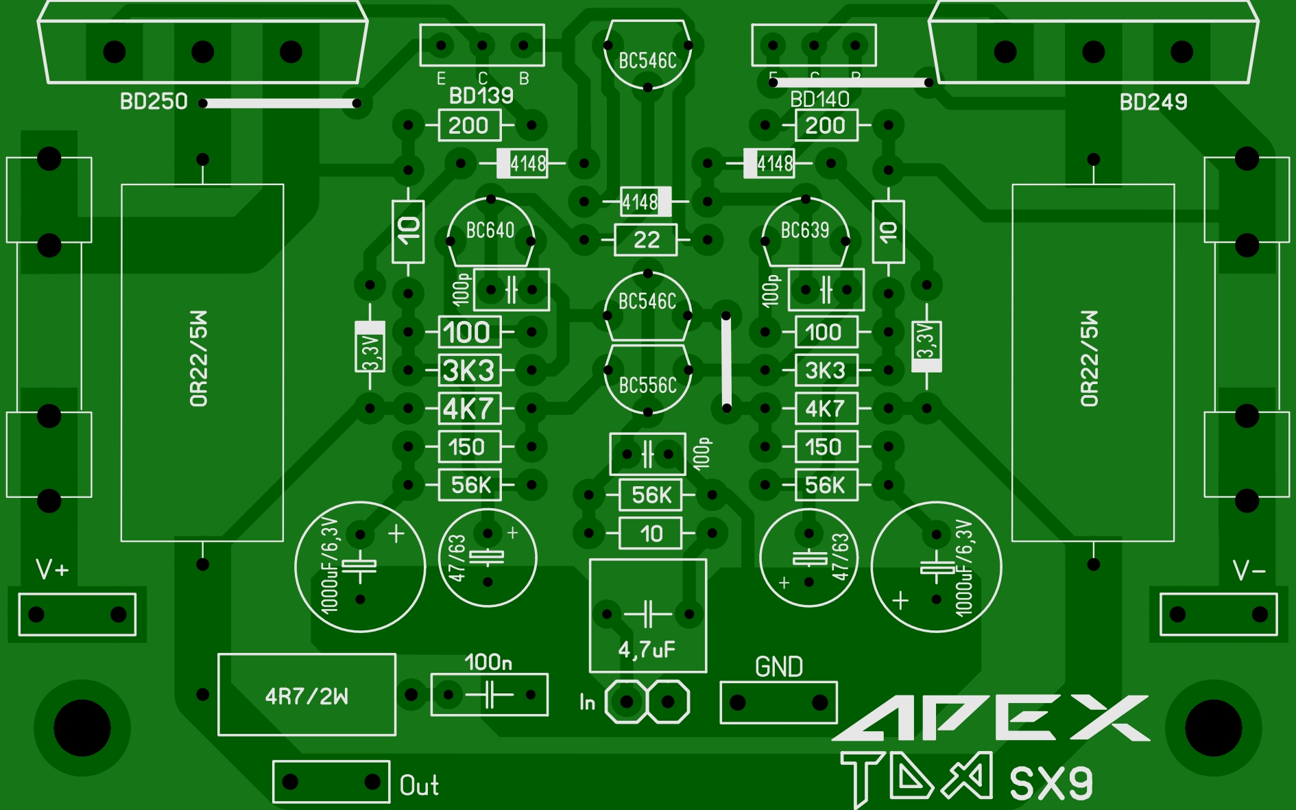

A40 factory PCB
A40 in progres , have to solder, some transistors on boards and will be ready soon . Prototype was tested successfully :)
