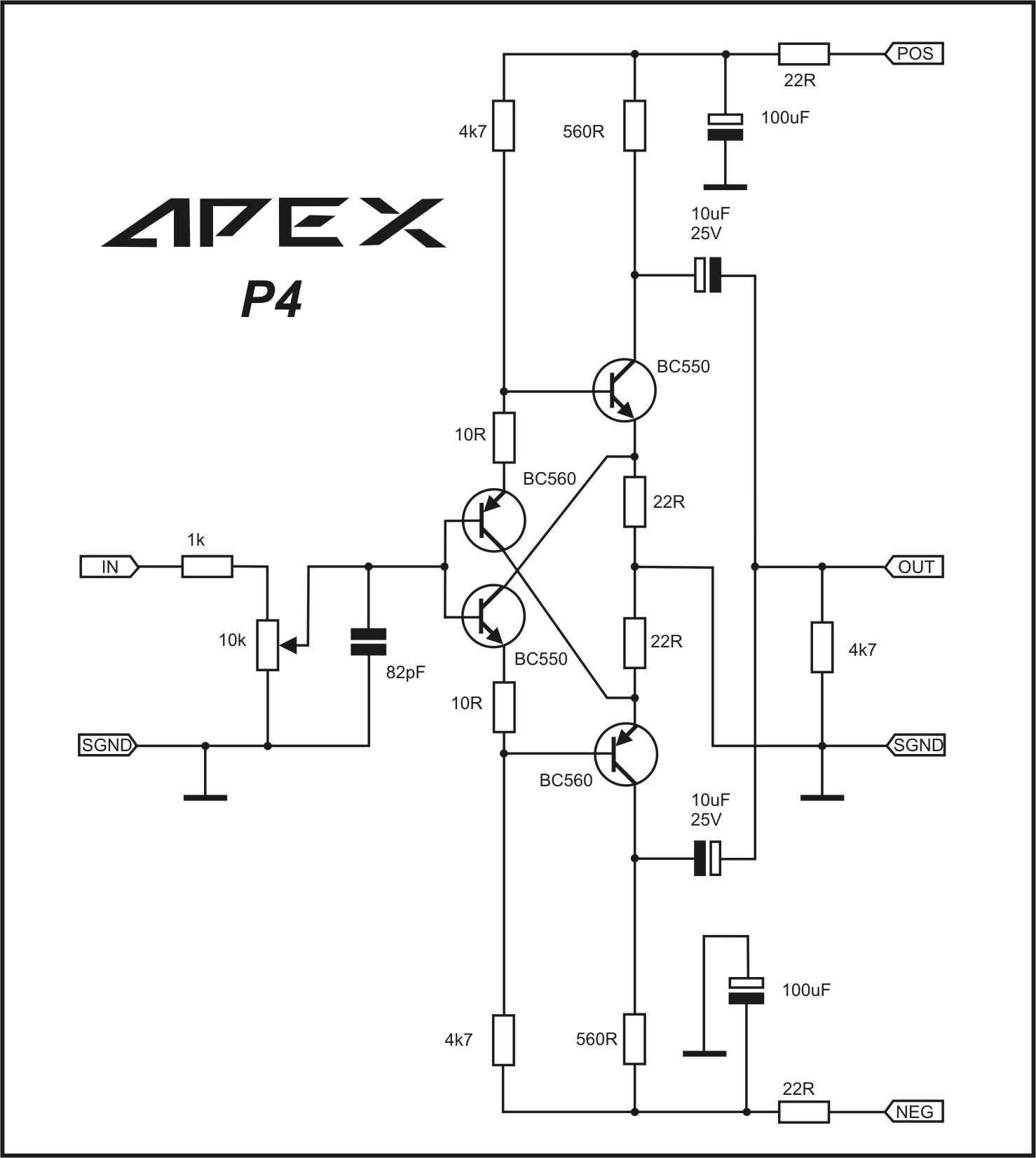

100W Ultimate Fidelity Amplifier
P4 Line Preamp

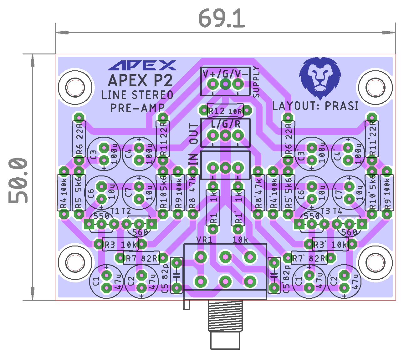

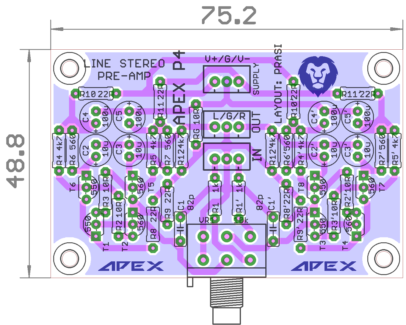

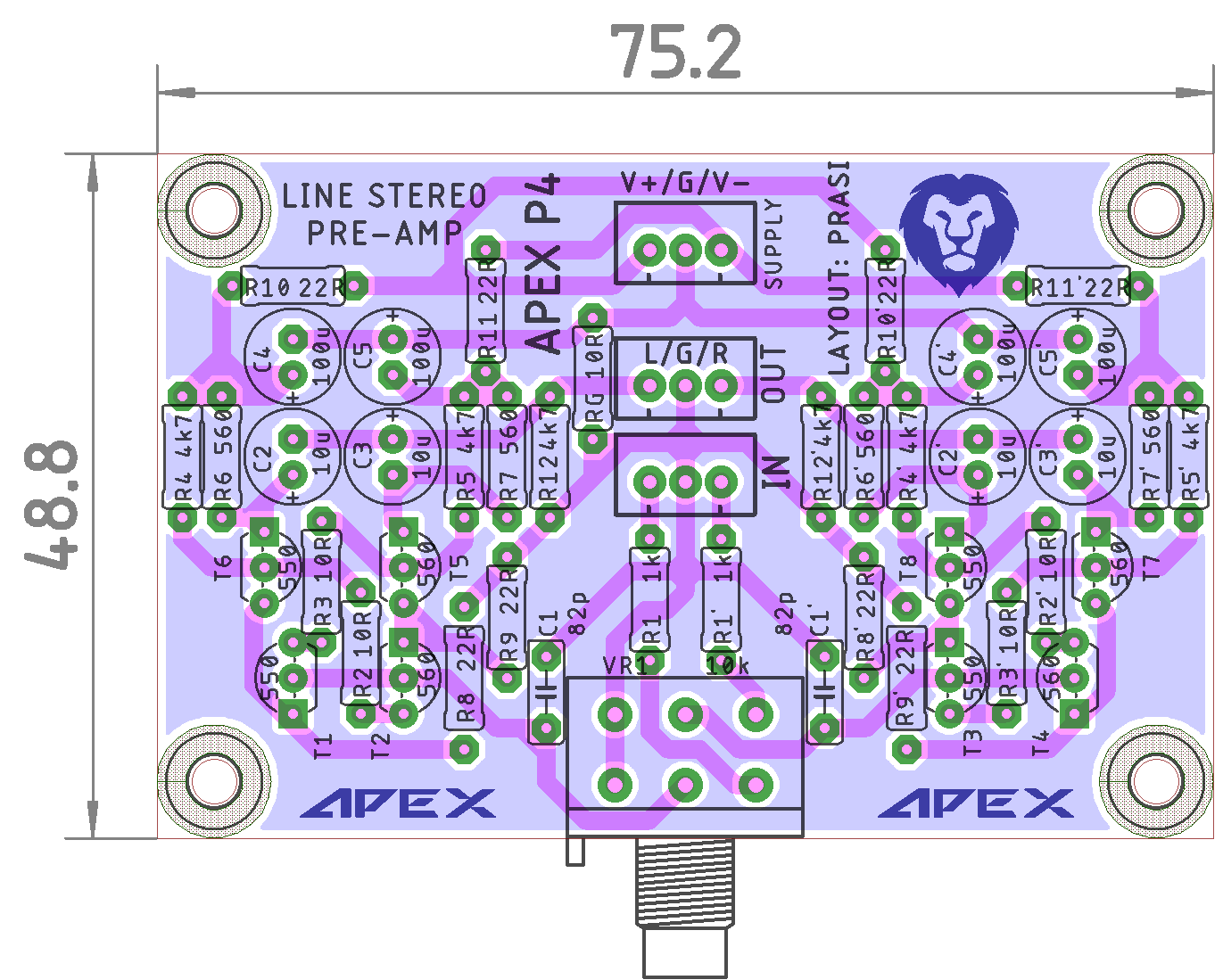

A note for those who want to etch their PCBs.
I have made the pdf's such a way that on a 4" x 6" copper clad, one can etch 4 PCBs at a time... Saves copper clad and etchant too...:D
But I would suggest to make use of cheap board houses, that way one could get double sided PCBs with gnd layer on top;).
  • gerbers P4.zip
  • gerbers P2.zip
  • P4 _4x4PCBs for 4inch x 6inch copper clad.pdf
  • P2 _4x4PCBs for 4inch x 6inch copper clad.pdf

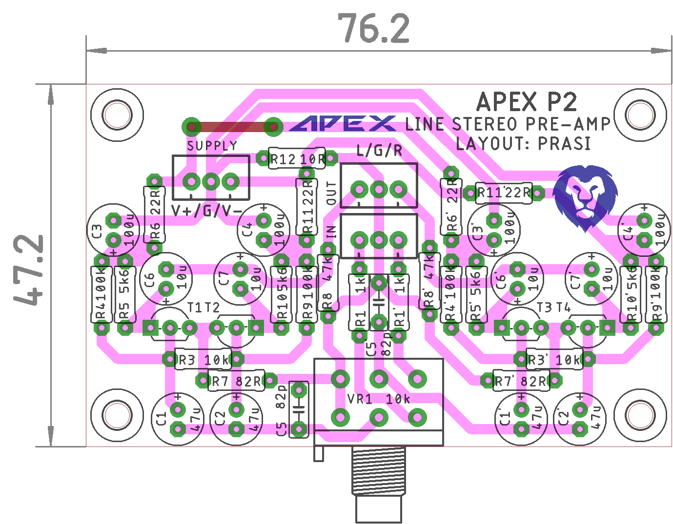

Prasi, you are such a nice guy again with sorting the pcb layout.:D I suppose this is for +-24 VDC, for working on +- 12VDC , which resistor values have to be decreased ?
For P2?
I am guessing R5 /R10 to 1k, based on the quick and dirty spice , here it is...
weird thing is I cant get it to work with Mr. Mile's original values. (I am no expert with spice BTW:mafioso:)
Can some one confirm or check the spice sim?
there definately appears to be something wrong here, in spice sim...
