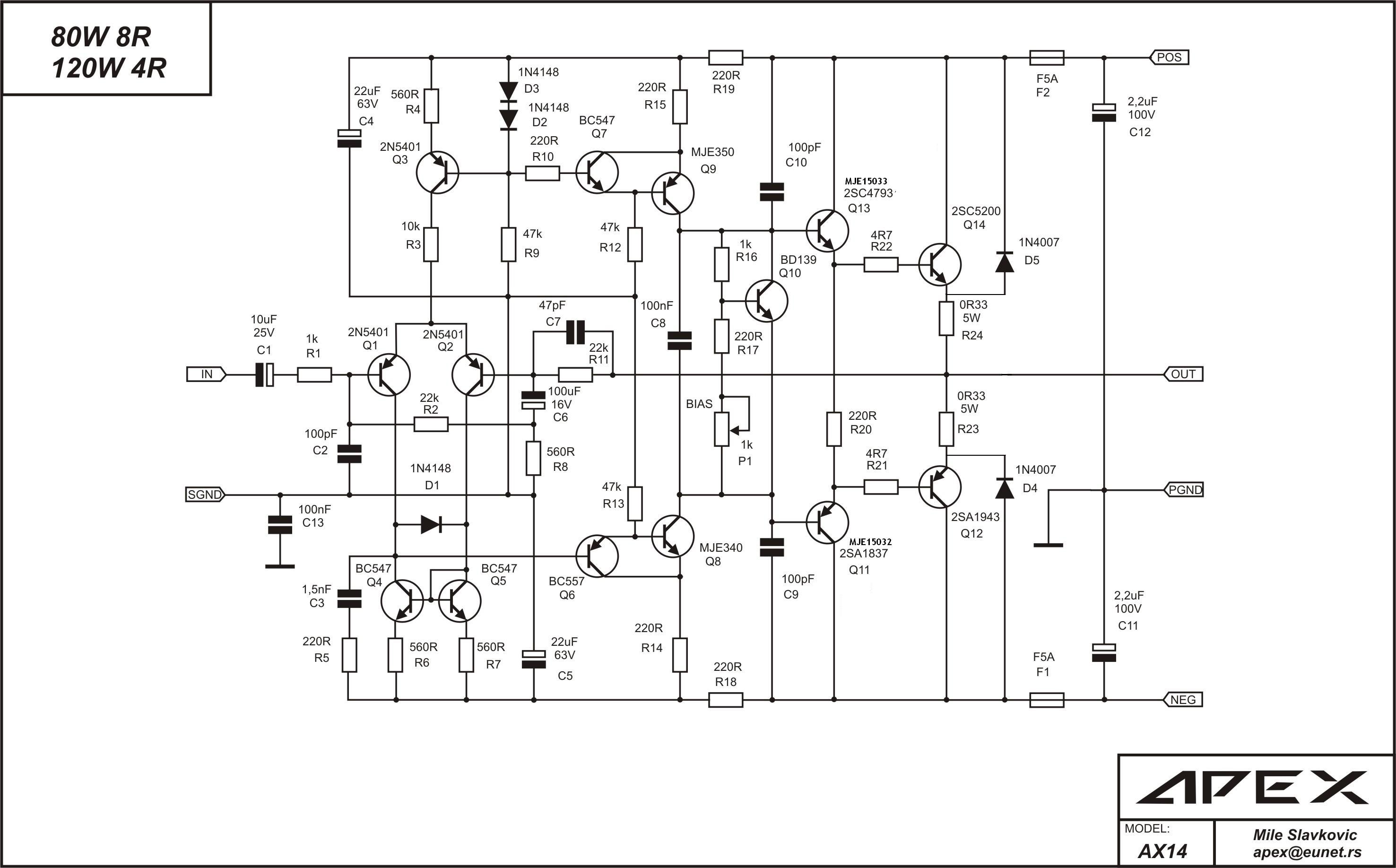

need help about AX-14
Hello Apexsir

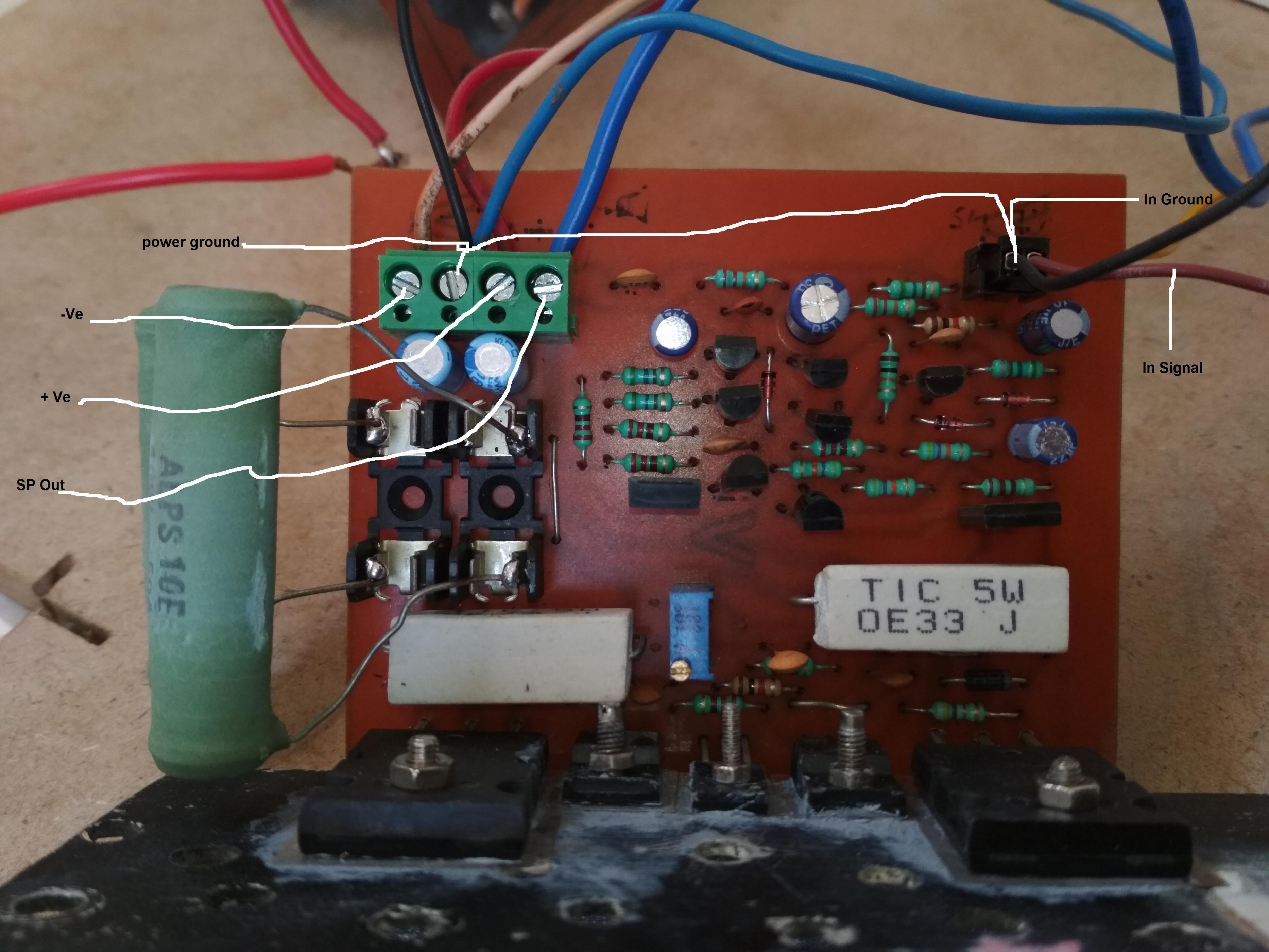

I make your AX-14 Amp today, during testing amp I got dc offset 40vdc and the same voltage on 0.33Ohm resister.I make all connection as you mention
Connect Input ground to PSU ground, a short input terminal, use 10 Ohm 10w resister instead of fuses. My supply voltage is +/-47Vdc.
What are the problems? please see attached photo and help me.

Dear prasi
I am using following layout . and I am get -40dc on sp out please help
I think you forget to connect signal ground from input to GND . See red line in attached picture.
I think you forget to connect signal ground from input to GND . See red line in attached picture.![]()

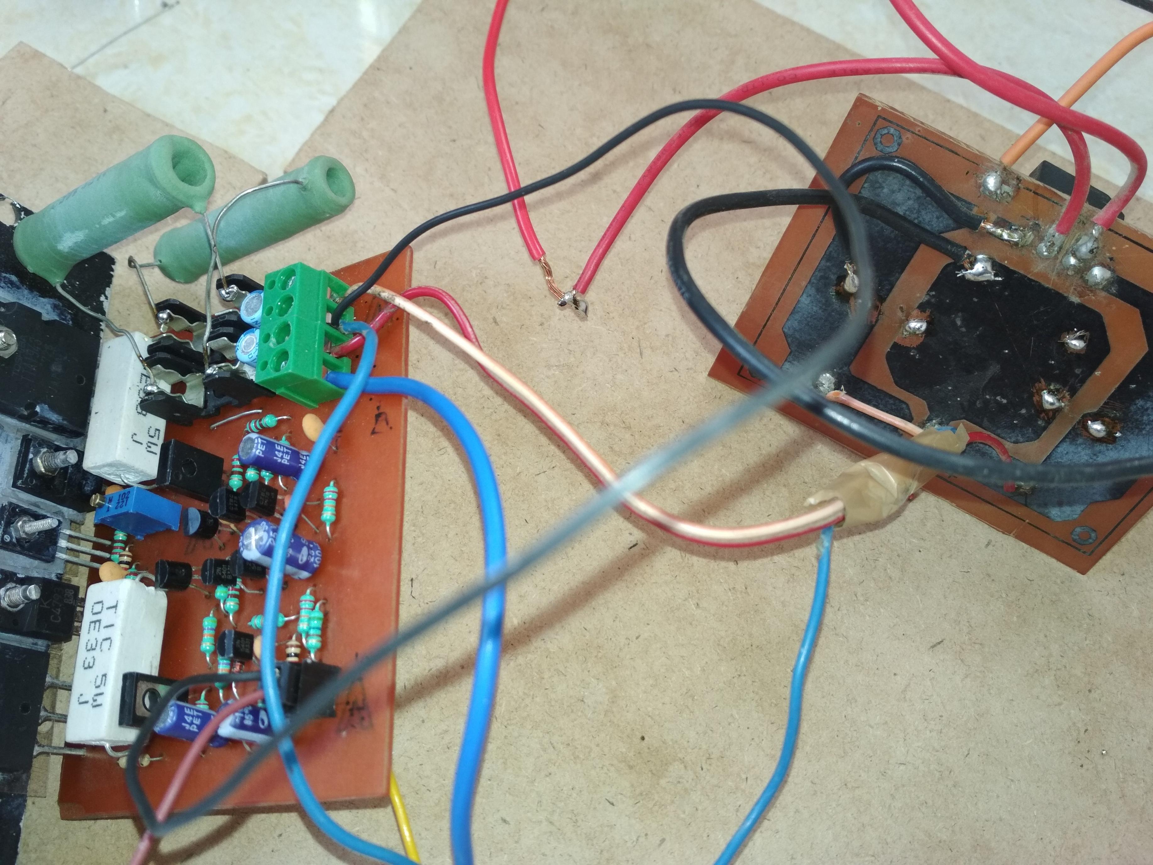

dear Alexmm sir
already connected Signal GND to PSU GND with wire, But still get -40Vdc on amp out.Whats wrong. please see the black wire in the picture

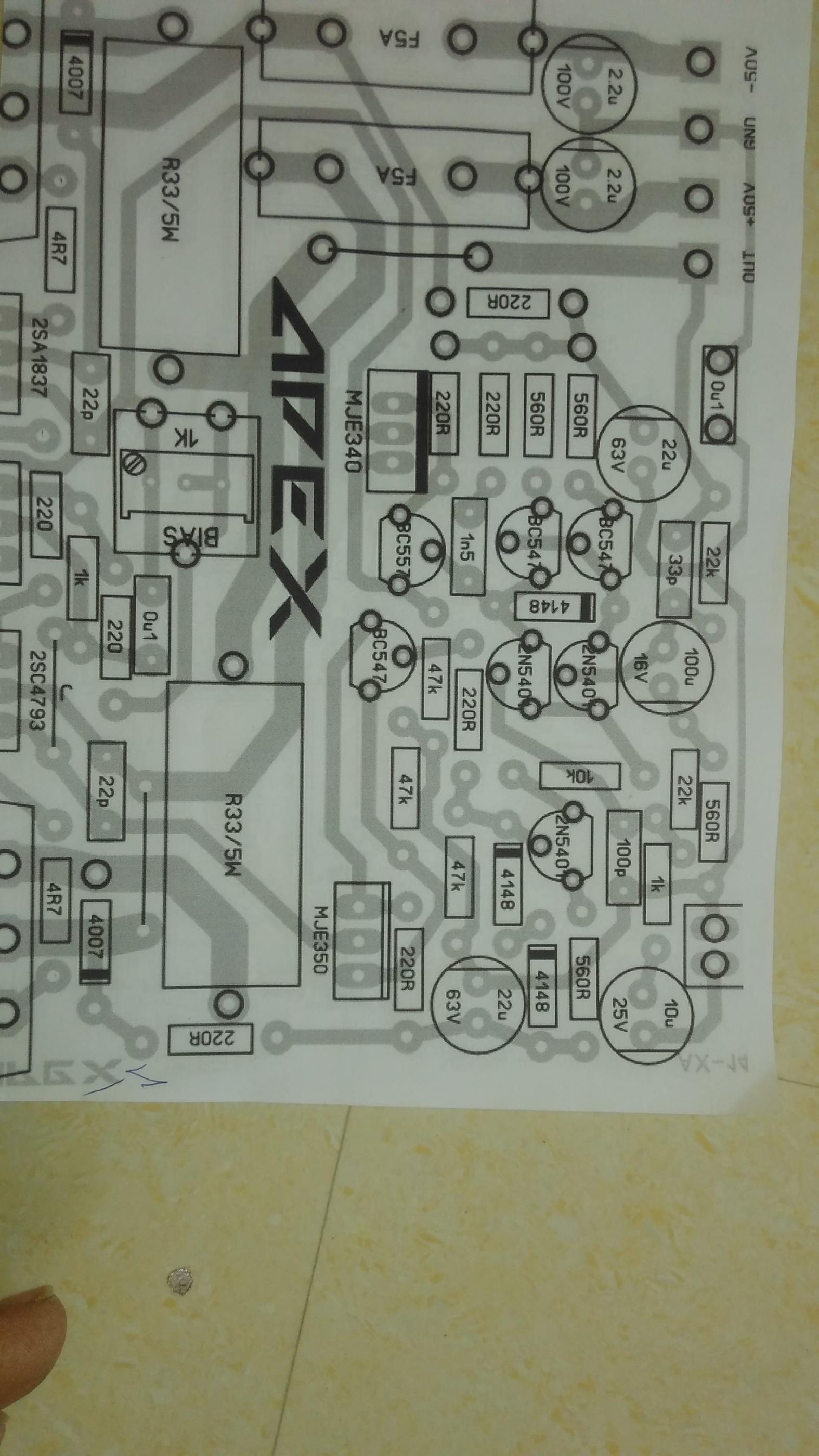

check if the track is proper...red circle
I have check track back again it's connected I have also checked in PCB layout and also not found any short track . I have also done light bulb test ,light glows only for fraction of time .
Did you check the output transistors for short circuit?
What you used for small signal transistors, are the pins correct connected,?

Voltage on R4=42.9 R6 and R7=-42.5 R14=-42.8Voltages on R4, R6, R7, R14 and R15?
R15=42.5
my rail voltage is +-45 v

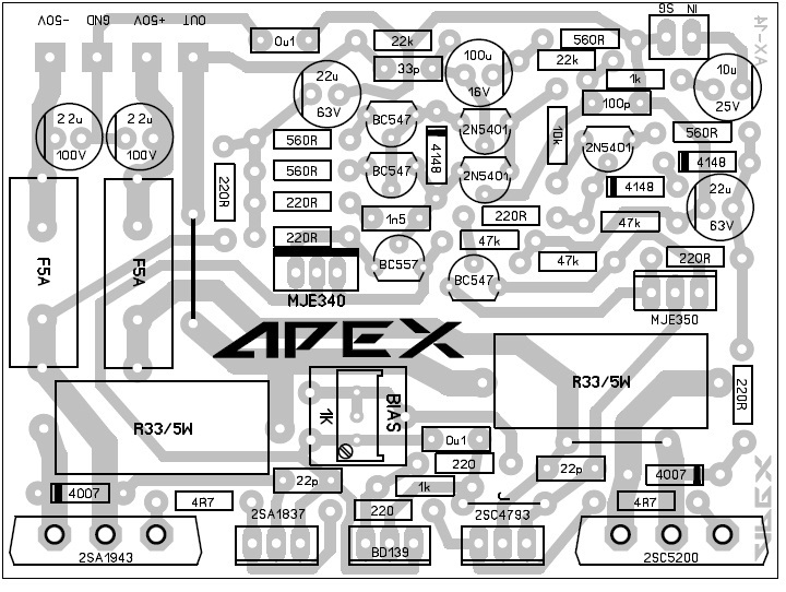

which schematics & PCB layout you used for your AX-14 Amp posted on Page 123 post #1221
Because I build one chanal for AX-14 amp from following schematics & PCB but, I am getting 40Vdc on Amp out during test dc offset, I already connected INput GND to PSU GND And short amp input, I check driver transistor also everything is ok. whats wrong, My rail voltage is +-45vDC.please help
dear Alexmm sir
already connected Signal GND to PSU GND with wire, But still get -40Vdc on amp out.Whats wrong. please see the black wire in the picture[/QU
try to connect input gnd direct to psu
