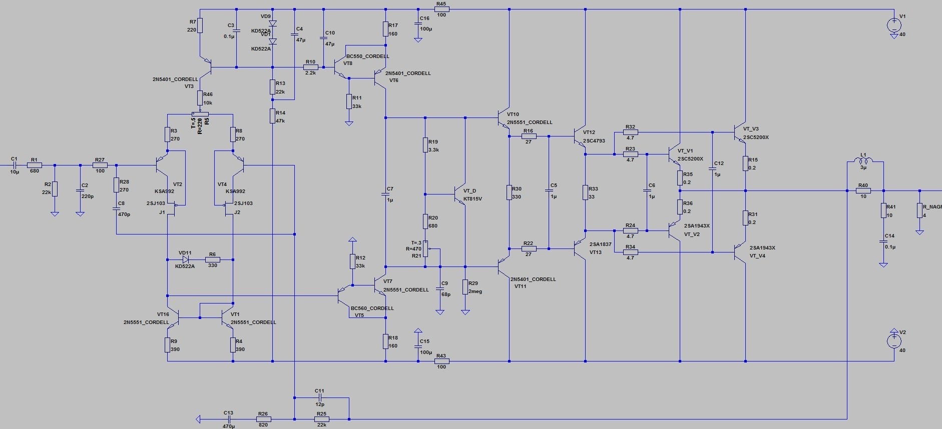

Mr. Astaro, I'm not going to build an amplifier on Soviet transistors, I specifically asked a question about using only KP504HT1 as J1, J2 by-parameters.

I have not read all 700 pages, but took a good look at the schematic on post 13981. Looks very nice, Damn good maybe, but not quite ultimate.
A few thoughts from my experience. Take with a grain of salt.
Giving up a a lot of swing with the size of the rail resistors. Maybe a "ripple eater" or as I used, a simple pi filter. ( 8X improvement in ripple)
Ultimate would be an independent regulated supply a few volts higher than the output rails.
IPS CCS is not as stiff as could pretty easily be achieved. An led is a bit more thermally stable than the two diodes. BJT/FET cascode is stiff as all get out.
I stumbled on playing with the amount of LTP degen vs global feedback and find there seems to be a sweet spot for every case. It seems to trade off even vs odd harmonics. One amp came out as the best compromise with 10 Ohms, another with 43. Self likes 63 but does not say why.
No output filter network? Fine if driving a resistor, but if a speaker, you might run into stability trouble.
I would have put the rail fuses outside the bypass caps. Electrolytics can short. But if one blew, it would not start a fire or blow up the amp.
No output protection? I understand even a fuse can cause distortion, but real world, DC sense, thermal and an a RF detector to detect instability? Or a fuse.
I can tell you, MOSFETS blow faster than fuses. Personal experience.
Some consider it evil, but I hate turn on and off thumps, so I sacrifice ultimate to use a muting relay. You can use the same sensing and relay driver to disconnect the rails as well as the speaker. Rail relay does not have to be good. Cheap will do.
One can then argue if the feedback should be in or outside the fuse.
The current fad is for differential input. I agree with your design it is not where to spend your design time for a home amplifier. If you already had a DAC and preamp that was diff, then I guess why not.
A feature I have added to amps is a low frequency HP filter. If driving full range speakers, it is wise to have an out- 20-30-40 Hz or so HP to limit cone excursion of your woofers below their F3 tuning. I think it would be smart to have an option of a 80Hz HP built in for running a sub. When I think ultimate, I think the entire system, not just the amp.
I was also looking at 139282. How much do you gain with the FETs? I have thought about them, but I can achieve simulations in the .00003% range ( on the bench, .003%) "FFT 10" levels of distortion without them.

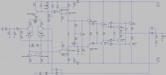

Hello everyone... just out of curiosity, I simulated the FH11 amplifier circuit and added a current mirror in the differential pair, which drastically reduced the distortion. Layman's question: is there any obstacle in including a current mirror in the differential pair circuit in FH11? Thank you in advance for your patience and responses.
It’s DIY so you are free to try out anything you want. Sort of like how I tried to make the FX8 a vertical MOSFET from a latFET. Adding a current mirror will change the amp’s signature sound for sure. Have you listened to a base FH9 or FH11? Try one first and have a reference to compare after you make a change that is supposed to make it better. The FH9/11 is already one of the best sounding amps there is out there IMO. It’s got a lot of solid bass and the mids and highs are all clear. The engagement factor is very very nice.
