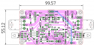

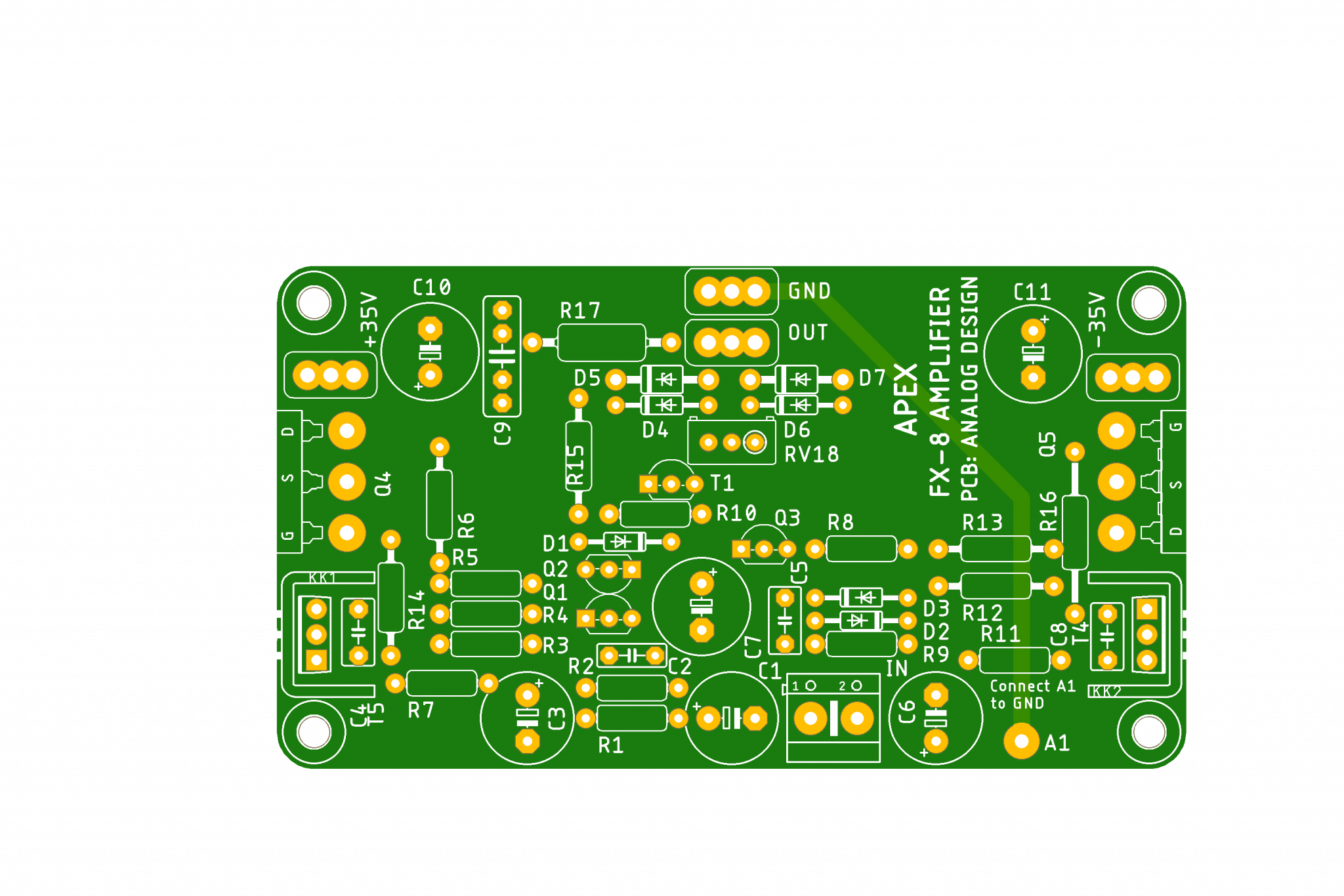

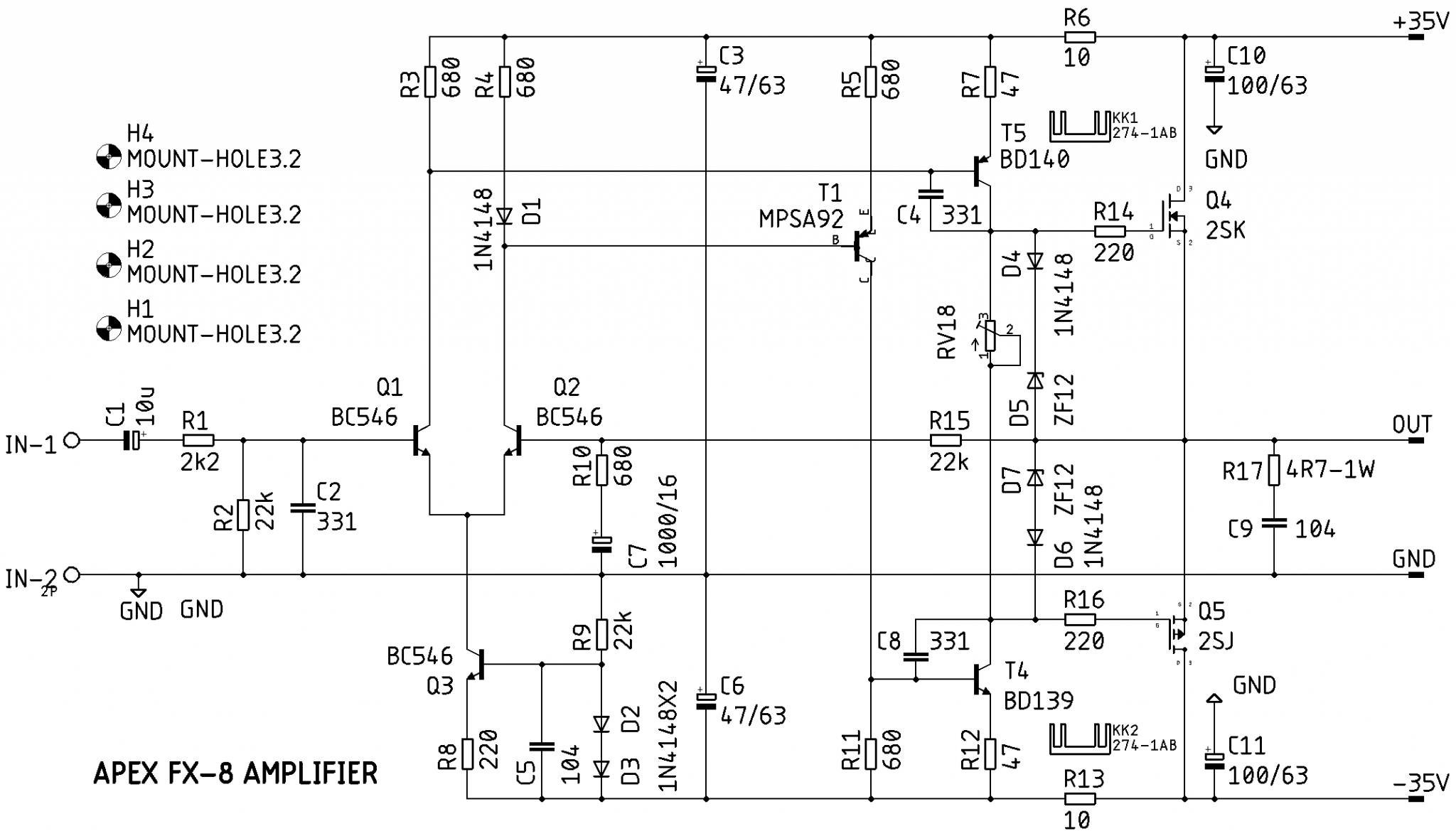

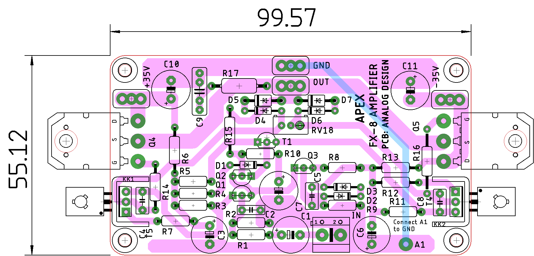

I will today. I just saw your post. Gerbers and pdfI want to make this circuit. Can you share the prasi gerber file?
Here are the files for apex fx-12I want to make this circuit. Can you share the prasi gerber file?
Thank you Prasi. So glad to have youHere are the files for apex fx-12

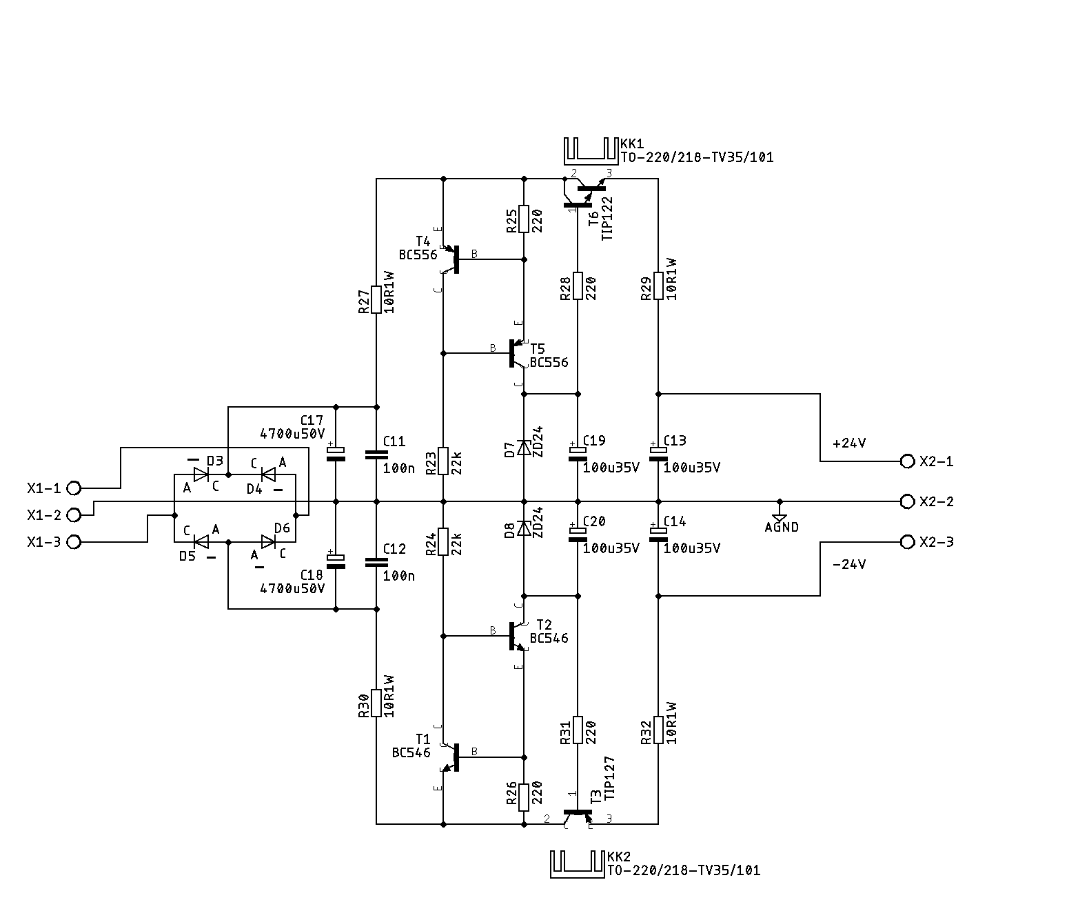

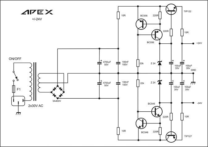

Apex Shunt psu from post#13477.here you go..![]()
I’m getting an output 2v lower than the installed zener diodes.
ZD24 = +/-22vdc output
ZD15 = +/-13vdc output
ZD12 = +/-10vdc output
All examples use appropriate transformer CT secondary voltages: 24v, 15v, and 12v.
Dummy load = 100mA
Is there an adjustment to the resistor values needed to get the correct output voltage?

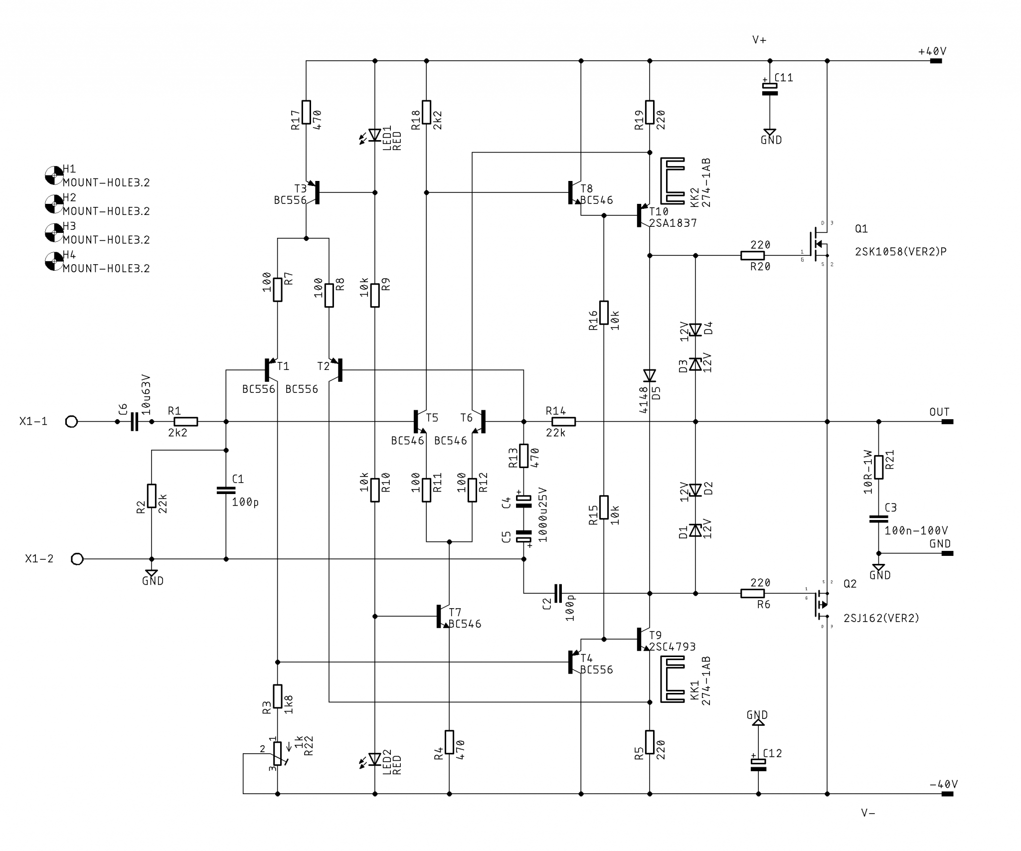

Hi Prasi,Hello Gurpreet,
here is a rough b50 layout.
What is the recommended supply voltage for the Apex B50?

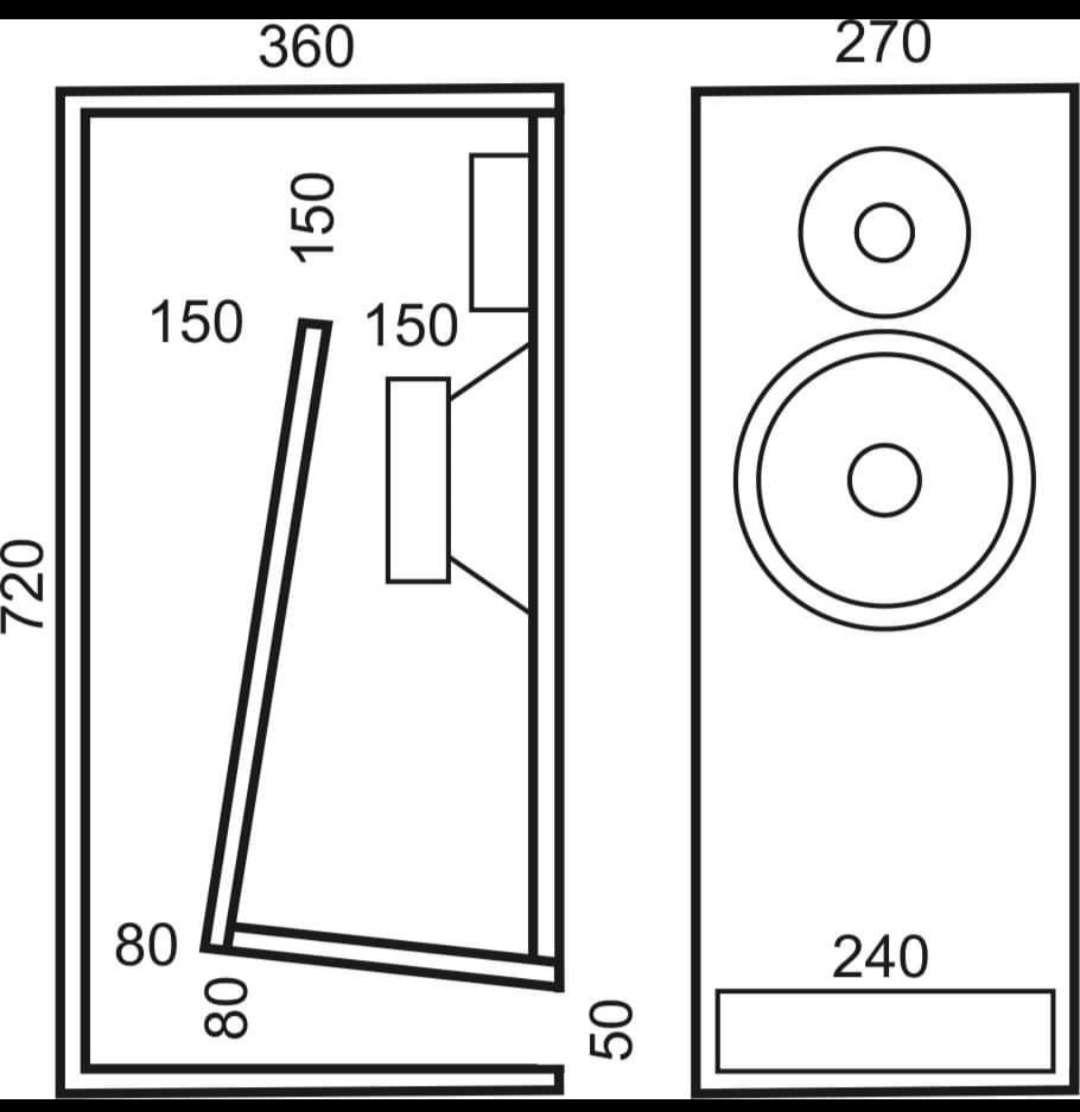

TL for 8 inch driver.
Is it 270 mm overall width dimensions of the speaker box without side wall or with side wall?TL with 8 inch driver
270mm is with side wall.Is it 270 mm overall width dimensions of the speaker box without side wall or with side wall? View attachment 1036089
I think since it's a single pair output, you would be safe with 35v.Hi Prasi,
Thanks i'm planning to build it but confused in that area so, confirming overall dimensions H-720mm x B-270mm x D-360270mm is with side wall.
Now confirmedThanks i'm planning to build it but confused in that area so, confirming overall dimensions H-720mm x B-270mm x D-360
