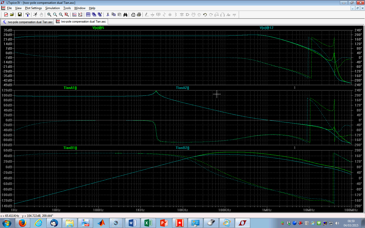

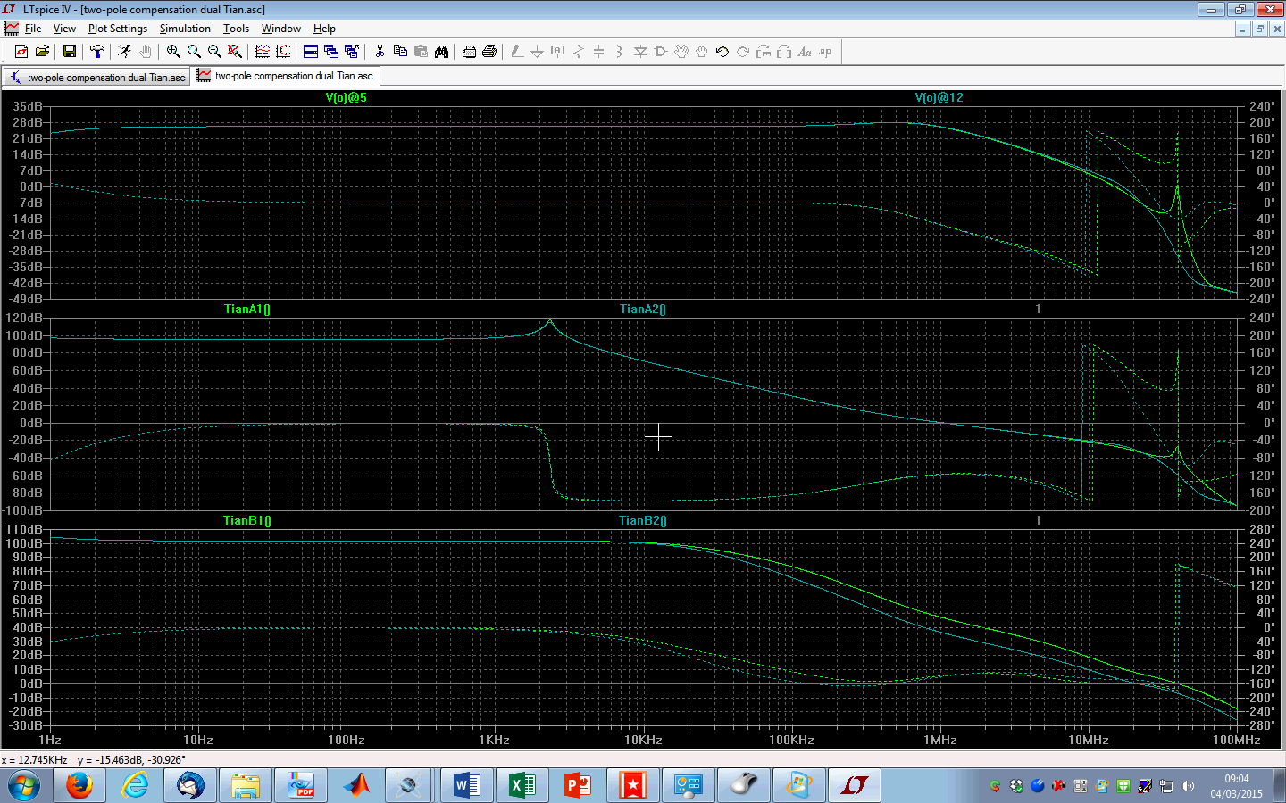

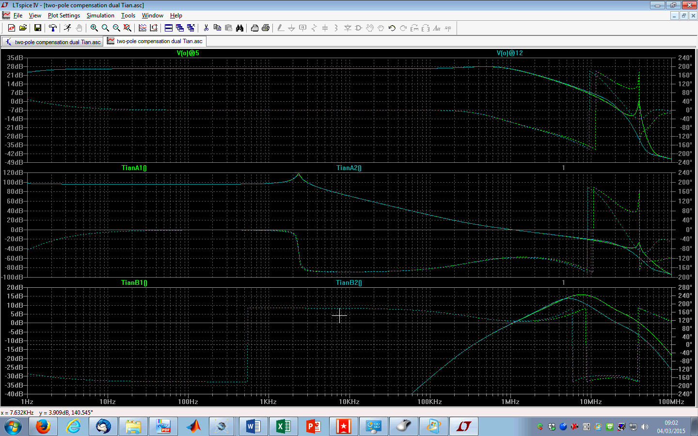

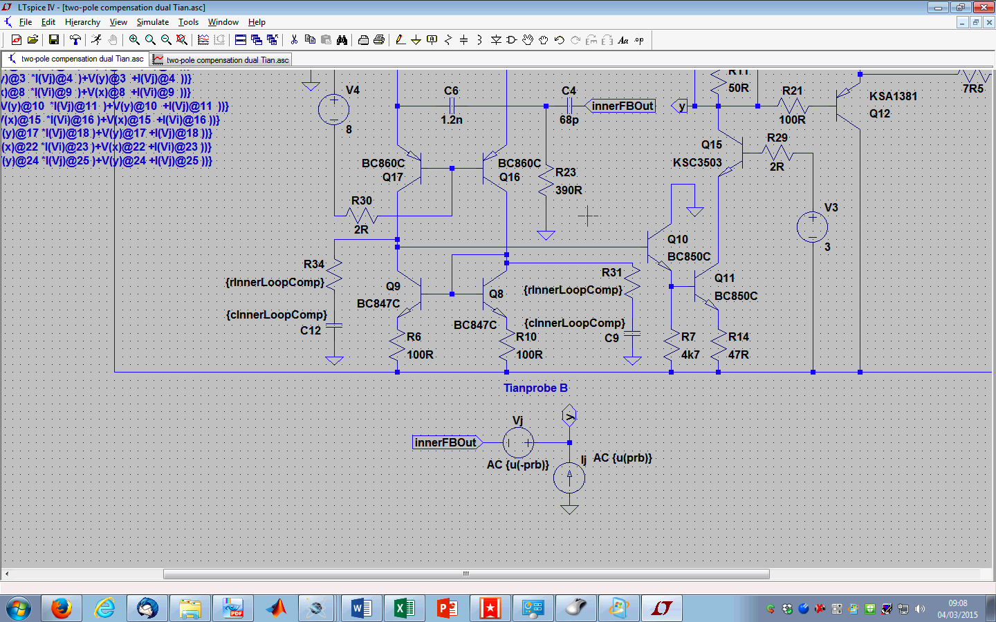

Harry, can you post CLOSED LOOP responses of your #711 examples?
Yes, here you go.
I’ve done some further experimenting, looking at differences observed for “isolating caps” (the big 1 kF caps placed at the input nodes to disable the global loop when the inner loop is simulated) being present vs. not present, and two different locations for the tian probe to simulate the inner loop. See attached images.
Notes: top pane = closed loop response, middle pane = global loop, bottom pane = inner loop
green trace = inner loop not compensated, blue trace = inner loop compensated
Enjoy!
Harry.

It’s fairly easy to make a two-pole compensated amp where the outer loop looks fine but the inner loop is unstable (put cascodes in the input stage and VAS/TIS, beta-enhance the VAS/TIS, connect feedback caps so both casodes are included in the loop).
No need to go that far. Just get a 30MHz RET devices triple EF output stage without Zobel and output inductor, with some 100nF capacitive load, and close a global loop around a standard Miller compensated Blameless.
If you consider the EF as the inner loop, then you can easily miss the EF triple instability if you look at the global loop only. Whatever gain and phase margins you'll get, the amp will be unstable on the bench because of local instability in the output stage.
Of course, people don't usually like to think of an EF as a local feedback stage.

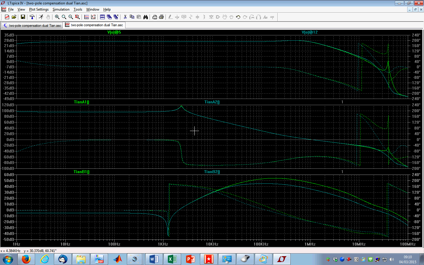

Thanks for this Harry.
I've done quite a lot of comparisons of Tian vs zillion Farad cap. My early efforts with LTspice used your zillion Farad cap or zillion Henry inductor. 😱
When I learnt the true Tian way, I did these comparisons to see which of my old sims I had to bin. IMHO, differences are usually well above ULGF of even the 'inner loop' so I was happy to keep my early efforts ... except for some exotic stuff to do with impedances. 🙂
_______________
Your Closed Loop responses are sorta what I'd expect. IMLE, the 'real life' amp will be unstable .. perhaps only on part of the cycle depending on load/signal/thermal history bla bla ... and at about the frequency of your 'inner loop' instability. You can probably see this using .TRANS
I/we seem to be jumping between this thread and Toni's http://www.diyaudio.com/forums/solid-state/235194-2stageef-high-performance-class-ab-power-amp-200w8r-400w4r-125.html.
I think you need to check stability of 'inner loops' with the 'main loop' intact. My posts in Toni's thread starting from #1242 show what a powerful influence it has on the 'inner loops'.

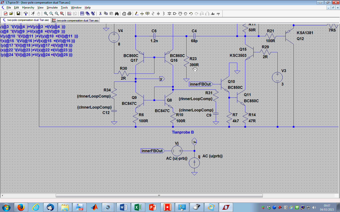

For measuring the inner loop, which probe position (ref: my post in this thread #722) is “correct”? Both give the same phase/gain stability margins (I checked) but very different responses at lower frequencies.
It depends on what you are trying to do or see.
If its stability, either will probably do.
I you want to show impressive figures in the audio range, the one on the base is superior. 😀
OK. I think the one on the VAS base is the correct one for this type of compensation
In this amp, it cuts ALL the important loops. Not sure about feedforward though 🙂
... I think the one on the VAS base is the correct one for this type of compensation
Definitely. I already wrote this in Toni's thread so I don't want to labor the point but, as you noted, we have skipped around between these two threads.
In this amp, it cuts ALL the important loops. Not sure about feedforward...
It does not include feed-forward for the inner loop, nor should it, because feed-forward does not contribute to Return Ratio of that loop.

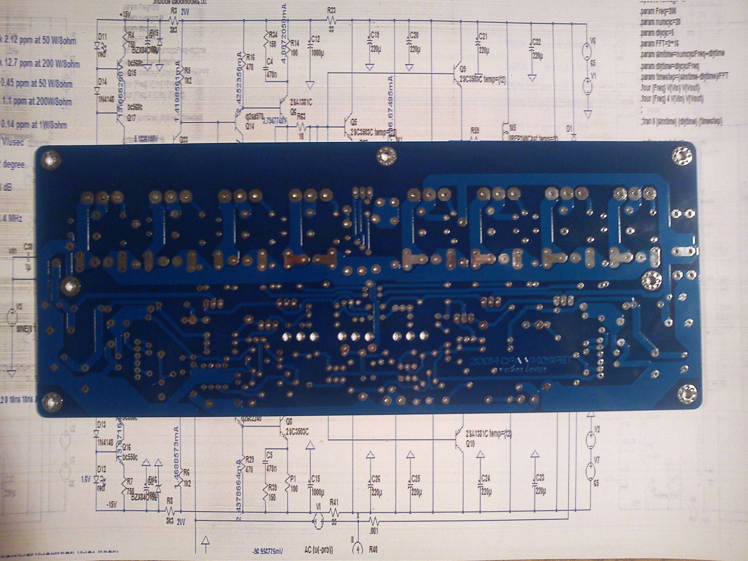

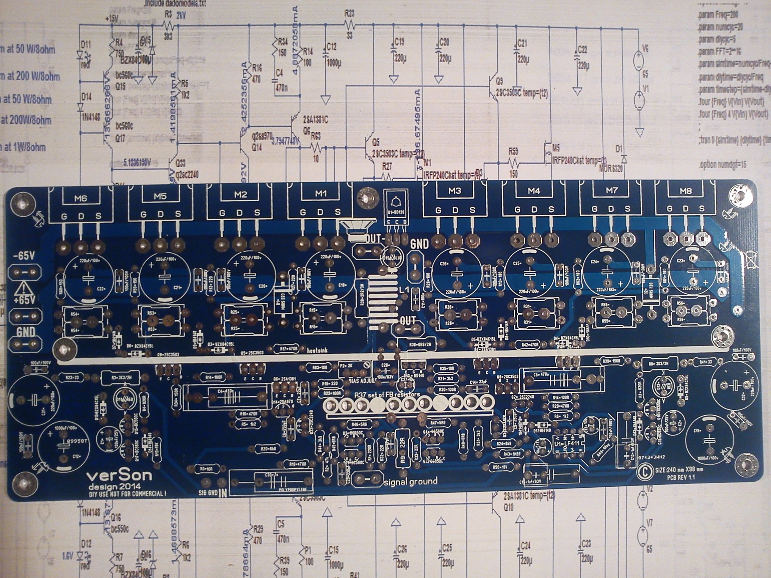

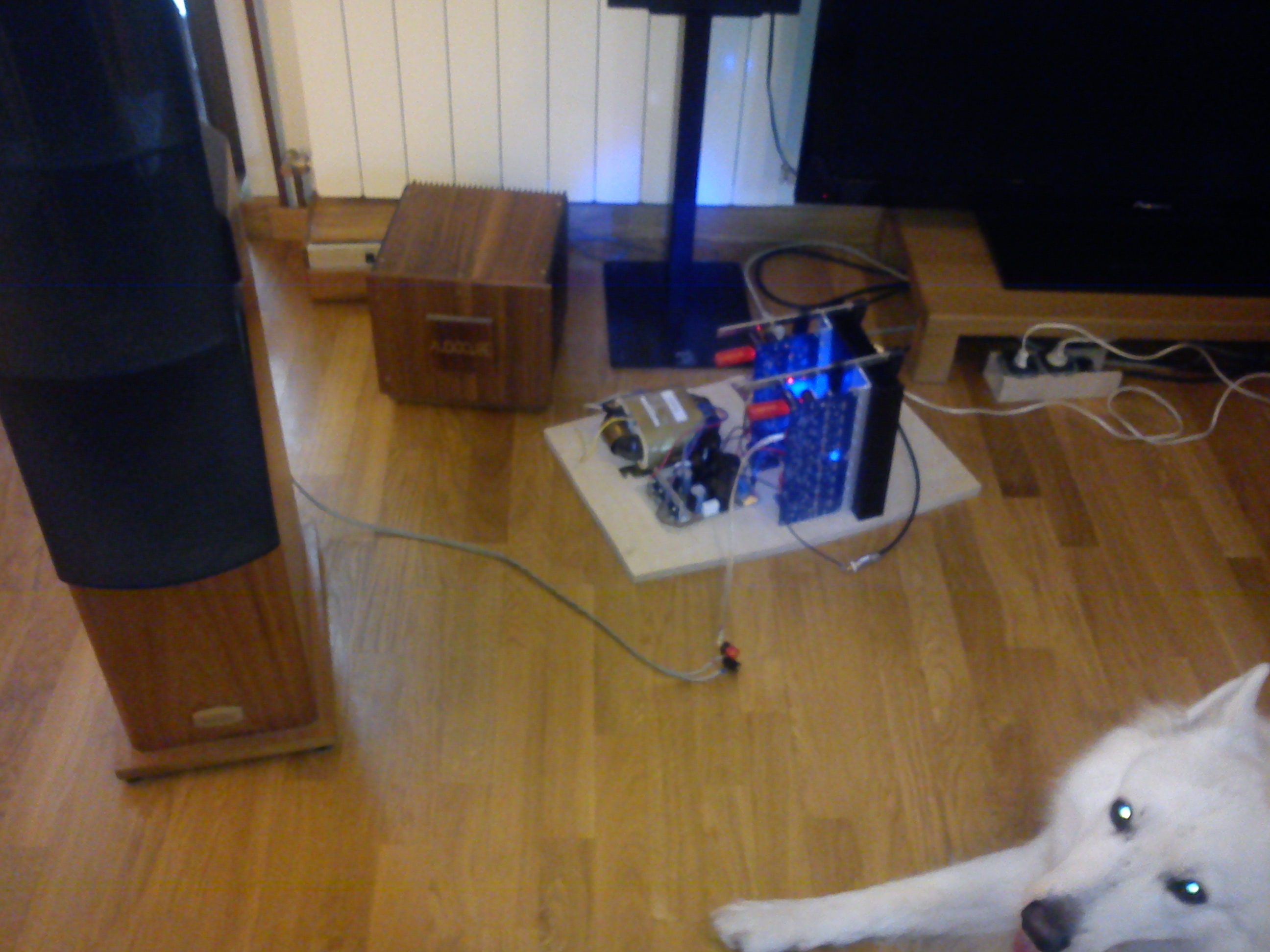

Hi Guys

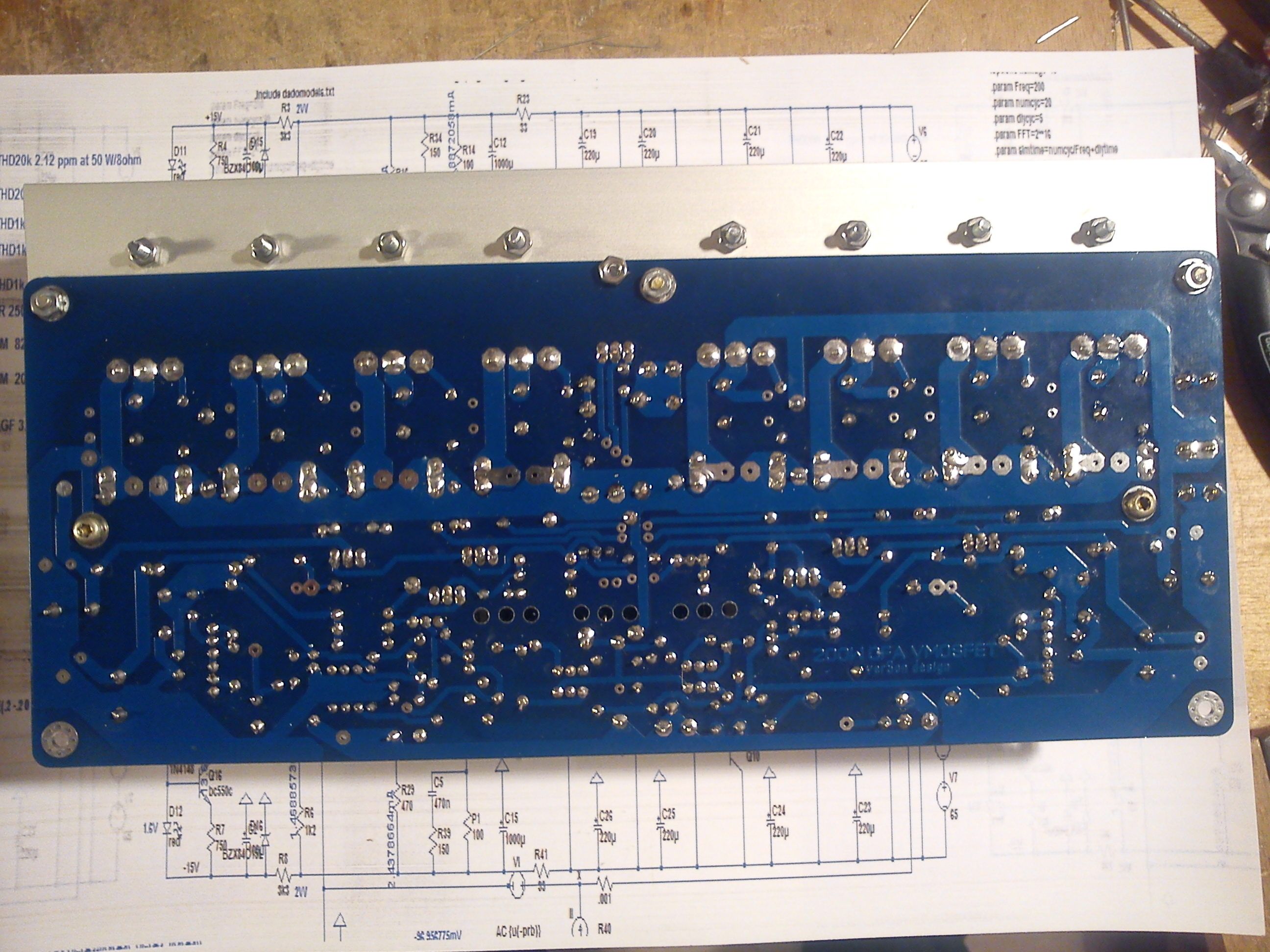

Nice boards Vamir! Shouldn't there be holes for the mosfet mounting bolts?
I wonder about the amount of heat at the edge of the angle bracket used to carry the output device heat to the main heat sink. Has anyone ever measured the temperature here?
Have fun
The PCB is narrow to get lower price, as the pcb price is per square cm (mm). The mosfet mounting holes are on the alu angle bracket only. With this amp I did not measured the temperature at the full power yet, but my other amp (TT amp) reaches 50 to 60 degree Centigrade on the alu bracket.
Damir
First proto board had to much layout errors and I ordered new boards with corrected errors. With the first board(corrected with some cut and wire) I tested the concept and it worked so now first channel with new board is ready. Next I have to assemble second channel and try it is stereo.
Here are the photos.
Damir

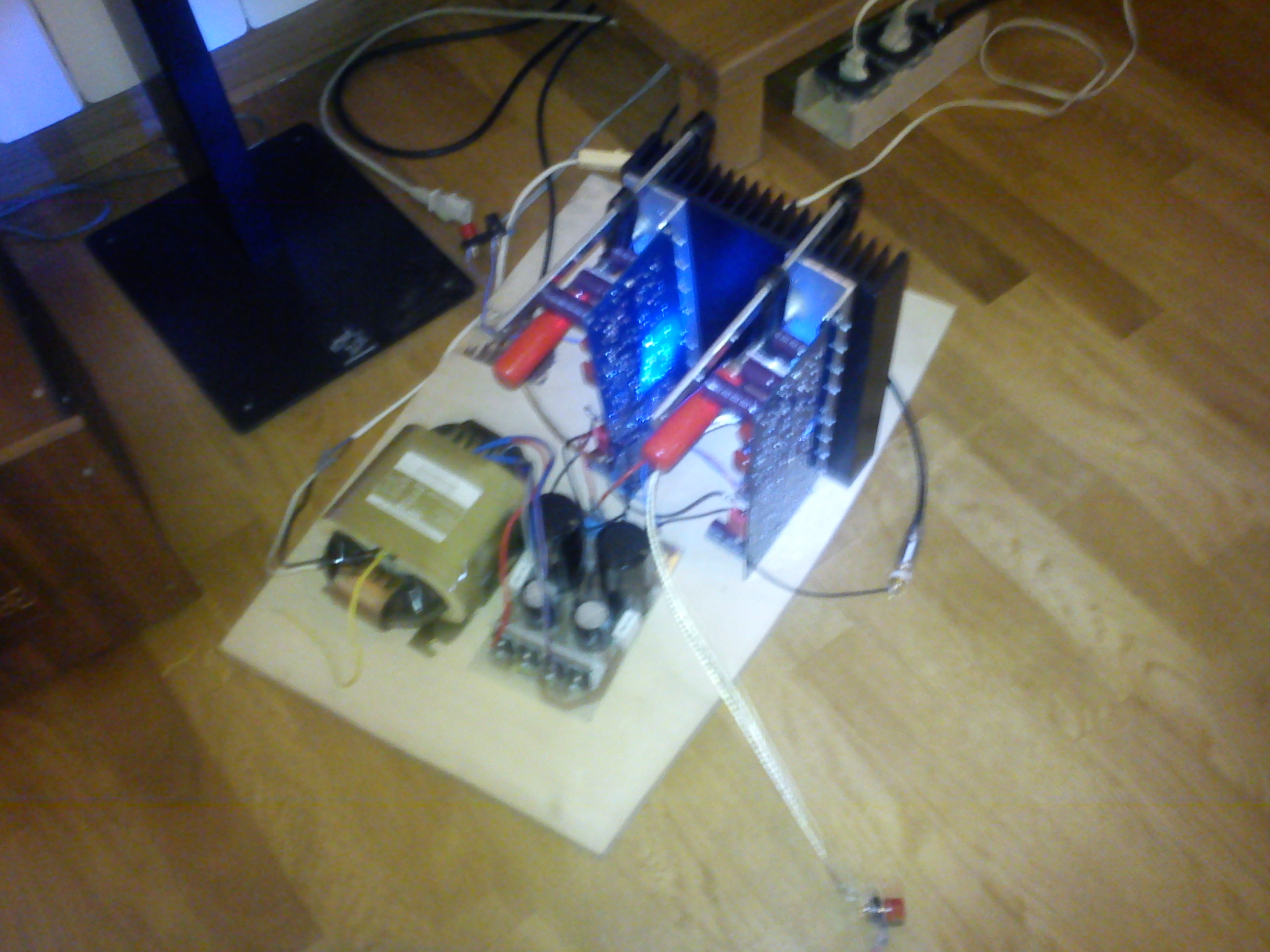

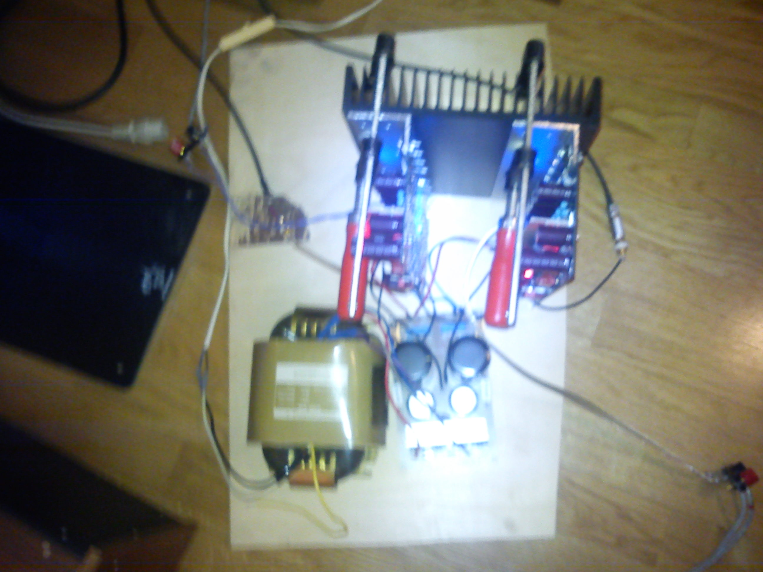

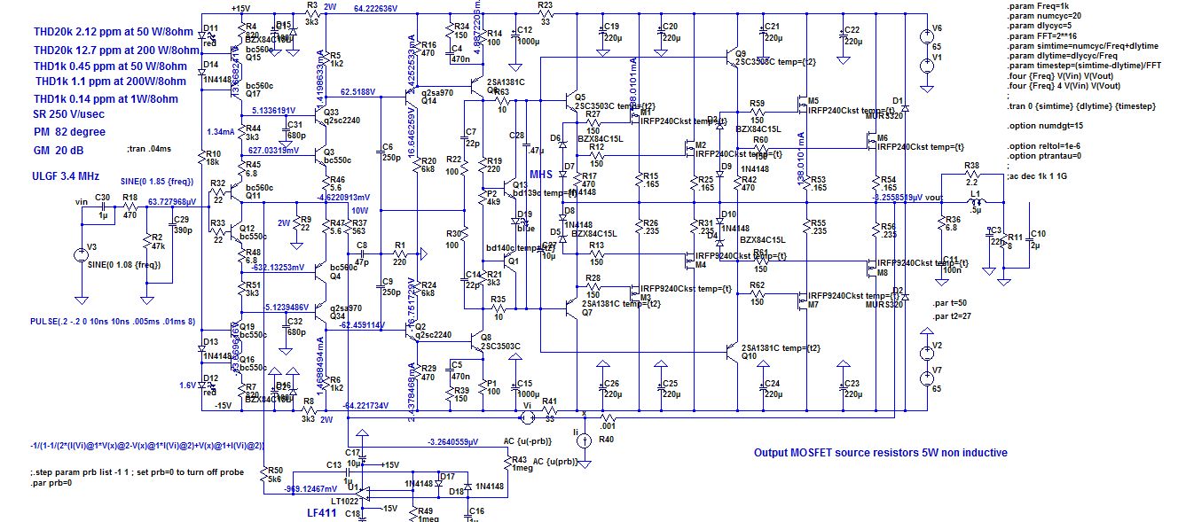

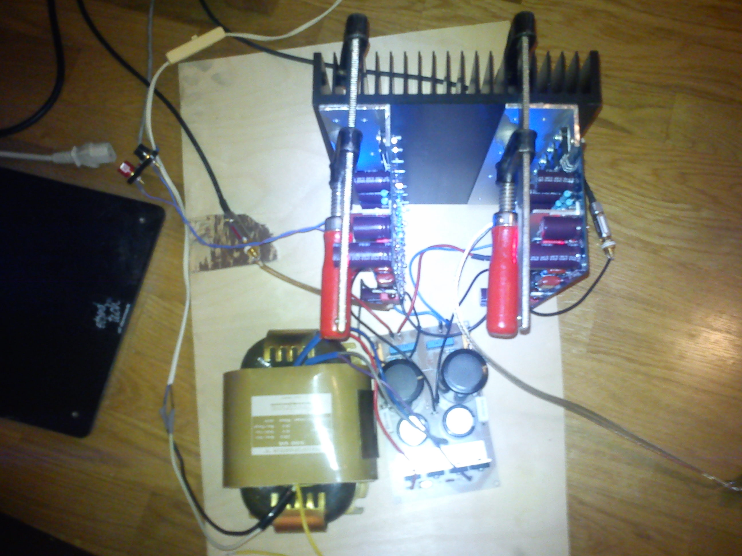

Listening 200W CFA VMOSFET amp
I did my first listening with two channel, stereo. The source was DVD player DENON 3910, the preamplifier was my GainWire mk2 in CFA mode, and the loudspeaker my design with long ribbon from NewForm Research and for the woofer 8 inch carbon/paper from Scan-Speak in closed box.
I was listening Patricia Barber on CD and Sara K. on SACD.
Two channels where powered from 500VA transformer and 2x 25000uF, so actually not enough to get full power from the amp.
First impression was total silence when I switched it on, no hum no any noise even with my ear close to the loudspeaker, and all that with wild wiring as could be seen from the photos.
What about music? It was marvel, great dynamic with punchy bas, clear middle in heights, excellent stereo image. It should even improve after electrolytic caps settled.
This is my design and it's not easy to write about it, but still I am impressed with this amp.
It uses cheap vertical mosfet, but different compensation I never found in other power amps. It is very stable with no hint of any oscillation.
Sorry for bad photos, I used my mobile phone quite old.
Damir
