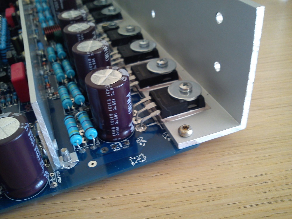

Ah, nice to see the fruits of ones labour, enjoy cheers rick

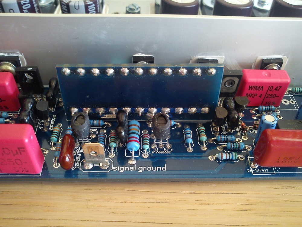

Congratulations. now we know it works and works great. I am ready to buy boards and parts.
OK lets get some boards made and let everyone enjoy the singing of your amp.
Great work Damir
Thank Chris, I will prepare detailed schematic and BOM next days. I have six spare boards and if there is going to be interest I can order some more.

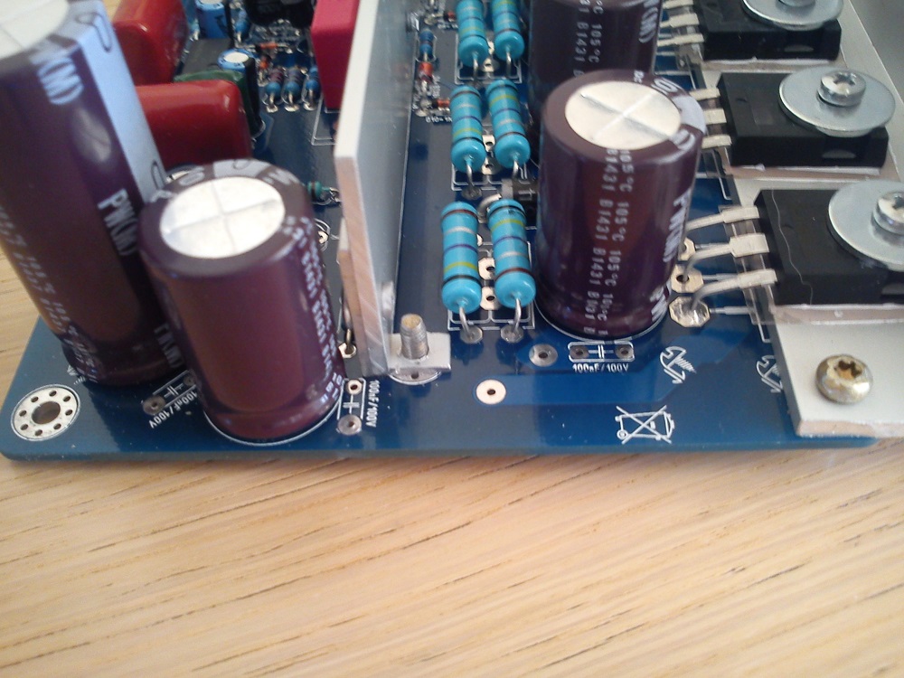

You are right about two transformers, but the problem is, one I have gives +-50 DC after the caps and for this amp to get full power I need +-65 DC.
I intended to use two PS regulators similar to one I use with my TT amp but with the VMOSFET as the regulated transistor and In this case is the same if I use one or two transformers, but one is cheaper even od double VA.

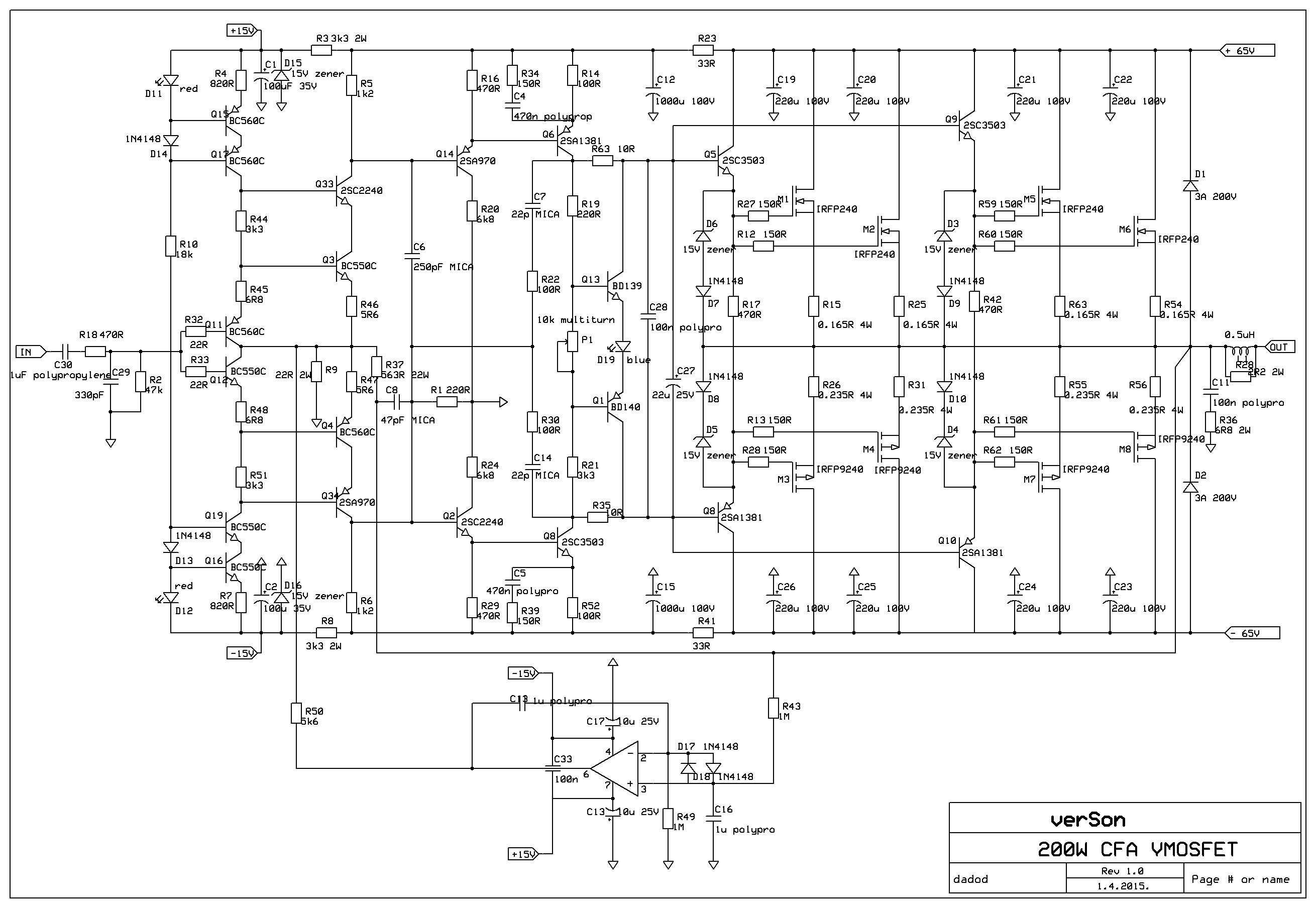

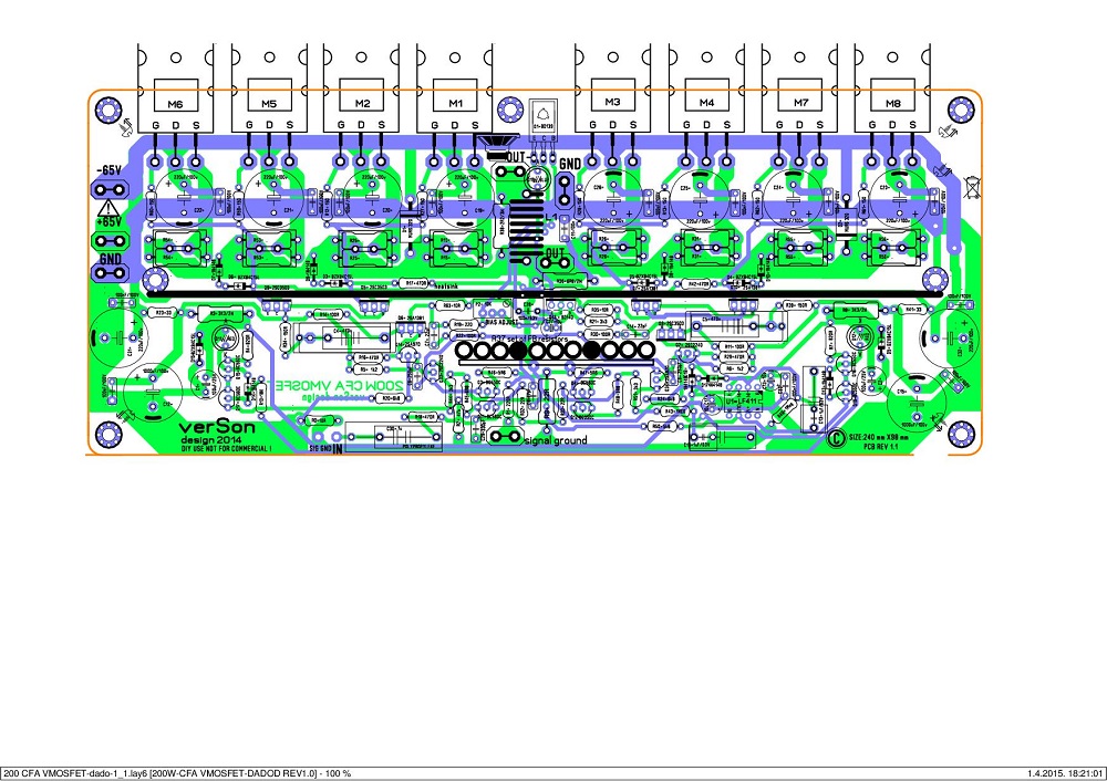

Updated schematic, PCB and BOM.

If i add more power mosfets in parallel to the output mosfets, the power will increase without effecting distortion and other specifications ?
And, how will the voltage variation of 100mV of blue LED effect the bias and the overall performance of the circuit ?
It was designed that one pair of the drivers drive two pairs of output mosfets.
I selected (matched) two blue LEDs to have the similar thermal behavior, and the LED voltage drop at 5mA was 2.75 to 2.77 V. With that LED the output bias current increased some during warm-up and than stayed stable with quite hot main heat sink.
All LEDs are blue ? Bom says 2 red 1 blue.
5mA, means you probably use 5 MM LEDs. It is relatively a too low current for BD139-140 . What is the reason to select such a high power transistor for a lowcurrent ?
So, people who wants to make this ampli have to match LEDs too ?
Sorry for many questions.
Two red LEDs and one blue LED(in the Vbe multiplier) all 3mm. Better to do some LED matching, nothing critical.
The VAS current is 6mA about, and BD139/140 are chosen because of the TO126 case, to fix them to the heat sinks.
Your question about LED was not clear to me.
Updated schematic
Hi Damir
Q6 and Q8 drawn incorrectly I think.
And is C6 in the correct place or does it need a partner?
Nice to see the finished amp.
And is C6 in the correct place?

Thank you David, I always make such stupid mistakes. Corrected schematic added.

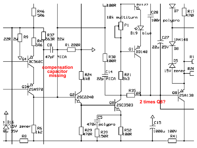

P.S.: found some errata on your circuit drawing. See attached picture.

Thank you Toni for finding some of my always present errors.
I will do as you suggested, add the link in the first post to the post with correct sch bom and asc files.
