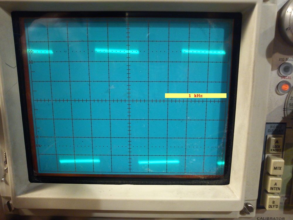

V/div ? Load? With input rfi capacitor?

As I don't have good enough power supply it was just 1 V/div, 8 ohm load and input filter and input cap as in schematic.

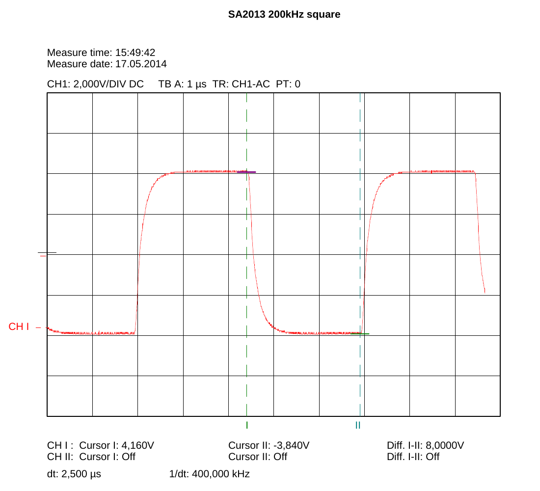

Dear Damir,
either your input square wave isn't good/sharp enough or your rfi filter is a bit strong. Your 20kHz square wave figure looks like my 200kHz small signal figure (2V/div) of my 2stageEF with 8R load, output zobels and input rfi capacitor.
Can you check this?

Toni, you are right, my function generator is very poor one. I have built it many years ago with one chip(don't remember now the name) and output from that generator is just the same as the output from the amp. That why I don't show square wave test to often as it does not show much of the tested amp. I just wanted to show that there is no overshoot. I think that is time to invest some in that direction, not sure how good are those quite cheap function generator on ebay?

Is your scope's trace always that thick? Otherwise, there might be some high frequency content. Is it also that way at the sig gen output, without the amp connected?
You could crank the timebase up to its fastest sweep speed, and set the v/div low, to attempt to zoom in on the top or bottom of just one of the square wave traces.
This is my scope non focused trace, I can't find a time to do some maintenance on it.

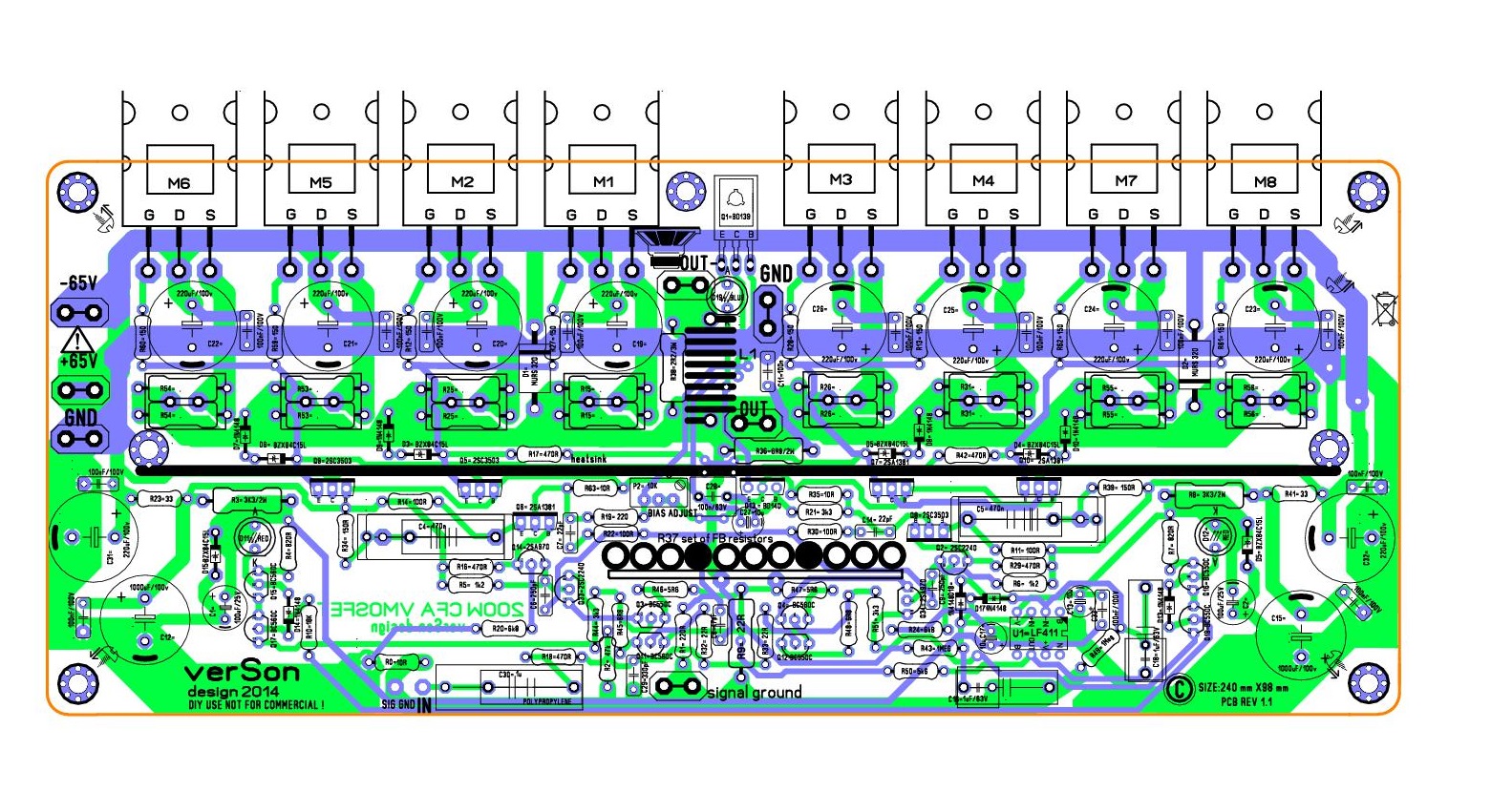

Chris and Toni will receive the PCBs in next days and here are corrected schematic, BOM and the layout.
Some errors exist on the layout where some components are with wrong values or wrong denotation.
1. All output mosfets gate resistor should be of 150R (R12, 13, 27, 28, 59, 60, 61, 62)
2. 1uF cap instead C13 should be C18.

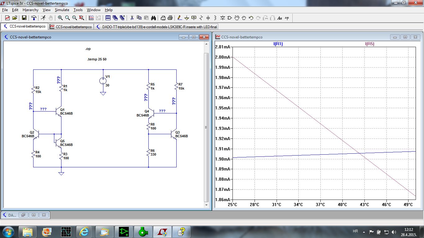

The CCS used in this amp is thermally very stable, but the current is dependent of the LED, and LED voltage drop can fluctuate a quite.
Here I suggest a novel (?) CCS, also thermally very stable but uses only bipolar transistors. It has lower dynamic resistance then ordinary feedback bjt CCS, but not much.

Hi Damir
That's a very nice current source!
Wouldn't the right-hand circuit be more stable without R8?
Have fun
Actually no, it's the same, R8 is there to get more headroom for sensing transistor.

perhaps I'm missing something in understanding #771, but, Dadod, would a fluctuation or noise in the supply voltage change the CCS current? Is this circuit requiring a highly regulated, low noise supply? What would the current I(R1) be if the supply is elevated from 30V to 40V? If the current changes with voltage, perhaps it is no longer a CCS? Too many questions from me. Thanks.

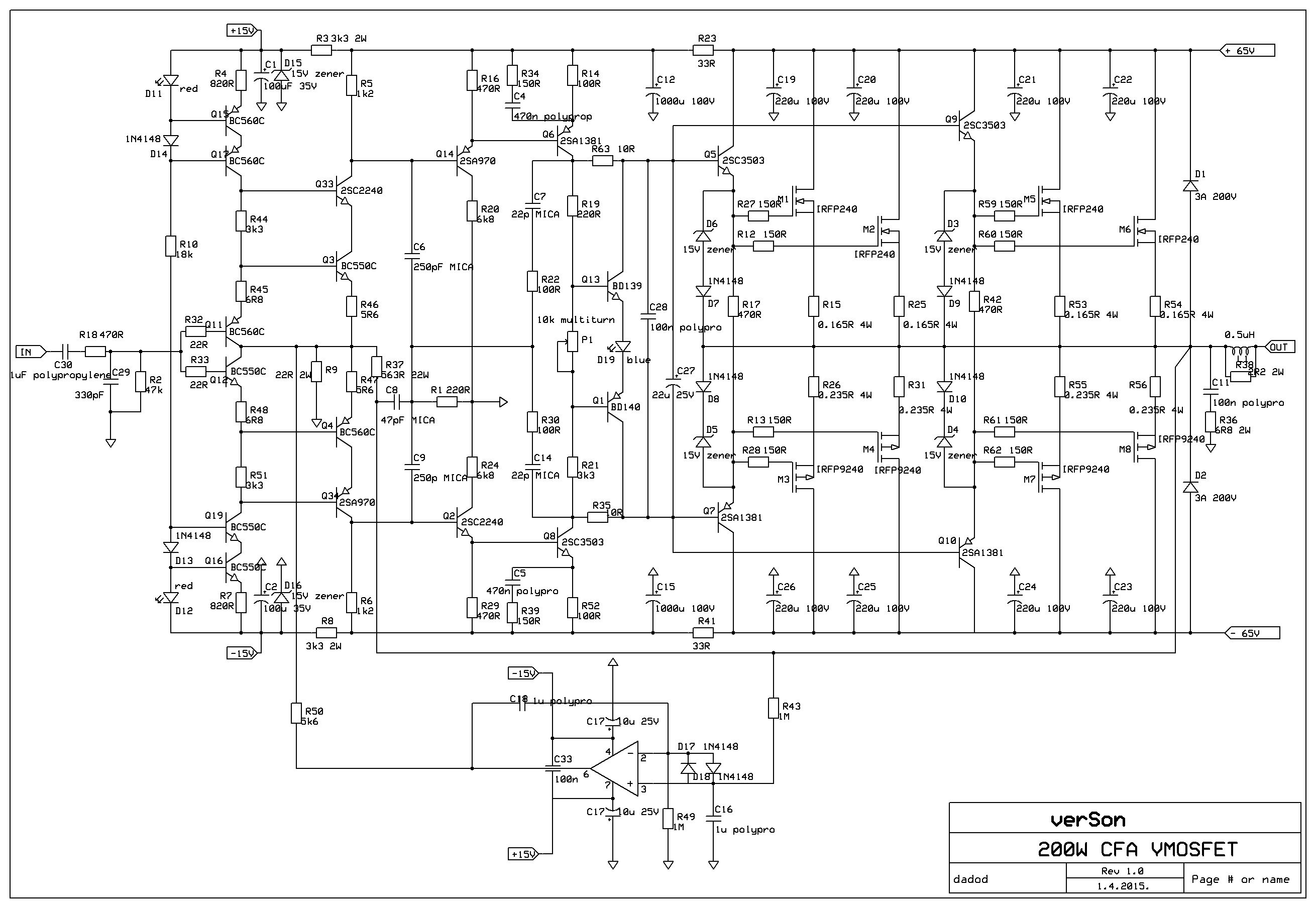

Yes you are correct. I was thinking to use this "CCS" with stable supply voltage as in this 200W CFA where input stage uses +-15V stabilized by zener.
