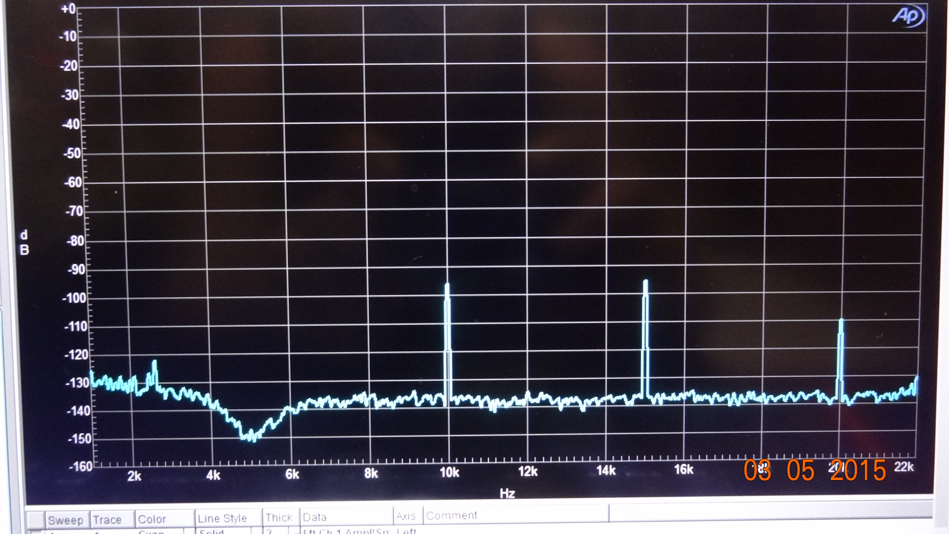

10KHz --
With the heat sink added..... same everything.... the 2H is lower now.... <-100dB as I could leave it on and OPS bias stablized at higher level.
(OPS device Temp = 50C during test).
10KHz --

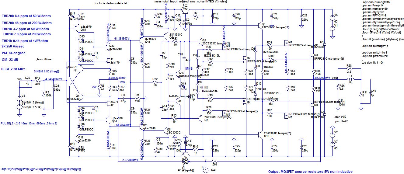

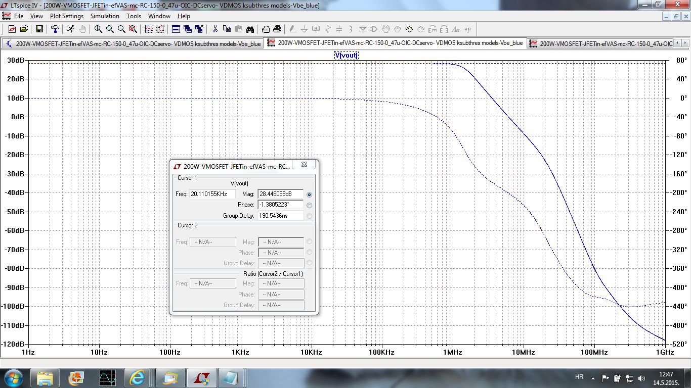

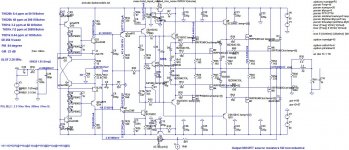

200W-CFA-VMOFET-jfetIPS
Here is a variant with complementary JFET input. No diamond nor supper pairs. The THD is higher but still quite low. IPS is bootstrap cascoded. Instead input CCS could be used simple resistor with no significant degradation. Two transistor used to isolate bootstrap from the fets current increase PSSR.
Damir

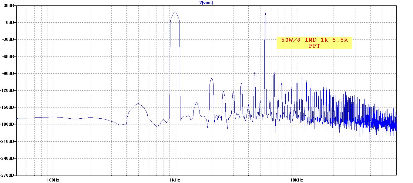

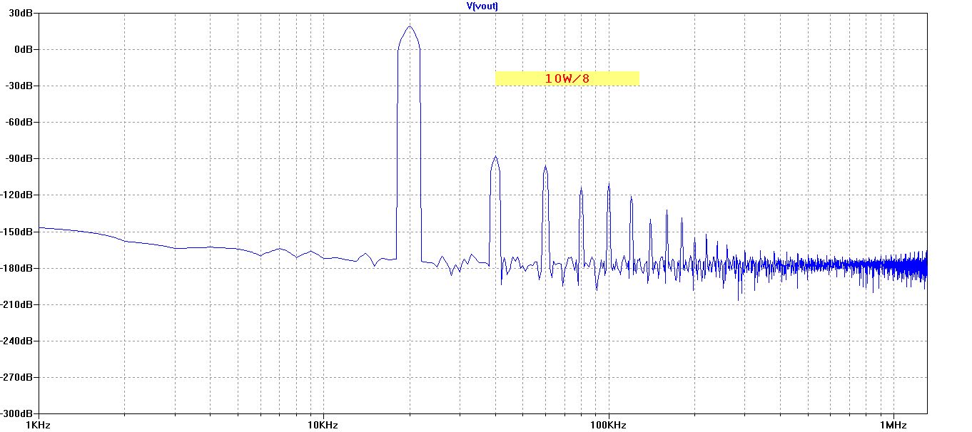

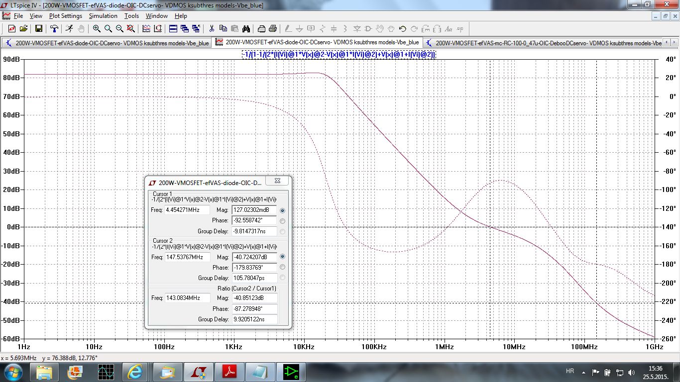

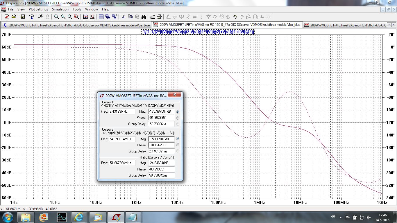

200W-CFA-VMOSFET improvement
I improved and simplified this amp in the same time with very small changes. The VAS emitter resistor was replaced with a diode, the RC across that resistor removed, and R5 and R6 increased from 1k2 to 1k33.
The Loop Gain is now 82 dB from zero to 20 kHz.
THD20 improved.
THD20k for 50W/8 dropped from 2.12 ppm to 1.5 ppm
THD20k for 200W/8 dropped from 12.7 ppm to 4.55 ppm
THD1k stayed almost the same
PM stayed the same, but GM increased from 20 dB to 40 dB
ULGF increased from 3.4 MHZ to 4.45 dB
Parallel to the output added 22 nF
Best thing is that the same PCB can be used, just some element changed and some removed.
Damir
  • 200W-CFA-VMOSFET-BOM-1.1.txt

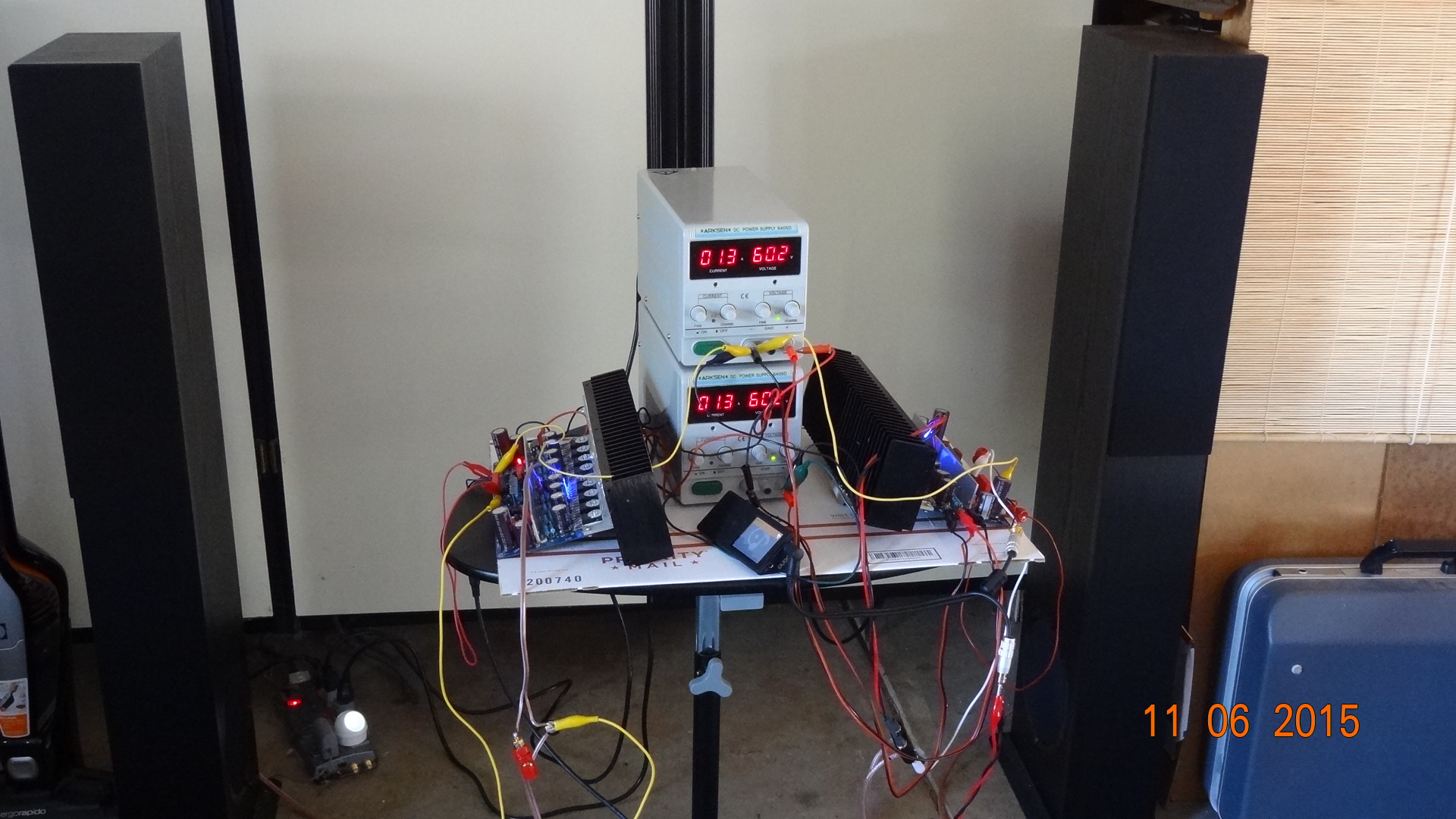

I'm not sure if I have the latest amp changes you just mentioned above.... but when connected to heat sinks and speakers, it is extreamly clear and detailed sounding on good speakers. Great sound stage clarity. The quality of the sound really comes thru. Now I will have to listen on even better speakers and clean up the mess of power/ground wires. The transients are sharp, quick and clean.... very nice !! I'm getting excited.
The heat sinks are still too small, though.
