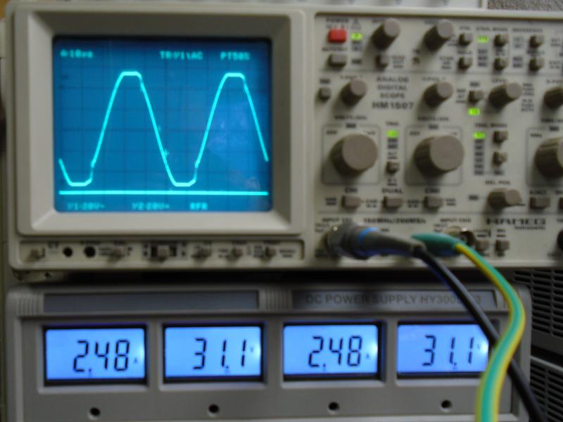

I'm using the RC combo - the cap is mounted on the solder side. HAve a look at the 2nd picture.
Using the diode variant the VAS current increases very fast above 100mA so I stopped using the BOM V1.1 variant and reverted to BOM V1.0.
BR, Toni

That increase was with thermaly coppled input supper pairs?
Can you tell what the VAS current is now?
BR Damir
Yes! It increases with increasing supply voltage very fast - above +/- 15V more as 100mA.
BR Damir
@ +/- 62V stabilized power supply:
VAS current is ~ 8.5mA
Bias 550mA total
Noise referred to 37.5V RMS / ~ 180W @8R
111dB unweighted/full bw
116dB 80kHz bW
117.5dB 20kHz bw
122dB A-weighted
IMHO really good values!
VAS suffers from exactly same sticking (@20kHz) as my enhanced VAS VFA (SA2013/SA2014) be4 using the VAS diode.
Next time I will add 2 BAV21 across the VAS transistors to recheck sticking behaviour.
BR Toni

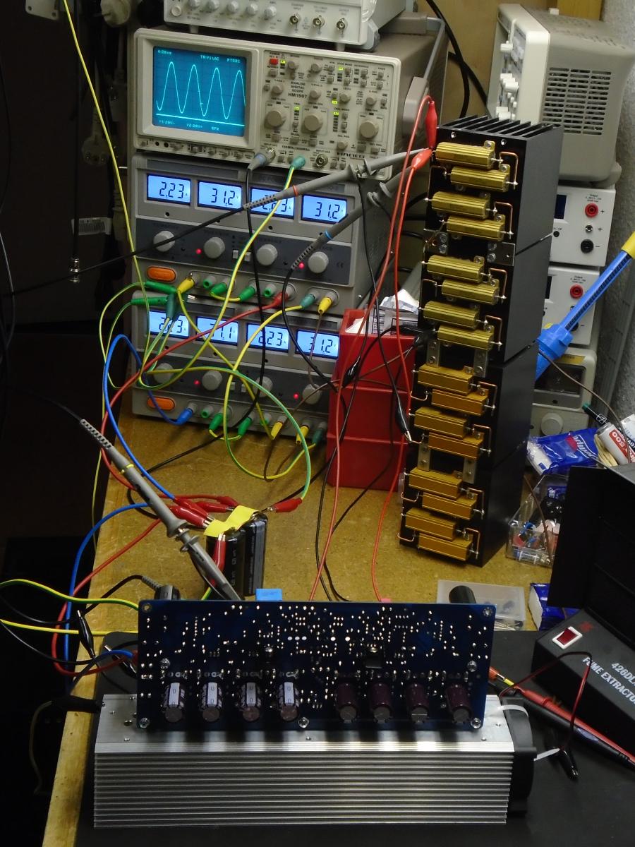

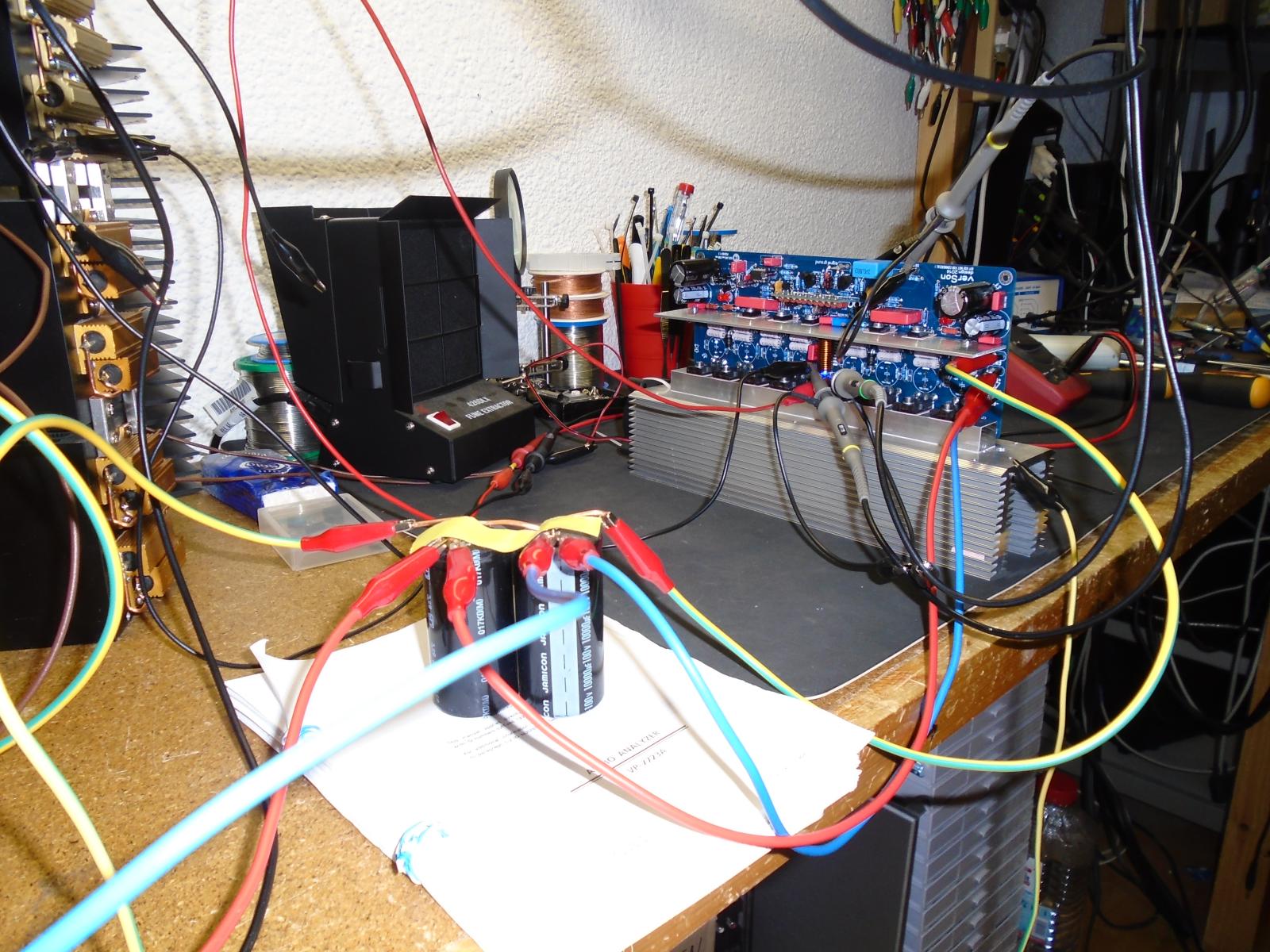

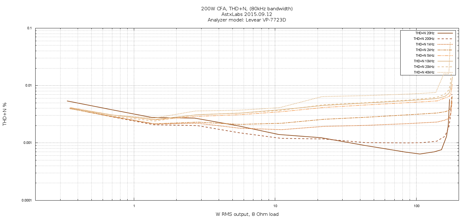

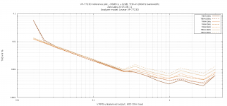

THD+N versus power on 8 ohm load
All measurements done with:
Attached the raw THD+N data points.
(measurement #; Hz; db level of signal generator @600R; Vrms on output; THD+N in %)
BR, Toni
- +/-62V stabilized power supply.
- Bias ~450 to 500mA
- 8R resistive load
- VP7723-D (set to 80kHz bw range)
- THD+N plot
- test setup
- test setup
- test setup (20kHz measurement, ~ 170W@8R)
- 200kHz small signal square wave
- reference plot of VP7723-D audio analyzer
BR, Toni

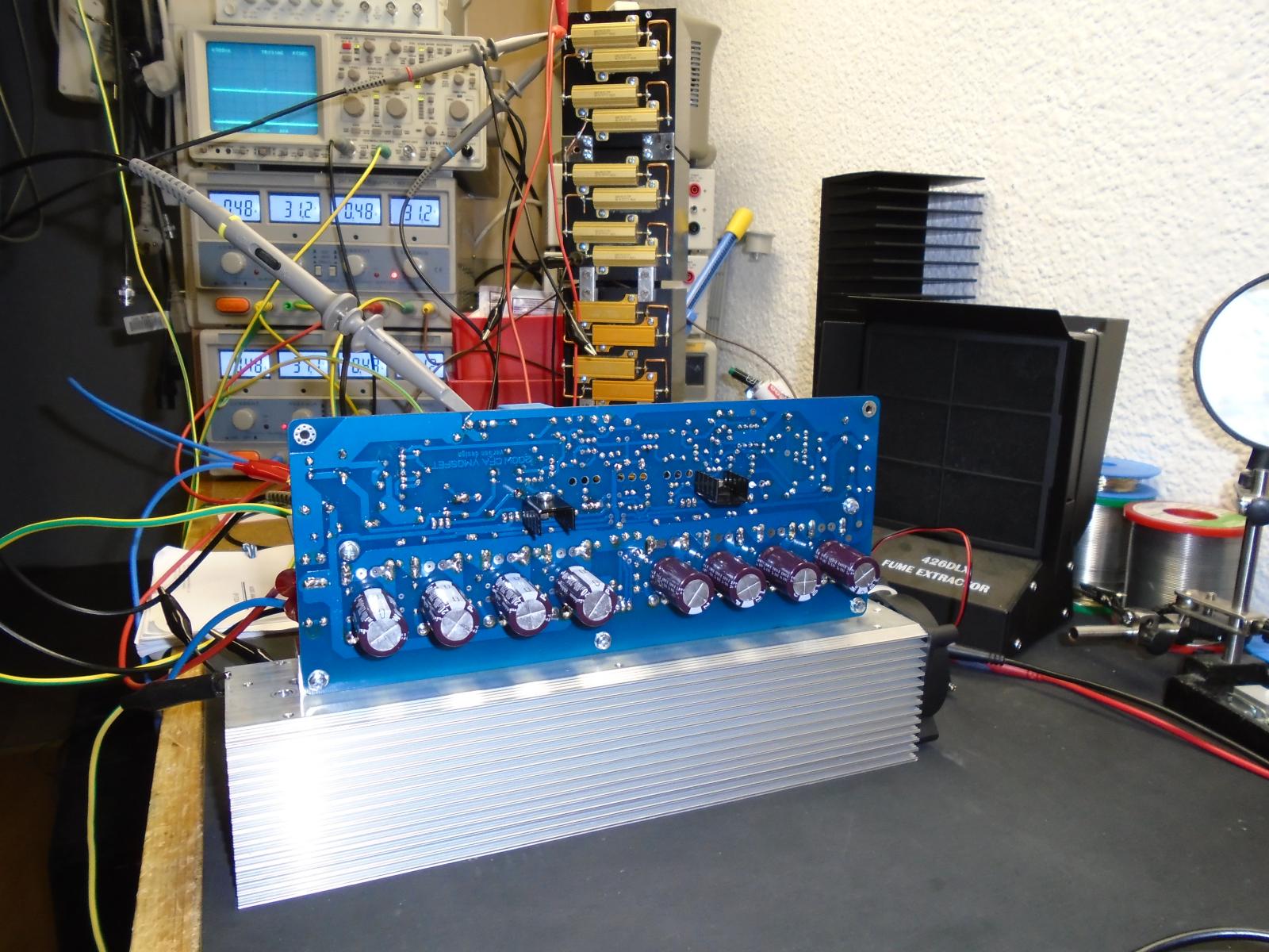

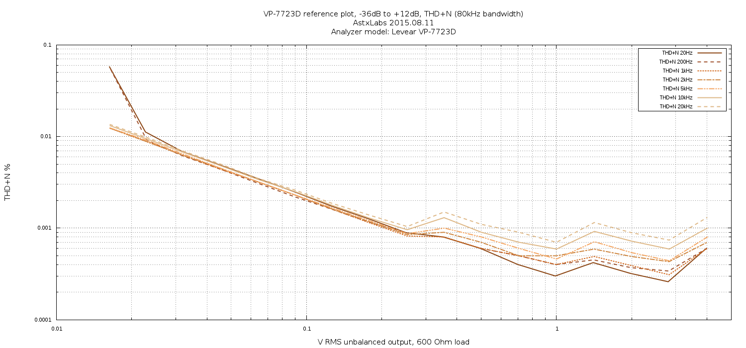

Hi Toni,
I like your test setup. I see that you soldered the OPS elcos from the back side, I suppose because the way the output transistors are fixed to the heat sink, to be away from the heat.
I can see that THD is higher at low output power, it is because how the analyser THD is higher at low output I suppose?
When you are going to do first listening?
BR Damir
Dear Damir,
the lower power values should be read "as good or better as". So values below 2 W output power would be better as shown in this plot.
The analyzer has its sweet spot from -12db to a maximum of +12db output. Today you will get a THD+N plot with lower output power where I use a 10db input divider to drive the analyzer at better/optimized output levels.
The capacitors are mounted on the back to be able to replace the output mosfets if damaged. If you someday decide to redesign the pcb may I place here some whishes:
About listening - I'm afraid I can't do that with highest quality because I drive my speakers with active Crossover - therefore I would need 4 amplifiers ...

Dear Toni,
Some of your suggestion I already included in 1.2 rev.(never ordered PCB yet), like moved RC combo away from small heat sink. I dont have my PC with me and cant check for MCP7, but there is possibility to use wirewound source resistor(not sure if 9mm footprint). I prefare here to use 1% 2W metal film resitors (easy to order from China). I'll check for VAS heat sink.
BR Damir

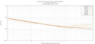

... attached the lower power tests where the analyzer is better driven at its sweet spot.
For this test results compare with the VP7723D reference plot some post above. In the middle of the VP7723D plot starts the -12db and ends with +12db on the right side.
IMHO all very good values. Hopefully you will provide a redesigned pcb 😉.
Have fun,
Toni

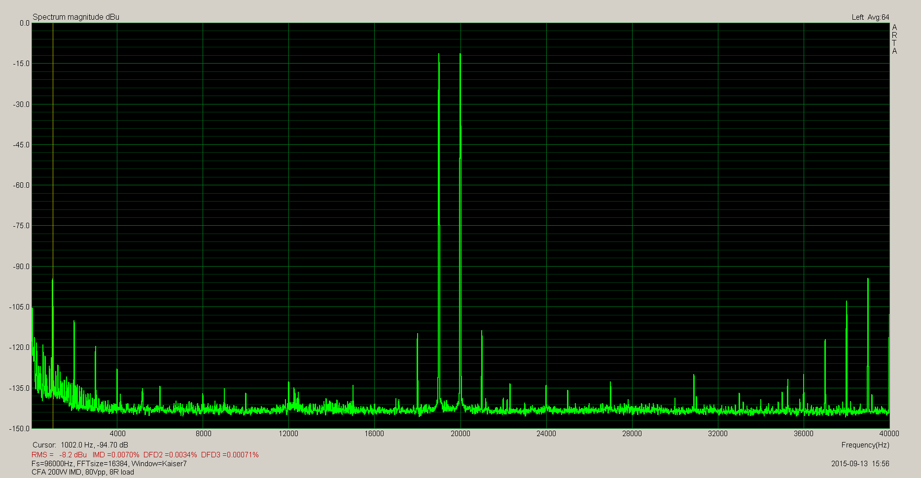

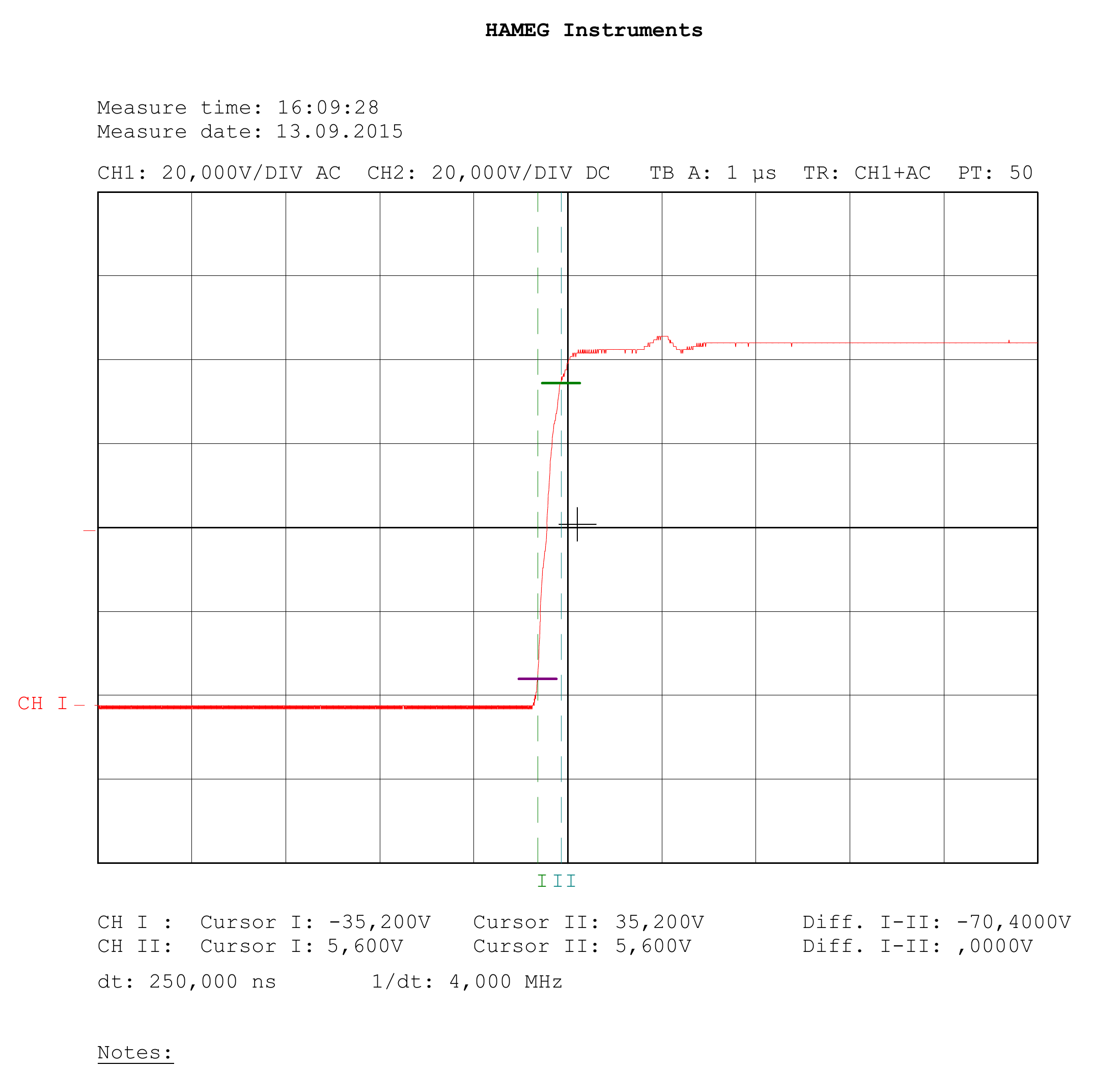

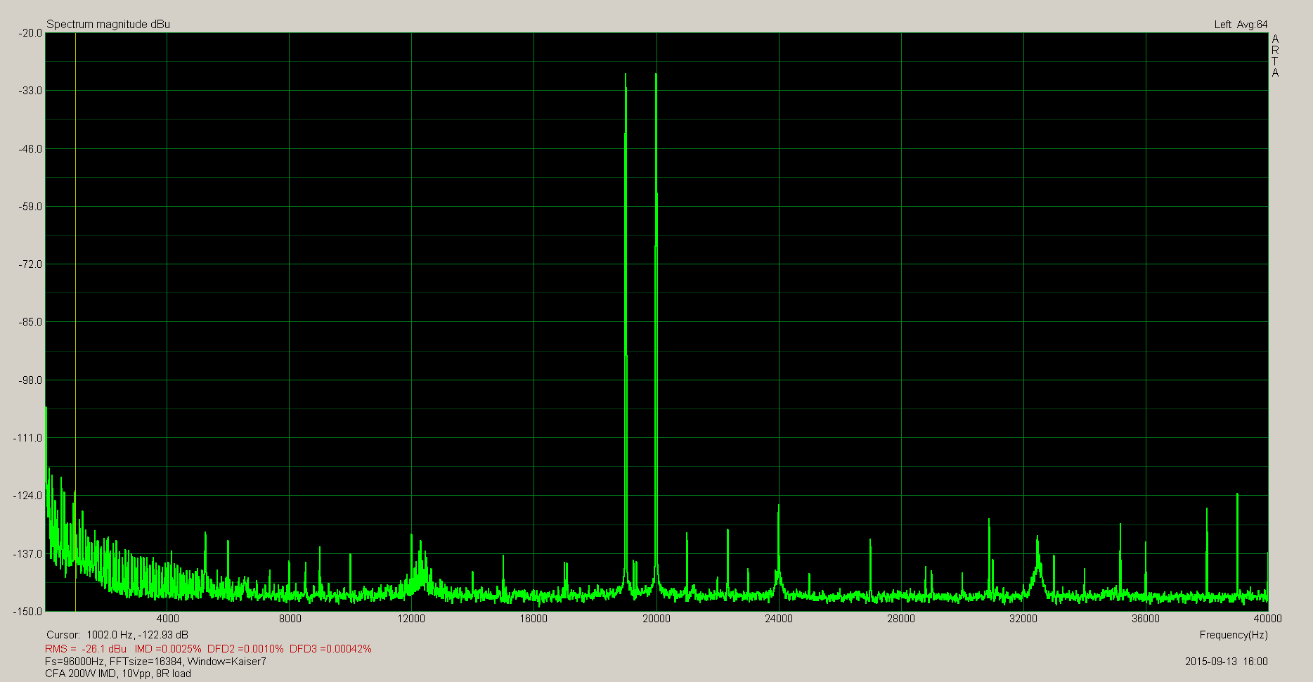

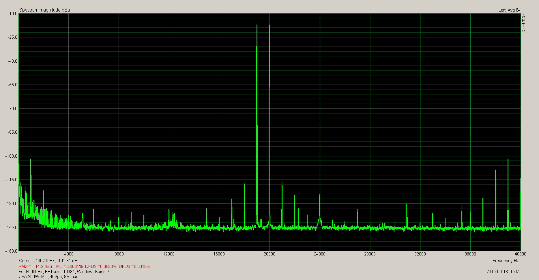

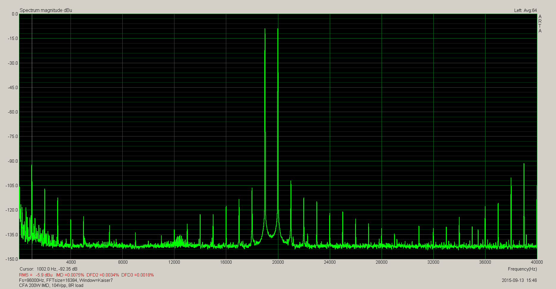

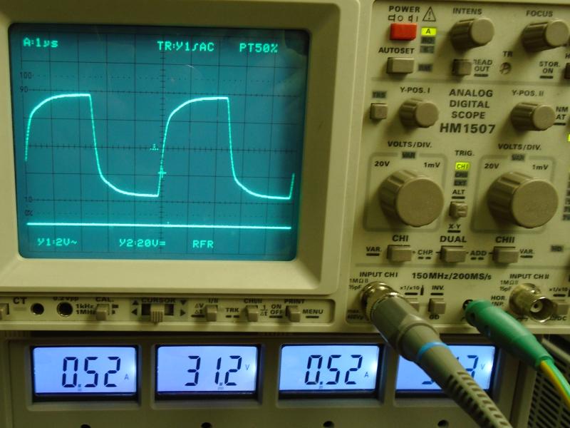

IMD and stability tests ...
IMD from left to right:
Stability checks:
All measurements taken with 8R resistive load.
BR, Toni
- 0.0025% @ 10Vpp
- 0.0039% @ 20Vpp
- 0.0061% @ 40Vpp
- 0.0070% @ 80Vpp
- 0.0075% @ 102Vpp
Stability checks:
- 10kHz square rising edge (slew: 70V in 250ns ~ 280V/µs)
- 10kHz square falling edge (slew: 70V in 375ns ~ 200V/µs)
- 1kHz sinus mixed with square be4 clipping pos.
- 1kHz sinus mixed with square be4 clipping neg.
BR, Toni

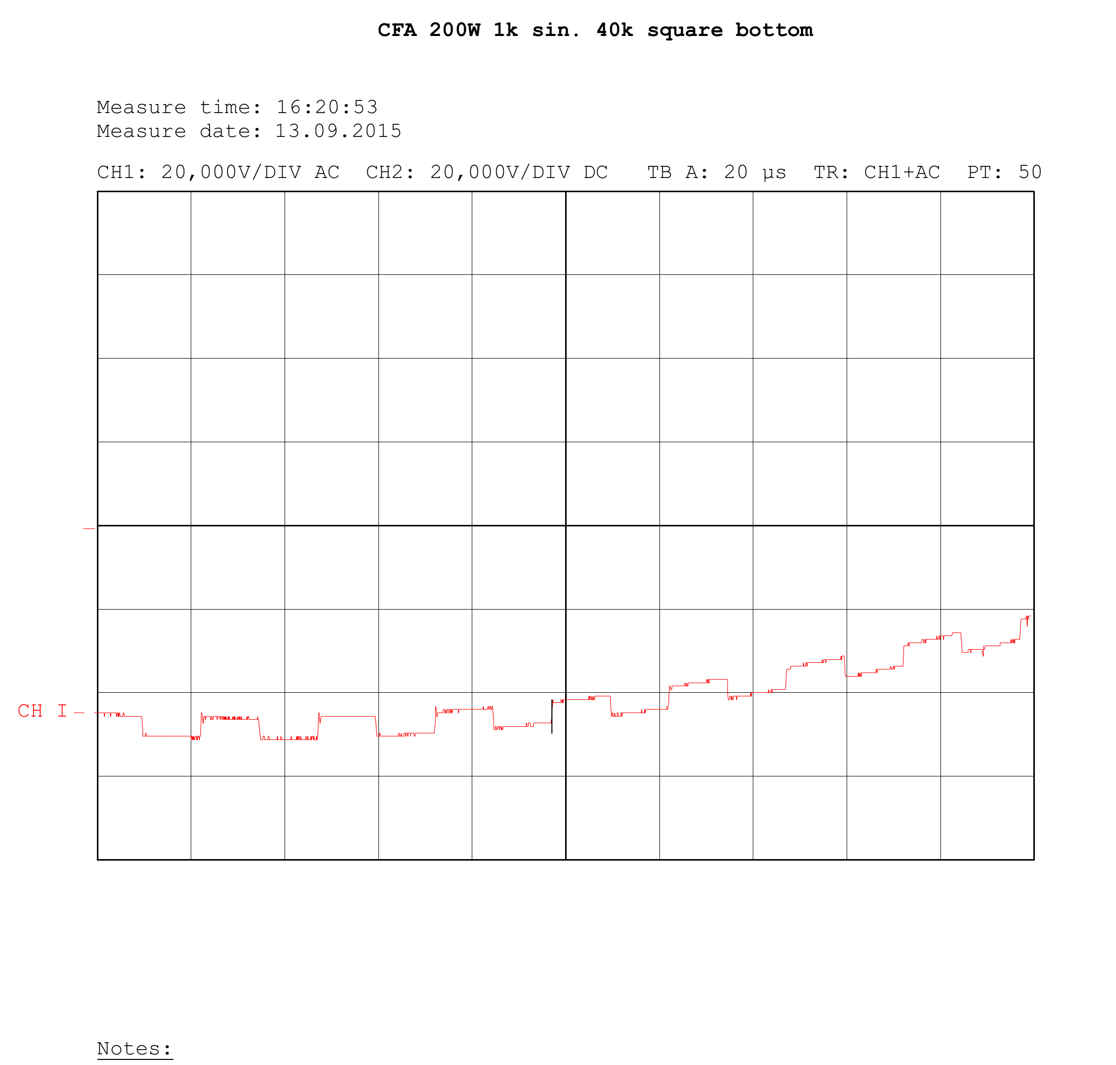

all with 8R LOAD
- 0.0025% @ 10Vpp
- 0.0039% @ 20Vpp
- 0.0061% @ 40Vpp
- 0.0070% @ 80Vpp
- 0.0075% @ 102Vpp
Stability checks:
3. and 4. shows some small signs of instability/oscillations just be4 clipping. Nothing dramatically. Maybe betters using a 47nF/4.7R zobel also at speaker output terminal. Maybe betters using a VAS-diode.
BR, Toni
