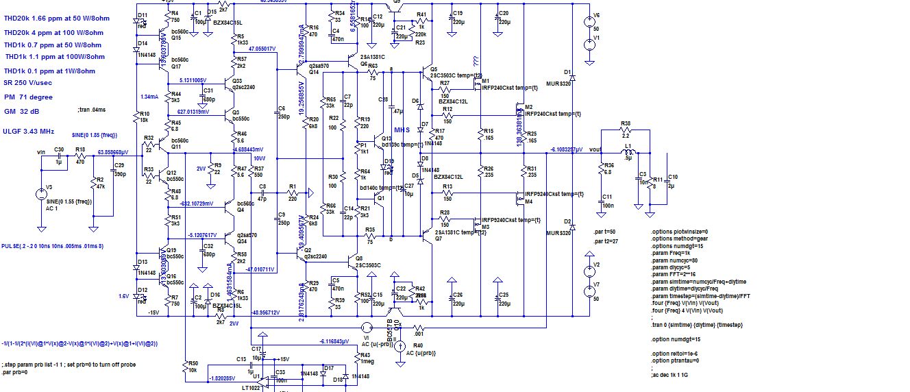

Have you put a schematic up that has the expected voltages on it for the front end? Thanks
Chris, it is here.
Damir
Chris, it is here.
Damir
There is one thing that puzzles me about this diagram.
F.ex. on the positive side, the GS voltage protection zeners D6 & D3 are connected to the emitter followers Q5 & Q9
I think that if the output is shorted to ground with signal on the input, the lack of feedback signal will force Q6 to conduct fully and draw the EF's to the rail, destroying either/both the EF's and/or zeners and also smoking the output devices when the zeners/diodes burns to open circuit.
The same happens on the negative side too.
Do you have any comments on this?
And is there any analyzes made of the consequences when the zener protection diodes comes into conducting?
Normally the VGS protection zener diodes are connected to the VAS outputs (Q6 & Q8) collectors and provisions should be made to limit the max current.

To be honest I never thought to much about this protection, just that it should protect the mosfet gates from excess voltage.
I simulated now with protection zeners connected to the VAS outputs and it looks you are right to some degree. The zeners will not be destroyed but still output current will be to high for the output mosfet.
Another advantage, I spare one set of the protection diodes in this amp.
Anyhow I am going to use my PS regulator incorporated with all needed protection for this amp.

Yes, but protection in the power supply can not protect individual smaller components that are overloaded and go up in smoke in milli-Seconds.
I see you have changed the value of R20 & R24 first from 220R to 6K8 and now to 15K0 and R16 & R29 from originally 680R to 470R, which results in a maximum possible -2Volt on the base of Q6 referred to the rail.
This restricts the peak current through Q6 to around 20mA (R34,C4 not accounted as they only works at higher frequencies), which is within the SOA limits for the C3503/A1381, so the zeners/4148's will also survive and everything seems to work that way.
Maybe the zener diode voltage can then be of a little lower value.
10-12Volt will probably do fine, to also limit the MOS-FET's peak current, before your power supply protection or fuses cuts in.

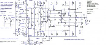

There s another non limited current path..
As pointed for another such design this path through Q6 is limited by a 130R total resistance, from ground through R22 and R46, then through Q3/Q33 collector/emitters and then through the base/emitter junction of Q14/Q6 and this latter s 100R degeneration resistance.
The cure is a few Kilohom resistance in serial with Q33/Q34 collectors, as can be seen in many old designs.

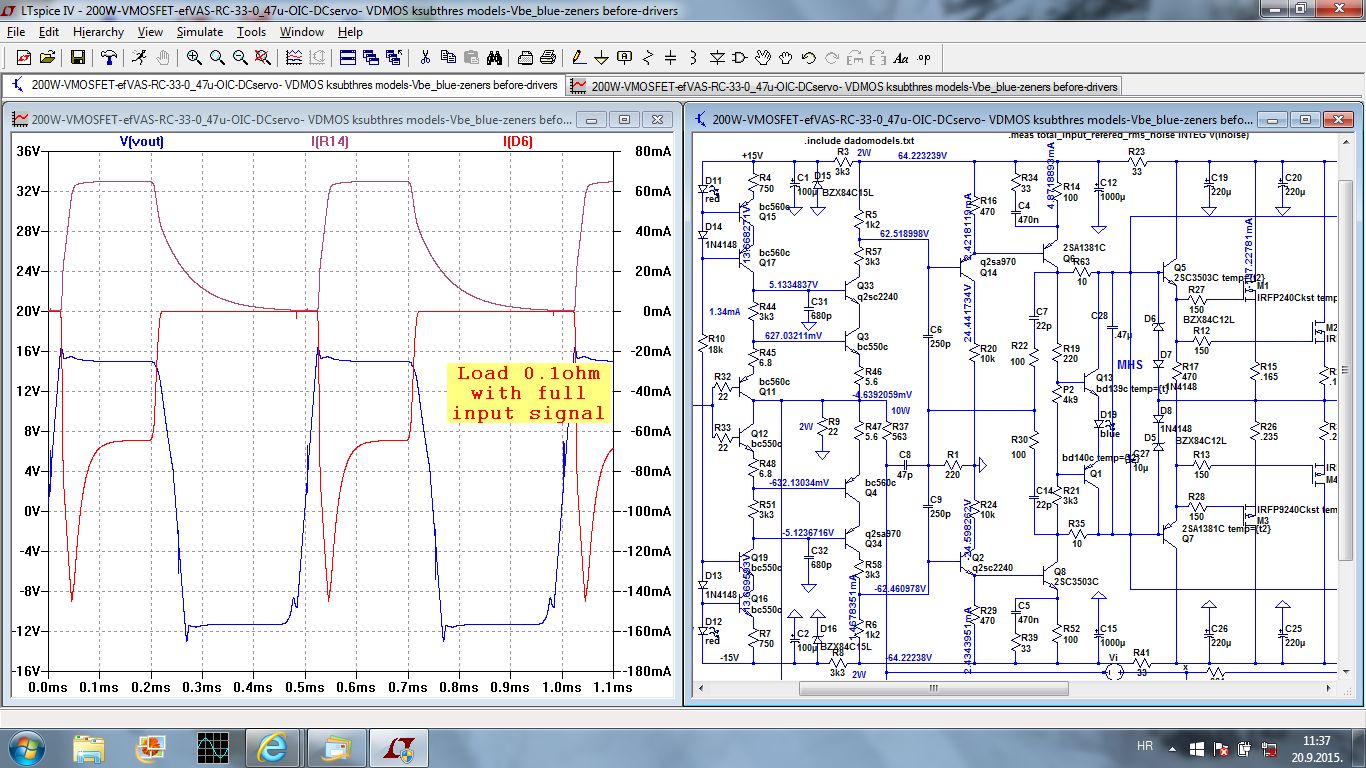

I think that now this amp has quite good protected against output short connection.
This plot shows the VAS and zener current with 0.1 ohm at the output and full signal at the input. Max MOSFET current is a bit more then 36 A.
I would like to thank all who came with suggestion how to do that.
Damir

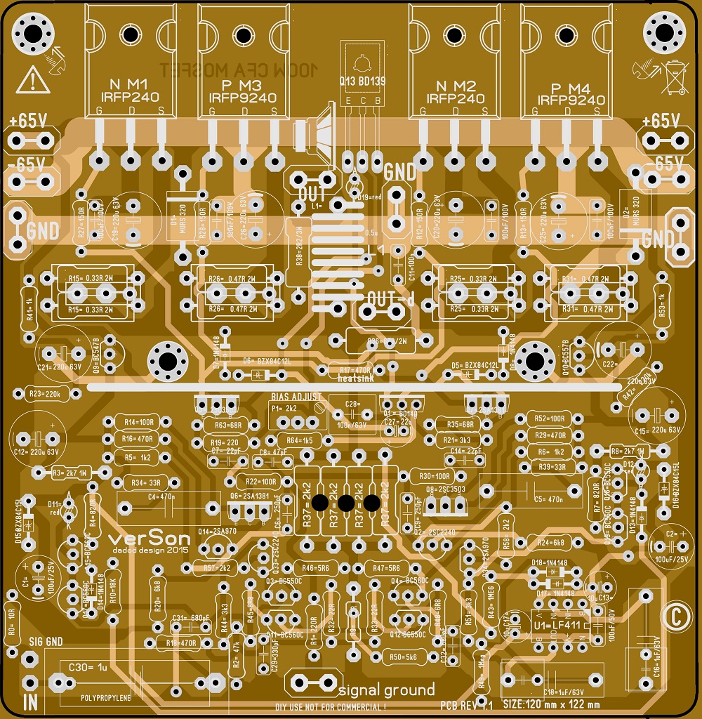

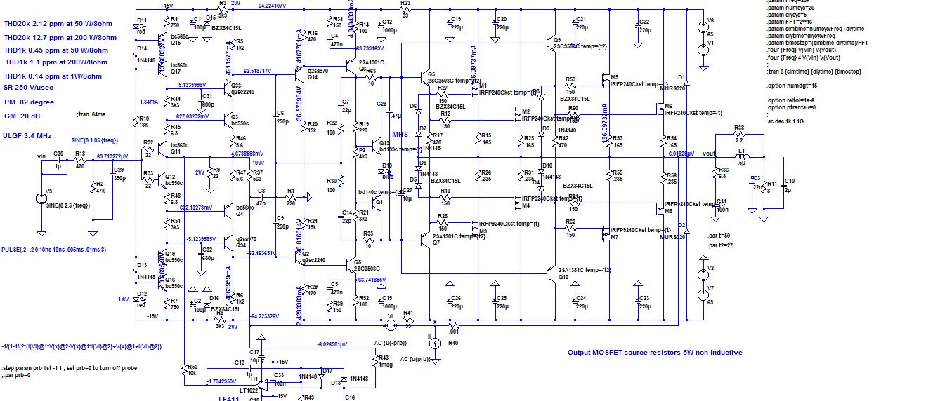

This is 100W/8ohm, 200W/4ohm version of the same amp. I think this power is very well suited for use in active loudspeakers, and of course for stand alone amplifier too.
I am ready to offer the PCB for this amp if there is going to be enough interested people, so let me know.
