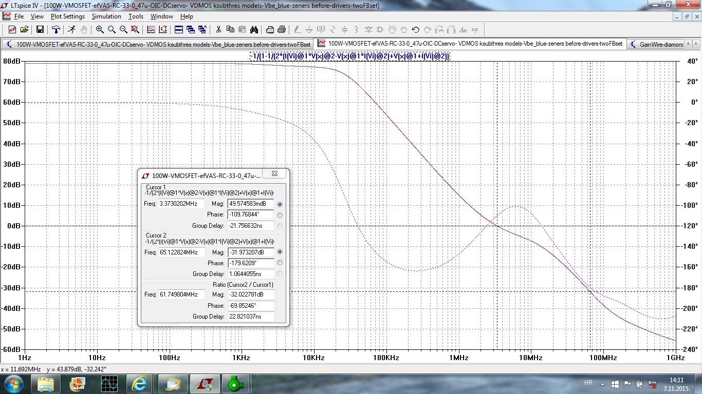

This is 100W/8ohm, 200W/4ohm version of the same amp. I think this power is very well suited for use in active loudspeakers, and of course for stand alone amplifier too.

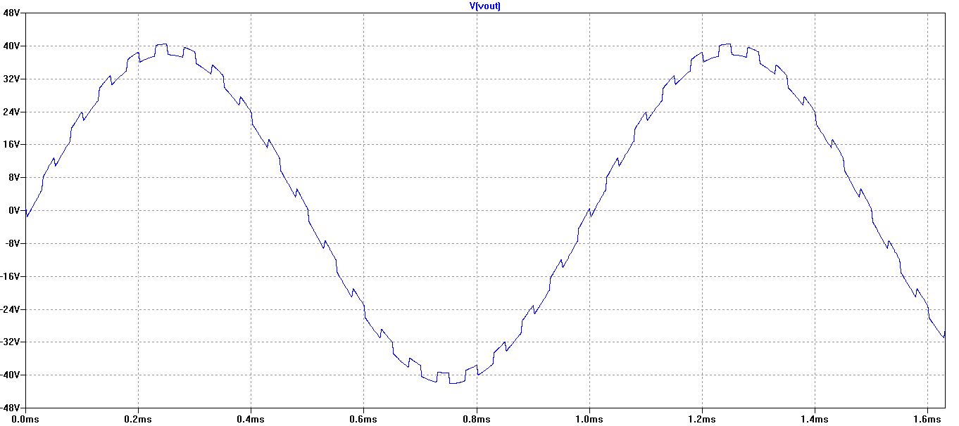

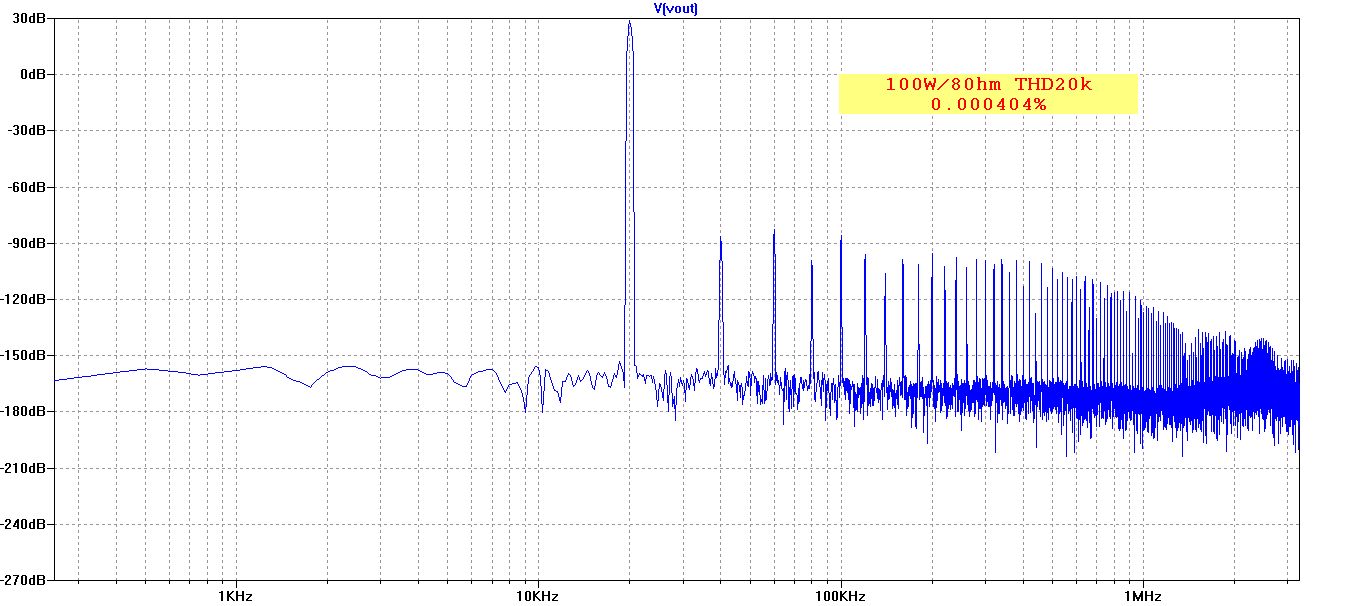

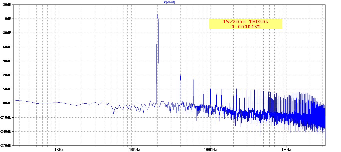

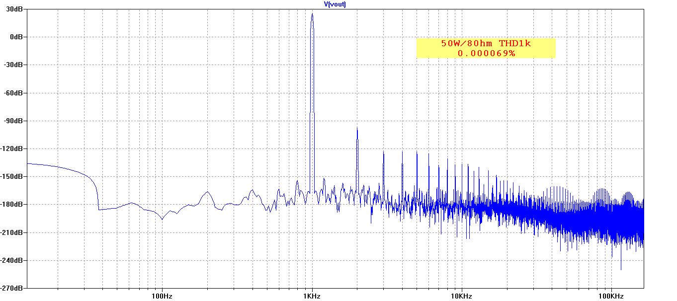

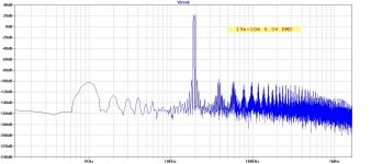

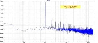

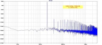

I will show some more plots, this is really excellent sounding and very stable power amp. I am listening to 200W version and this one has all attribute of the more powerful brother just half the output power.
Distortion is quite low and very uniform for all audio frequencies and all output power. Some people prefer low GNFB amps, but this one thanks to flat GNFB of about 80 dB up to 20 kHz achieves all that presented. I my opinion it's hard to bet this amp, and is quite simple to build with no expensive parts.

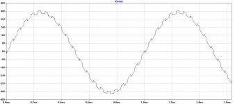

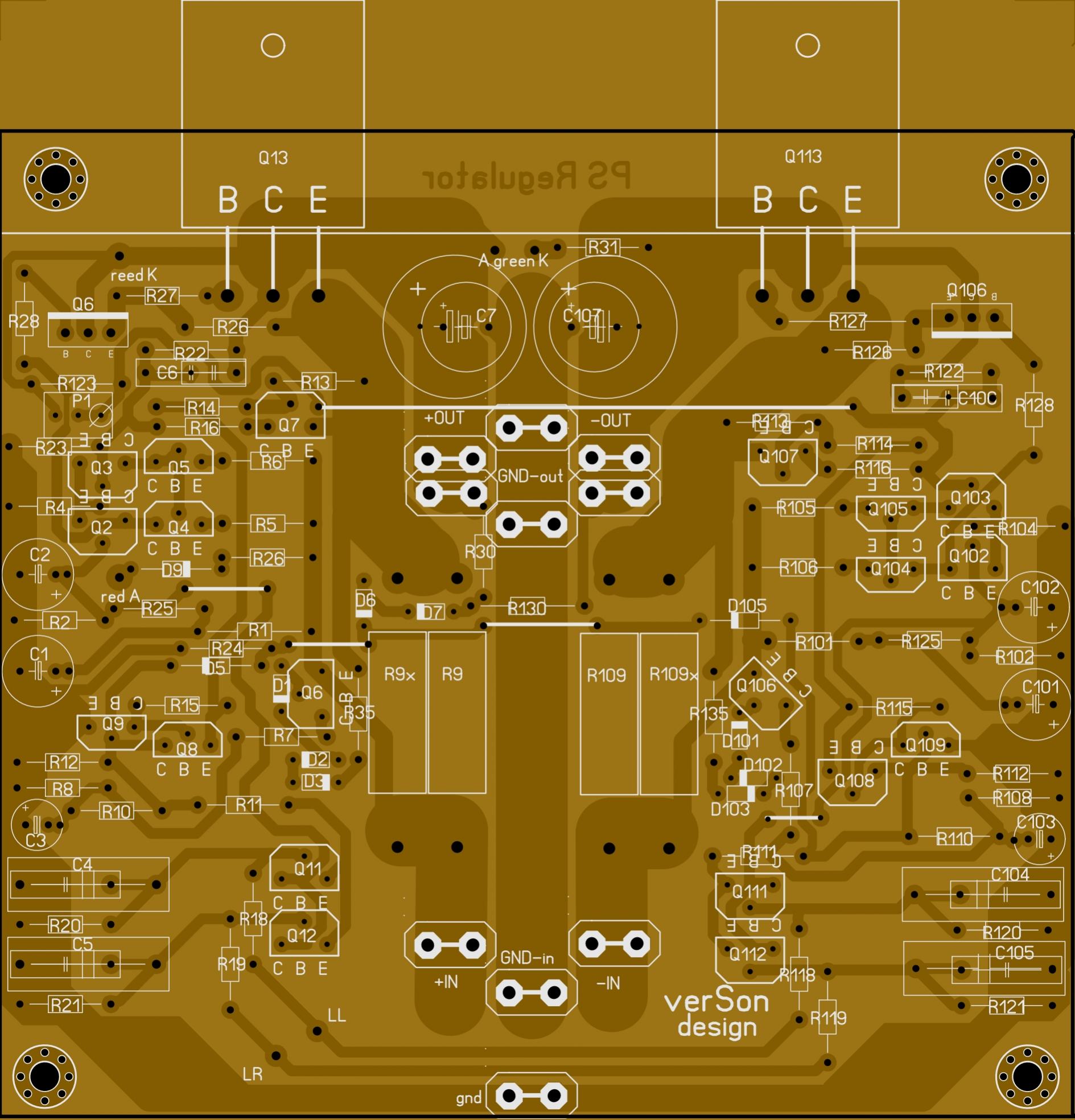

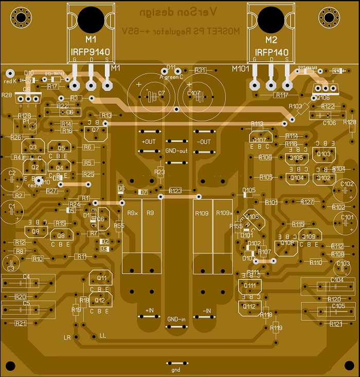

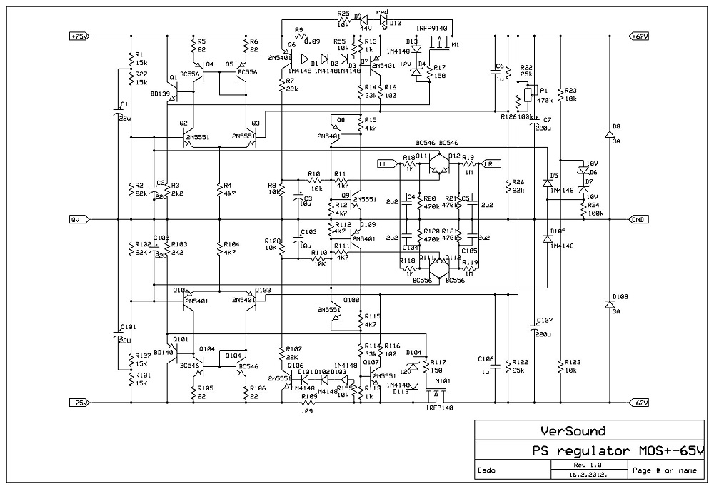

Here is the PS Regulator with overcurrent protection, loudspeaker protection against an amp output DC offset, Master slave output voltage behavior, and instantaneous switch off if one polarity sags to low. It can work with input voltage from 45 to 80 V, showing 5 to 6 V lower output.
I would like to know if there interested people. It is very suitable for 100W or higher wattage amplifiers. It could be used one board for both channels or two as in dual mono (no need for two transformers).

It looks like there is not going to be more interested here, I will place Monday the PCB production order check the prices and inform you before to finalize it.
There is one change. I have found some problem with the PS Regulator with MOSFET as regulating transistor. It was designed for higher power amp(200W) and never tried in real life. I have a version with BJT as the regulating transistor and that is proven version, working in my ThermalTrak 100W amplifier for years with no problem.
I suggest to change to this type, it is single side PCB and should be even cheaper. Let me know if that is OK.
