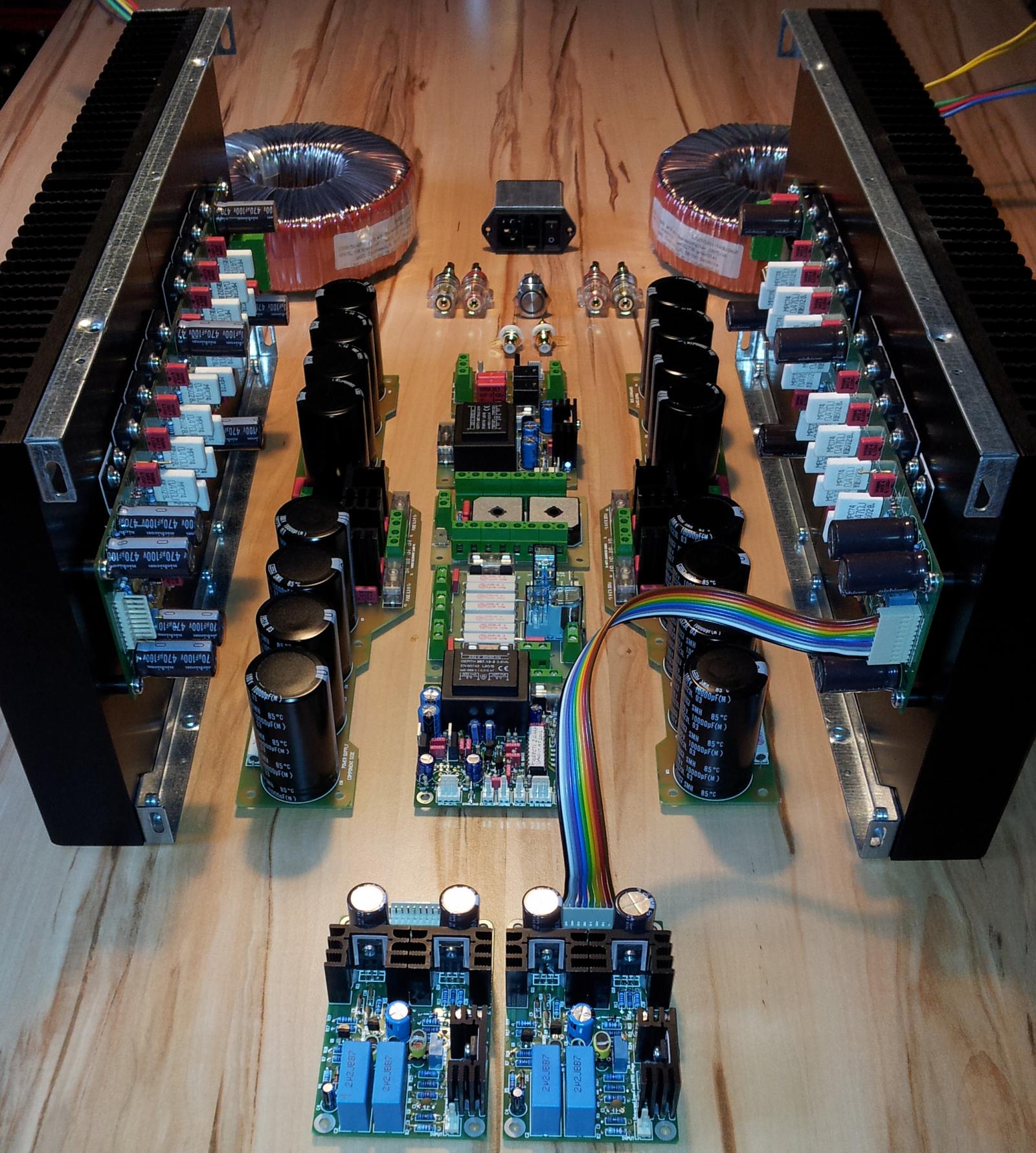

Milestone SA2013-Rev2-RC1
All pcb's are now ready for mounting and cabling.
The case needs some work (drilling and engraving) and maybe the first prototype amplifier will be ready in the next 2 - 3 weeks for extended real life audio tests.
  • 2 x input/vas stages
  • 2 x output stages
  • 2 x power suppy
  • 1 x microcontroller board (controls: inrush current, temperature, remote functions, speaker DC, speaker output relais, mute)
  • 1 x mains supply board
  • 1 x dual mono star ground
  • 1 x power supply 12V for output relais board
  • 1 x dual mono speaker output relais board
