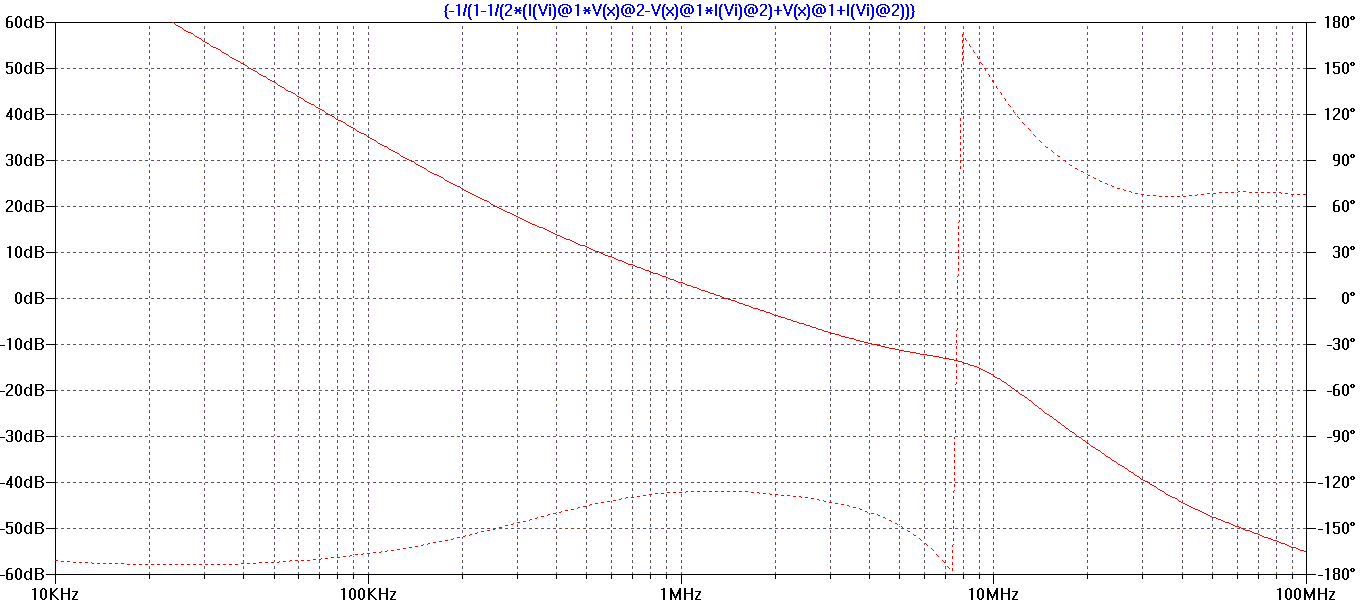

Hi Toni. I have started to play around with this and tried to optimise the conventional version first.
I am not sure that I have an up to date ASC for your current version, you may have altered a few values already.
But for the version I have I found that the VAS emitter resistor bypass capacitor should about 12nF.
There should be no series resistor with the capacitor.
The 470pF TMC capacitor should be reduced to 220pF and the TMC resistor to 220 ohms.
You may want to simulate this, I found it effective.

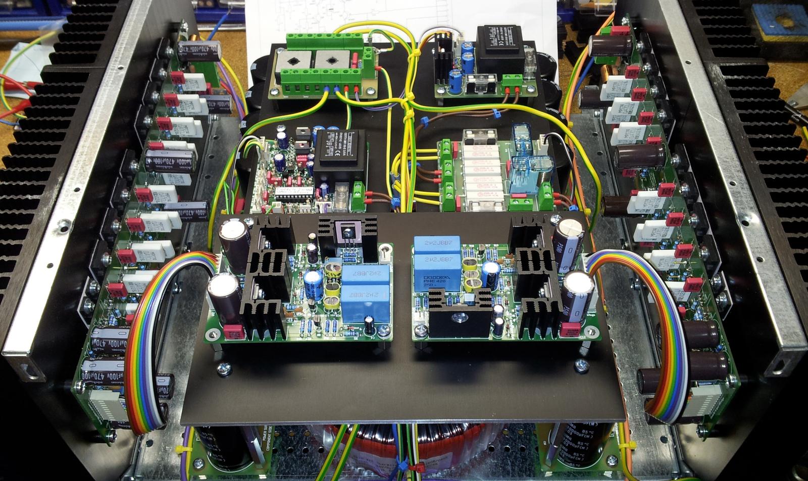

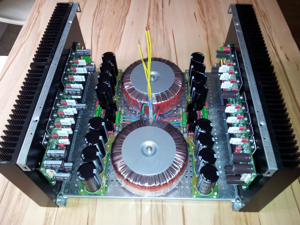

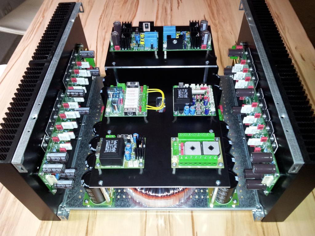

Looks nice, as usual.
I just noticed, how many layers on that board?
Thanks!...

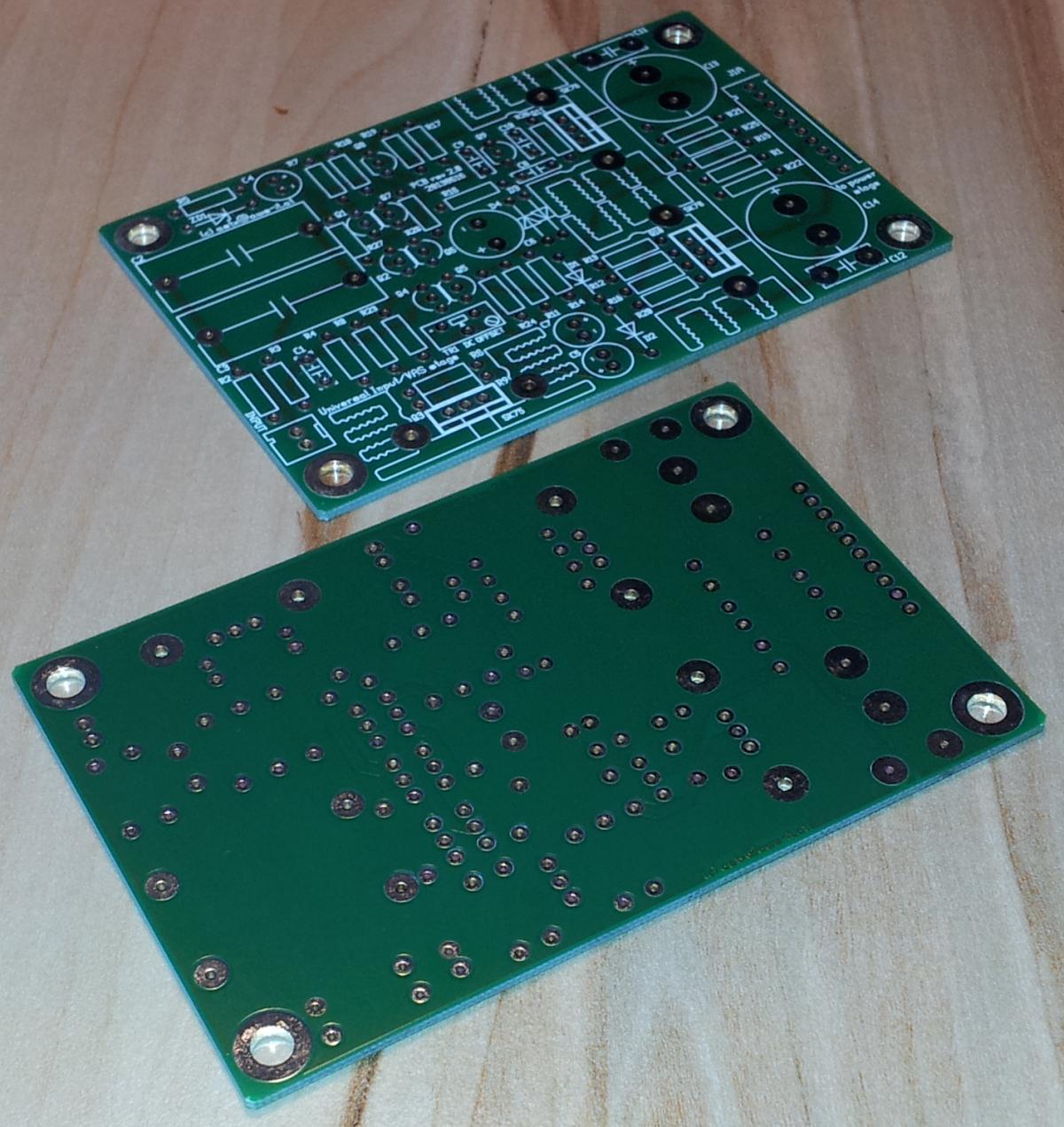

Board is using 2 layers - the bottom side is mostly signal ground and partially power ground.
Gerber files will follow soon if RC1 is stable.

The solder mask on the boards does not show the traces and I wondered if you had just a plane on each side and a 4 layer board.
I have never tried a 4 layer layout and want to learn more.

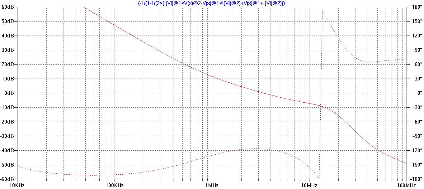

Dear Dave,
using current asc file and upper values the PM looks good - about 63 degree.
But GM is < 9dB. Maybe too less GM?
BR, Toni
Dear Dave,
BR, Toni
Yes I wondered about that, but I think it's fine.
Cordell says at least 6 and he is sensible.
Nichols plot shows approximate trade off of GM and PM and 9dB is plenty.

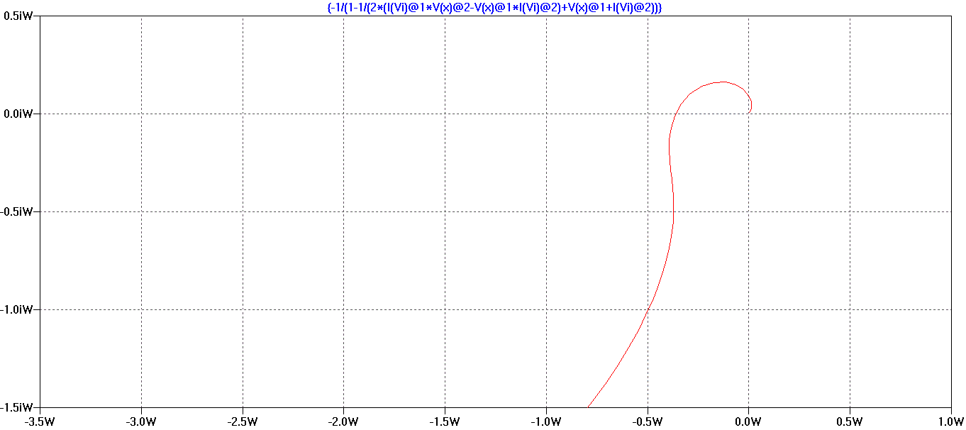

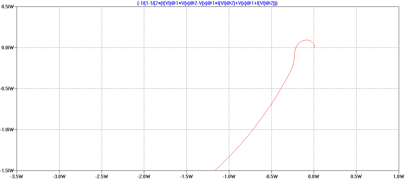

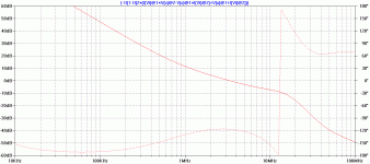

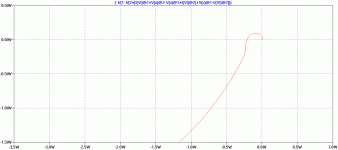

Dave, 609.gif & 609nyq.gif are Loop Gain for Toni's #609 circuit as is. Good margins and Nyquist keeps well away from (-1,0)
609Z.gif & 609Znyq.gif have your recommendations that Toni lists in #610 including the 12n across R22, the VAS emitter resistor.
I think his #609 circuit is a better compromise as the distance from (-1,0) is large and fairly constant.
Your version has better PM (the distance when Loop Gain cuts the unit circle) at the expense of GM (the distance where LG crosses the Re axis)
I haven't done any THD or stability with other loads.

Ok. The explanation.
I don't think we need to worry too much about circuit variability.
A proper compensation scheme will set the relevant return ratio with well defined passive components rather than unpredictable transistor parameters. 1% metal film resistors and 5% capacitors or better, probably.
So we can optimise the feedback network for best response at nominal.
We eliminate all the RHP zeros so essentially no excess phase (used strictly).
That means the frequency response is all we need to consider because it essentially defines the behaviour.
For instance the impulse response is just a transformation and will be nice if the frequency response is smooth.
The Nichols chart shows how much response peak occurs for various combinations of phase and gain difference. One curve intersects about 60 degrees (one radian) and 6 dB. So that is a balanced trade-off.
I have a bit more than 60 degrees of PM and about 9dB of GM.
Actually a bit conservative on GM.
And the new values have a little better PM and about double the return ratio.
THD should be better but I haven't simulated it yet, the smaller resistor and smaller capacitor is a closer approximation to "pure" Cherry so I expected you would want to.

Dear David,
just tried your values but amplifier is not stable and starts oscillation at about 6 to 7 Mhz. Short or long ribbon cable has nearly no influence.
Tested TMC values where:
- 470R => 220R
- 470p => 220p
- 12nF cap parallel to VAS emitter resistor
Think we have reached the limits of this design. Maybe a small change of the pcb layout and/or cabling would help to get below 10ppm THD20k@200W@8R.
