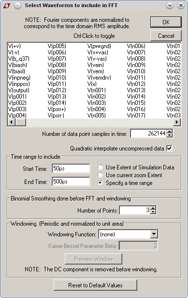

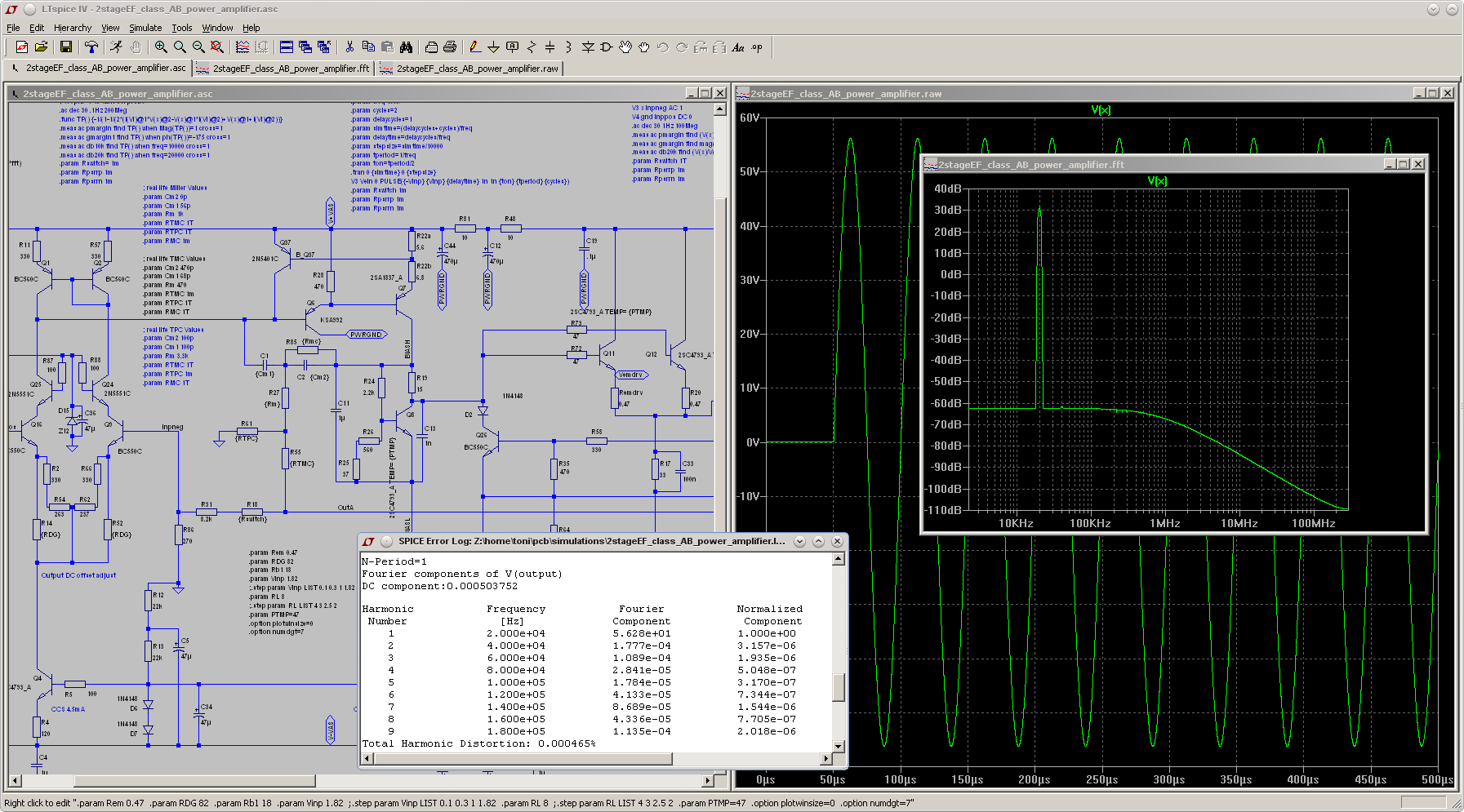

Can you put the FFT at 20khz ? The THDat the 20khz it is unrealistic. How many harmonics are calculated in the THD ? My simulation of the amplifier show that : THD at 20khz with 15 harmonics is 0.12%
You have to skip the first 1/10 of time scale as it contains no valid signal if you use the "FOURIER ..."

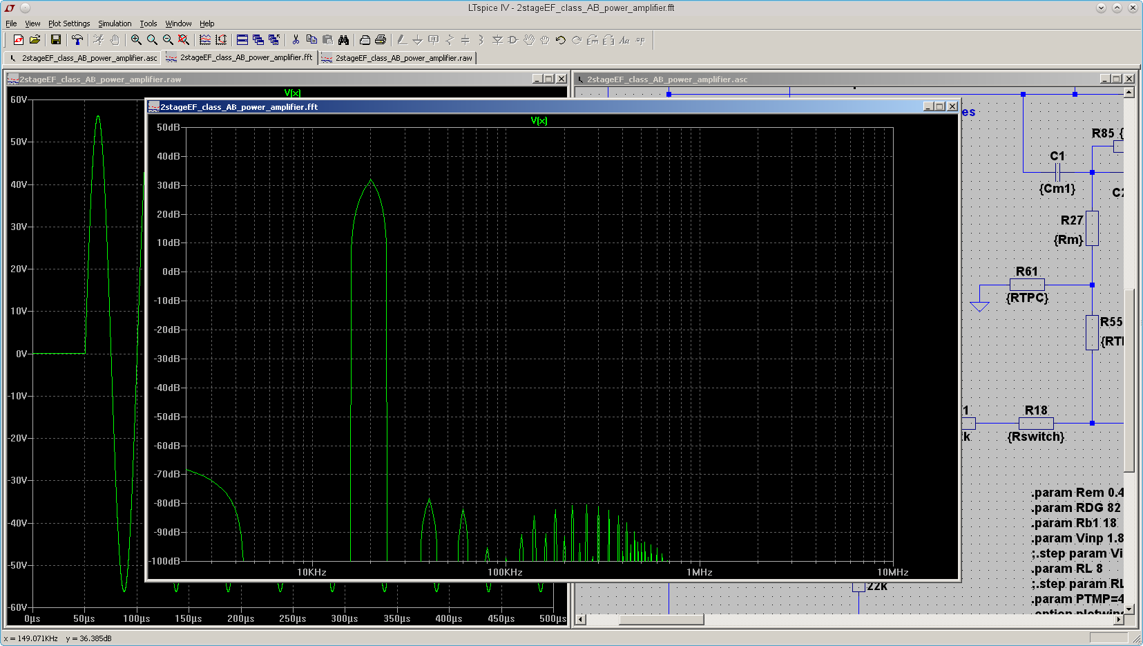

See attached picture of a 20kHz fft of v(x)

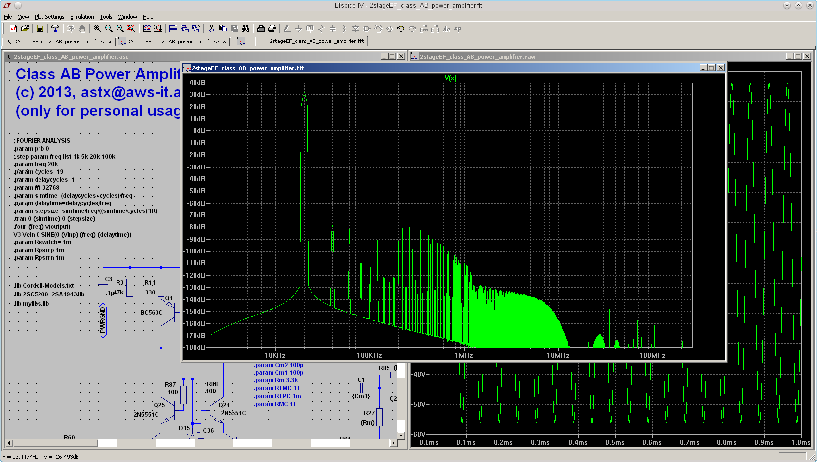

Astx, your simulation still has too much DC drift, hence the FFT noise floor obscuring the harmonics. You can use the Hann FFT window to fix this, but you will need to make all the DC blocking caps 1F or so to reduce the drift so that the .four command reports accurately. The CCS capacitors may matter too.
Do not give the sine source a delay in the plotted data! It should start at the same time as simulation or before. The abrupt start creates a large impulse which obfuscates the FFT.

< 500µV DC offset and < -90 db harmonics @20kHz . Real life FFT with hp3585A shows nearly the same smooth frequency response.
Sim starts with 1 cycle DC and 9 cycle sinus so it is necessary to skip 1/10 of sim otherwise you get garbage

Actually your new FFT AGREES with the .four analysis. I see about -106db distortion, which is about .0005%.

You don't need to use the Hann window to see this. Set the sine start delay to 0 and make all DC blocking or bootstrapping caps 1F. The DC drift will no longer obscure the harmonics.
EDIT: Now I see you exclude the sine start in your FFT. I found this was extra effort when I could do basically the same thing in the .tran statement. Still, the noise floor is caused by drift.

Yes, Hann was my idea. I never said it was the problem.
The 1F caps don't add any magic. They won't change the harmonics. They will do absolutely nothing unless your DC operating point was solved very badly.
Got it. Attached a fft picture of the second half of a 1ms sample to get DC stabilized. Now we can see a more detailed fft.
