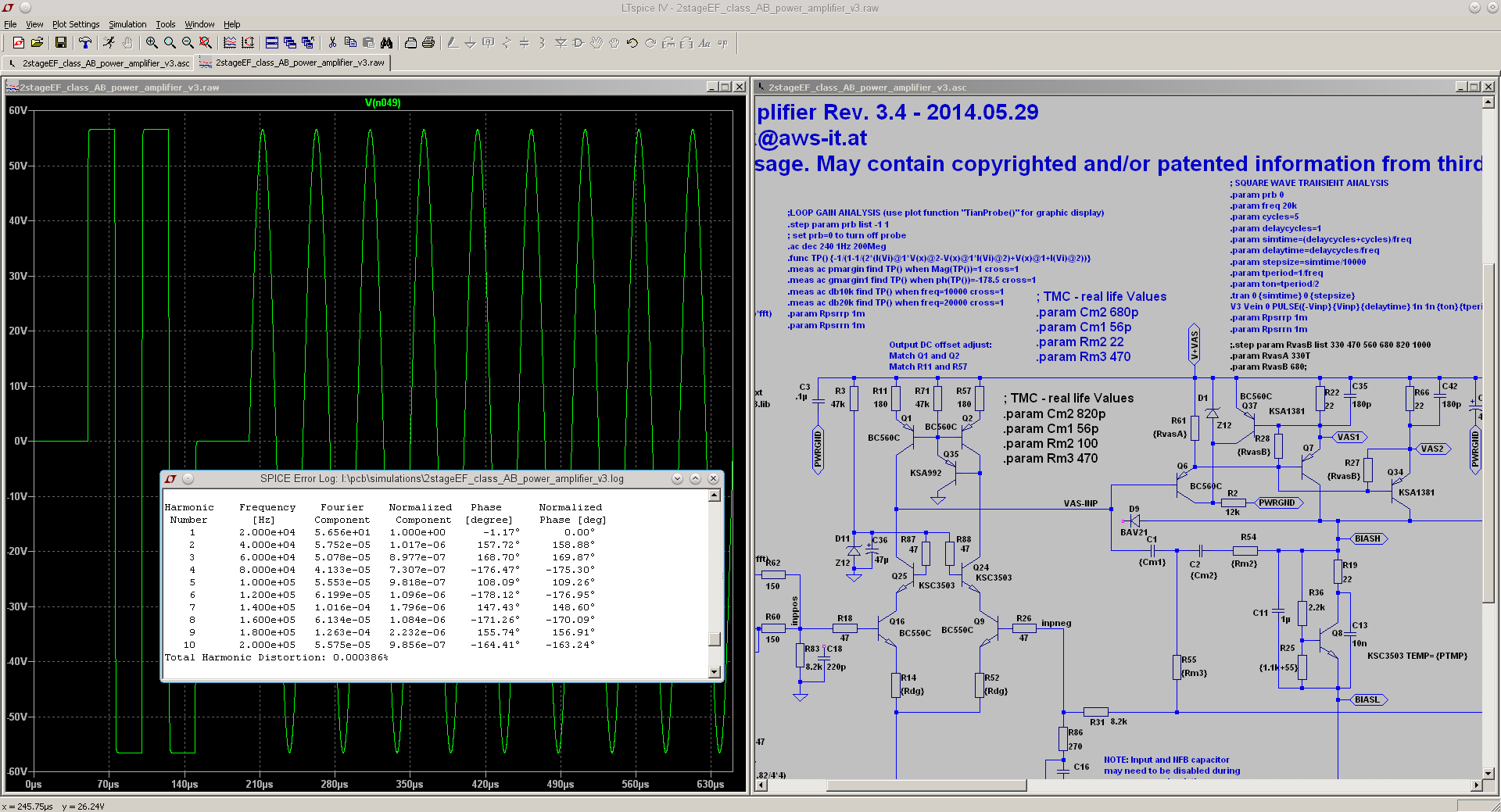

SA2013 V3.4 ready for takeoff ...
... some measurements added ... this one (v3.4) will be built 😉

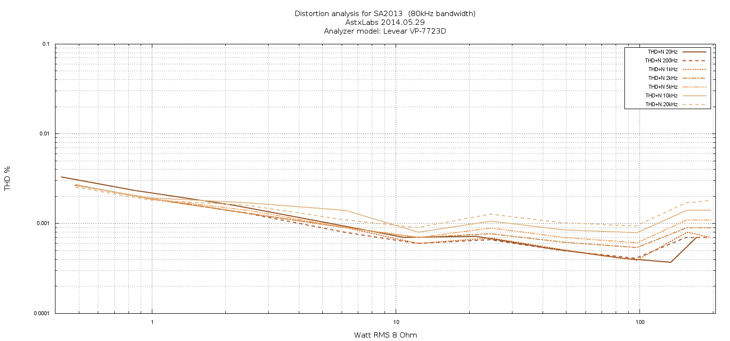

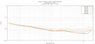

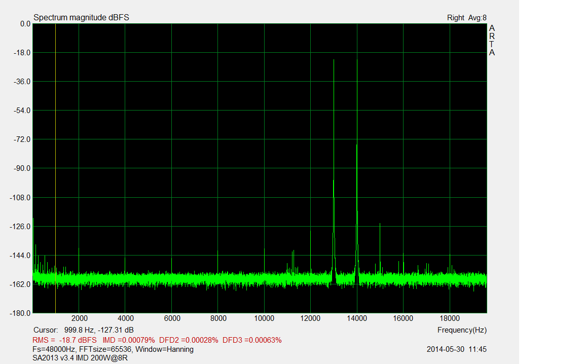

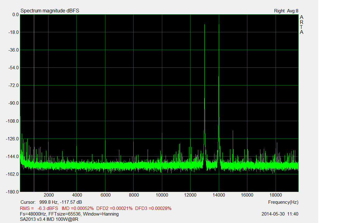

IMD SA2013 v3.4

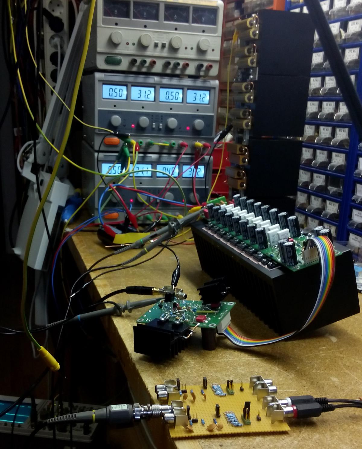

attached IMD measurement and picture of test setup. Idle current - mostly bias is about 0.5A as you can see in the background.
Home brew attenuation adapter as seen in the foreground is attached to ASUS Xonar sound cards line input. The 100W measurement has been done with 20dB attenuation, the 200W with 40dB attenuation using a simple jumper. Not very comfortable but cheap and it works.🙂
  • 0.00052% @ 100W @ 8R
  • 0.00079% @ 200W @ 8R
Now I need to rework SA2013 pcb's to reflect v3.4 changes. 😉
