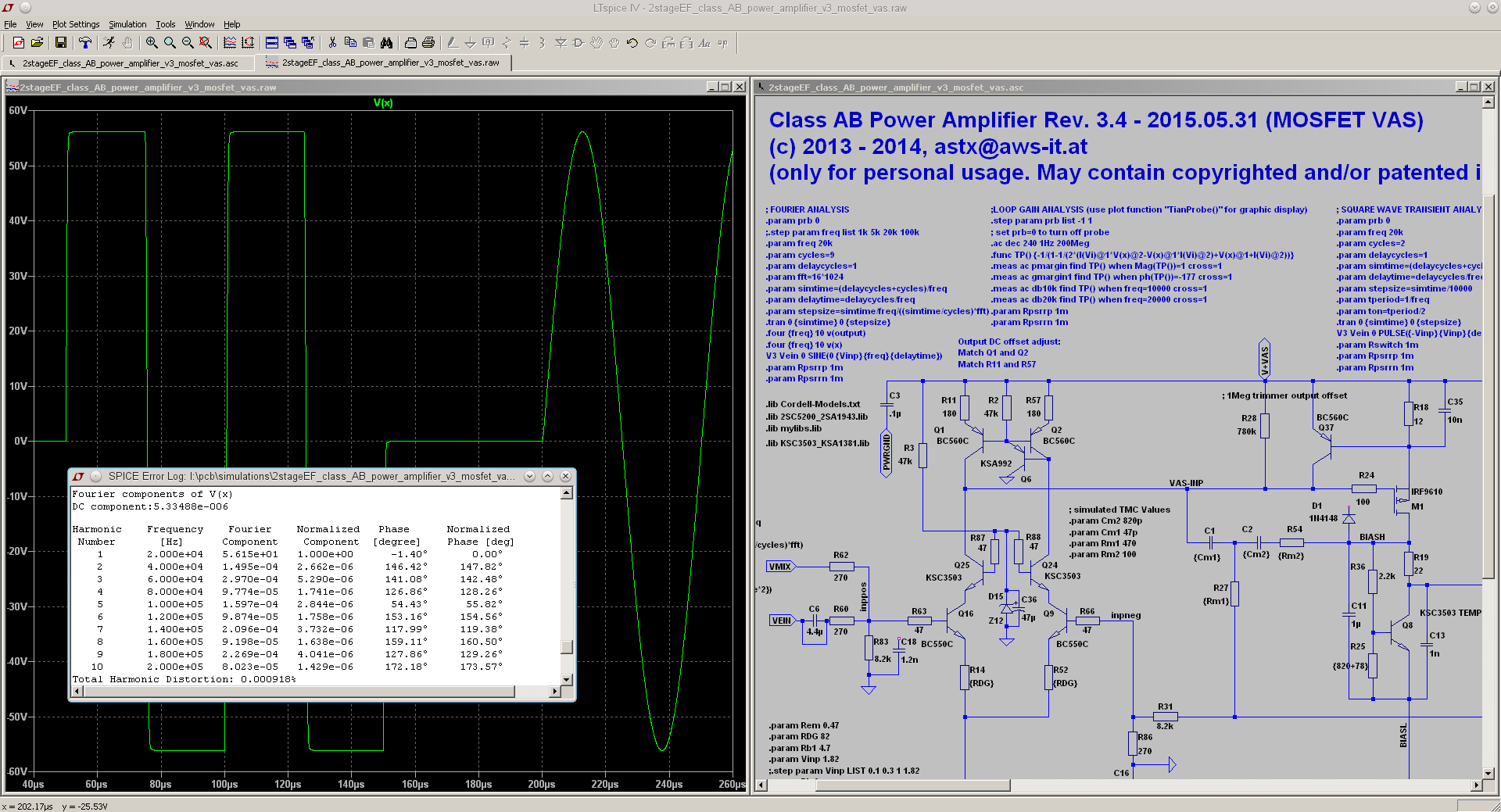

Not really off topic - MOSFET VAS variant simulation
  • during lab cleanup I found a couple of IRF9610 lying around from an old papa Pass project
  • found an IRF9610 spice file
  • simulated SA2013 v3.4 using IRF9610 for VAS
Attached are the results. NFB gain at 20 kHz drops from 60db to 42db compared to enhanced VAS. Maybe I will try this variant the next days in real life. Hopefully the mosfet spice file is not too far away from reality.
Have fun, Toni 😉

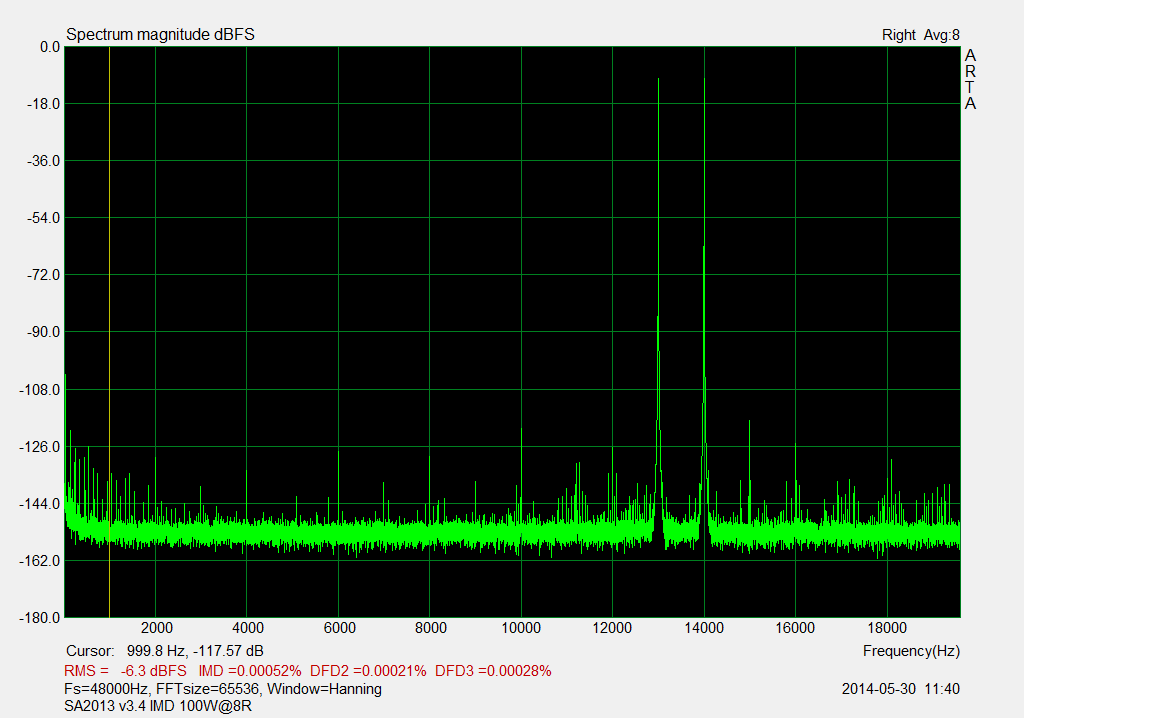

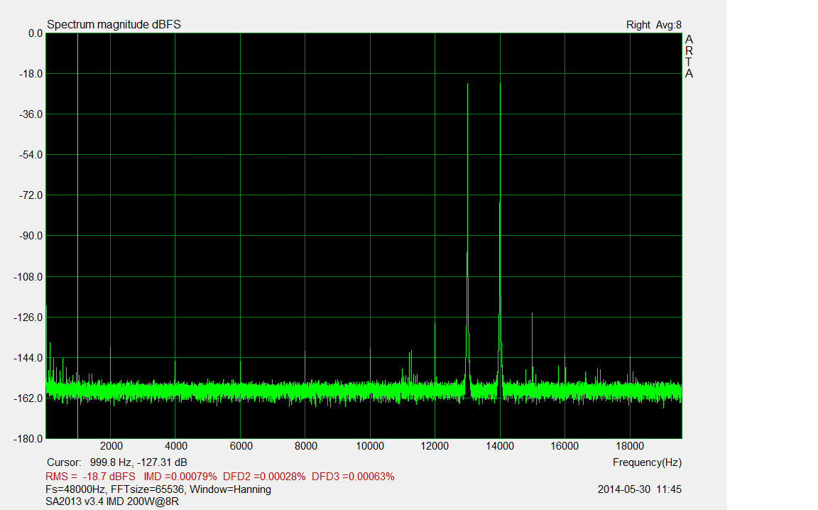

attached IMD measurement and picture of test setup. Idle current - mostly bias is about 0.5A as you can see in the background.
Home brew attenuation adapter as seen in the foreground is attached to ASUS Xonar sound cards line input. The 100W measurement has been done with 20dB attenuation, the 200W with 40dB attenuation using a simple jumper. Not very comfortable but cheap and it works.🙂
  • 0.00052% @ 100W @ 8R
  • 0.00079% @ 200W @ 8R
Now I need to rework SA2013 pcb's to reflect v3.4 changes. 😉

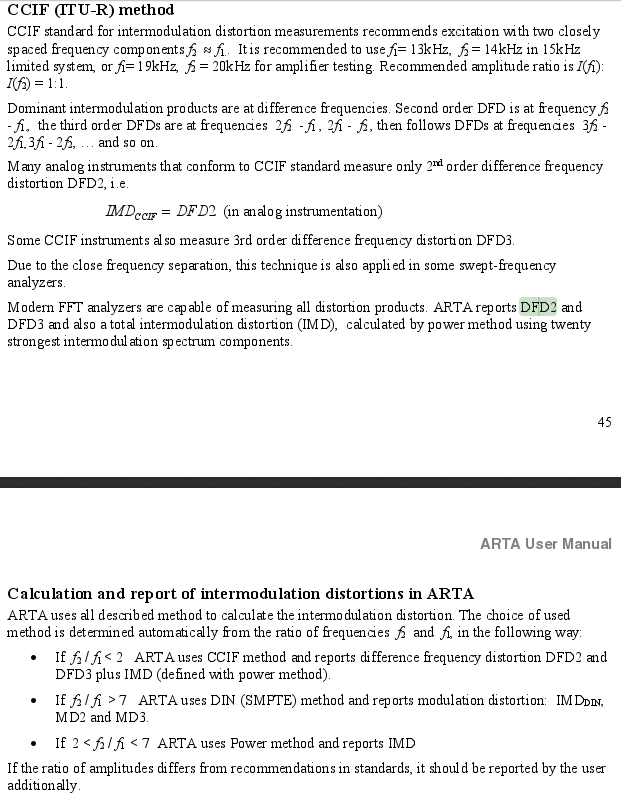

CCIF IMD is only DFD2 (see ARTA manual page 45/46)
  • 0.00021% @ 100W @ 8R
  • 0.00028% @ 200W @ 8R
Even DFD3 is very low (frequency products directly left and right from f1 and f2). Of course they may not be heard as good as DFD2 due to masking effects...
Literally the excerpt does read that way.
But I suspect it is not true that the actual specification is only DFD2.
Instead, that some CCIF type instruments only measure DFD2.
Anyone have a copy of the standard to check?
DFD3 will be well masked by the particular CCIF frequencies, but not by real music.
So I think the DFD3 is like 20 kHz 2nd harmonic distortion test. Still a reasonable test of linearity even if the specific measured frequency is inaudible.

I notice that CCIF specifically recommends 19 + 20 kHz for amplifiers but you have chosen lower.
I expect you have a reason that is not just to improve the numbers?

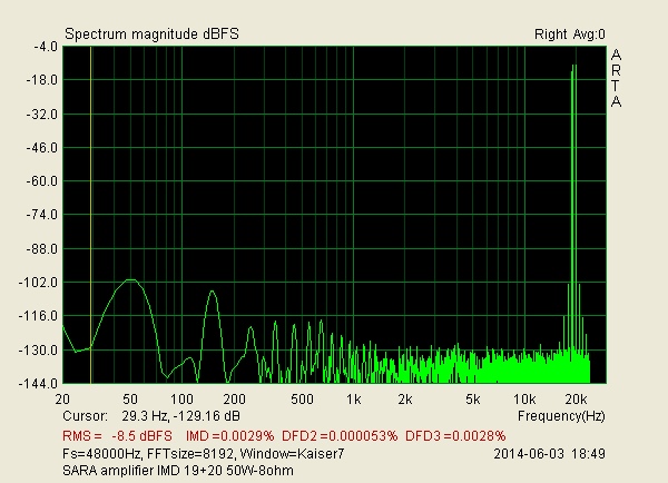

In Stereophile Magazine , John Atkinson talks in a first time about f2-f1 product , 1khz in 19+20 khz case, because it is in audio band and it is far away from test frequencys. Obviously the best is to have all the products small. Astx made a very good amplifier, almost perfect.
I repeat the measurement at SARA, my amplifier, at half of power, 50W in 8 ohm and DFD2 is 0.00005 %....Of course DFD3 is much bigger, but nobody is perfect 😀😀😀
Good job, well done Astx, go on. 😉

Thanks!
DFD2 of SARA looks really excellent - but why is DFD3 so much higher? Try to repeat your measurements with linear frequency scale and an averaging of about 8 to 16 times...
Same again as loopback reference to be sure, DFD3 does not come from soundcard.
