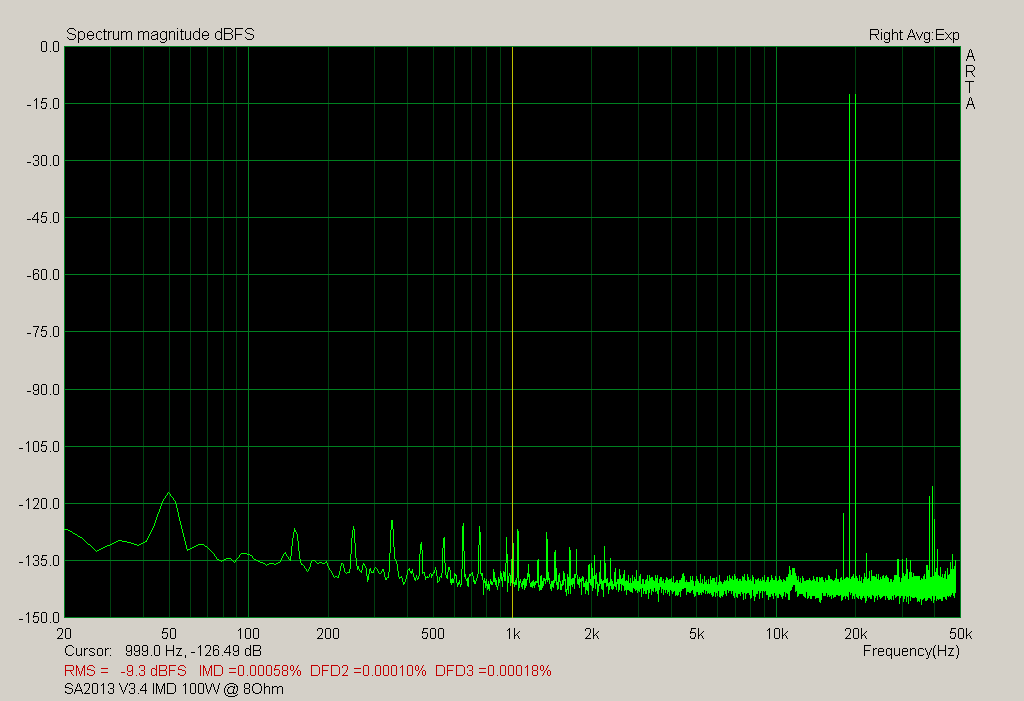

DFD2 of SARA looks really excellent - but why is DFD3 so much higher? Try to repeat your measurements with linear frequency scale and an averaging of about 8 to 16 times...
Same again as loopback reference to be sure, DFD3 does not come from soundcard.
Thank you for the tips 😉 I shall try....

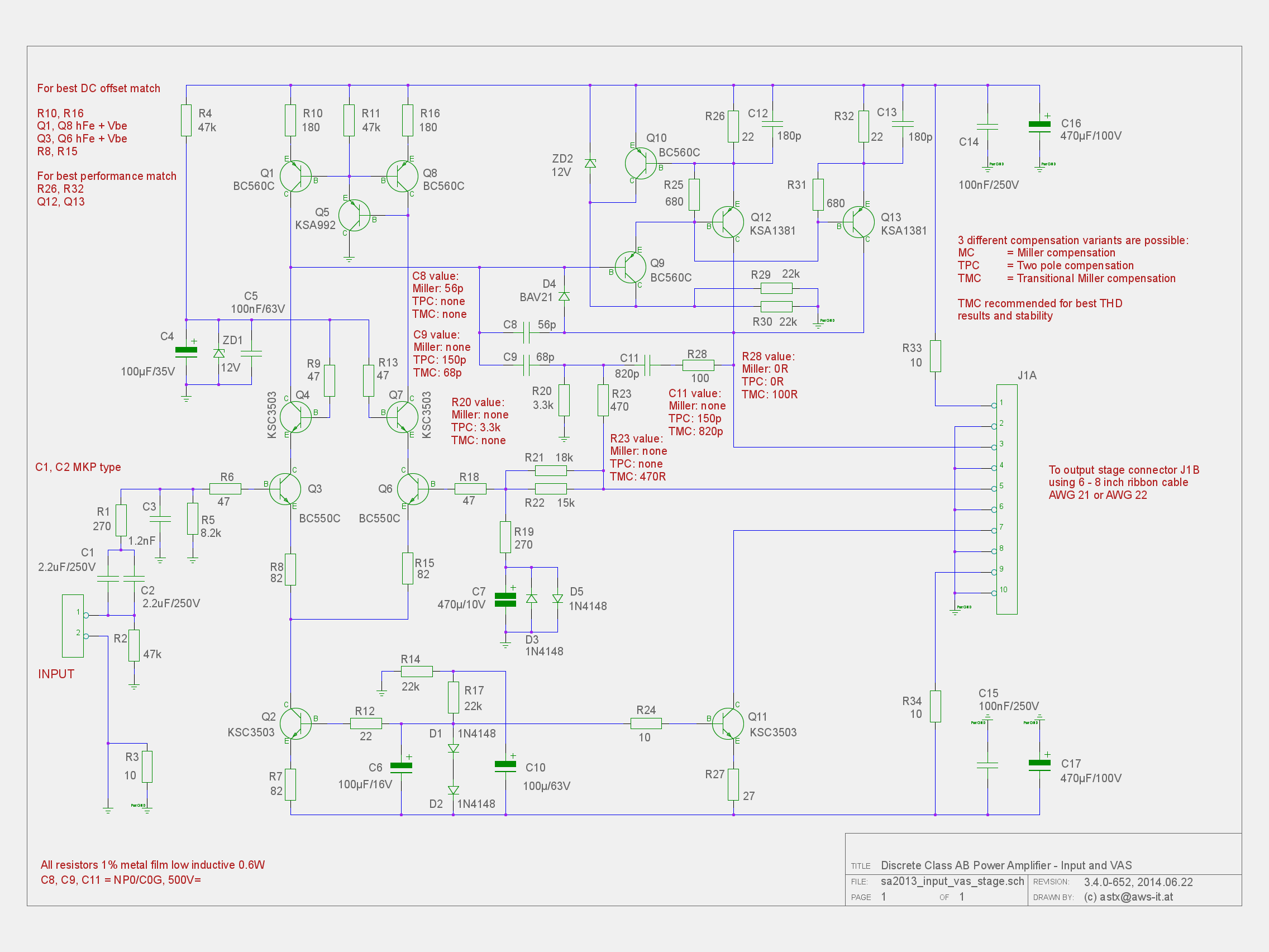

Attached are the results. NFB gain at 20 kHz drops from 60db to 42db compared to enhanced VAS. Maybe I will try this variant the next days in real life. Hopefully the mosfet spice file is not too far away from reality.
- during lab cleanup I found a couple of IRF9610 lying around from an old papa Pass project
- found an IRF9610 spice file

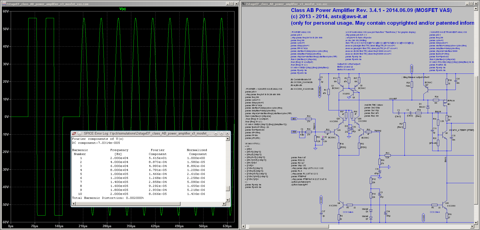

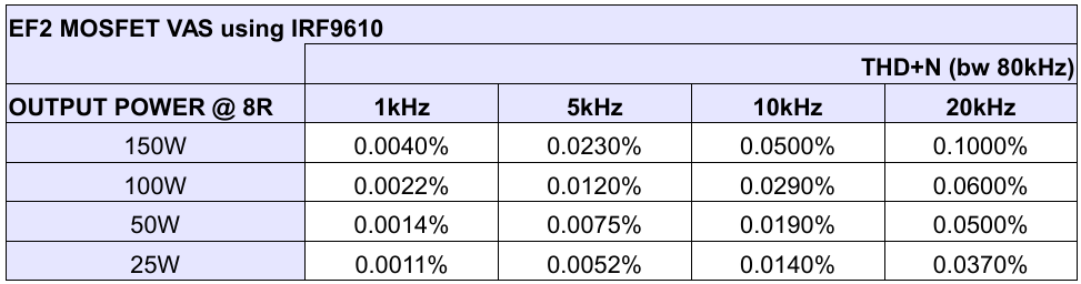

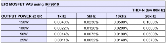

- simulated SA2013 v3.4 using IRF9610 for VAS
Attached the test results of the MOSFET VAS. It works fine and real life THD isn't so far away from simulation.
CCID IMD 0.002% @ 100W @ 8Ω
Have fun, Toni 😉
Have fun, Toni 😉
0,002% in simulation and 0,1% measured is a factor of 50?
Stil very interesting measurements. Can I ask how much the amount of feedback is at 20khz?
Have you listened to the FET VAS? What do you think about vs the bjt vas?
- The factor is even worse. More as 100 times higher THD at full power 20kHz real life versus simulation. The sentence "THD isn't so far away from simulation." was meant as a joke! 😉
- Feedback from simulation is about 40dB@20k
- Haven't listened to it.
- IMHO: not worth building it unless you need it for a subwoofer

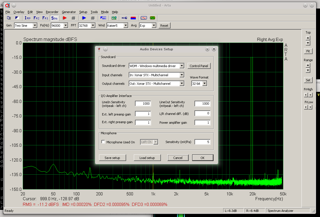

IMD measurement using ARTA running under Linux/Wine
One step forward eliminating the need of a M$ operating system: Today I got ARTA running under openSUSE 13.1 using wine 1.7.17 (setup doesn't work under wine, but copying the installed files from windows / "Program Files (x86)/ArtaSoftware" to linux wine drive_c works)
Attached ARTA device settings under Linux using Asus Xonar STX. You can control the device settings using the console program "alsamixer". Switching output to headphone or line out, control headphone impedance ...

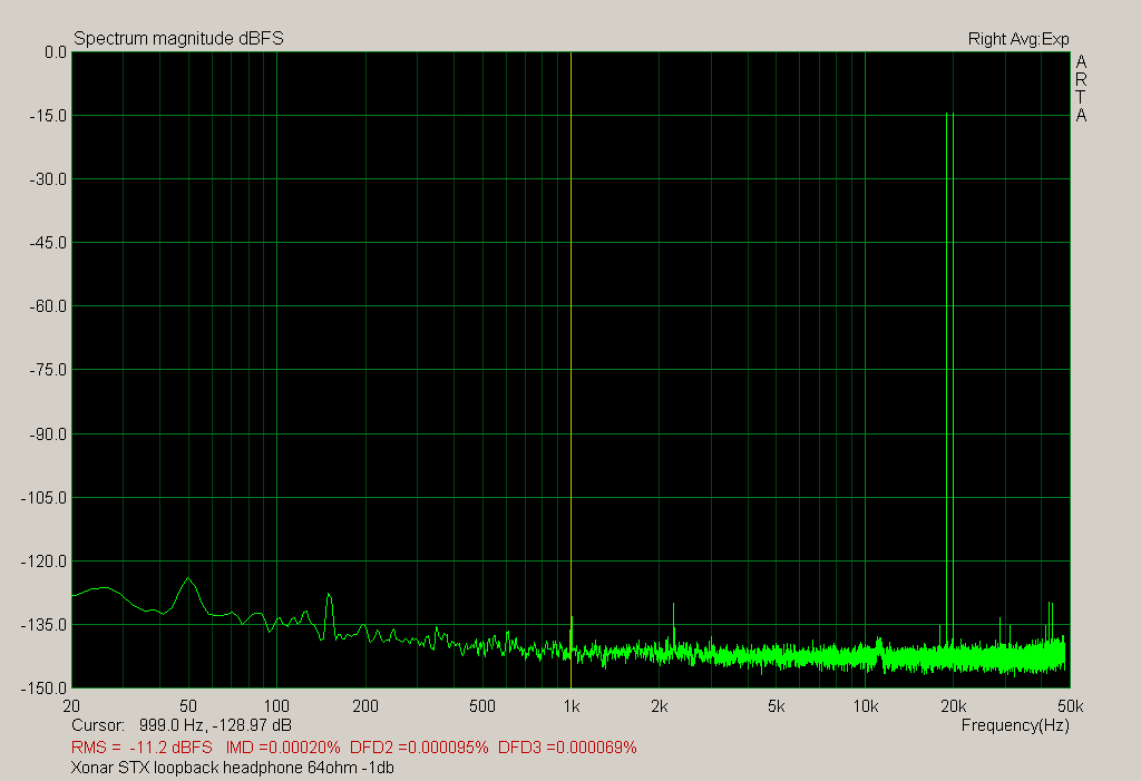

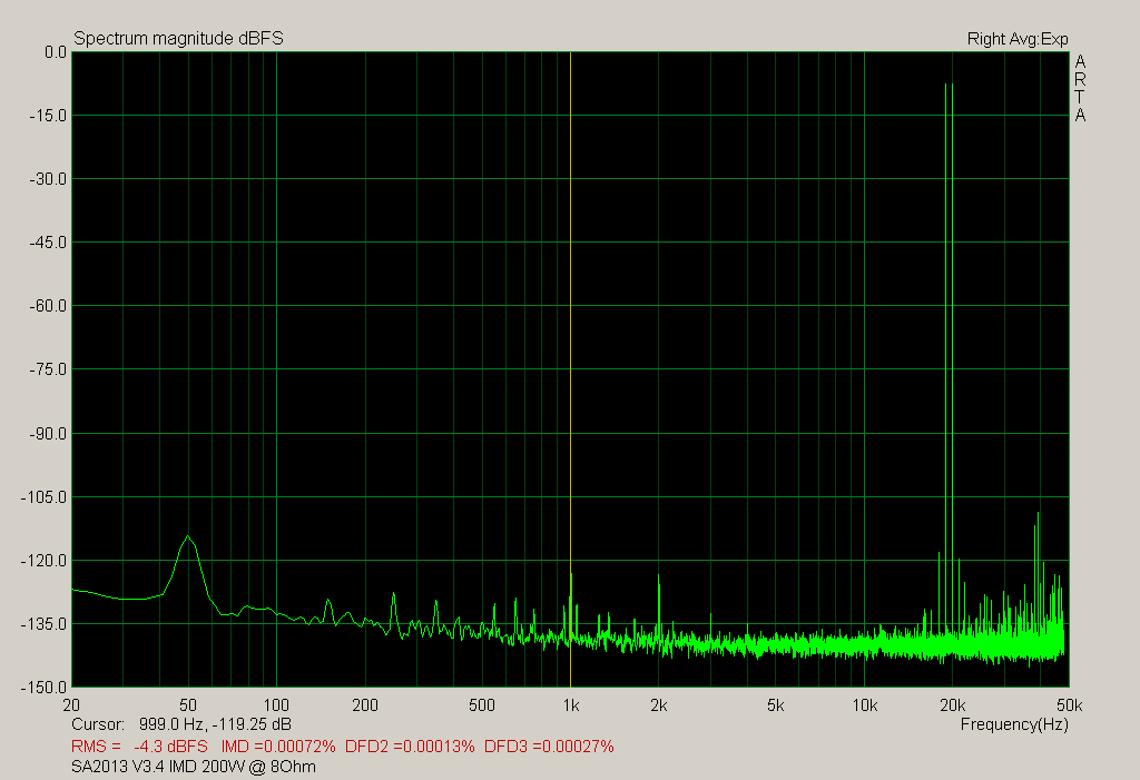

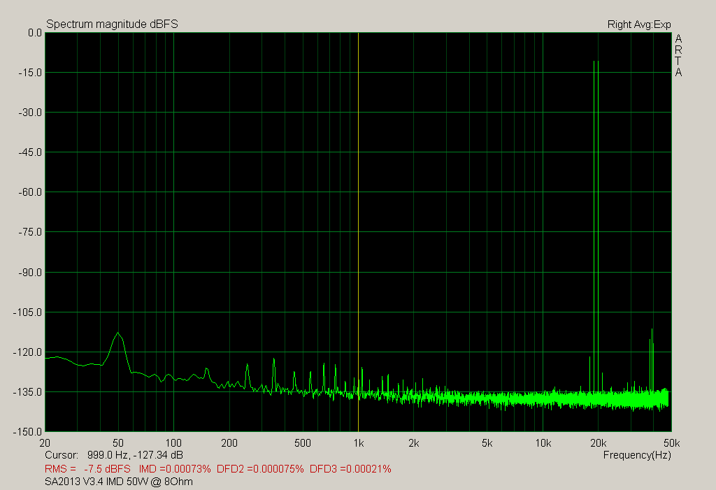

See attached pictures of some settings and a redone IMD measurement as I was now able to use the headphone outputs instead of line out.
Pictures:
Awesome!
Pictures:
- ARTA devices settings under linux/wine
- alsamixer settings
- IMD reference of soundcard
- IMD 50W@8R
- IMD 100W@8R
- IMD 200W@8R

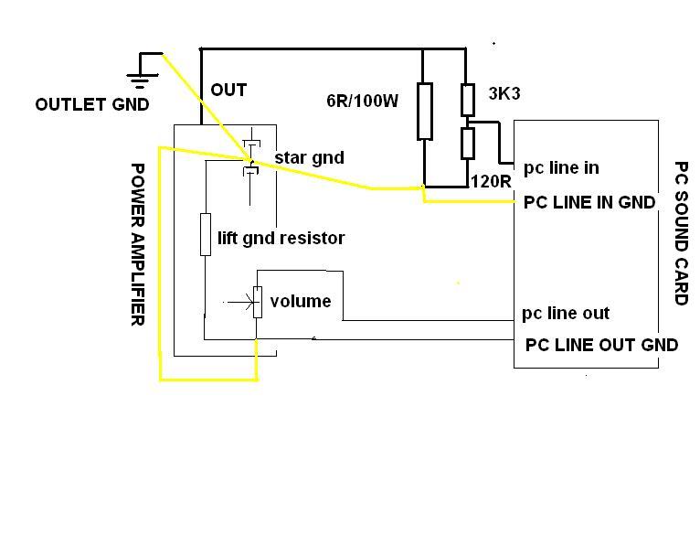

Can you share a schematic how amplifier connected with load ,attenuetor and sound card?
I have troubles with this
I used the setup as photo.
Did you try using Step (ARTA)?
Thimios.
Hi astx nice work!
Thimios.
Thx! Didn't use STEPS as I have a PANASONIC/LEVEAR VP-7723D audio analyzer which has a better THD resolution as the Xonar up to 100kHz.

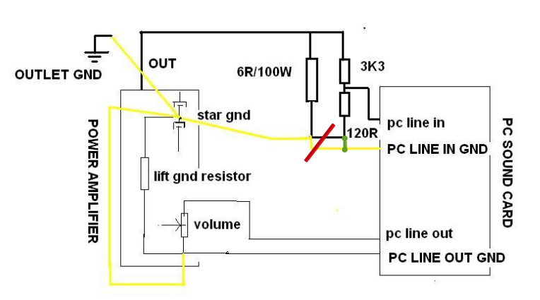

Attached the modified setup. I have used 9k resistor and 1k poti to trim output level to sound card sweet spot. The signal from amplifier has been taken directly after output coil using a osci probe (ground clips at probe isolated to avoid ground loop).
Have fun! 🙂
BR Toni
Have fun! 🙂
BR Toni
And the load? where connected the load(in your configuration)?
Of course 8R load was connected from amplifier output to power/star -ground as shown in the simple schematic.And the load? where connected the load(in your configuration)?
Ok thanks i will try this modification soon.Of course 8R load was connected from amplifier output to power/star -ground as shown in the simple schematic.
Best regards.
Thimios.

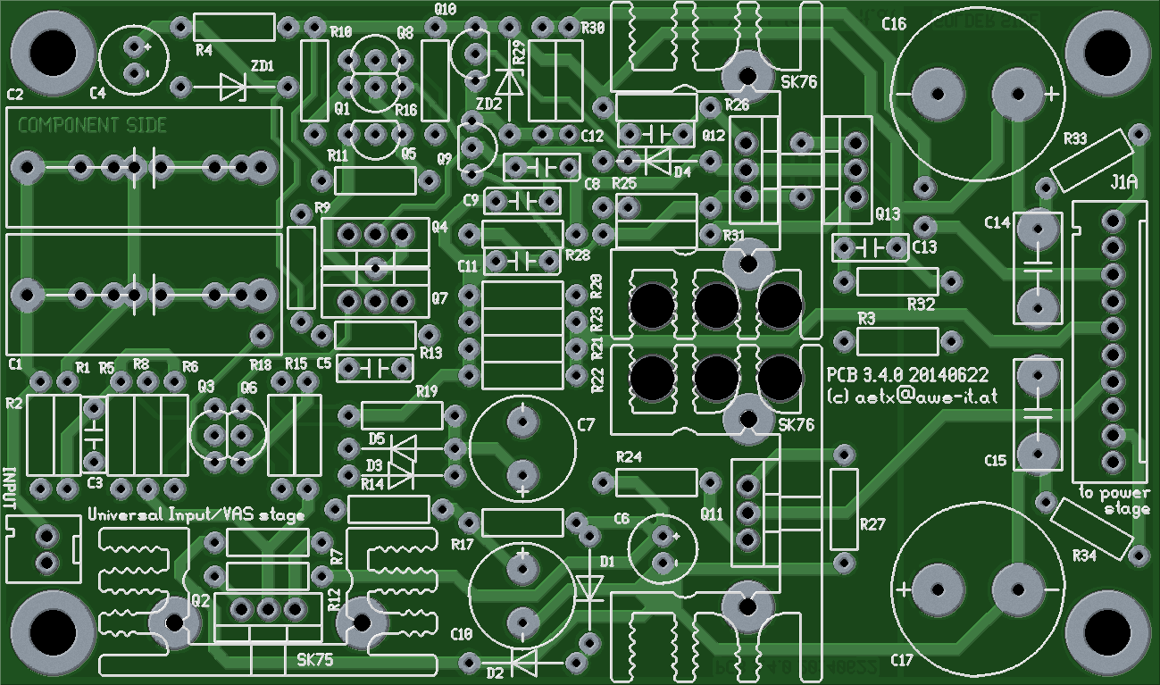

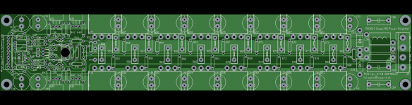

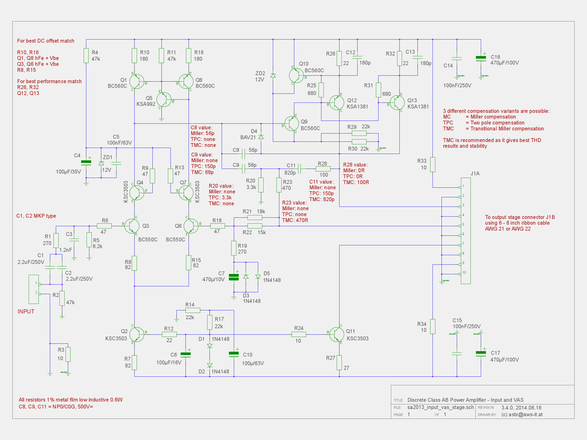

SA2013 V3.4 input stage pcb ...
... just sent to fab.
As always schematics and pcb gerber files are free to use only for non commercial DIY projects.
Have fun,
Toni

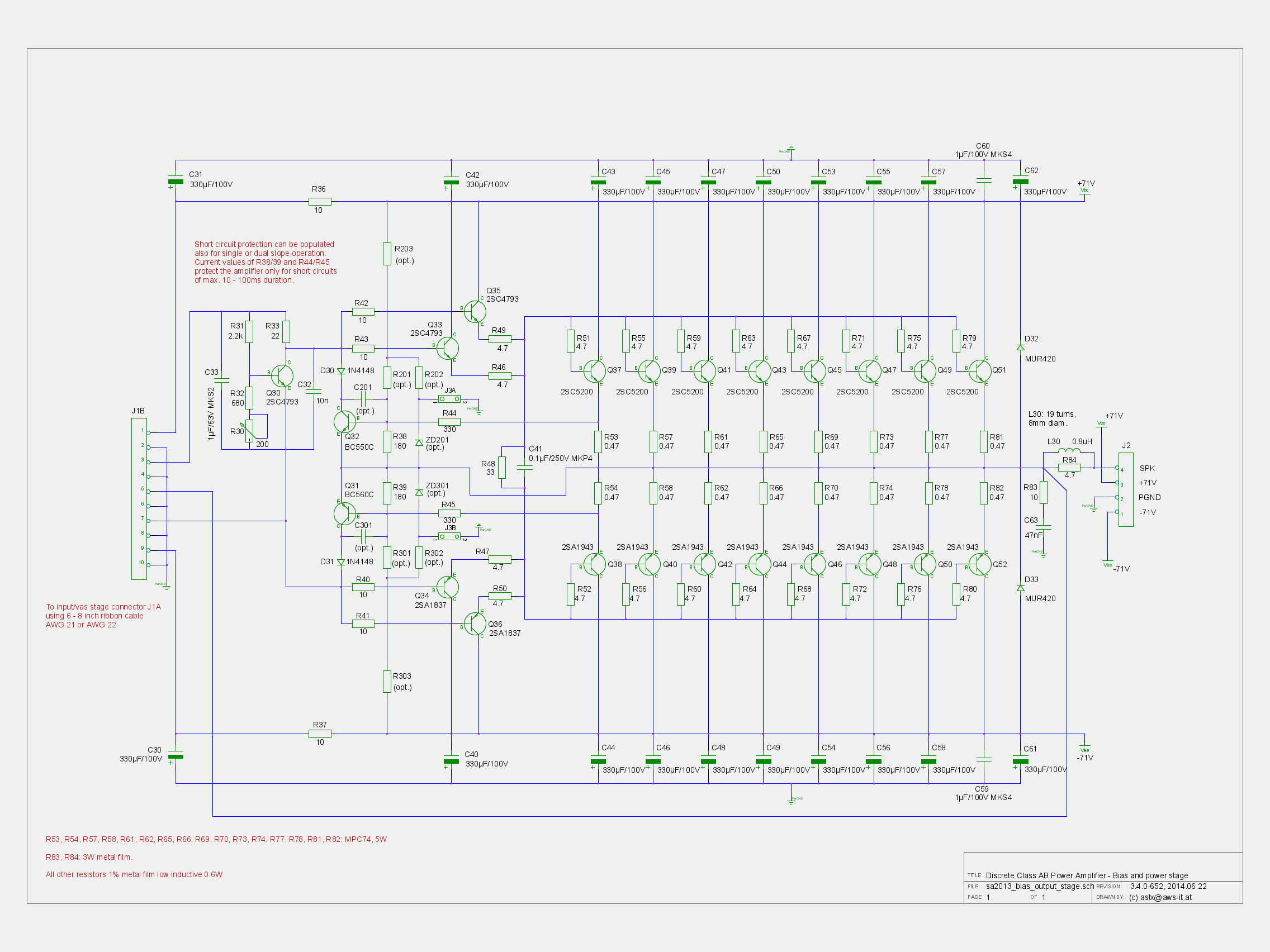

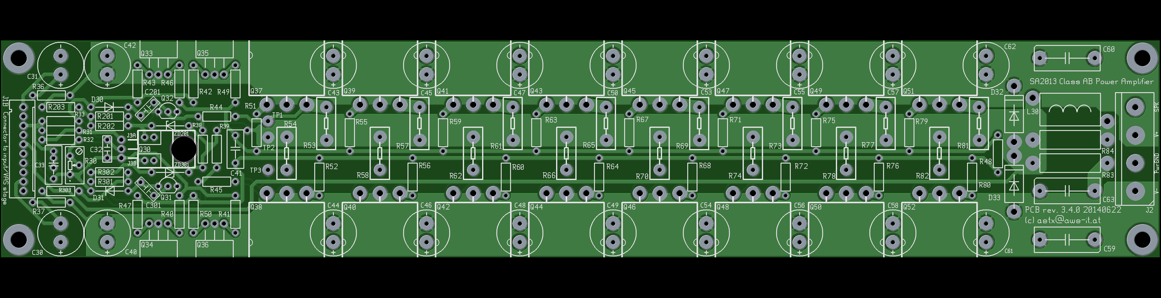

SA2013 V3.4 bias and output stage pcb ...
Schematics and pcb gerber files are free to use only for non commercial DIY projects.
- 2stageEF high performance class AB power amp / 200W8R / 400W4R
