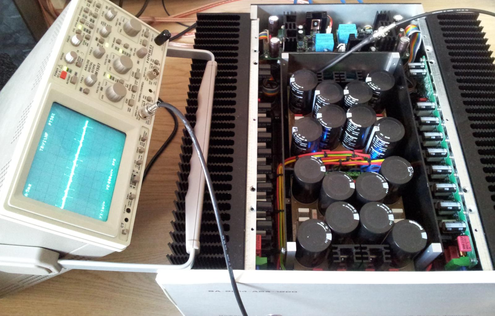

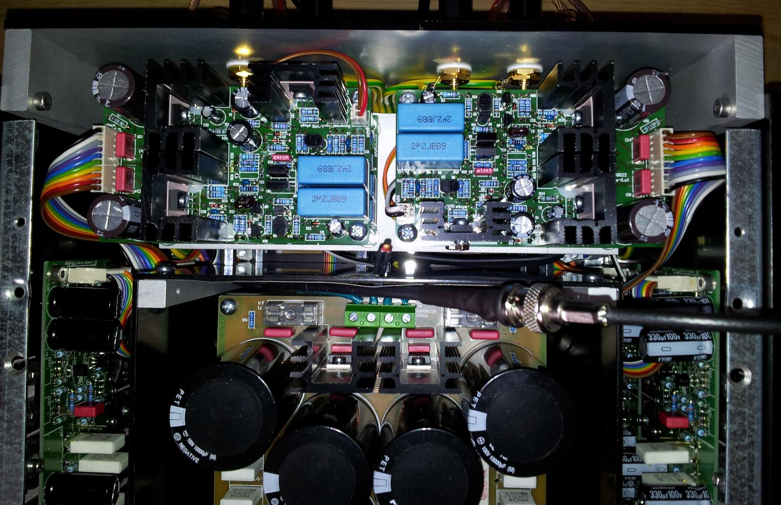

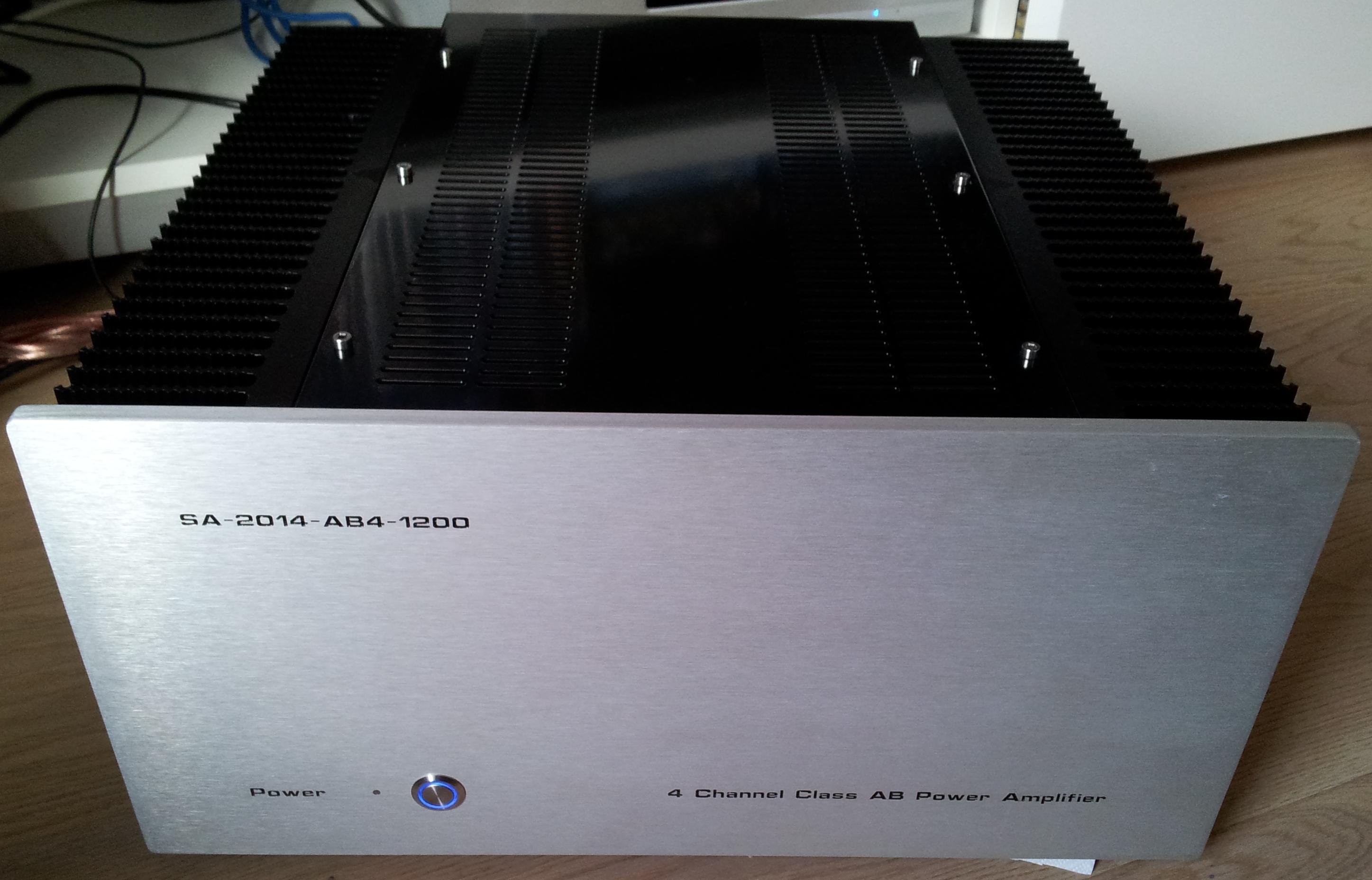

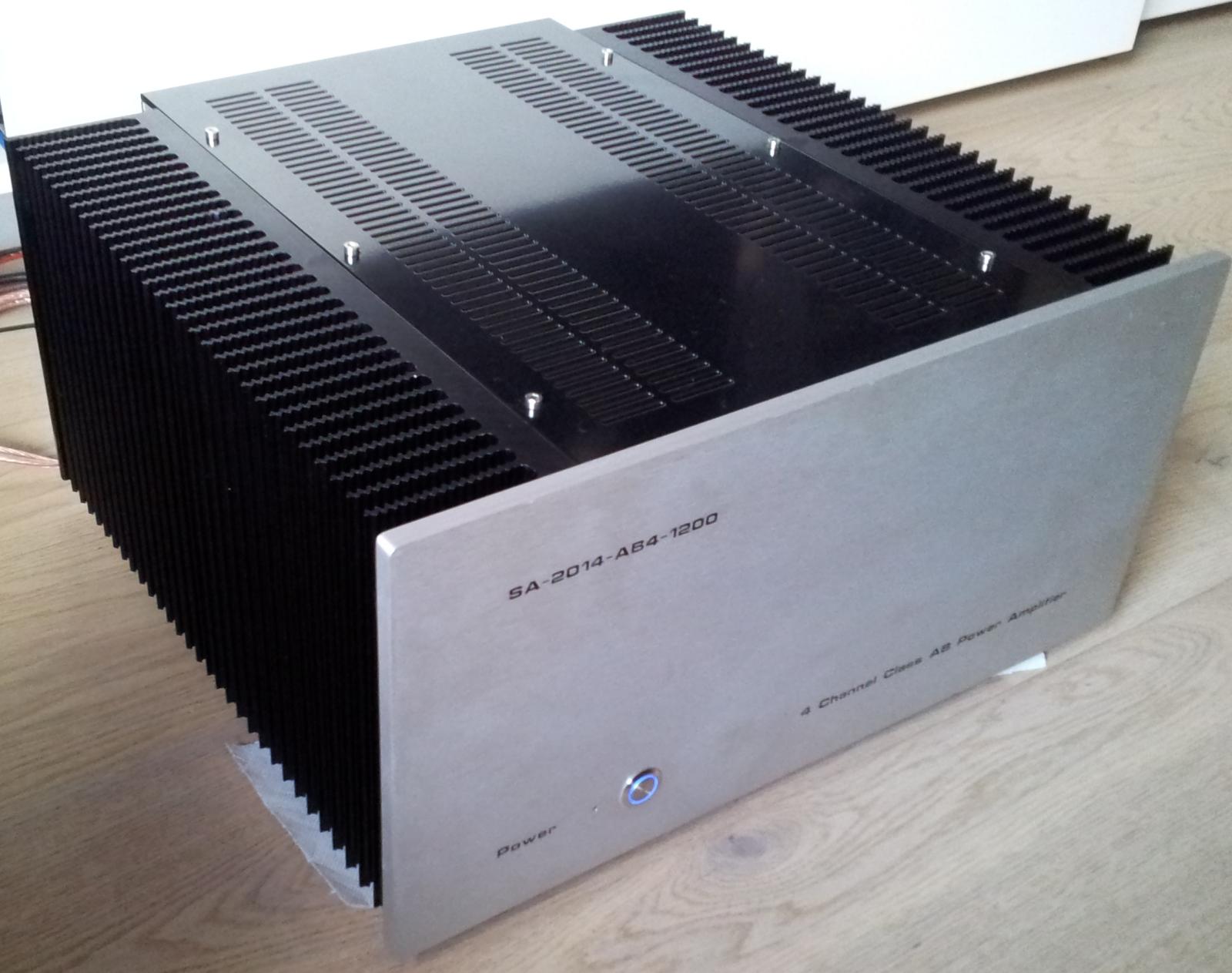

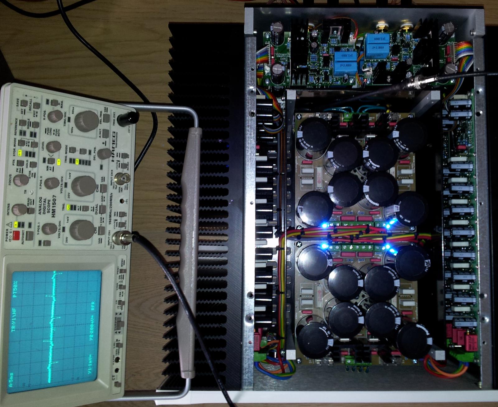

... start tuning for lowest SNR with homebrew h-field probe ... need to add some cnc machined mu-metal.
SNR from lab is as low as 125 (A-weighted)
Current SNR is about 110 db (A-weighted)
Picture 3: homebrew h-field probe
Pictures 4 and 5 are showing rectifying spikes. Using the h-field probe it is very easy to find "hum" hotspots. ;)
BR, Toni
