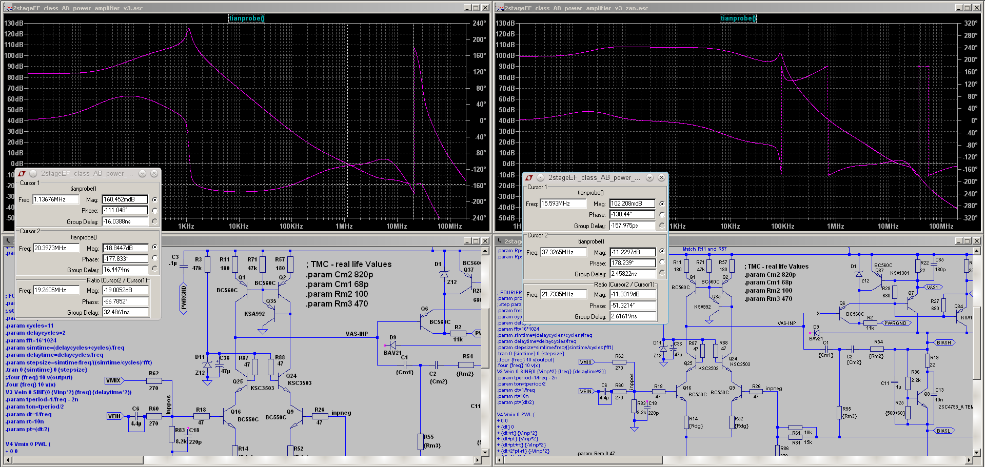

Thanks for that, I did a simulation of the inner loop Return Ratio, at the VAS input.
Have you looked at this, in particular the PM?
Best wishes
David

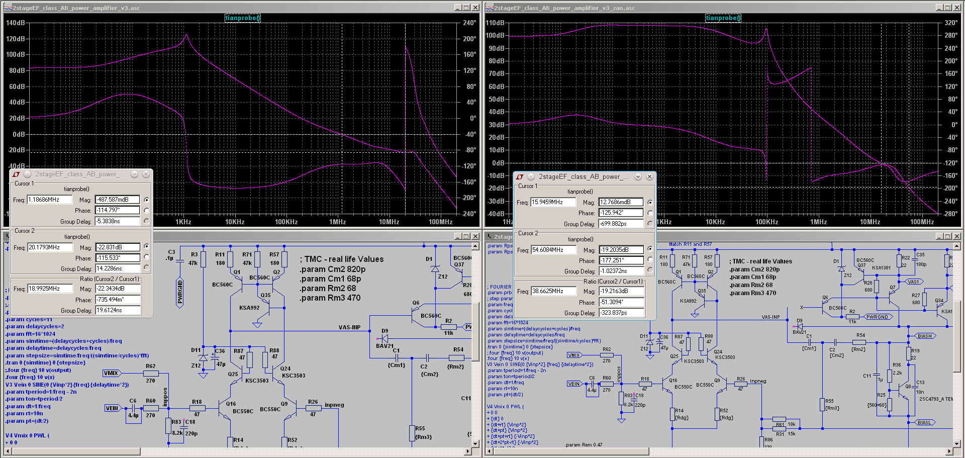

Dear david,
you are right. The simulation shows a relatively small PM in inner loop. Maybe "Rm2" is a bit oversized. If Rm2 is reduced from 100R to 68R the balance between inner and outer loop GM/PM values are looking better.
Note: The real hardware is pretty stable using 100R. I will verify if 68R does give any different measurement/hearing results the next days/weeks.
Thank you for reporting!
Simulating the inner loop using the "Tianprobe" does give a weird 180 degree wrap around at 100kHz using enhanced VAS. Maybe one has an explanation for this effect (LTSpice bug? Who knows?).
BR, Toni
...Note: The real hardware is pretty stable...
It looks acceptable in simulation too, especially when it is validated with real tests. But it's always nice to improve.
One idea that you could retry is TPC. The extra load that it imposes compared to TMC can sometimes actually act as a little helpful shunt compensation.
One lesson I have worked out is that with more gain in the VAS then more difference between the two TPC capacitors can be useful.
... a weird 180 degree wrap around at 100kHz ... Maybe one has an explanation for this effect (LTSpice bug? Who knows?)
I think what you shown is perfectly normal, you have a little Nyquist conditional stability between 100 kHz and 700 kHz. No problem.
Sometimes I do find LTSpice shows weird phase plots, apparently when there is a null of some sort and it decides the phase arbitrarily. I suspect these should be checked carefully but don't fully understand yet.
Ok

I don’t get why the phase is recovering at high frequency (40+ MHz) - what’s the explanation here? Is it a right-hand plane pole and is that a problem?
What happens if you extend the Sim to 1 GHz? Of course we need to remember that as you go above 100 MHz the model requires more and more parasitic elements (layout-specific) for the sims to have any basis in reality.
...(40+ MHz) - what’s the explanation here?
I don't pay too much attention once the frequency pushes up, for precisely the reasons you mention, but that's well spotted, it is a bit odd.

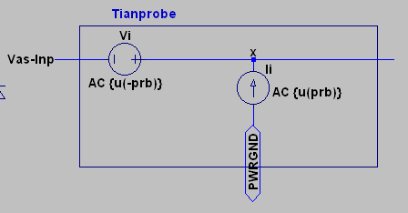

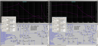

Toni, its not clear where your Tian probe is connected.you are right. The simulation shows a relatively small PM in inner loop. Maybe "Rm2" is a bit oversized. If Rm2 is reduced from 100R to 68R the balance between inner and outer loop GM/PM values are looking better.
Are the 2 plots of the same compensation method? Are you using the Tian probe from the LTspice library?
Also, if C18 (at the LTP i/p) is not connected, you can't guarantee stability if the i/p is open circuit. Even if the i/p is short circuited, the absence of C18 will lead to different stability conditions.
This is true both for LTspice as well as 'real life'.
think, Dave wanted to save "virtual wires"
The 2 plots are using the same circuit and the same compensation only "Rm2" was changed from 100R to 68R. Left plot is outer loop stability, right plot is inner loop stability.
If C18 is connected, the stability betters a few db (for me it's not clear why).
The "Tianprobe" is from LTspice lib. I have added this function to the "plot.defs" file:
.func TianProbe() {-1/(1-1/(2*(I(Vi)@1*V(x)@2-V(x)@1*I(Vi)@2)+V(x)@1+I(Vi)@2))}
BR, Toni
... Even if the i/p is short circuited, the absence of C18 will lead to different stability conditions.
