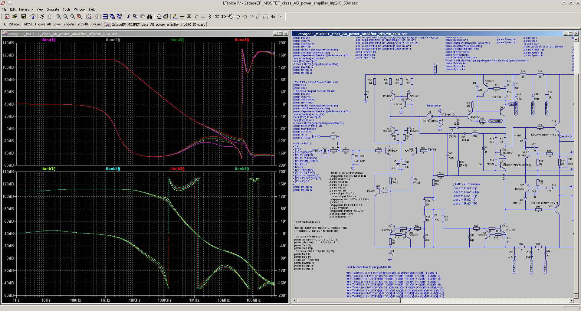

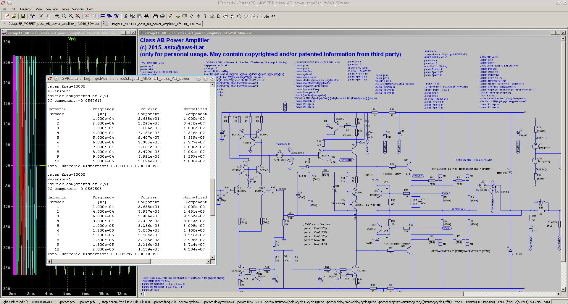

Simulation only: 50W/8R MOSFET amplifier for mid and treble in a 3 channel active crossover power amplifier:
BR, Toni
- combined TMC/Cherry compensation
- using 2x30V AC for supply
- THD20k@50W@8R: 0.0003 %
- overall PM 80, GM16
BR, Toni
Simulation shows good and stable results but will it work on breadboard?
BR, Toni
Hi Toni,
Nice to have you back here, very nice amp. I suggest you to bootstrapped the cascode biasing instead referenced to the ground, and you can have some THD improvement (Q19 on the attached picture). By the way I think that you need to increase the zener (D6) current to pass the knee.

Thx for the hints and the nice words!
Have incorporated your recommendations. Attached the corrected version.
BR, Toni
LTspice allows capacitors with value zero!
"Ctian" will be used for switching inputs to ground using 1kF cap during calculating "Tianprobe B".
BR, Toni
BR, Toni

The ULGF is pushed pretty far up and PM is not conservative, to say the least. I assume you have checked this as the output transistors approach the rails. You think this is adequate?

Dear David,
thanks for checking this. Any recommendations are always highly welcome. As it is a work in progress I have it pushed to the limits watching for instabilities (e.g. square wave overshoot, oscillation ...).
Phase margin of the global loop looks to be over 60°. This should be plenty, no?
The phase margin of the inner loop is much smaller, perhaps you are referring to this? In my experience it can be difficult to get the phase margin much bigger without severely compromising the global loop. I’ve never investigated the sensitivity of the inner loop to component and operating variations so I don’t know if one can get away with these small margins.
Maybe. I was almost shocked to see how much PM was reduced once I included a bit of capacitance in the load and simulated near peak amplitude, to reduce the output transistor Vce.
That was in my own BJT test amp, Paul made similar comments after I recommended he try such tests on his similar, BJT amp.
Not sure how it will work out here.
Yes, the inner loop looks a bit scary to me....of the inner loop is much smaller... In my experience it can be difficult to get the phase margin much bigger without severely compromising the global loop. I’ve never investigated the sensitivity of the inner loop to component and operating variations so I don’t know if one can get away with these small margins.
40 MHz so parasitics will matter, and not much room for error.

PS I posted a little on the problem of simultaneous optimization of the two loops, not easy but possible.
A hint how to do this?...
Maybe you can add a link to this? Thx!
BR, Toni

Could you clarify, as it is not visible in the screenshot - presumably the amplifier has a zobel (RC) on its output to ground, and then a series L (possibly with a parallel R) before the actual output terminal, and it is the actual output terminal at which these load networks are being connected?

I am pretty happy with this. I was able to land the phase peak square on top of the ULGF for both the inner and outer loop simultaneously.
Attached after output zobel. Have a look at the previously attached asc file.
BR, Toni
Added capacitive loads:
Looks like the Zobel isolates the amp pretty well, just like it is intended to.
This was my experience also, I tried without a Zobel but the deterioration in stability was severe just to eliminate a few simple parts.
A Zobel is practically essential if you want robust stability.
Best wishes
David
Output Zobel is the R+C from output to ground.Looks like the Zobel isolates the amp pretty well, just like it is intended to.
The Thiele Network has both and R+C to ground and an L||R in series before the speaker terminals.
Are either of your referring to the L||R part of the Thiele Network?
