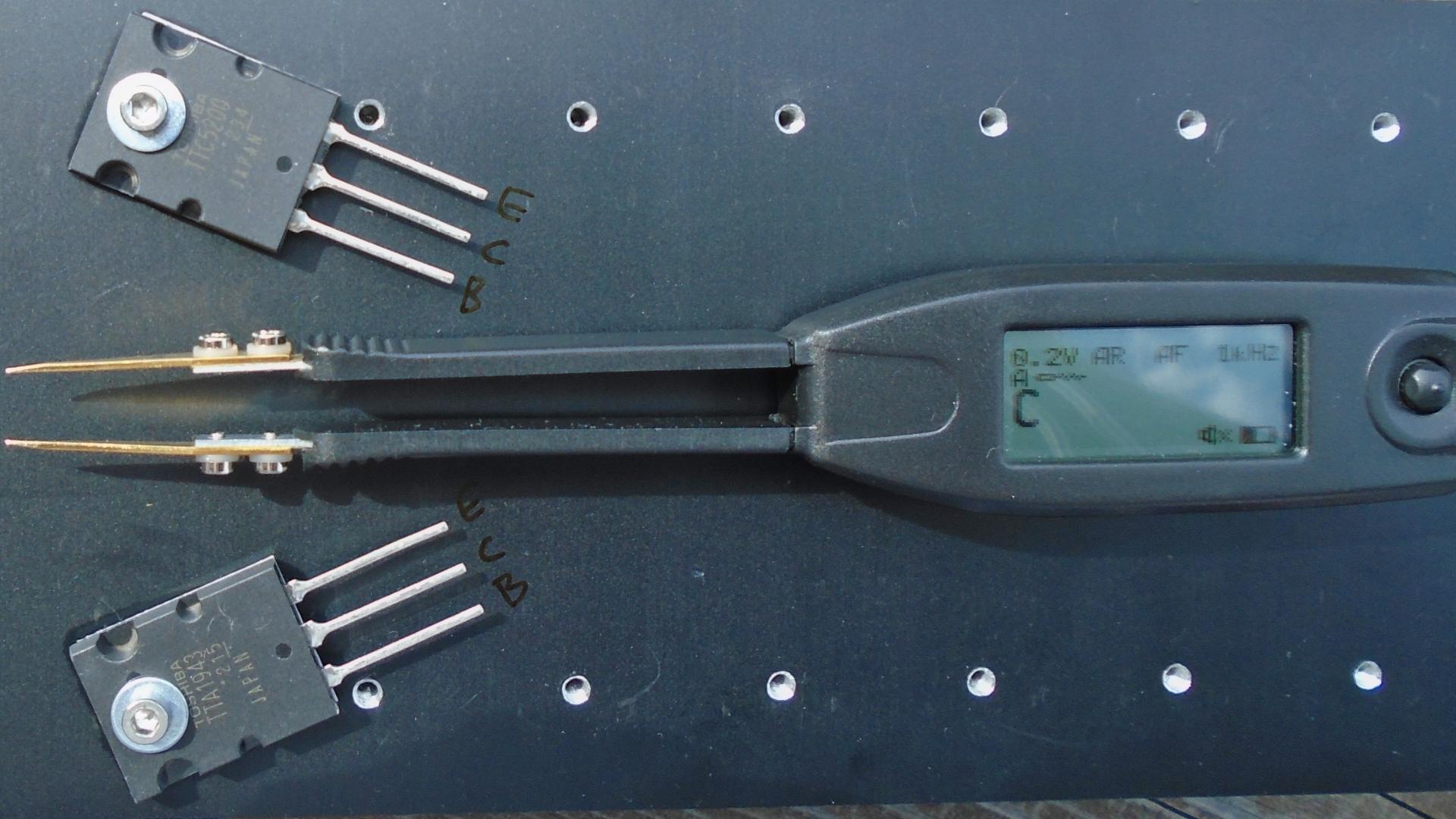

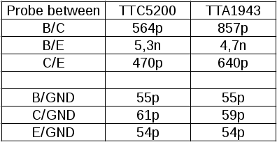

Here some measurements using single mounted BJTs (isolation provided by keratherm red 86/82). Collector of BJT's is internally electrically connected with copper back plane. The copper backplane has a capacitance of about 59p-61p to the heatsink per BJT (TTC5200/TTA1943).
Measurement frequency was 200mV RMS @ 10kHz
Now the (noob = me) question: can the measured 54p between emitter and heatsink/GND completely be ignored as they are measured in series with collector/emitter which is already included in the bjt spice model or is this stray capacitance at least partially effective?

That's not a noob question Actually I think it's a pretty subtle one.
I suspect the capacitance from the output to the heat-sink is screened by the collector metalwork Seems that the metal plate should act as a Faraday shield but it's not obvious to me. Hmm.

The power device backplate is electrically the same as the Drain/Collector of the device.
Capacitance between backplate and surroundings is effectively the same as capacitance from Drain/Collector to surroundings.
For a Lateral mosFET where Source is the backplate, it is equivalent to Source to surroundings capacitance.
Thought about. Think Harry is right. The measured emitter capacitance to the copper plate capacitance is only seen through the bjt's internal capacitance. C/E capacitance is about 10 times bigger as the C/GND capacitance. Real capacitance from emitter to copper would be very low due to the small die size. So the measured capacitance is more or less only another (but small) blocking capacitor from collector to GND.

...Real capacitance from emitter to copper would be very low due to the small die size...
So we are all in accord that the effective value is much smaller than you measured?
Best wishes
David
And therefore not much of a problem?
Best wishes
David
No problem - only if we would use lateral MOSFETS where source is connected to copper plate.

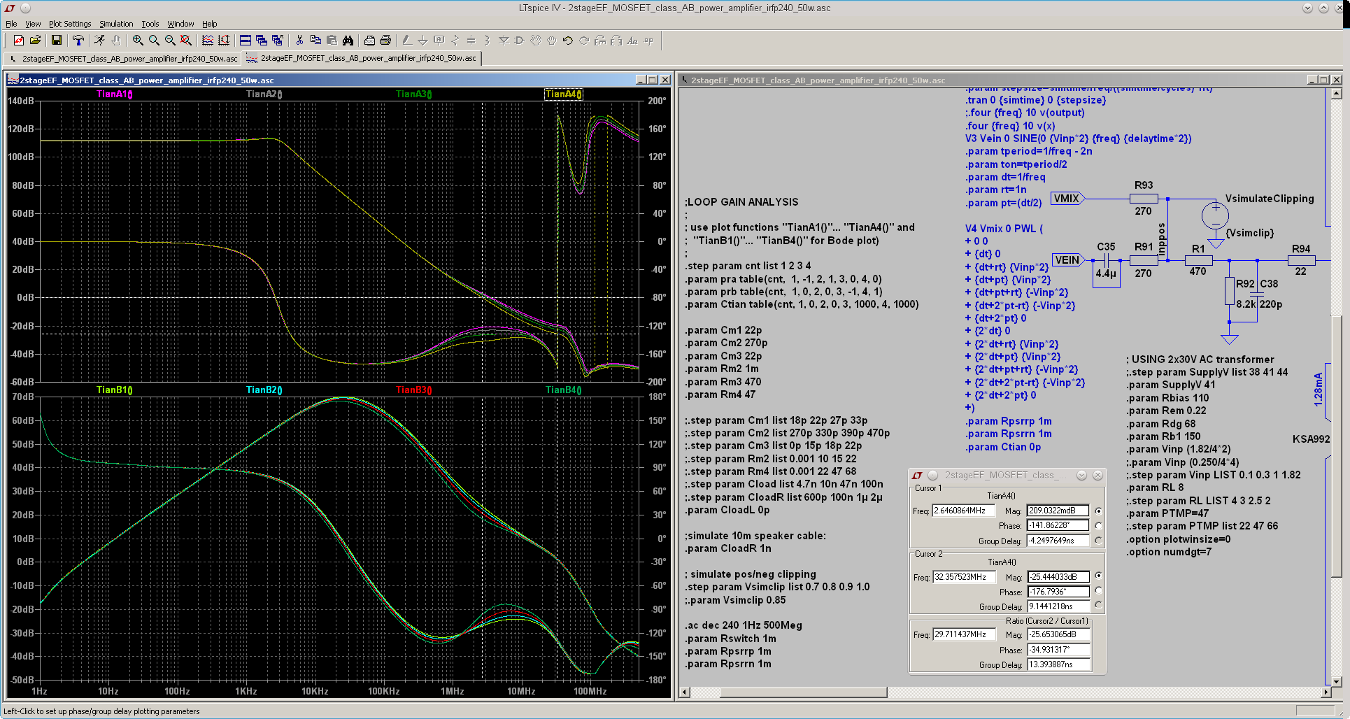

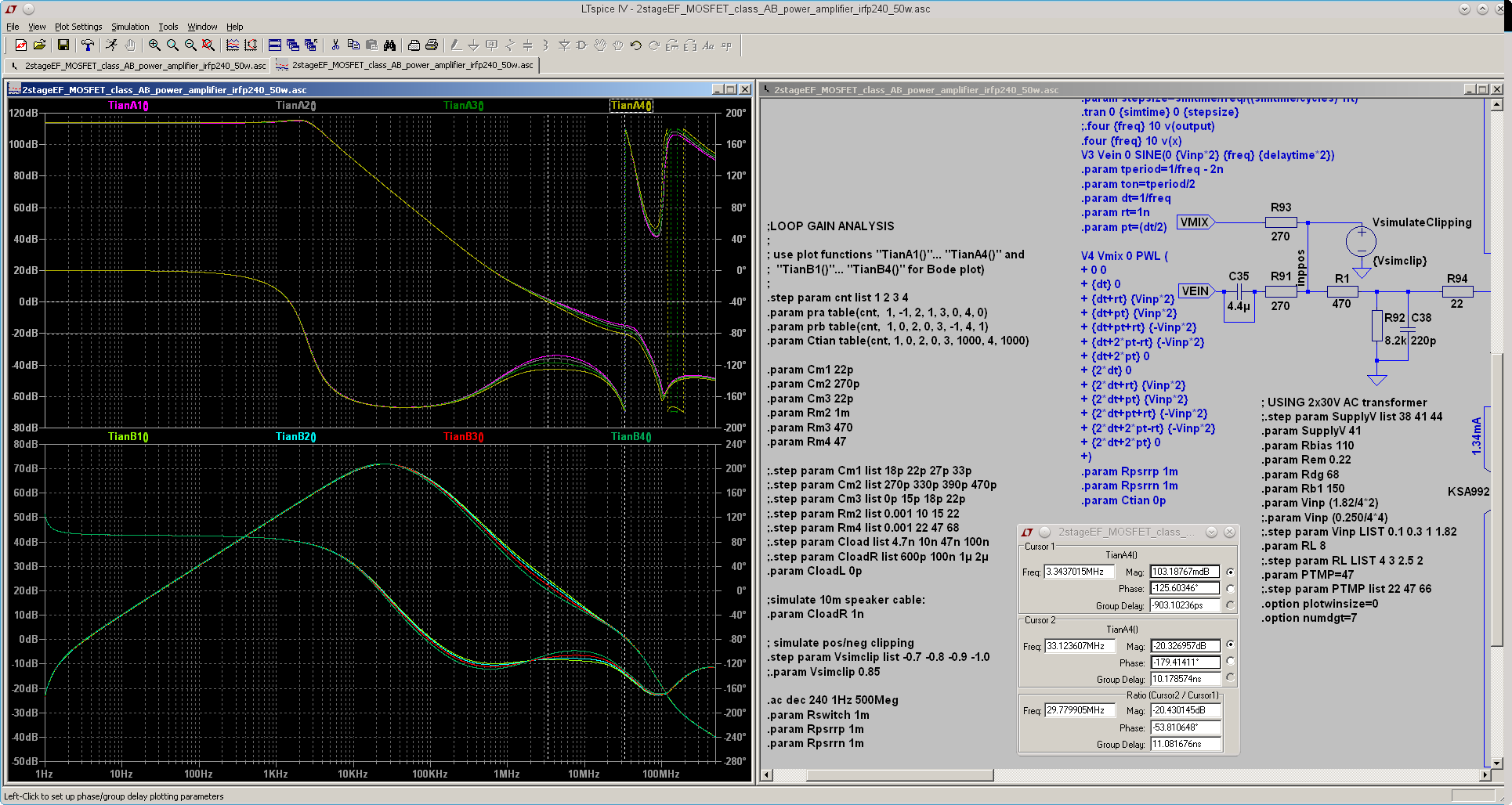

Stability near clipping
Some findings...
during positive offset:
during negative offset;
This may explain an old real life measurement result in this thread: during cherry compensation tests oscillations where mostly seen at positive halfwave near clipping.
Some findings...
- as phase margin decreases, gain margin increases
- stability is better during negative halfwave
...positive offset...
Looks like you have used my technique, you have any problems, comments or ideas for improvements?
Your results show a bit less loss of PM than mine, perhaps (probably?) because your VMOSFET outputs lose a bit less speed than the BJTs in my simulation.
Always of interest to see how different circuits respond.
Also I use a symmetrical circuit with push-pull VAS so +ve and -ve are similar.
Best wishes
David

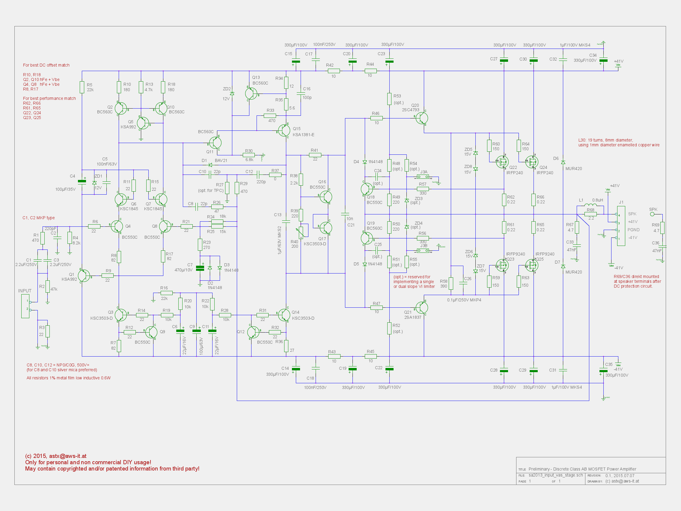

... for this 50W mosfet amplifier I'm already using the new models from Bob Cordell (I have added the IRFP*Ckst models to the "Cordell-Models.txt" file - see asc and "needed_libs.zip" some posts above)
Thx, Toni
... as the preliminary schematic is nearly finished ...
Hi Toni
By coincidence I have just posted a few comments on Bob's thread about why I don't think the current mirror helper transistor is the best choice.
I won't repeat them here because they are easy to find but I think they apply to your circuit too.
Best wishes
David

Very nice "wolverine" , ASTX !
I'm kidding , but you are SO close (2 CCS's , EF for the cascode reference).
Your bias spreader is the same as the slew red LED referenced Vbe for the Vfet OPS.
Besides the CM "helper" , I can just about assure you no "magic smoke"
out of your design , just <10ppm 20K !
Great work!
Edit - C12/C10 E. stuart recommends 4:1 - 5:1 ratio TMC ? I use 330/68pF ?
OS

Thx!
Just done a GM/PM comparison using CM with/without helper bjt:
Without helper bjt:
near pos. clipping: PM worsens about 3dB
near neg. clipping: PM betters about 2dB
GM variation stays within 1dB.
As the PM is in general much better at neg. clipping I would keep the CM helper bjt in place as we get 3dB more PM at pos. clipping where we really need more stability.
Can you verify this behaviour?
BR, Toni
