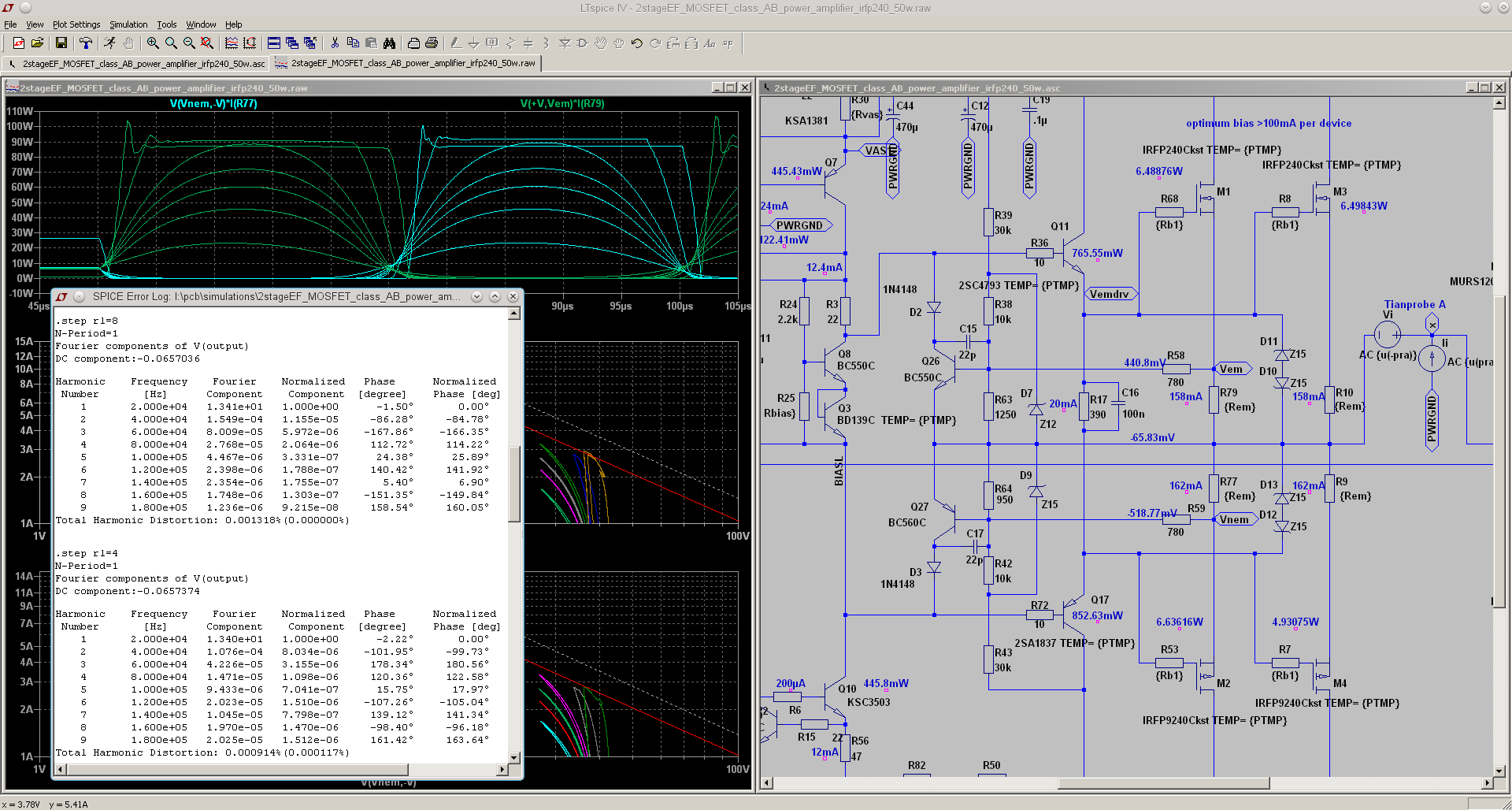

Very nice "wolverine" , ASTX !
I'm kidding , but you are SO close (2 CCS's , EF for the cascode reference).
Your bias spreader is the same as the slew red LED referenced Vbe for the Vfet OPS.
Besides the CM "helper", I can just about assure you no "magic smoke"
out of your design , just <10ppm 20K !
Great work!
Edit - C12/C10 E. stuart recommends 4:1 - 5:1 ratio TMC ? I use 330/68pF ?
OS
Dear OS,
thx for your kind words. Would say 2StageEF/SA2013-SA2015 and Wolverine are both blameless derivates ...
TMC/Cherry compensation was more or less a result of many iterative simulations hence the 10:1 ratio of the TMC capacitors. Without the Cherry component the ratio would be about 5:1.
BR, Toni

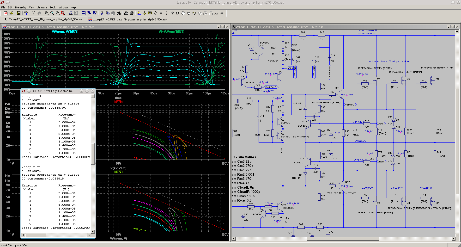

best SOA or best THD performance ...
Adding 1 more output pair helps a lot to get a good THD figure down to 3R load...
maybe I am not reading it correctly but you seem to be showing that adding a 3rd pair gives both better THD and better SOA.
Why does your header say "or"
D.Self (for BJTs) showed way back that adding an output pair results in significant lowering of distortion.
His "Load Invariant" paper was all about this.
It is simply the same header/topic/title/paragraph where the two posts belong to.
Of course you are right, that the second picture showed better THD and SOA headroom.
But I'm not sure, if the SOA protection is implemented correctly because I have removed the resistors in series with the Z-diodes due to very high distortion. More simulation tests have to be done...
BR, Toni

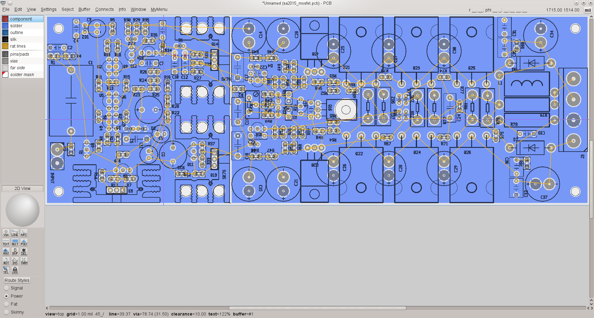

I have been looking for an amp with this power. How far would it be from a possible pcb GB? Another dumb/lazy question - how low loads would be safe to load it with? Is it short proof? Anyone who have a link to fitting analog meters for this one - I know - bells and whissles but I'm a sucker for that kind of bling-bling
Then of course I would need to have the right sized heathsink pointed out for me and probably others. Better to trust the ones knowing what they are doing
When this seems to materialize in the real world - I will of course read the whole thread.
Regards
Regards
I have been looking for an amp with this power. How far would it be from a possible pcb GB? Another dumb/lazy question - how low loads would be safe to load it with? Is it short proof? Anyone who have a link to fitting analog meters for this one - I know - bells and whissles but I'm a sucker for that kind of bling-bling.
Then of course I would need to have the right sized heathsink pointed out for me and probably others. Better to trust the ones knowing what they are doing.
Dear Turbon,
- If the new SA2015 (=50W@8R MOSFET) works as expected, maybe there will be a group buy...
- This amplifier is designed to be short circuit proof. 2R resistive load is acceptable but with higher distortion. It should be save to drive 8 and 4 Ohm speakers.
- Heat sink size depends on your idle bias settings.
- The SA2014 (=200W@8R BJT amplifier) may be short circuit proof if your power supply is fitted with a 600 - 650VA toroid per channel.
BR, Toni

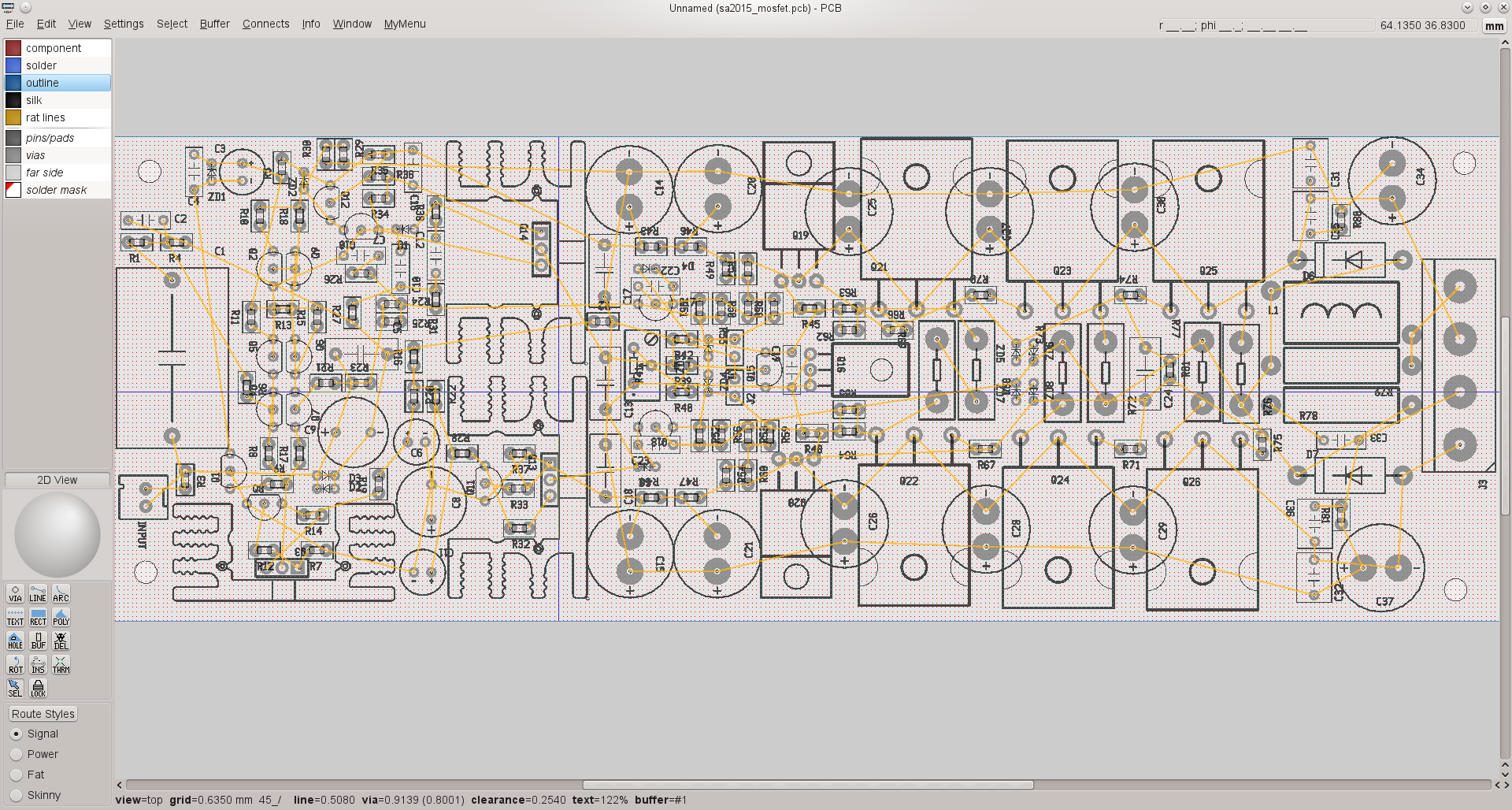

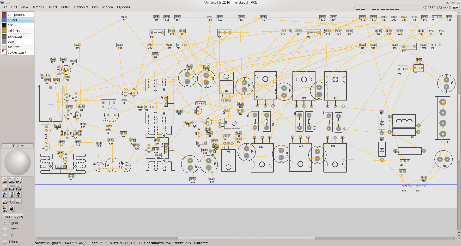

Hi Toni
Do you output your LTSpice simulation as a netlist and then import into PCB? I have started with D.Spark but wonder about other options.
Best wishes
David
Dear Dave,
AFAIK pcb from geda project doesn't have an import function to read asc files.
I always have to redraw the LTspice asc using gschem from geda project...
![sad :sad: :sad:](https://files.diyaudio.com/forums/images/smilies/sad.gif)
BR, Toni
