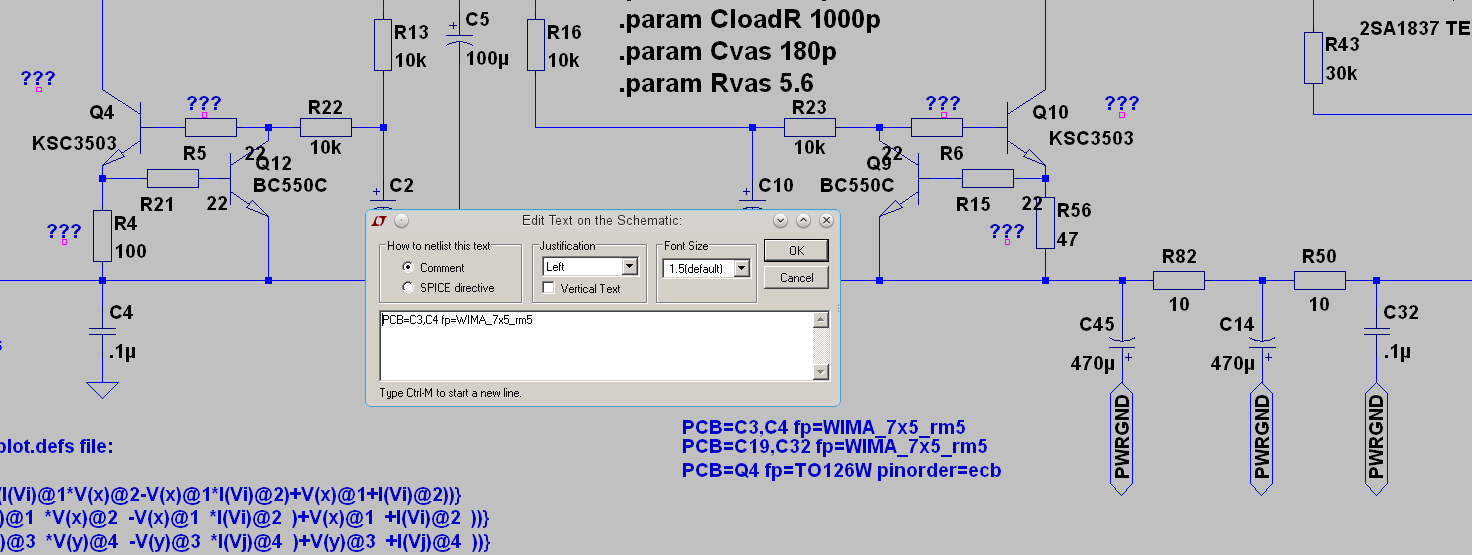

LTSpice2PCB / beta testers
Forward annotation works!
pcb/geda specific values can be directly inserted in your ltspice schematic as comments like attached picture.
Beta testers wanted.
You need following software installed:
BR, Toni

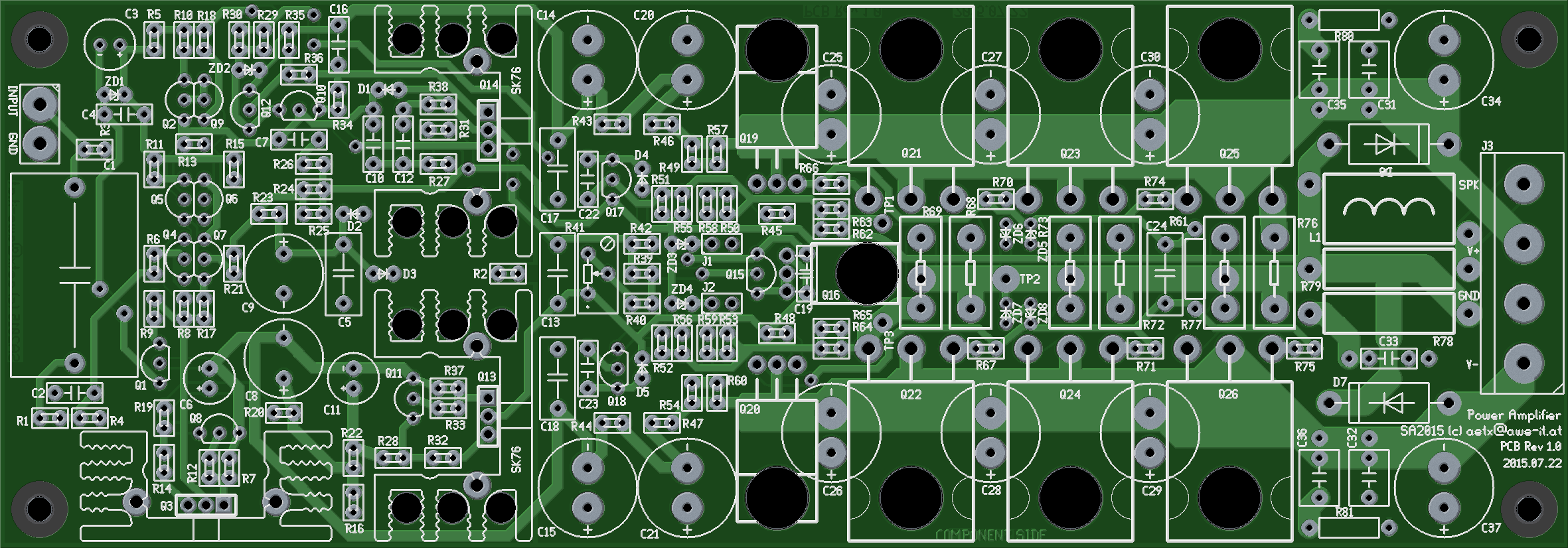

Regarding LTSpice2PCB: I have good news for you! Today I have written a perl program which is able to read a LTspice "asc" and LTspice "WireList netlist" file and generates a BOM (first step) and a pcb/geda readable part/netlist file (2nd step - needs BOM file with added footprint data).
Generated BOM with added footprint and pin renumbering data looks currently like:D13 zener diode_zener_rm2.54 <remap> Z15Fields are delimited by "TAB". Field number 1,2,5 are provided by converter program, field 3 and 4 is "footprint" and "pin reordering" (e.g. ebc, cbe or 3,1,2). A newer version could contain footprints as comments in the asc file (e.g.: "; footprint Q3=TO126_FLAT").
L1 ind diode_zener_rm2.54 <remap> 0.8µ
L2 ind diode_zener_rm2.54 <remap> 1.4mH
L3 ind diode_zener_rm2.54 <remap> 10mH
L4 ind diode_zener_rm2.54 <remap> 0.33mH
M1 nmos TO247AC gds IRFP240Ckst
M2 pmos TO247AC gds IRFP9240Ckst
M3 nmos TO247AC gds IRFP240Ckst
M4 pmos TO247AC gds IRFP9240Ckst
M5 nmos TO247AC gds IRFP240Ckst
M6 pmos TO247AC gds IRFP9240Ckst
Q1 pnp TO92-KL cbe BC560C
Q2 pnp TO92-KL cbe BC560C
Q3 npn TO126_FLAT ecb KSC3503
Pin number conversion is also done automatically for npn, pnp, njf, pjf,nmos,pmos,polcap,diode ...
Simple variables will be expanded too (e.g.: {Rbias} will be replaced by the latest active .param statement).
LTspice2PCB forward annotation is currently untested but may work too.
Attached a successful imported asc file from the current 50W MOSFET amplifier (footprints are not always the correct one - was only for 1st test)
If there is some real interest I will provide this as an opensource toolkit.
BR, Toni
- PCB/Geda version >= pcb-20140316
- perl >= 5.8.7
BR, Toni

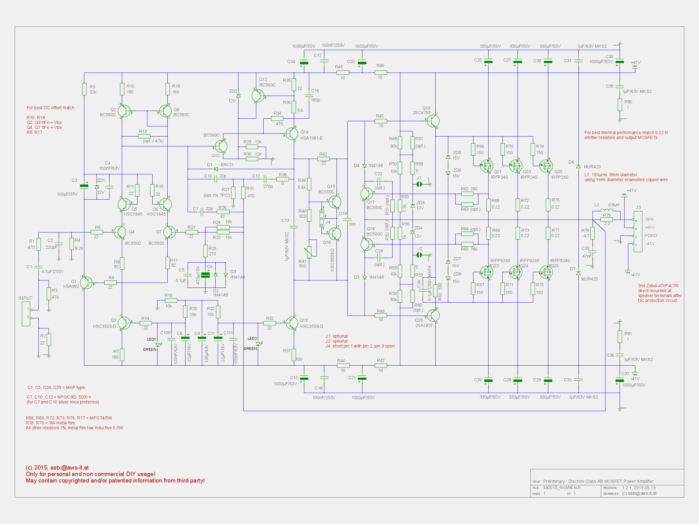

For SA2014/400W rev 3.4.2 amplifier (partially old name is SA2013) you will need:
- Latest valid PCB gerber files for input/VAS and output stage board can be found in post # 979 and 980
- PCB gerber files for power supply for one channel in post # 993
- Latest schematic in post # 1145 and corrected BOM in post # 1146
- R28 (100R) needs to be reduced to 68R to get some extra PM stability.
- "asc" files can be found in post #1149
SA2015 is in development and there exists no final schematic nor pcb gerber files.

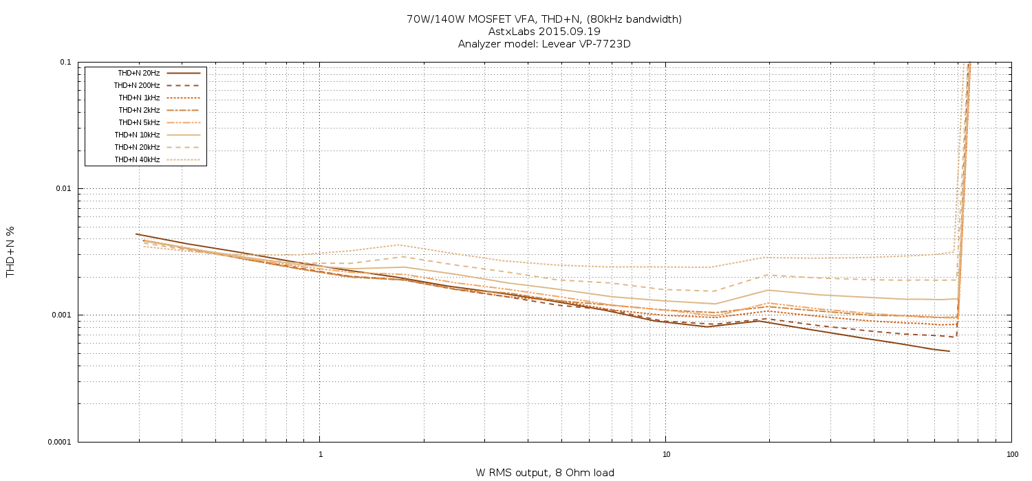

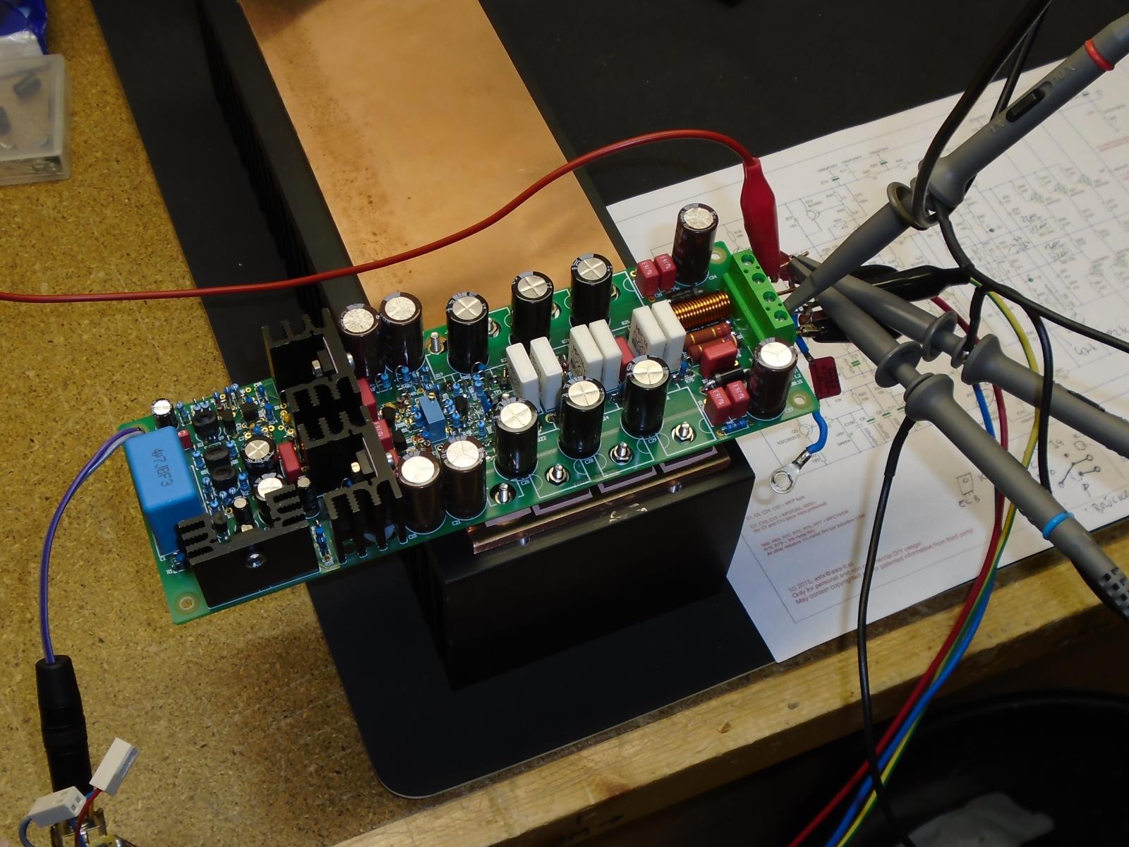

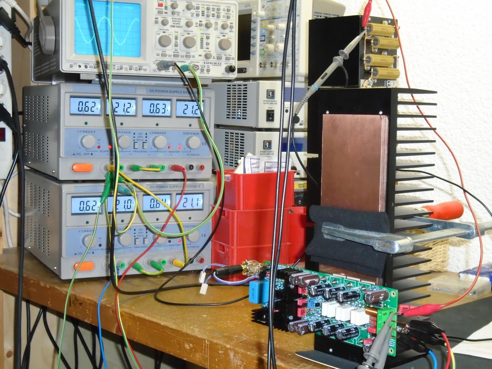

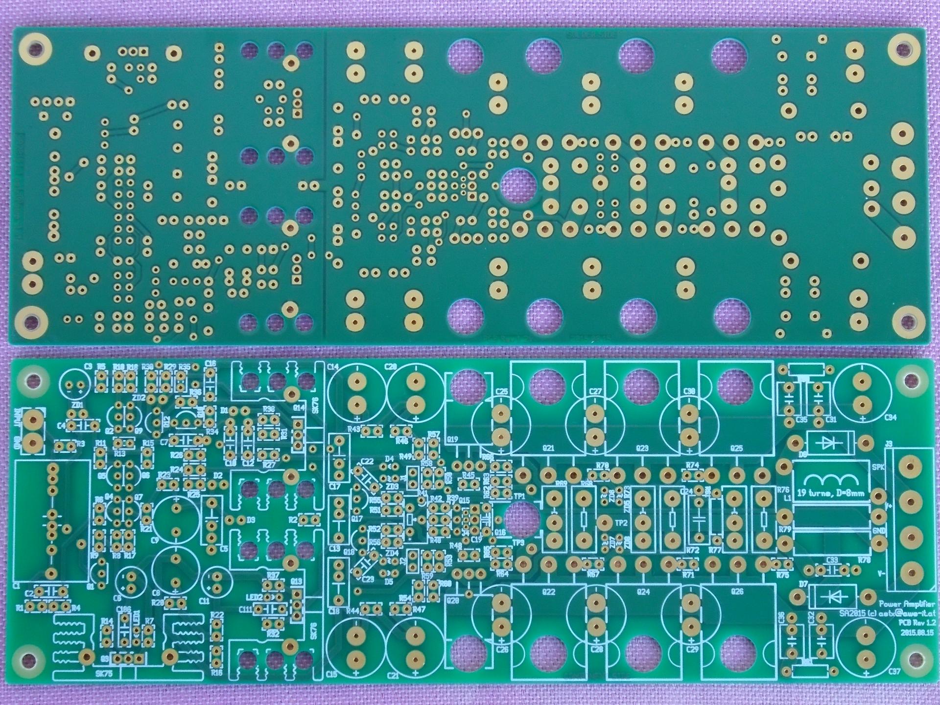

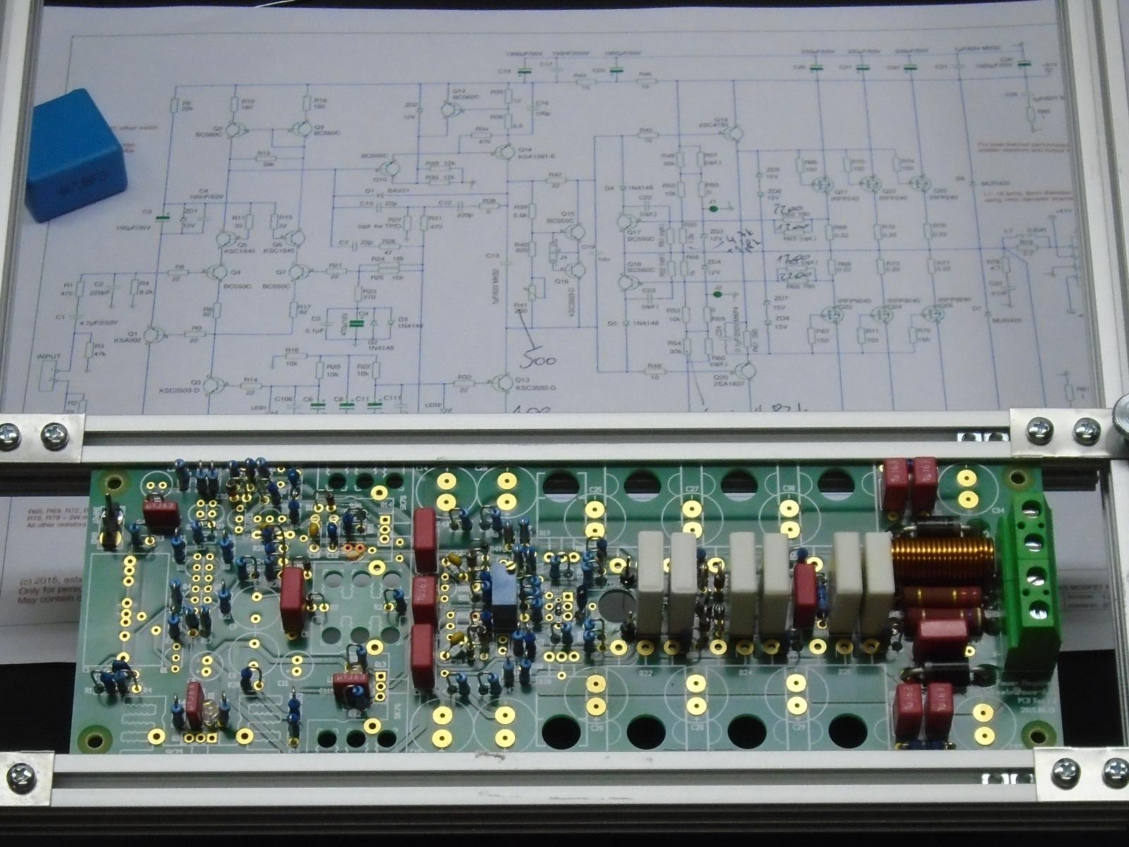

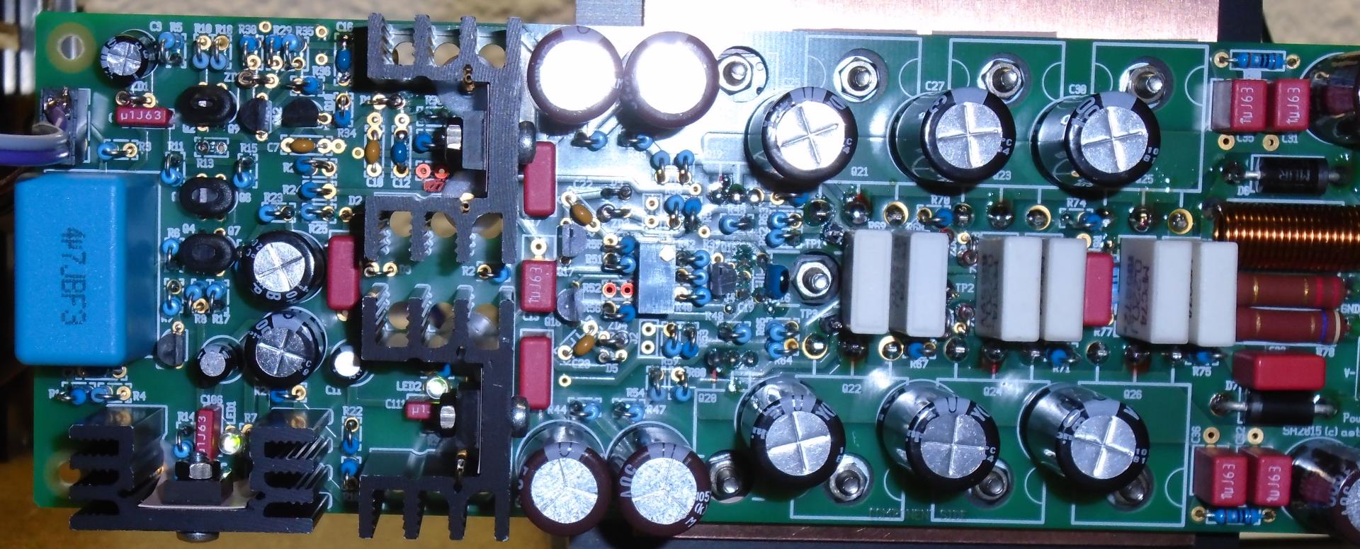

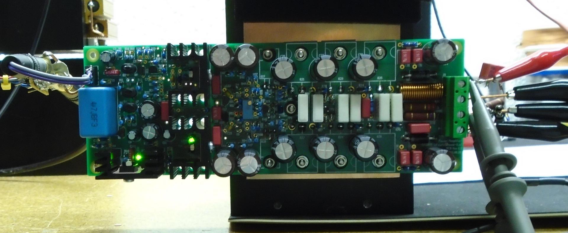

2stageEF 50W MOSFET - aka SA2015MT
... works out of the box 🙂🙂🙂 without holy smoke

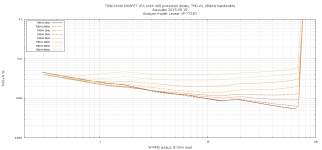

at a maximum of 1% THD+N, bw 80kHz:
overall THD+N < 0.004% from 20Hz - 20kHz, bw 80kHz
BR, Toni

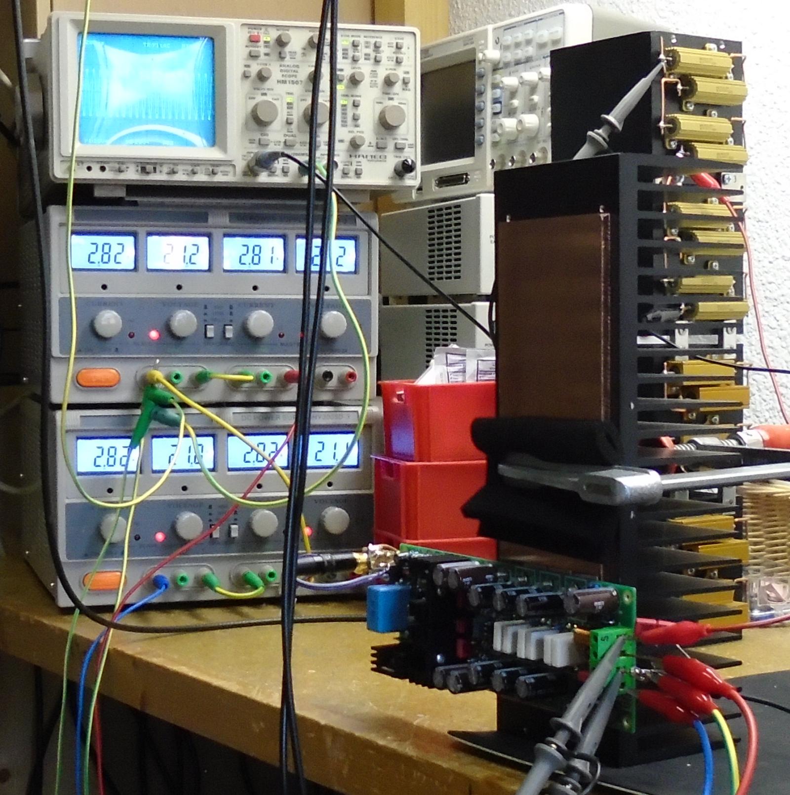

- Quicktest with +/- 42V regulated power supply
- Bias 450mA (150mA per mosfet)
- max. 82W RMS output power 8R load
- max. 145W RMS output power 4R load
- 50W RMS output power 8R load
- 100W RMS output power 4R load
BR, Toni

... want more measurement data?
- +/-42V regulated power supply.
- bias 450mA (150mA per MOSFET)
- slew rate > 90V/µS with input filter in situ
- 8R resistive load, bw 80 kHz
- no VAS protection diode installed
- 104 db full bw
- 111 dB 80kHz bw
- 119 dB A weighted

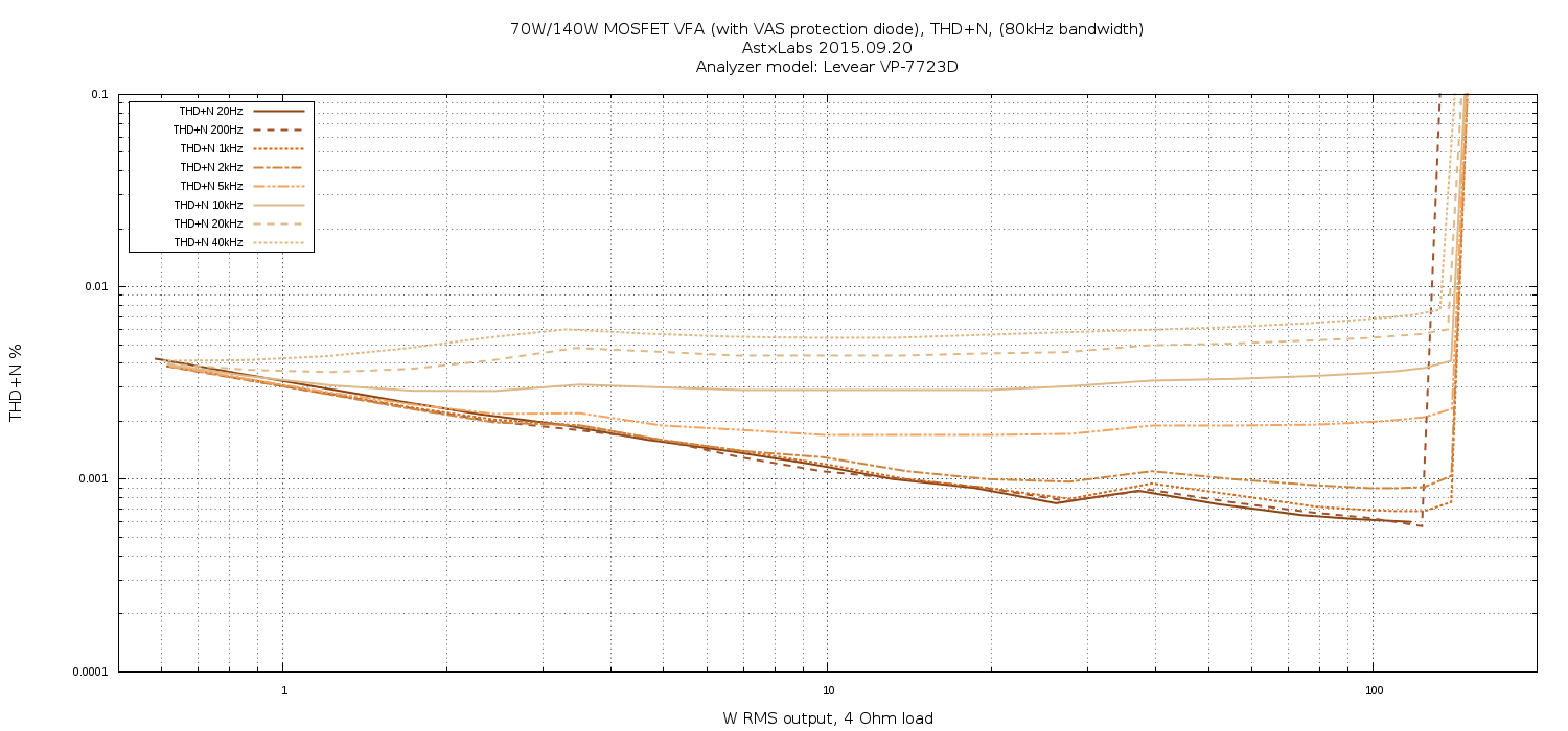

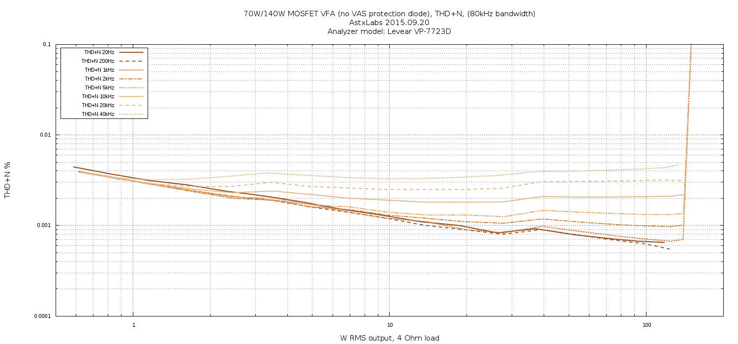

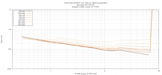

... attached 4R resistive load measurements.
THD+N measurements of output power above 120W@4R where not always possible due to current limiter of regulated power supply.
Right picture views current consumption on 10kHz / 140W / 4R output power test. Total power delivered by power supply ~ 240W
BR, Toni
BR, Toni

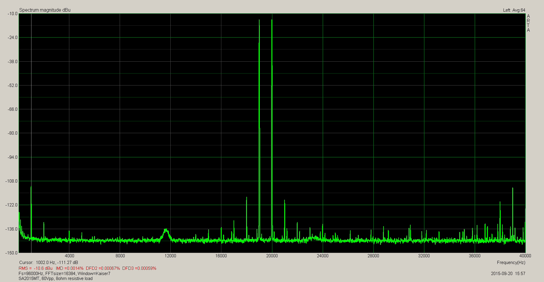

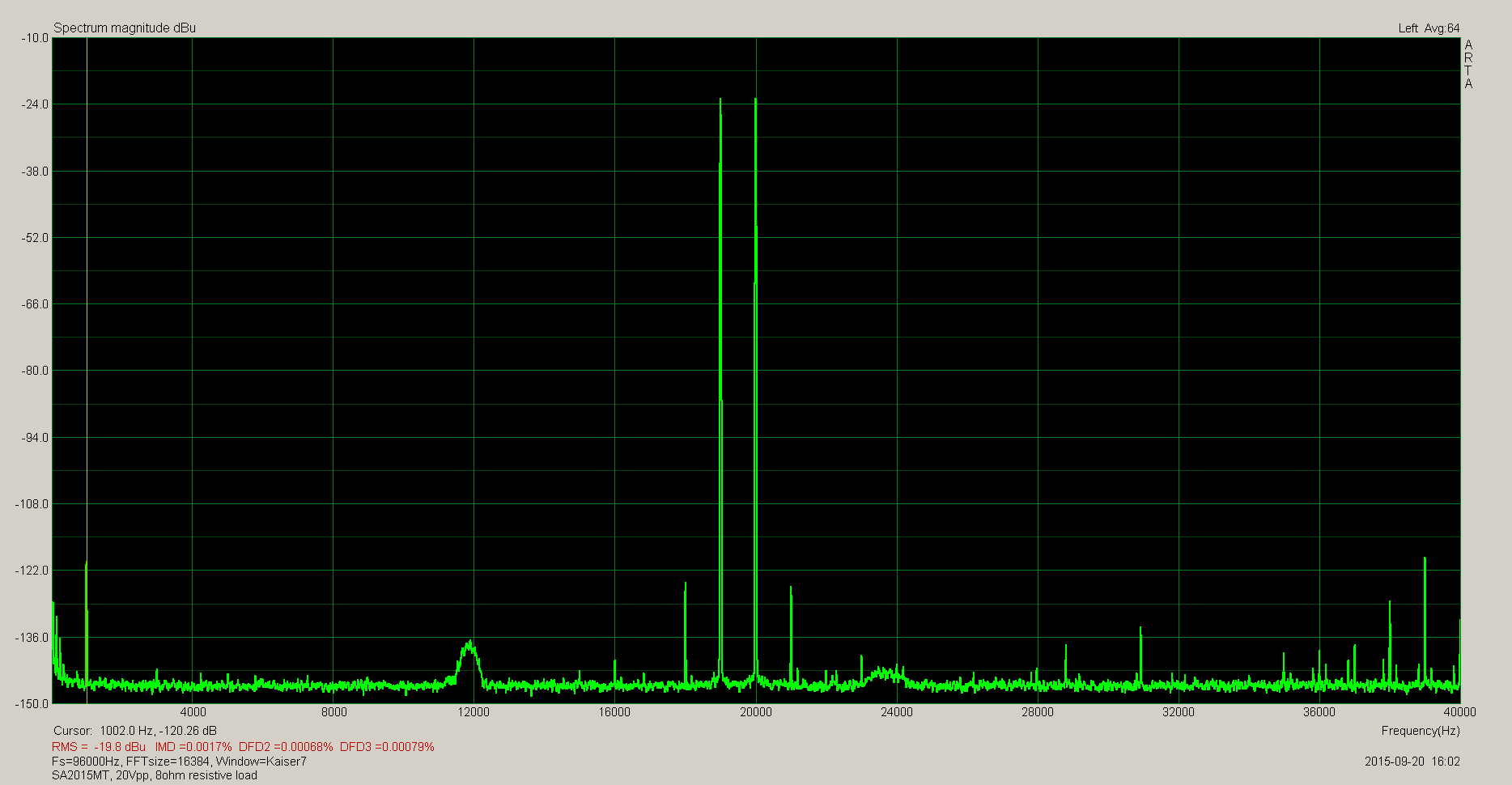

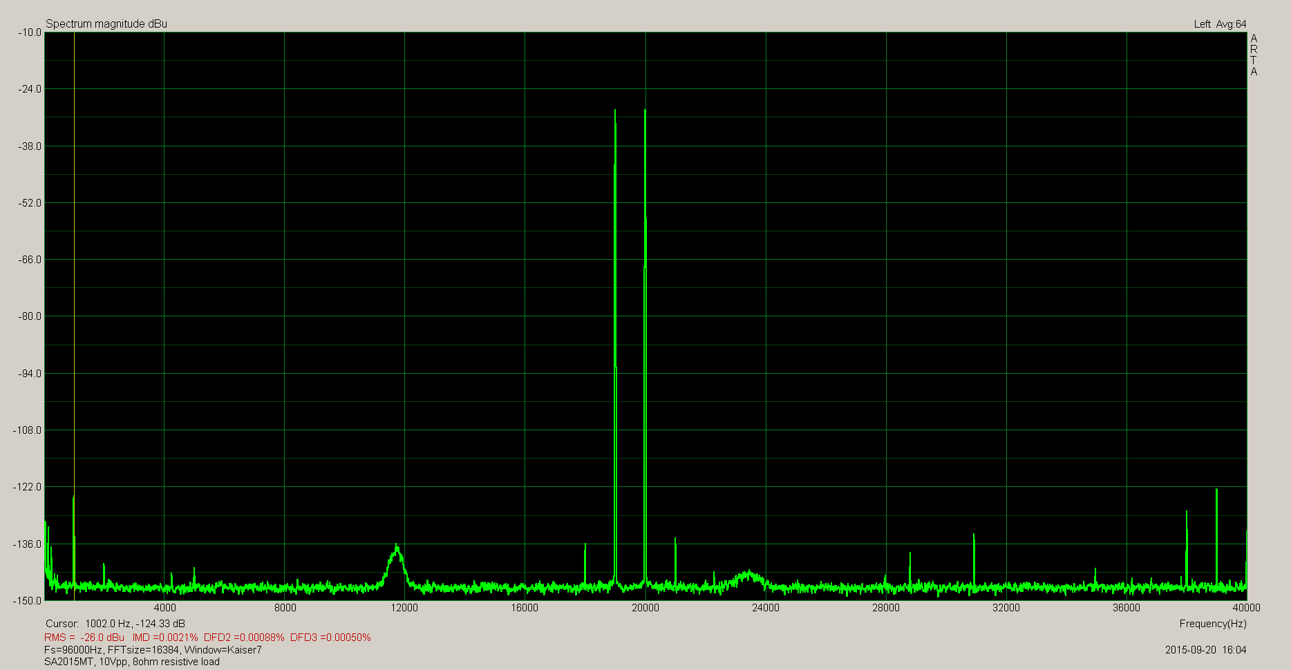

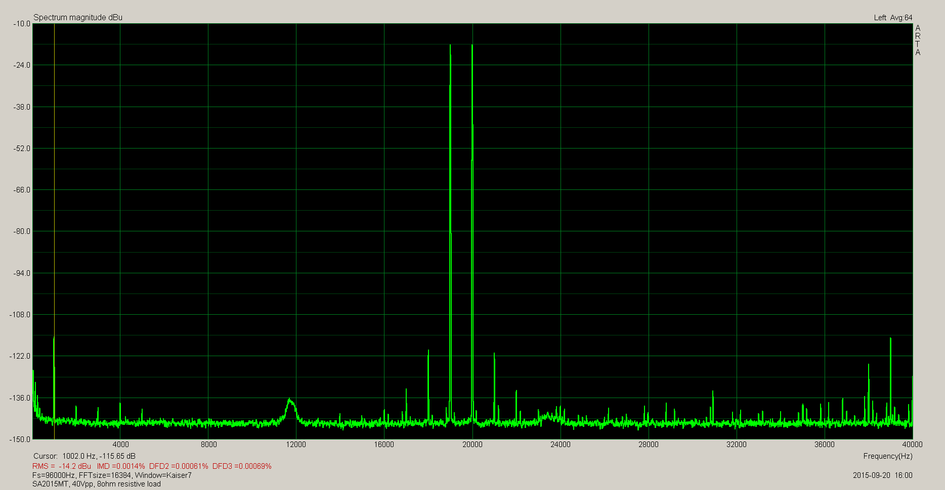

IMD measurements
No VAS diode installed:
0.0021% IMD @ 10Vpp @8R
0.0017% IMD @ 20Vpp @8R
0.0014% IMD @ 40Vpp @8R
0.0014% IMD @ 60Vpp @8R
IMD measurements
IMD measurements
