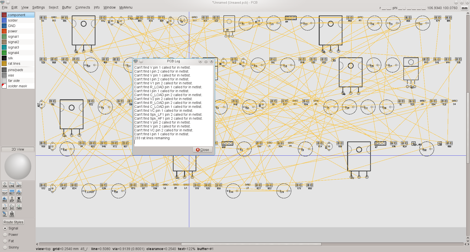

Regarding LTSpice2PCB: I have good news for you! Today I have written a perl program which is able to read a LTspice "asc" and LTspice "WireList netlist" file and generates a BOM (first step) and a pcb/geda readable part/netlist file (2nd step - needs BOM file with added footprint data).
Generated BOM with added footprint and pin renumbering data looks currently like:
D13 zener diode_zener_rm2.54 <remap> Z15
L1 ind diode_zener_rm2.54 <remap> 0.8µ
L2 ind diode_zener_rm2.54 <remap> 1.4mH
L3 ind diode_zener_rm2.54 <remap> 10mH
L4 ind diode_zener_rm2.54 <remap> 0.33mH
M1 nmos TO247AC gds IRFP240Ckst
M2 pmos TO247AC gds IRFP9240Ckst
M3 nmos TO247AC gds IRFP240Ckst
M4 pmos TO247AC gds IRFP9240Ckst
M5 nmos TO247AC gds IRFP240Ckst
M6 pmos TO247AC gds IRFP9240Ckst
Q1 pnp TO92-KL cbe BC560C
Q2 pnp TO92-KL cbe BC560C
Q3 npn TO126_FLAT ecb KSC3503
Fields are delimited by "TAB". Field number 1,2,5 are provided by converter program, field 3 and 4 is "footprint" and "pin reordering" (e.g. ebc, cbe or 3,1,2). A newer version could contain footprints as comments in the asc file (e.g.: "; footprint Q3=TO126_FLAT").
Pin number conversion is also done automatically for npn, pnp, njf, pjf,nmos,pmos,polcap,diode ...
Simple variables will be expanded too (e.g.: {Rbias} will be replaced by the latest active .param statement).
LTspice2PCB forward annotation is currently untested but may work too.
Attached a successful imported asc file from the current 50W MOSFET amplifier (footprints are not always the correct one - was only for 1st test)
If there is some real interest I will provide this as an opensource toolkit.
BR, Toni

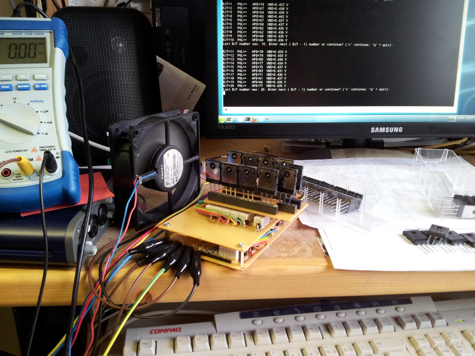

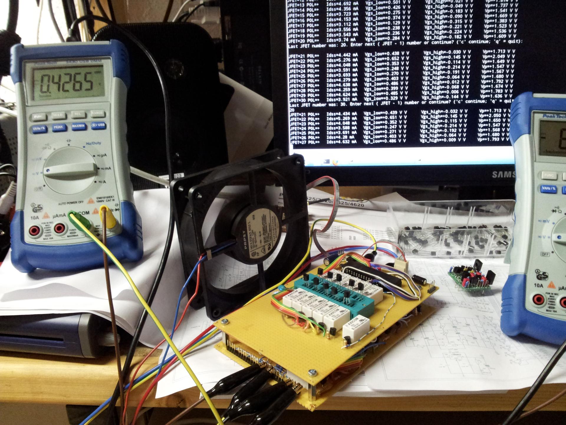

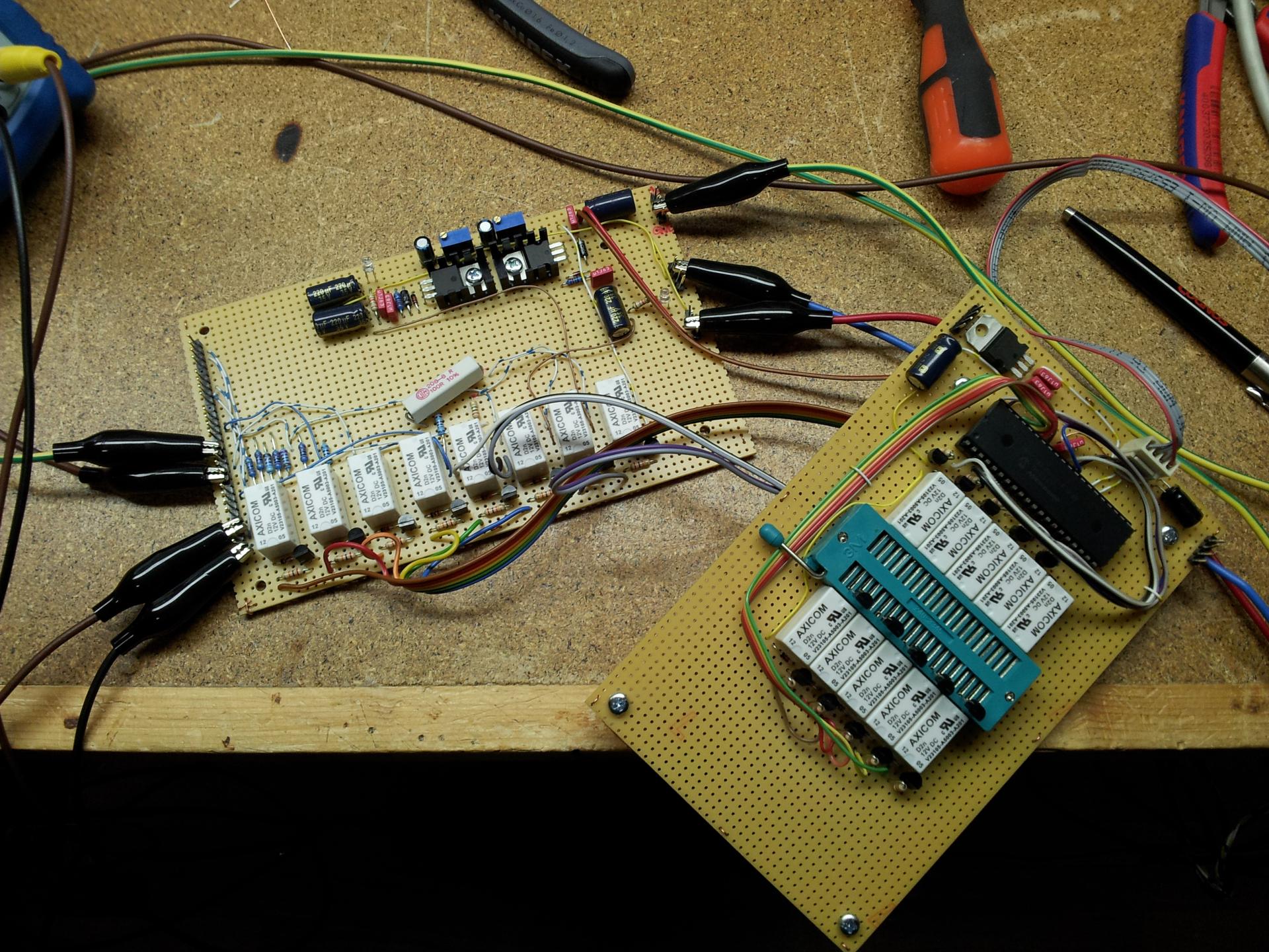

Some parts are missing and MOSFETs have to be matched for the 200W CFA and also for my new 50W MOSFET VFA.
Attached some pictures from my "mass transistor matcher" prototype in action.
... more in ~ 1 or 2 weeks ... 😉
BR, Toni
