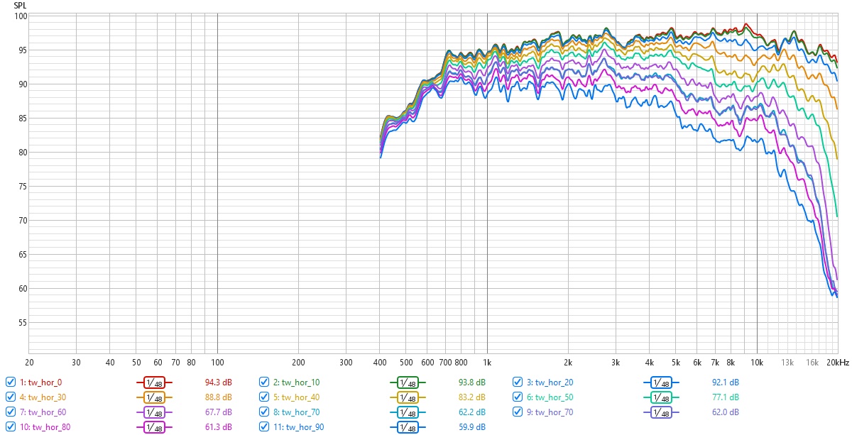

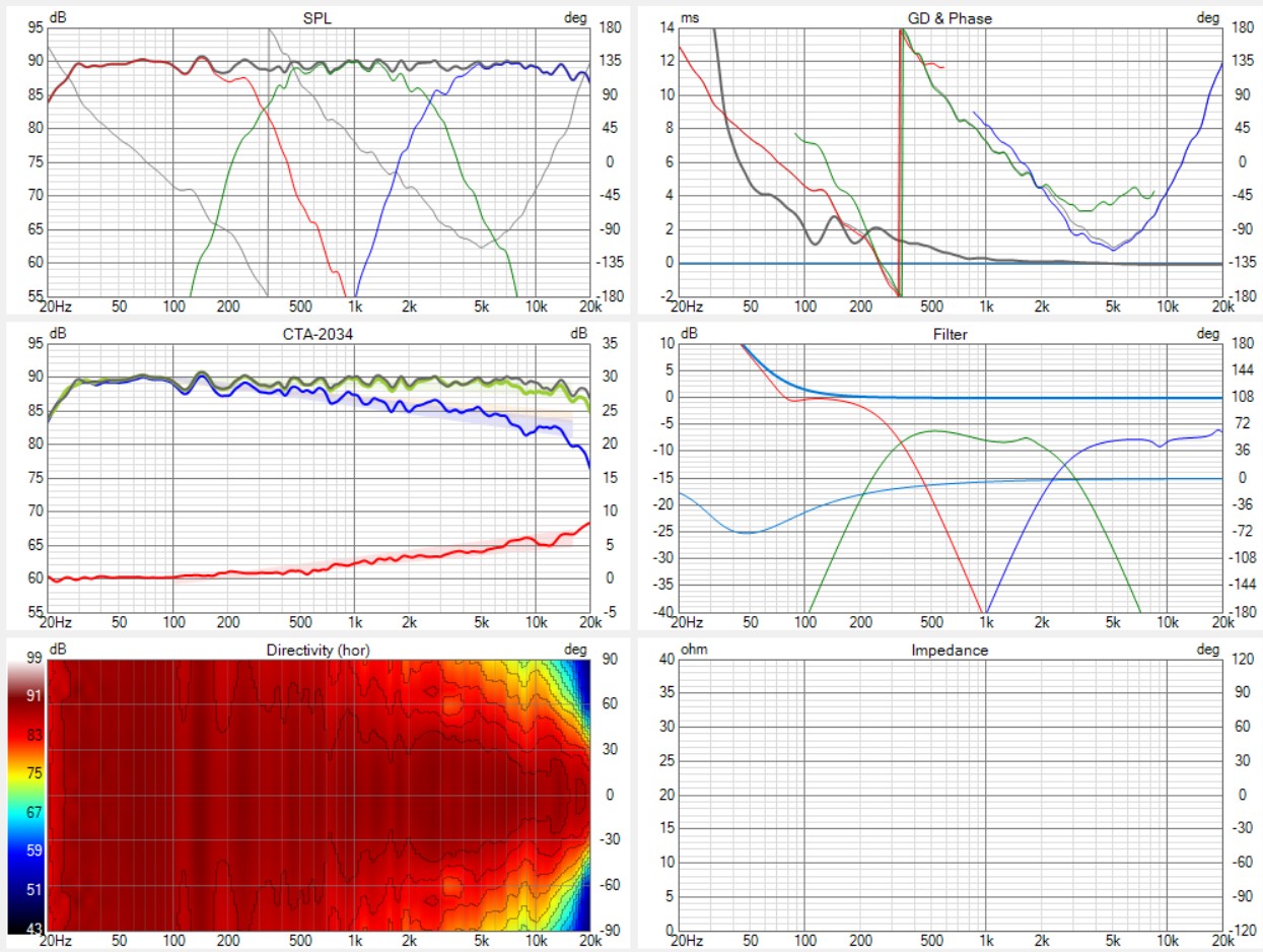

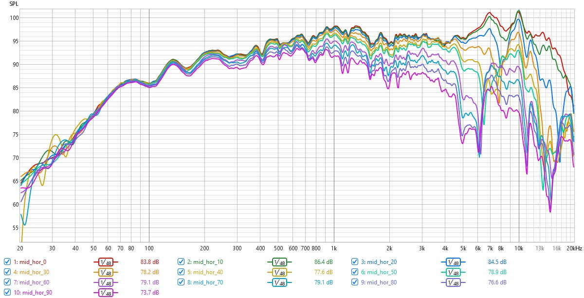

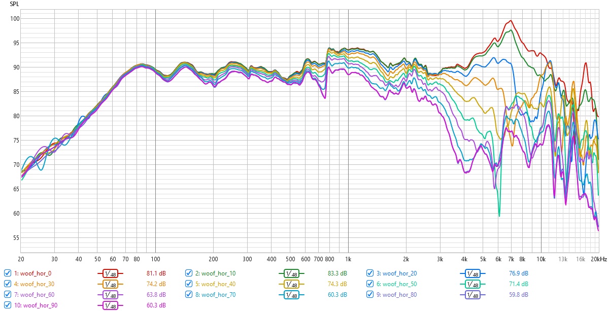

Here we go, measurements attempt 5. Outdoors. 2m from floor. 1m mic distance. I think this time even phase recorded OK (at least within the intended eventual operating range of the drivers)
Tweeter:
Midrange:
Woofers:

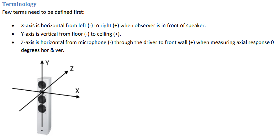

I am not sure if it was clear from the other posts... Regarding a speaker with vertically aligned drivers and with all drivers on a common baffle (i.e. fixed z dimension):
If all drivers are measured with a single common mic position, and both vertical and horizontal polar scans were taken, then each driver should have 0,0,0 as driver coordinates. This is not how the VituixCad software was intended to be used, but it does work. All the requirements must be met (1) vertically aligned drivers, (2) common baffle, (3) fixed common mic position, and (4) polar scans in both vertical and horizontal planes.
Most of the time, the mic is raised/lowered to be on-axis with each driver. Most of the time, only horizontal polar scans are taken. Sometimes vertical polar scans are taken, but the mic position is on each driver's axis. This is more in keeping with Kimmo's instructions. In this more general case, it is necessary to install the driver's y dimension into the VituixCad simulation.
Driver position must somehow make it into the simulation. This can be done by explicitly entering the driver coordinates, or by having the positional information buried in the measured frequency/phase data. Depending on how the measurements are conducted, it is possible that some coordinates will need to be entered into the sim, while others are not. For example, it is fairly typical that only horizontal scans are taken, and each driver was measured on its own axis, and the distance from mic to baffle is kept constant. In this case, the y dimension is entered into VituixCad, but the x and z dimensions are left as 0.

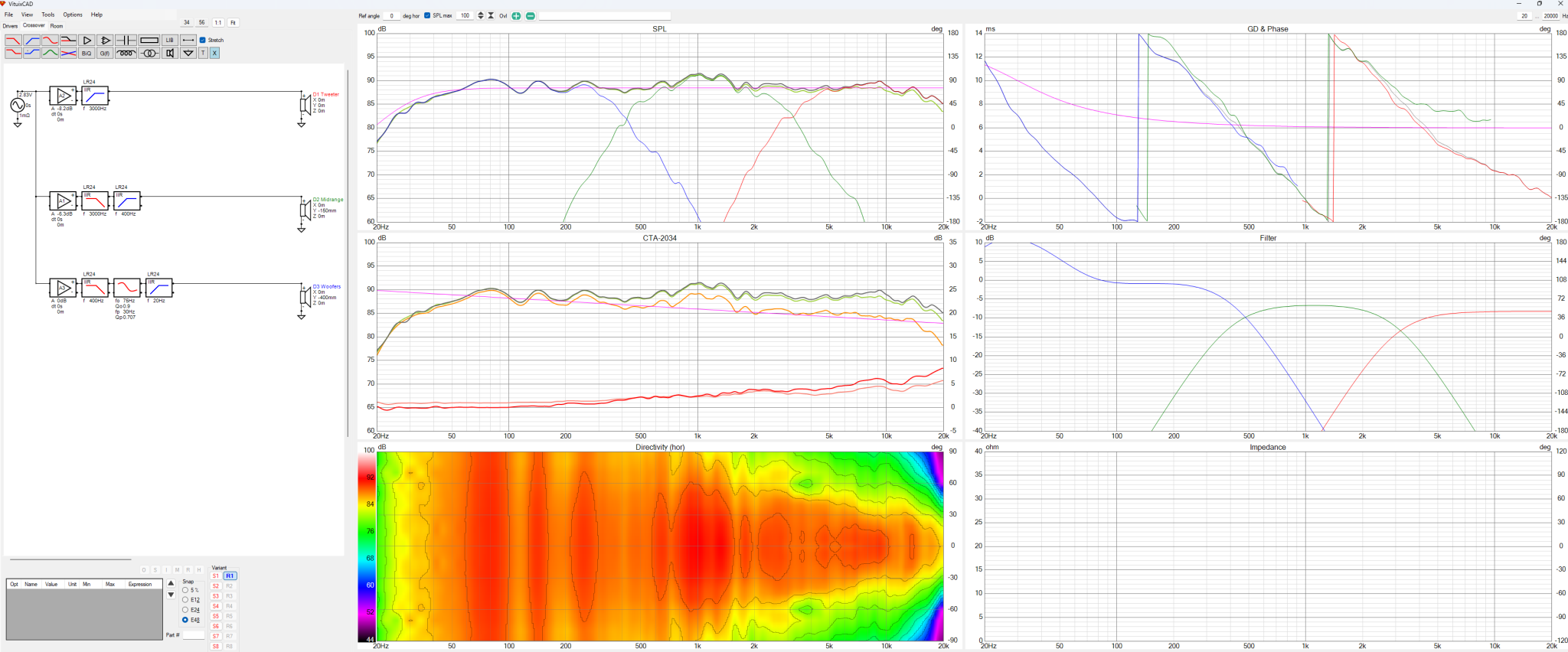

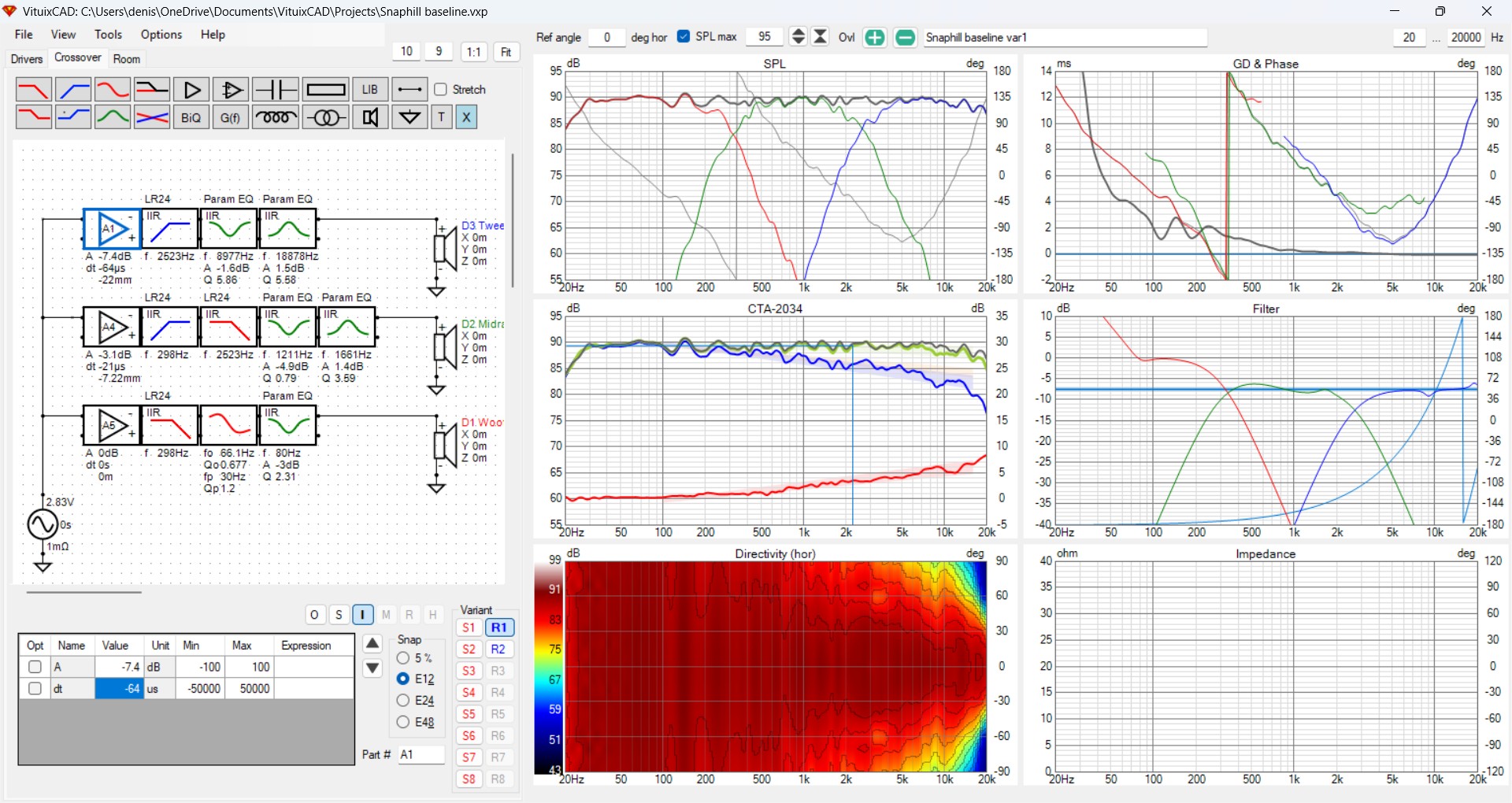

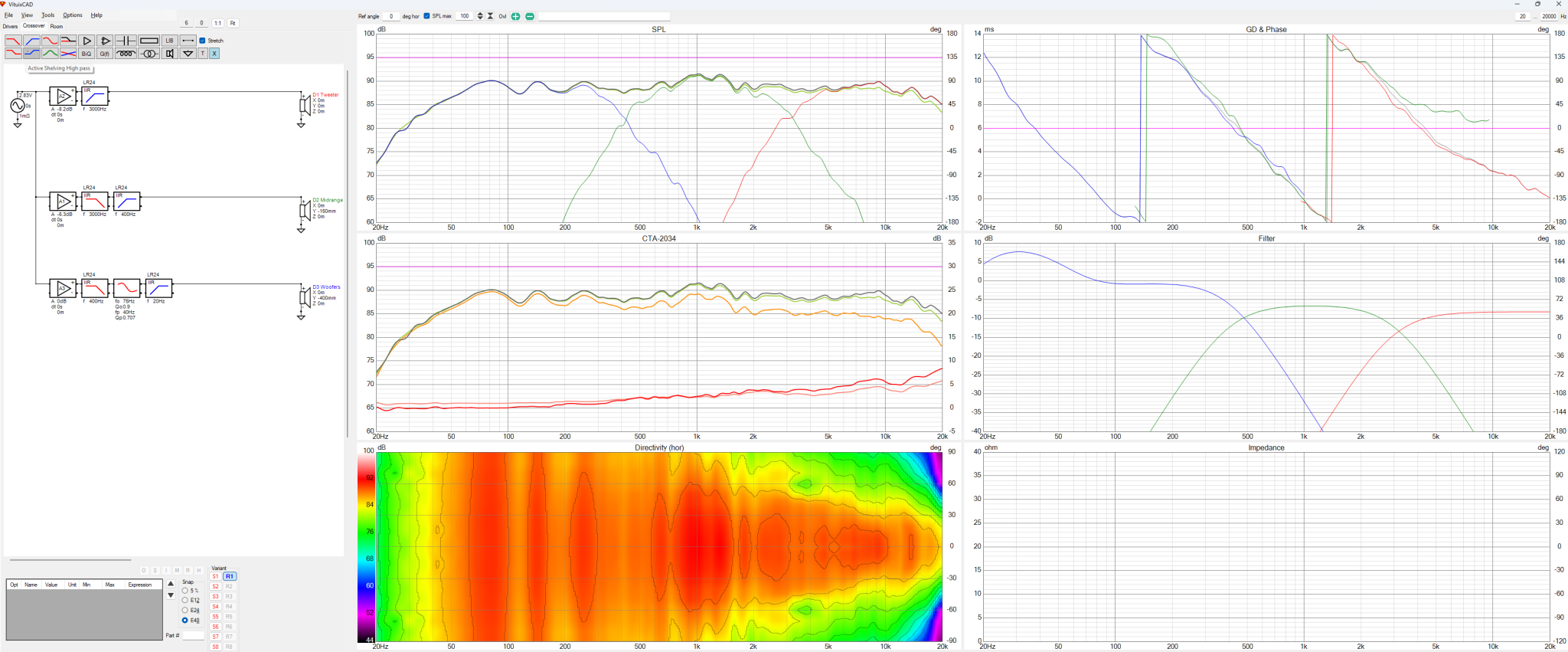

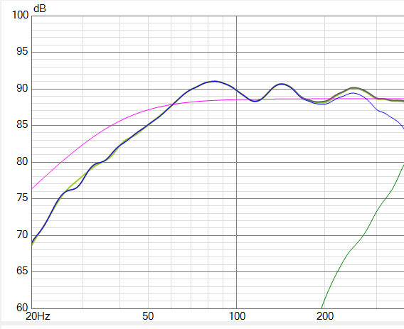

Long post series coming. Gonna go over the optimizer tool. Mainly because it's fun.
So I'm starting from here:
-Initial crossovers that we used before (LR4, 400hz/3000hz)
-Levels are set to get all the drivers in the ballpark
-I plugged in an LT and a highpass at 20hz to shape the bottom end.

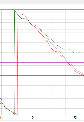

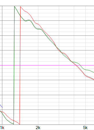

Let's get the delay/phase squared away. Look at the 3khz area of the phase chart. The midrange phase line diverts from the tweeter, and delaying the midrange a little bit will fix that. On the left is original, the right is a 25us delay on the midrange. This is a minor correction. I'm going to leave everything else alone.

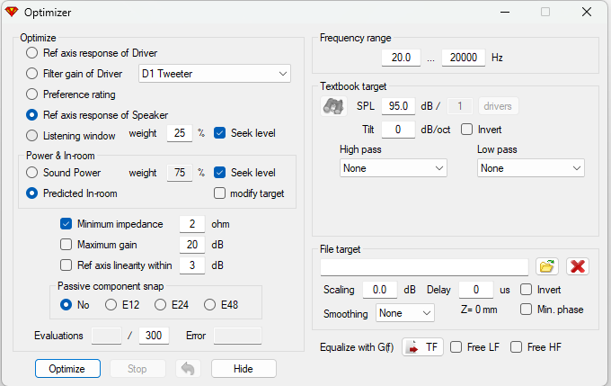

On to the optimizer!

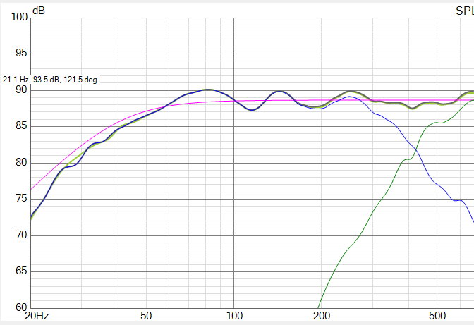

Select the first option under the view tab.
You'll see this:

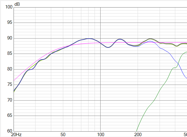

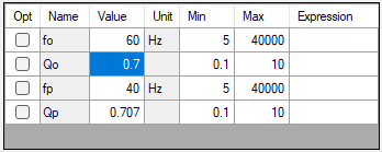

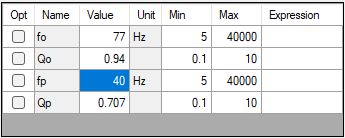

First I want to check my LT design, so select ref axis response of speaker (like the picture). Then we're going to adjust the textbook target and add a highpass. You can see I used a 2nd order highpass, and setup the same numbers that I used in my linkwitz transform for Qp and Fp.
Adjust the target SPL until the pink line matches the woofers response (ballpark middle of the ripples).
Now adjust the F0 and Q0 in the LT until your response matches the target curve.
Example, starting from very off numbers:
More in the next post
