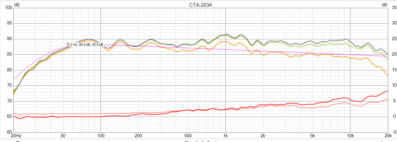

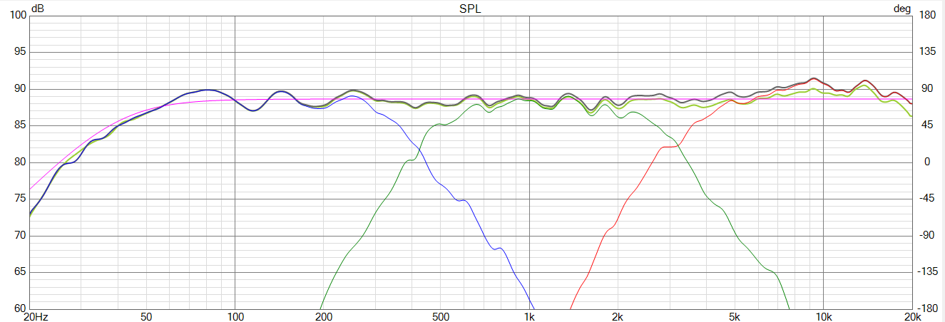

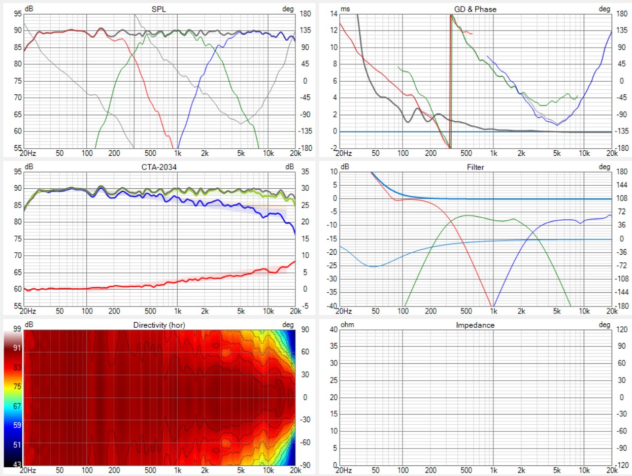

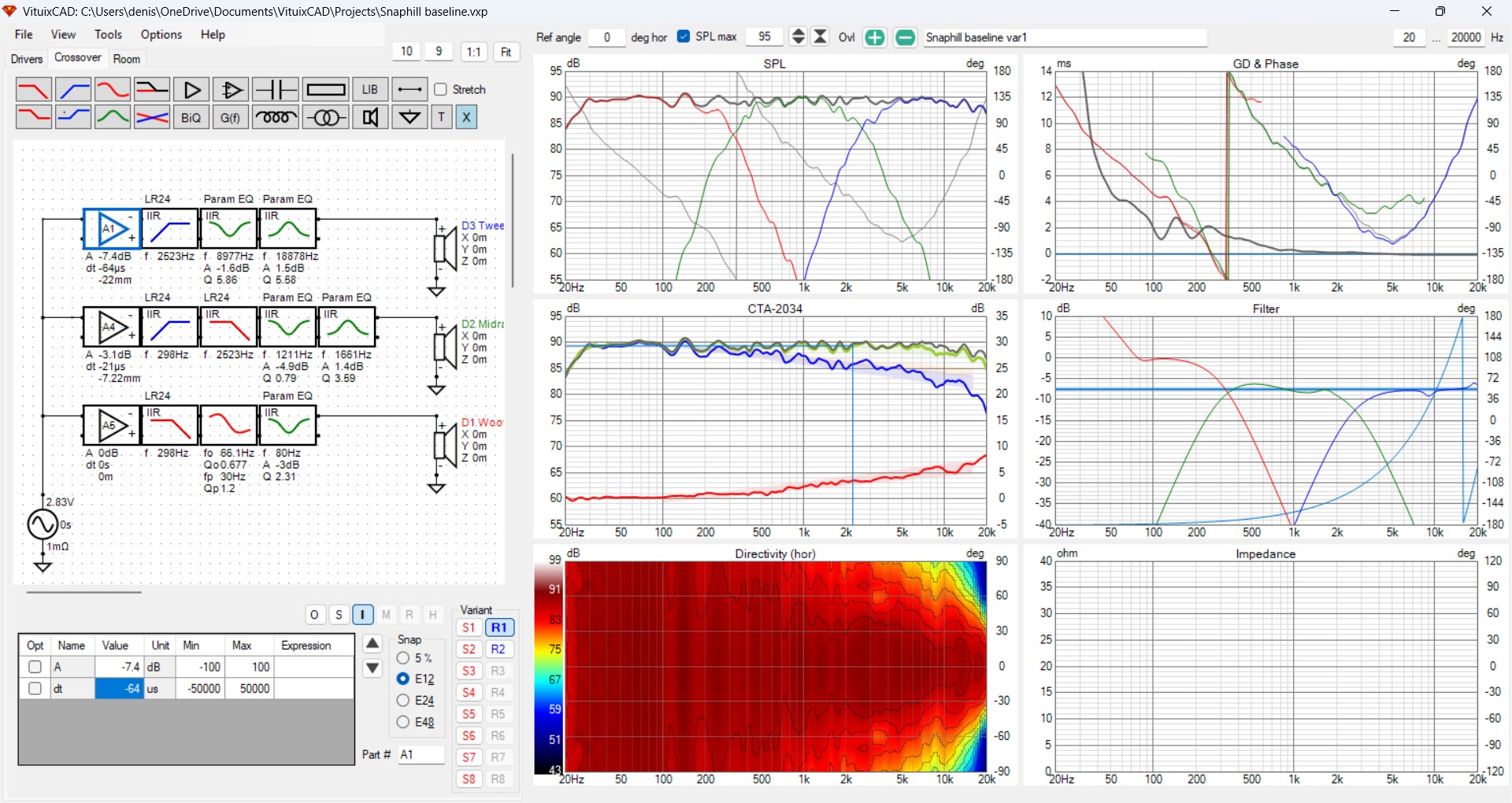

So now we have this:

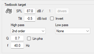

We're going to setup the off axis target slope next (in room) and then the optimizer will allow us to automatically tune the EQ to get our desired response, balancing on axis and off axis response.

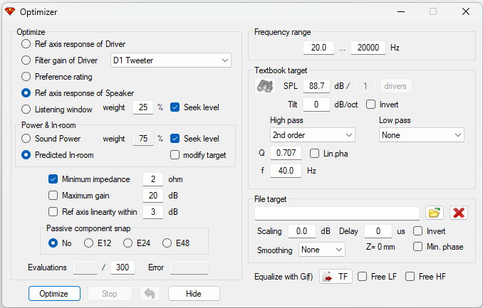

So, in the optimizer window, we're going to select predicted in room and modify target:
You can now modify the pink target line in the CTA-2034 window.
So now that we have targets to work with, we can start adding EQ filters to get this squared away. This will also give the optimizer the things it needs to work with to tune. Unlike in REW, this tool does not add it's own filters, it can also be used to tube a passive crossover.

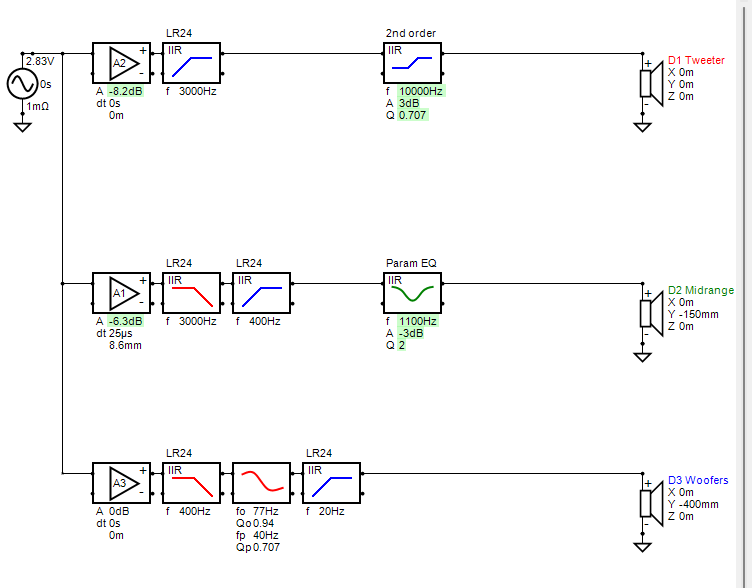

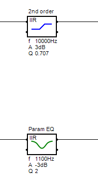

So just looking at it, I'd like to add a peaking filter around 1100hz to knock down that bump. And I'd like to lift the top end from about 10khz and up, so I'll use a high shelf there.
These are the two filters I added:

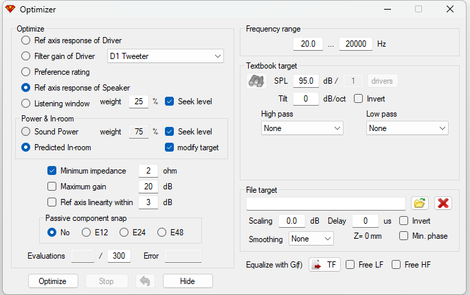

Now let's setup the optimizer.

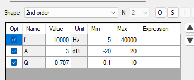

First we need to tell it which values is can alter to try to achieve the target that we gave it. This is done by checking the box under Opt on the individual crossover filters/functions.
This is the high shelf I put on the tweeter. I've checked all three fields.
In the crossover sketch, the green highlighting shows which fields I'm going to let the optimizer alter. For now, I'm going to leave the crossover out of it, and just alter the two bands of EQ and the midrange and tweeter levels.
Ok, final setup: The relative weighting between reference axis and predicted in-room
I've selected 25% reference axis, and 75% in-room. There's no right/wrong here, it's voicing preference.
But stick with me. Click on the optimize button.

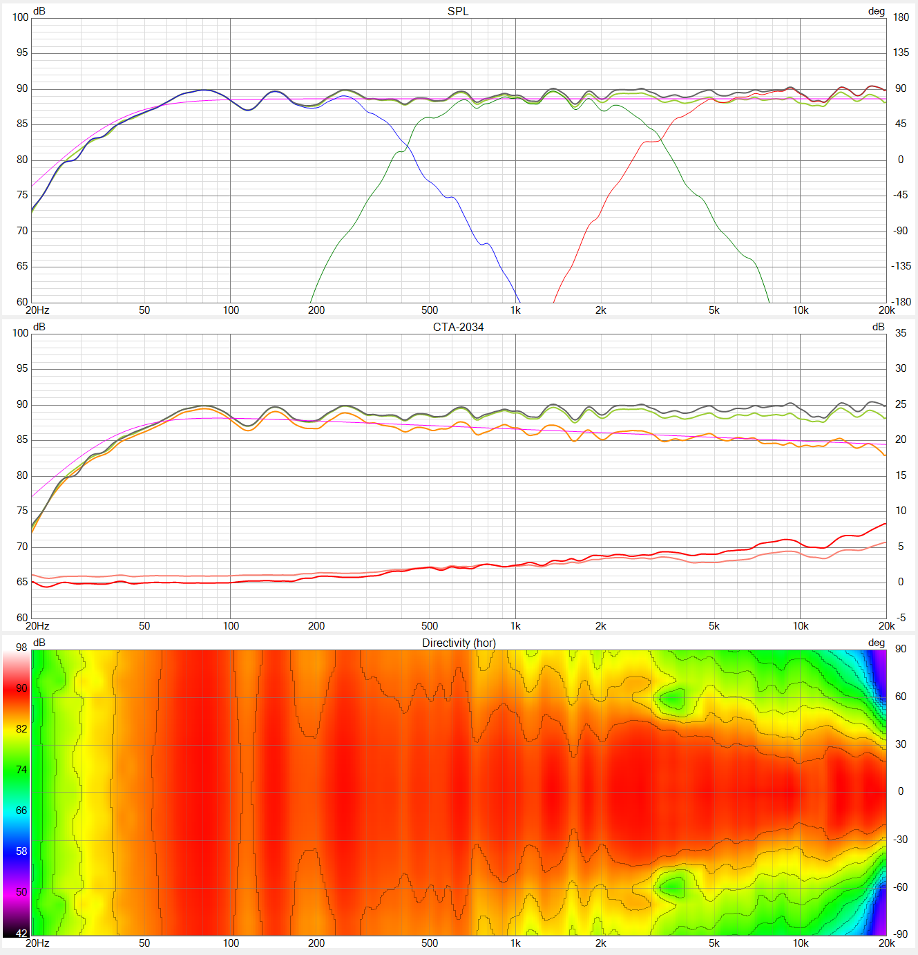

What you get won't be exactly the same each time you run it, it's iteratively adjusting the parameters to achieve your target. So if you have different starting points, it can vary a bit in the output.

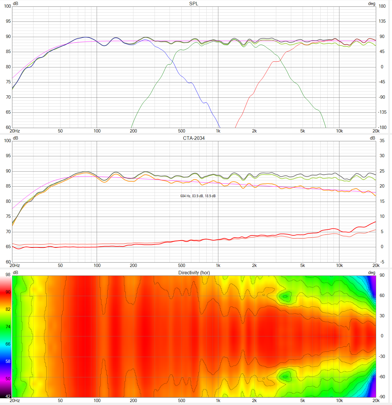

Here's what I just got:

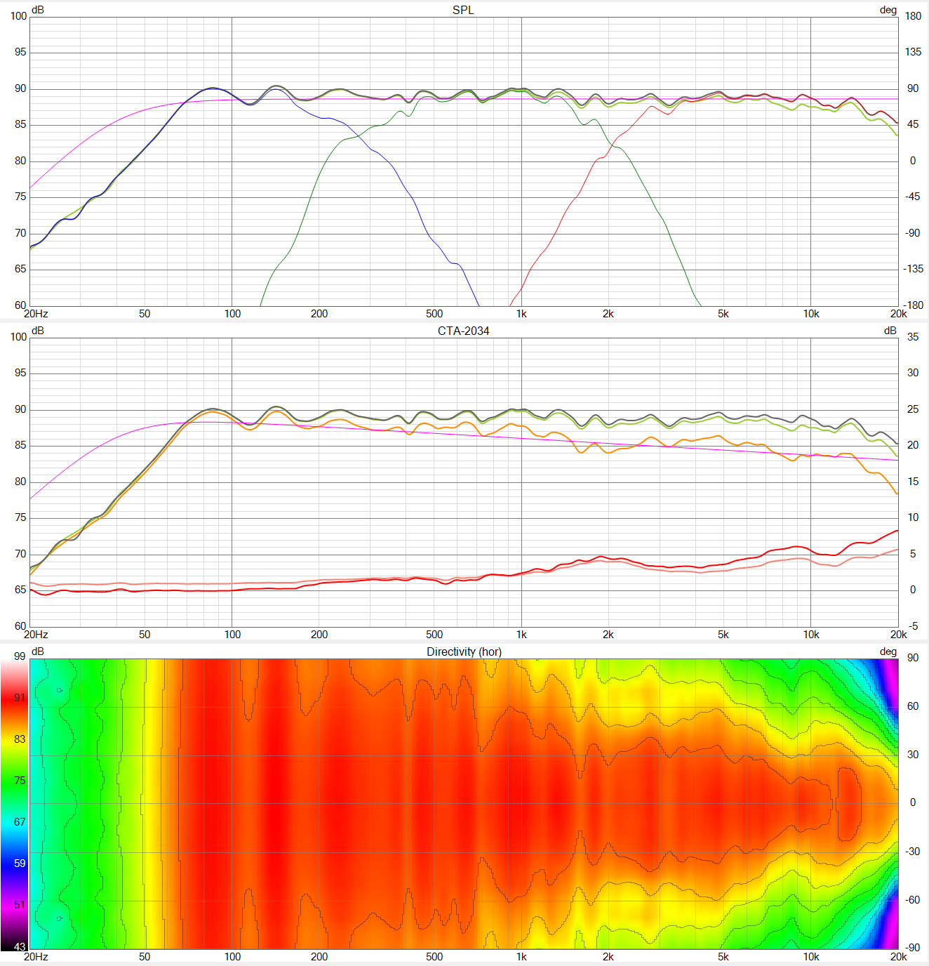

That's not what I was envisioning with the tweeter. So I'm going to move the high pass filter, and adjust the tweeter level and then re-run the tool.
Re-run:
Much better. But I don't like the way the speaker response rises slightly across the entire FR range. So I'm going to go back to the optimizer and adjust my in-room target to slope down a bit more. I moved that value from -0.5dB/oct tilt to -0.7dB/oct, and re-ran again.
I'm pretty happy with that.
View attachment 1475410View attachment 1475411
View attachment 1475412View attachment 1475413

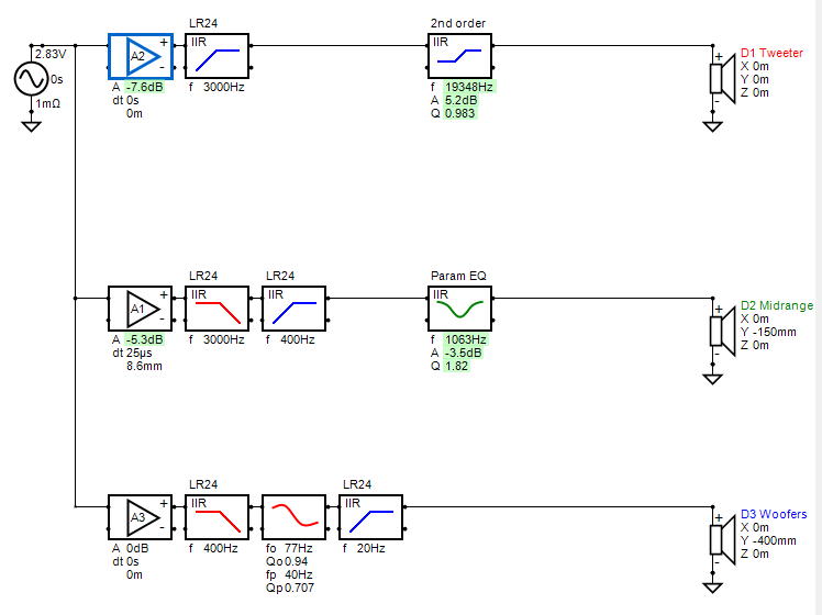

View attachment 1475419View attachment 1475420
View attachment 1475424View attachment 1475425

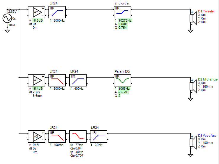

Re-run:

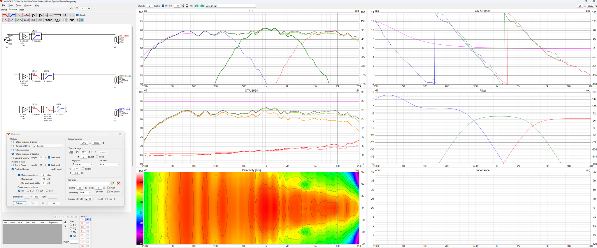

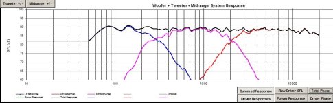

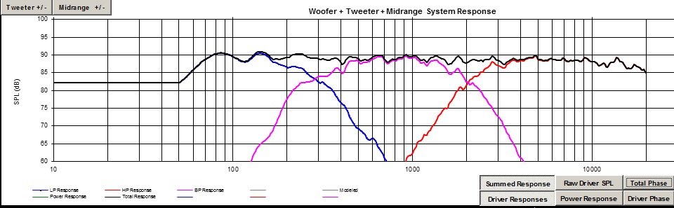

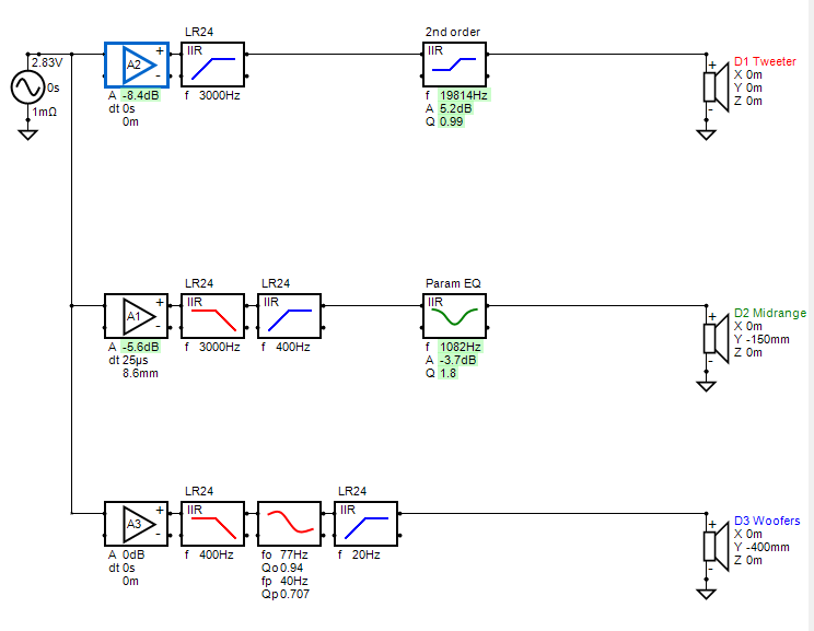

I forgot to add this: These FR exports from REW are from your latest measurements, and I used a frequency dependent window at 14 cycles instead of gating. There is no smoothing in VCAD.
If you have time, I'd like to see what this sim looks like in VCAD. I adjusted gains to match the SPL level in your sim. Both are virtually the same on axis, but I crossed lower.
Woofer LR4 @ 300
Mid BW4 @ 240 and BW4 @ 1900
Tweeter BW3 @ 2500
EQ
W -2.5 @ 265 Q=3
M +1.5 @ 600 Q=1
M -2 @ 1200 Q=1
T -1.5 @ 8500
Levels
W 0
M -7
T -8

I'm not an expert on polars, but I'm thinking my low 2k crossed sim looks rather good off axis.

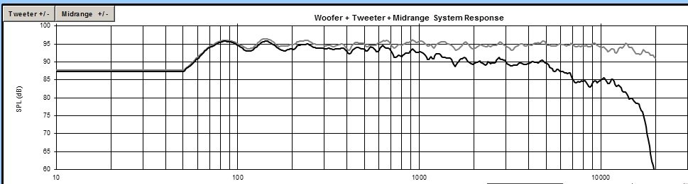

I have tried to implement this sim in Hypex DSP and it sounded way too bright.
Recommend you do a quick on axis measurement of a design. Not saying you shouldn't try other designs. But, it's useful to have a connection between what you hear (and like, or dislike) and measurements. So instead of you saying "it's too bright" you get to the point that you say "it sounded too bright to me, so I scooped the 2khz to 5khz region with a low Q, low gain filter to _______________" and insert your desired effect into the blank spot.

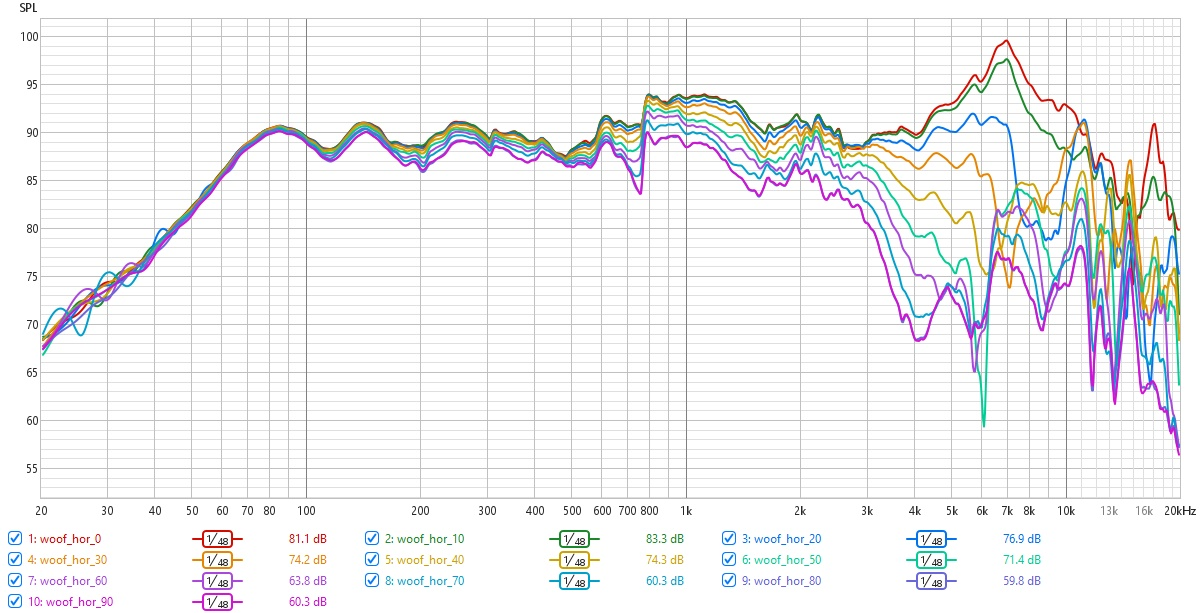

I understand the unevenness in the woofer response in the 80-250Hz range should only be looked at at the room EQ stage. No point to try to correct it without taking the room effects into account, right?
I wouldn't bother with that. Those ripples will change based on room positioning, mic positioning, etc. etc.
