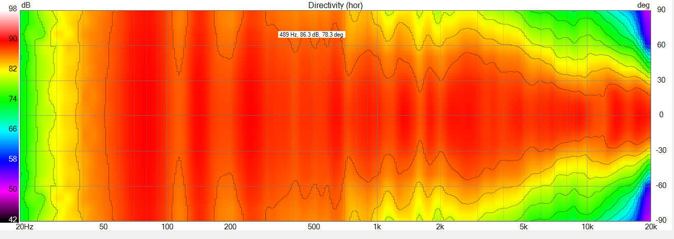

You're thinking polars in the sense of smooth. Which is not what they are useful for in my opinion. You could after all hammer the response flat as a board with a FIR filter. So what.
Look at your x-over design, at the polar from 2khz to 5khz. You should be able to easily see that the dispersion narrows at the cross over and then gets wide again at 5khz. This is what causes the estimated in-room response to dip at the cross over and then bump up at 5khz.
You can either sacrifice on axis behavior to counter act this. Or, change your crossover design to not get off axis cancellation in the crossover region.

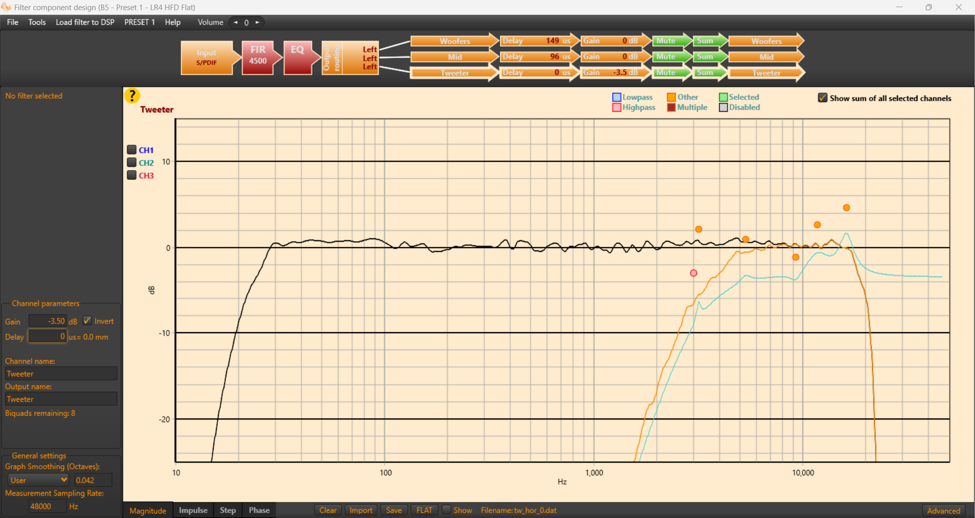

However, there is something new I tried yesterday - I learned to export the IR from REW and load the IR response into HFD. This makes designing the filters in HFD very intuitive and within 20min of fiddling I had this curve. Pretty flat and with driver delays set to deepest nulls. On loading to amp the speakers sounded great, but a bit bight. So I added a gentle downwards slope. Then added three notches at the worst room peaks and I have great sound!
So you in your sim, the tweeter and mid are actually working against each other off axis, and have cancellations between 3k-5k, and that is what narrows the graph in that frequency range. This is the prediction anyway for the horizontal listening axis only. I assume this polar tells nothing about how the drivers add 20 to 30 degrees above this axis. Am I understanding what this shows, or does the software do more estimating vertically, even though no vertical measurements have been entered?

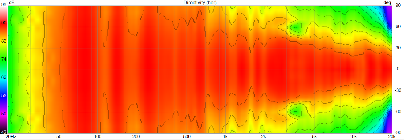

The two circular swirl things at 3500hz at 60 degrees off axis on my design are cancellations due to tweeter/midrange spacing, delay and phase. Changing the vertical spacing alters that behavior, as does altering the delay that I put on the midrange.
That said, I mentioned these earlier in the thread. I'm not sure they're real. If I don't export measured phase, and instead rely on VCad calculating phase, they go away.
If I were building these, I'd likely want to put it together and then measure at 60 degrees off axis and see if that cancellation actually shows up.
Here's my original idea:

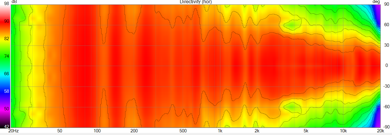

Here's the same design without the measured phase:
This is if I remove the delay on the midrange (with measured phase):
