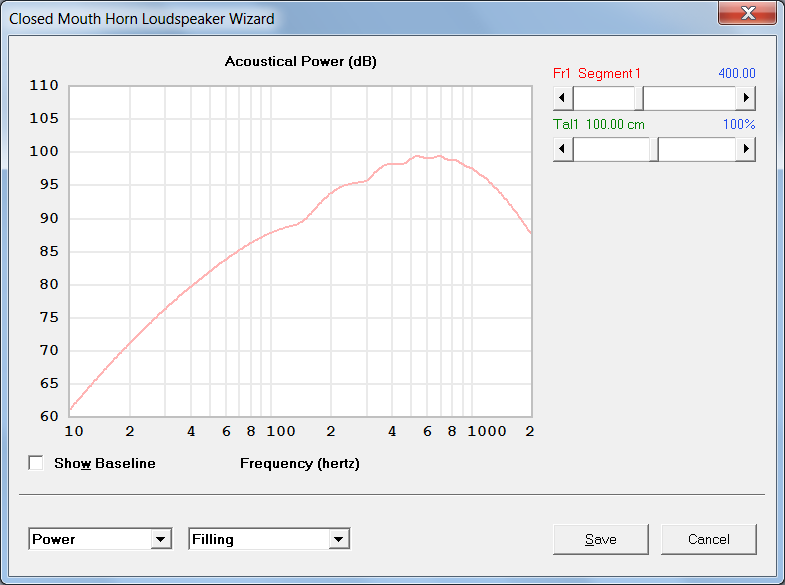

When the 'resonances not masked' option is selected both sealed box and closed transmission line systems are analysed the same way by Hornresp. This can be confirmed by comparing a sealed box with an untapered closed transmission line system of the same dimensions. As shown in the attachments the 'resonances not masked' results are identical. Tapering a closed transmission line simply alters the calculated acoustical impedance loading the rear side of the driver diaphragm. The simulation model itself does not change.

The closed TL is a really interesting feature, I'm surprised more people haven't used it.

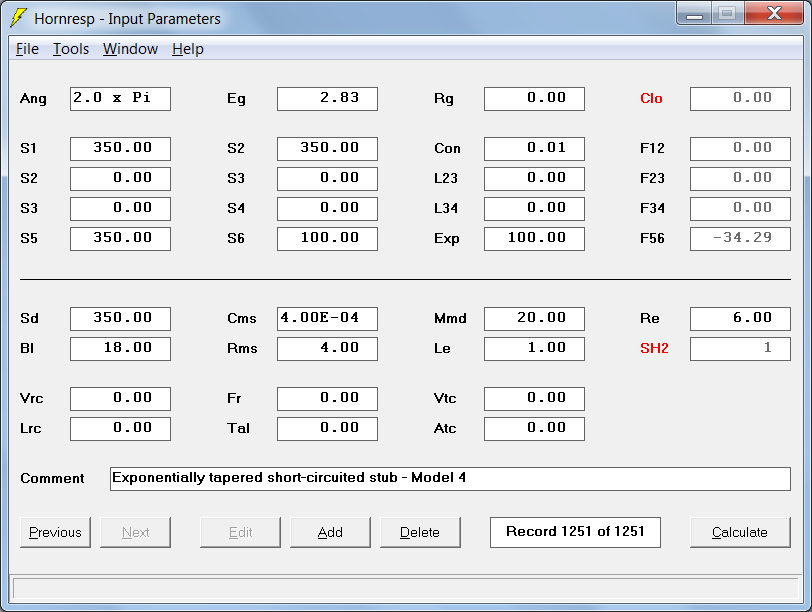

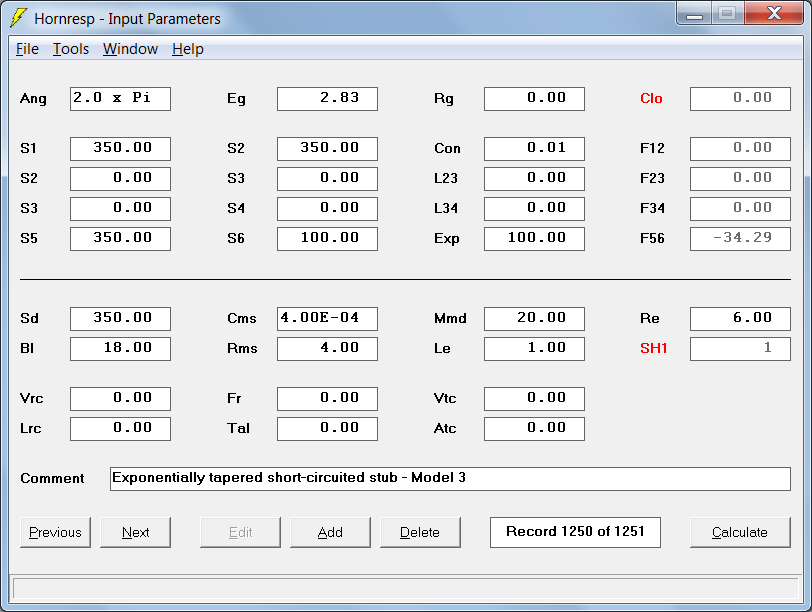

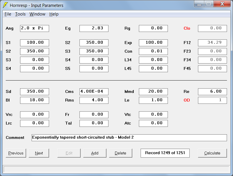

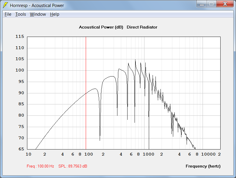

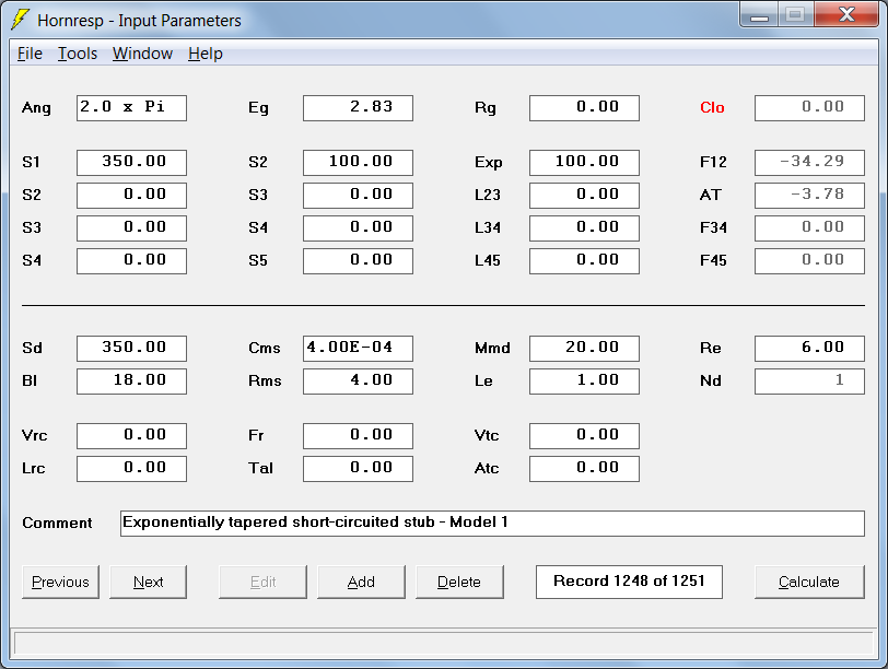

The closed TL is similar to a short-circuited stub. There are a number of ways that it can be modelled in Hornresp, as shown in the attached examples. The results will be the same for each model. Absorbent filling material can be added using the Loudspeaker Wizard.

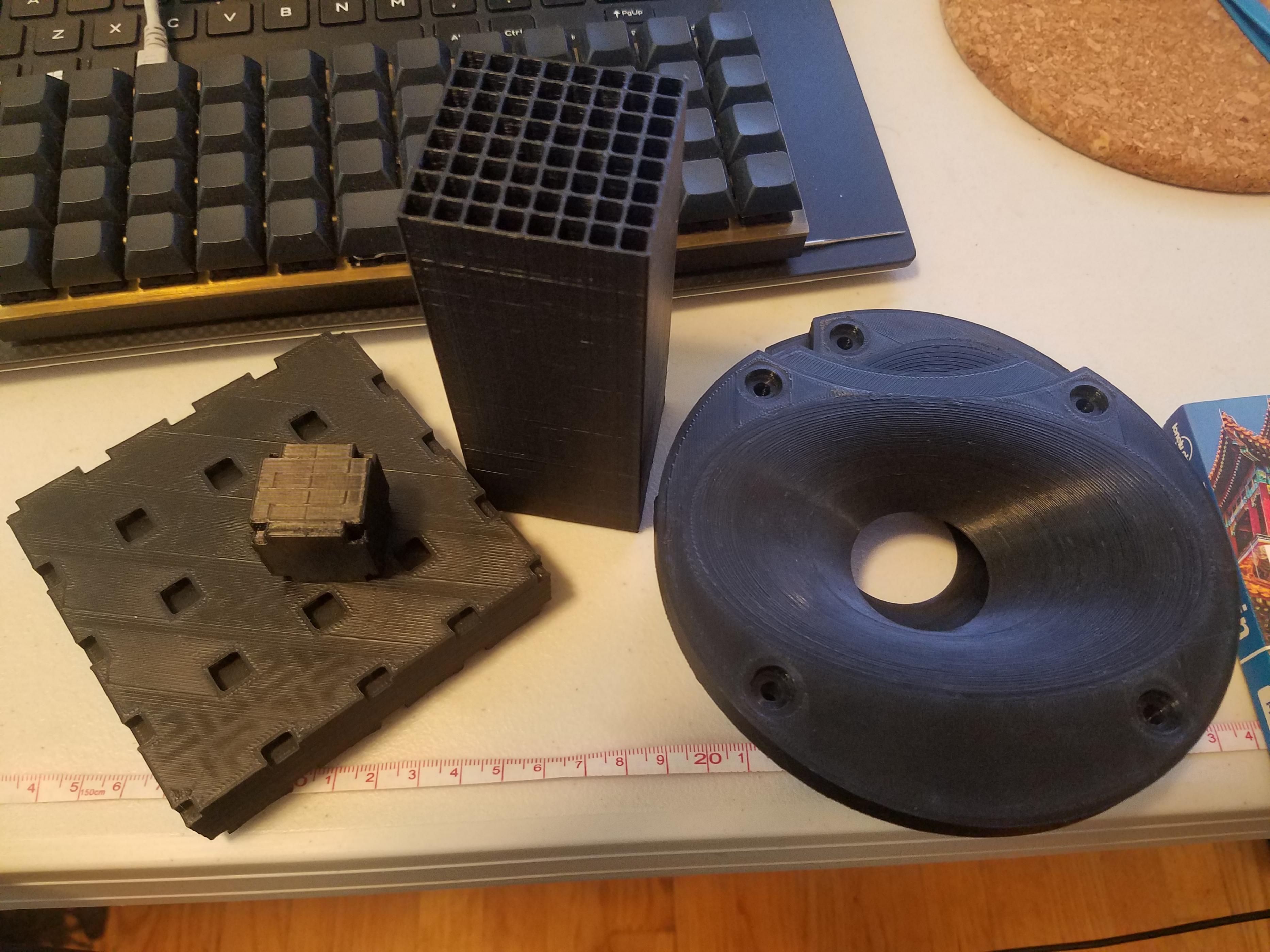

Here is an image of my test prints for my metamaterial models. Tape for scale and keyboards have a .75" or 19.05mm spacing between keys. Printed at 50mm/s on the walls (they are all exterior walls so you may need to change slicer settings) with 0.2mm layer height and 0.4mm nozzle. Real print time for both is about the same at about 12-13h. So far subjectively just aiming a headphone speaker at them and listening from behind the speaker the tall FP tube one seems to have a greater effect in comparison to a flat plate (simulated by my cell phone). The labyrinthine one may need additional layers.

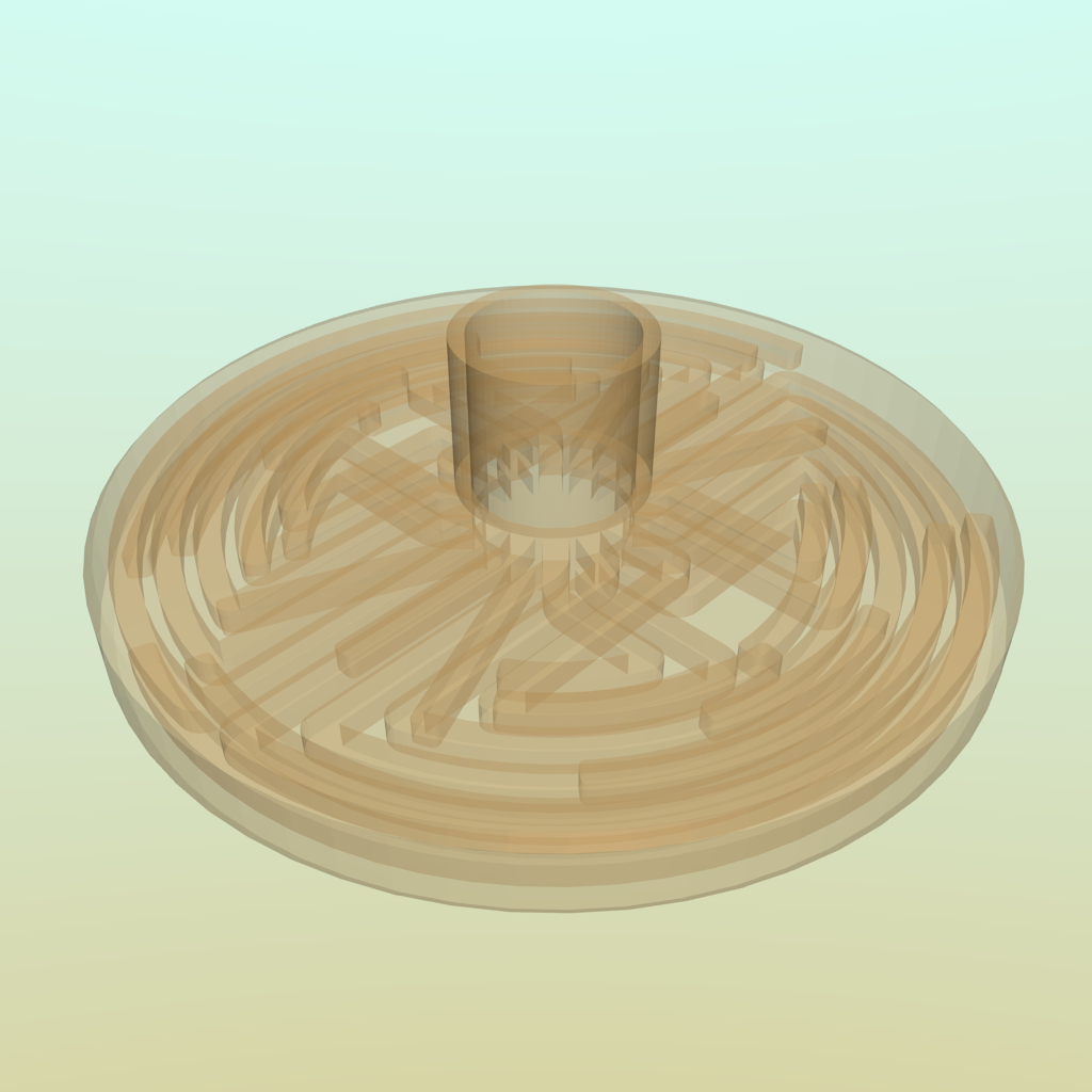

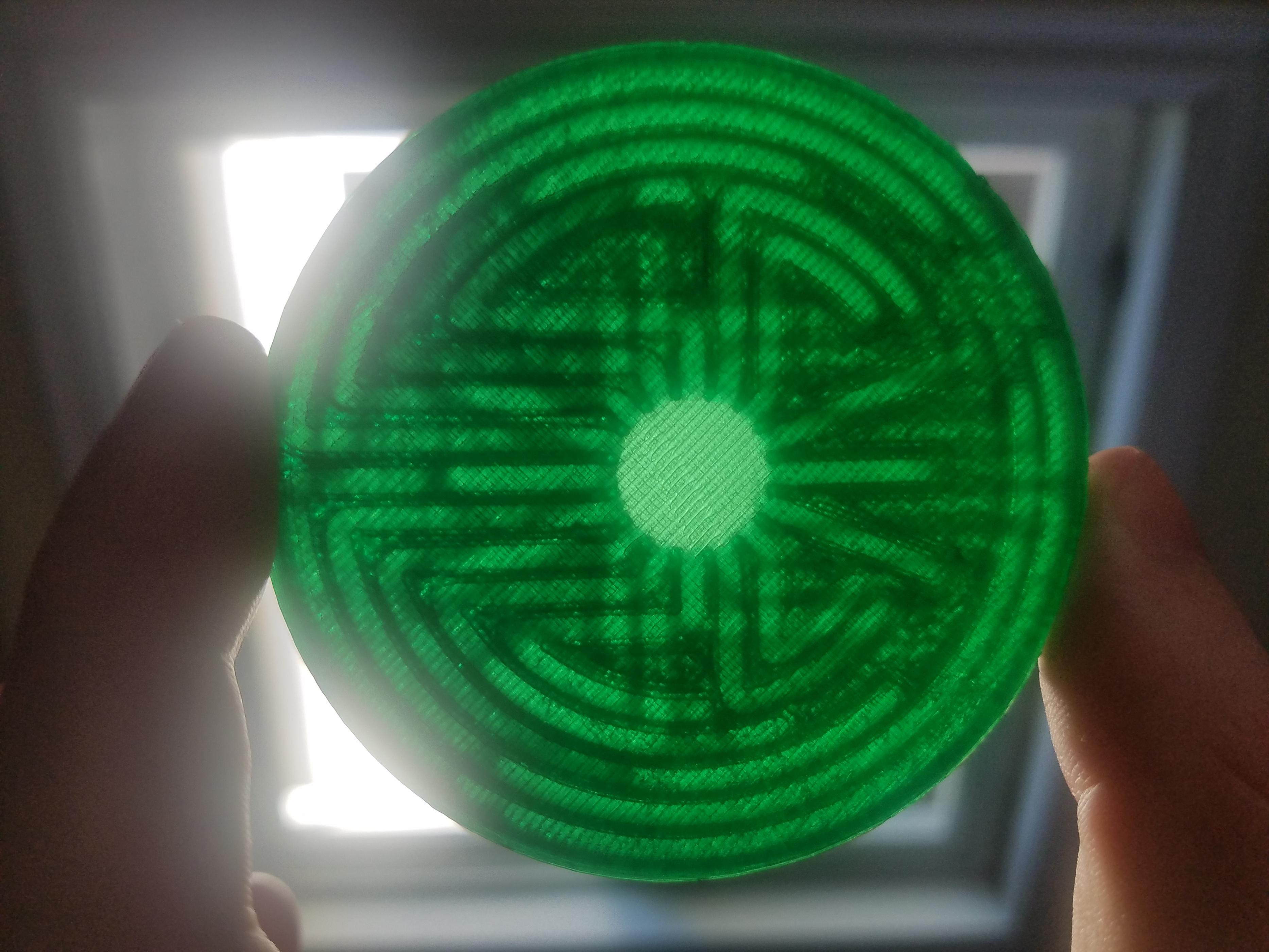

Got a tweeter metamaterial disk made up. Effective 620Hz to 6.2kHz center frequencies, 32 2mmx2mm FP channels with log spacing using the script I posted earlier. Inlet throat is 12.7mm, overall diameter 70mm. Should fit nicely in the standard driver cutout or behind a waveguide.
For the DA25BG08-06 specifically you will want to continue the narrower 12.7mm throat out to the metamaterial with a tube either fully filling the larger rear chamber (like with a wood puck with a donut hole) or stuffing around the tube. A small bit of foam or polyfill should be placed in the metamaterial's central cavity to smooth the filtering.
I printed it out of PETG for the see through effect, but I would suggest PLA or ABS/ASA. PETG has those little boogers that can get caught in the channels.

Made some edits to help with printability and to better isolate the tweeter from any woofer it may share the cabinet with. The bottom/back was only 1mm thick, bumped that up to 3mm, lends better dimensional consistency further from the build plate for the channels. Increased diameter to 72mm, extra 1mm material all the way around.

Someone sent me a message asking how to do a Closed Transmission Line. Here's how:
"Double-click the Cir or Fta label in edit mode to select the Clo closed horn mouth option. Not applicable to direct radiator loudspeakers, tapped horns or single segment horns other than Con, Exp or Par."
So I printed this last night, but I don't think it's going to work in the real world. The channels are something like 2mm in diameter, and I think that's too fine.
For instance, the nozzle on my 3D printer is 0.8mm, and when I printed it, a significant number of the channels are impeded by stringing and just a general lack of accuracy.
The obvious solution would be to reduce the nozzle size to 0.4mm, but when I do that, my printer always jams.
The other solution would be to do it in ABS. Which I may try today.
Ideally, I'd love to carve out a few hours and redesign this thing, so that the diameter of the channels is about 4-5mm.
It's not as simple as scaling the 3D model, because if I scale it, it will change the resonant frequencies of the channels.
Another option might be to scale the model on one axis only. This would increase the volume without changing the resonant frequencies.
