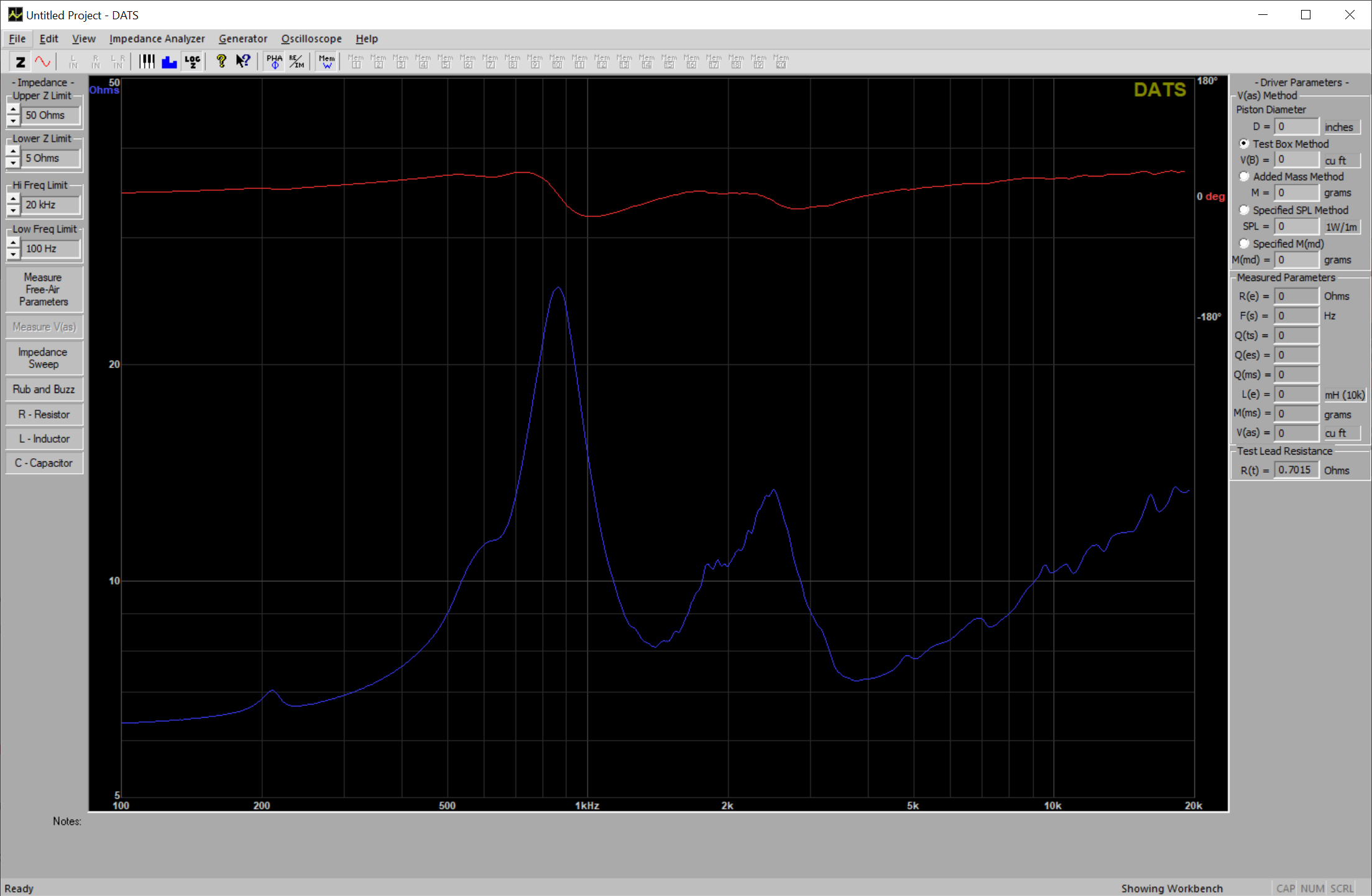

Attached is the measured impedance of a Dayton D250P. This is a cheap/forgettable compression drivers that I bought ages ago.
The D250P is a clone of the B&C DE25 or DE250, and because of that, you can completely dismantle it - including the back chamber.
I think this is fairly unique; all of my Eminence, BMS, and Celestion compression drivers can't do this.
So the D250P could be a good candidate for one of these experiments.
The measurement I've attached is the curve WITHOUT a back chamber. We can't really call it "dipole" or "open back" because there's a chamber in the mix. (The chamber where the phase plug is.)
If you really wanted to go crazy, you could even 3D print a custom phase plug, because that's removable too!
I am curious how this will turn out, because I've never been thrilled with how this compression driver sounds.

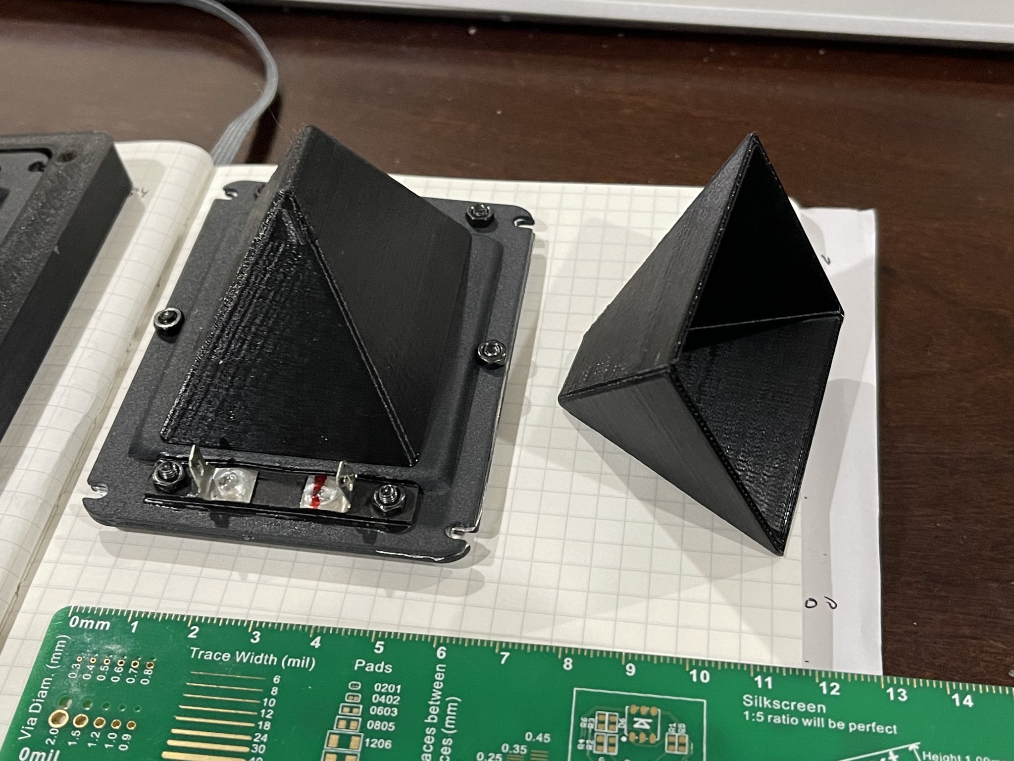

Here's the frequency response of a Dayton D250P in it's "stock" enclosure, and in a metamaterial enclosure.
Not much to see here...
![YNtdi7a.png](https://i.imgur.com/YNtdi7a.png)
![PPNROEt.png](https://i.imgur.com/PPNROEt.png)
But when you look at the distortion curve, the higher order distortion has been NUKED. It's just completely absent above 1500Hz or so.
This might explain why people preferred the sound of the Hegeman enclosure; the frequency response of the metamaterial enclosure isn't much different, but higher order distortion drops like a rock. And subwoofers are particularly prone to producing distortion.
I've measured at least a hundred speakers, and I've reached a point where I can *immediately* tell if the speaker will measure well, from hearing the pink noise. Like, I can play pink noise over a speaker, and before my PC finishes processing the input, I can tell if it's going to measure well, just from how the pink noise sounds.
This was one of those cases; the "stock" D250P doesn't sound great by any means, but the metamaterial D250P sounds unmistakably better, even though the frequency response is comparable.
Make no mistake, I'm still not thrilled with this compression driver. To me, it sounds like the high frequencies could be a lot cleaner. The dips and peaks above 5khz basically illustrate that all of the high frequency output is generated by resonances in the diaphragm. If it was perfectly rigid, the output above 5khz would like be about 5-10dB lower.
Then again, it has efficiency to burn, so it might be an interesting candidate to tweak. Particularly since it's very affordable.

If anyone wants to print it, attached are the files.
I don't think they're 100% great, in particular the area around the bolts needs to be reinforced. To get the enclosure to work, I used some clamps to seal everything up properly.
I've included the 123D file in case anyone wants to reinforce the bolt holes.

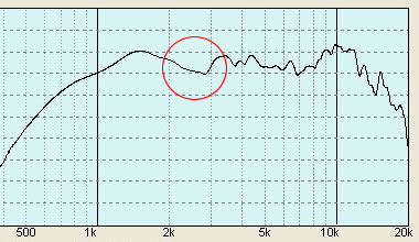

If I am right - then this has some interesting ramifications for loudspeaker builders. Metamaterial absorbers are pretty cool - but we can likely achieve something comparable (not identical) by just using much much much larger enclosures for our tweeters. Tons of people have commented on how good John K's speakers sound, and part of that may be that the tweeter is basically radiating into a nearly infinite space, with just about no obstructions.
![OixpoMW.jpg](https://i.imgur.com/OixpoMW.jpg)
Every conventional dome tweeter will have a difficult time pulling off the same trick because there's a resonant cavity behind the diaphragm that's formed by the hold through the magnet. The resonance of that cavity is significant.

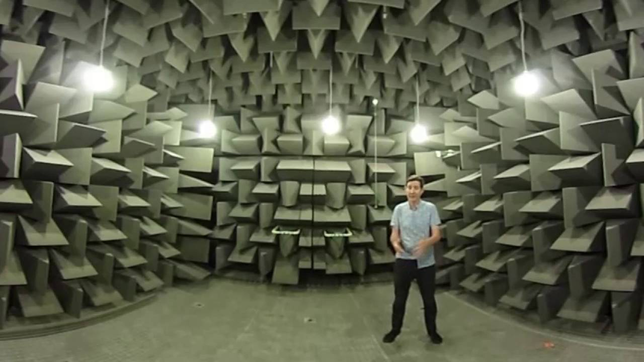

is the metamaterial more absorbent than a traditional approach like a foam wedge?
Significantly. Like, orders of magnitude.
To achieve something comparable, you'd need something like the B&W nautilus design (sealed transmission line.)
Having said that, in my own home I use Bubos absorbers from Amazon. I 3D printed metamaterial absorbers, but a 8"x8" absorber takes 20 hours to print and costs about $10 worth of filament.
Bubos absorber is 12"x12" and costs like $3.
I have them in a hallway leading to a guest room, and it's weird how when you walk by them you can hear the ambient SPL fall by about 10dB. It's a trip.
I put them in there to basically turn the hallway into a black hole for sound, sort of like how Danley put tuned Helmholtz resonators in his first tapped horns, to null out the out-of-band peaks.
