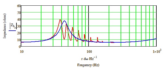

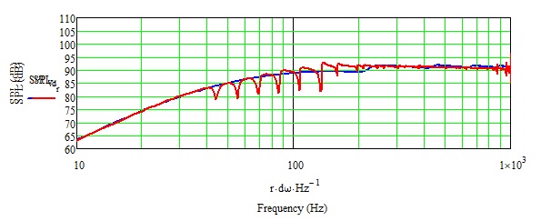

From the paper, here's some guesstimates on where the tubes are tuned to.
Note the lowest is at 620Hz, and clearly shows as a 'spike' in the graph.

Karabassis has posted a spreadsheet that can help you calculate the length of the stubs that are part of the enclosure.
One thing that confused me, was that the Kef metamaterial uses stubs that are one half wavelength long, while the Hegeman design uses stubs that are 1/4WL in length.

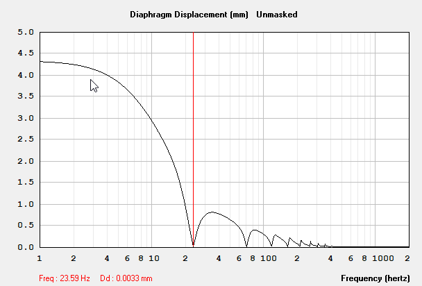

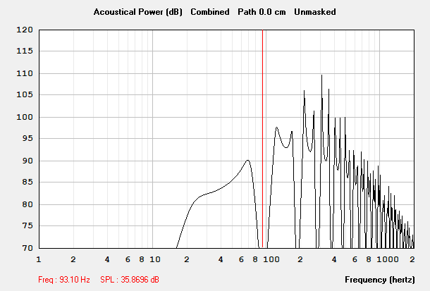

1) In a back loaded horn, the stub is tuned to one quarter wavelength, and the output from the back of the loudspeaker augments the front of the loudspeaker at 1/4WL. IE, if you have a BLH that's tuned to 24Hz, the output from the rear of the cone will augment the front of the cone at 24Hz and higher.
2) In a back loaded horn, the stub is tuned to one quarter wavelength, and the output from the back of the loudspeaker augments the front of the loudspeaker at 1/2 wavelength. IE, if you have a BLH that's tuned to 1/4WL at 24Hz, the output from the rear of the cone will augment the front of the cone VERY STRONGLY at 48Hz. Basically you will get a very strong enhancement at 48hz.
2) In a back loaded horn, the stub is tuned to one quarter wavelength, and the output from the back of the loudspeaker nullifies the front of the loudspeaker at one wavelength. IE, if you have a BLH that's tuned to 1/4WL at 24Hz, the output from the rear of the cone will nullify the front of the cone VERY STRONGLY at 96Hz. Basically you will get a very strong null at 96Hz.
I've attached a couple sims, of a subwoofer tuned to 24Hz in a back loaded horn. You can see that there's a 1/4WL resonance at 24Hz, strong reinforcement at 48Hz, and a null at 96Hz.

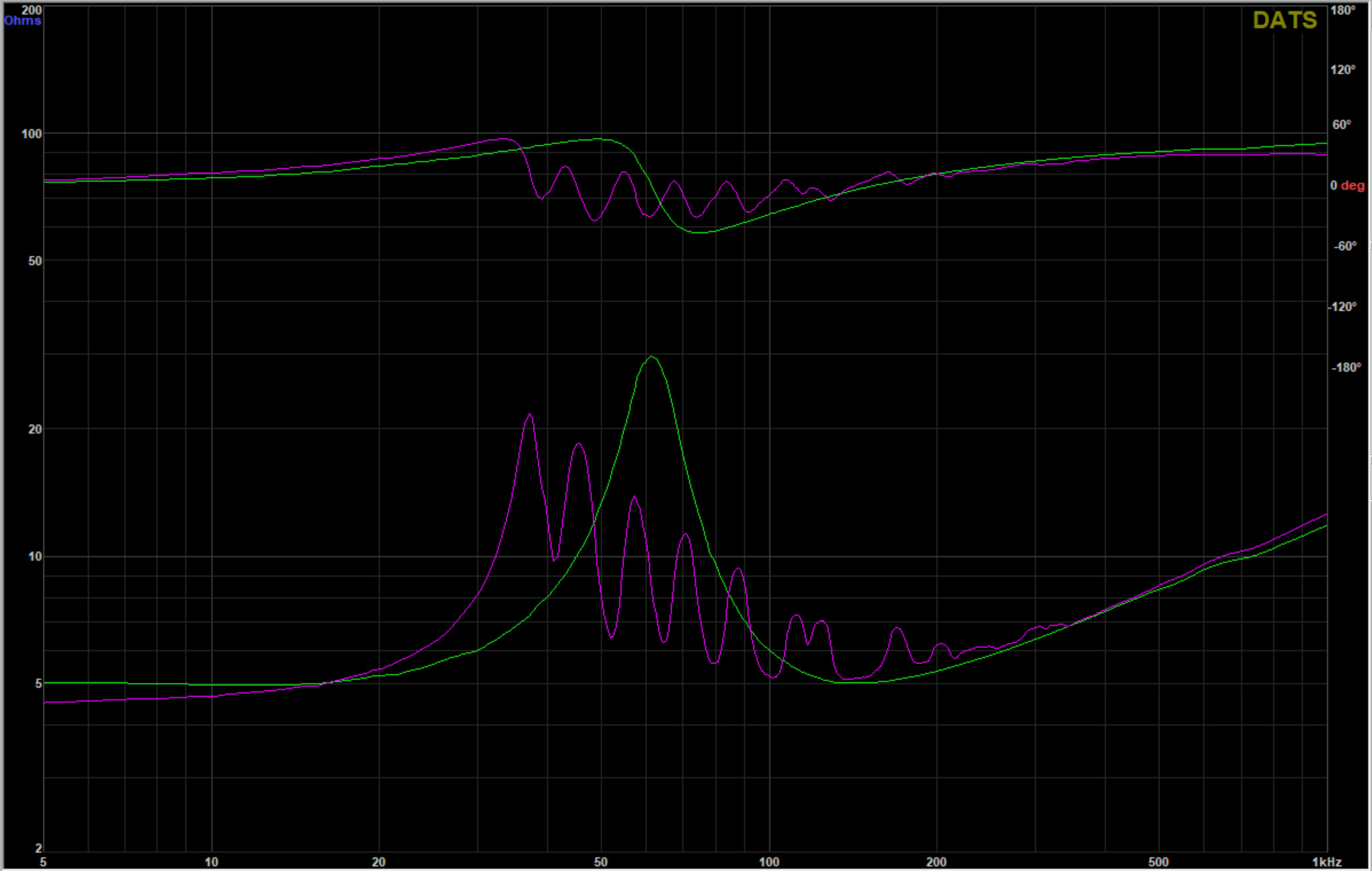

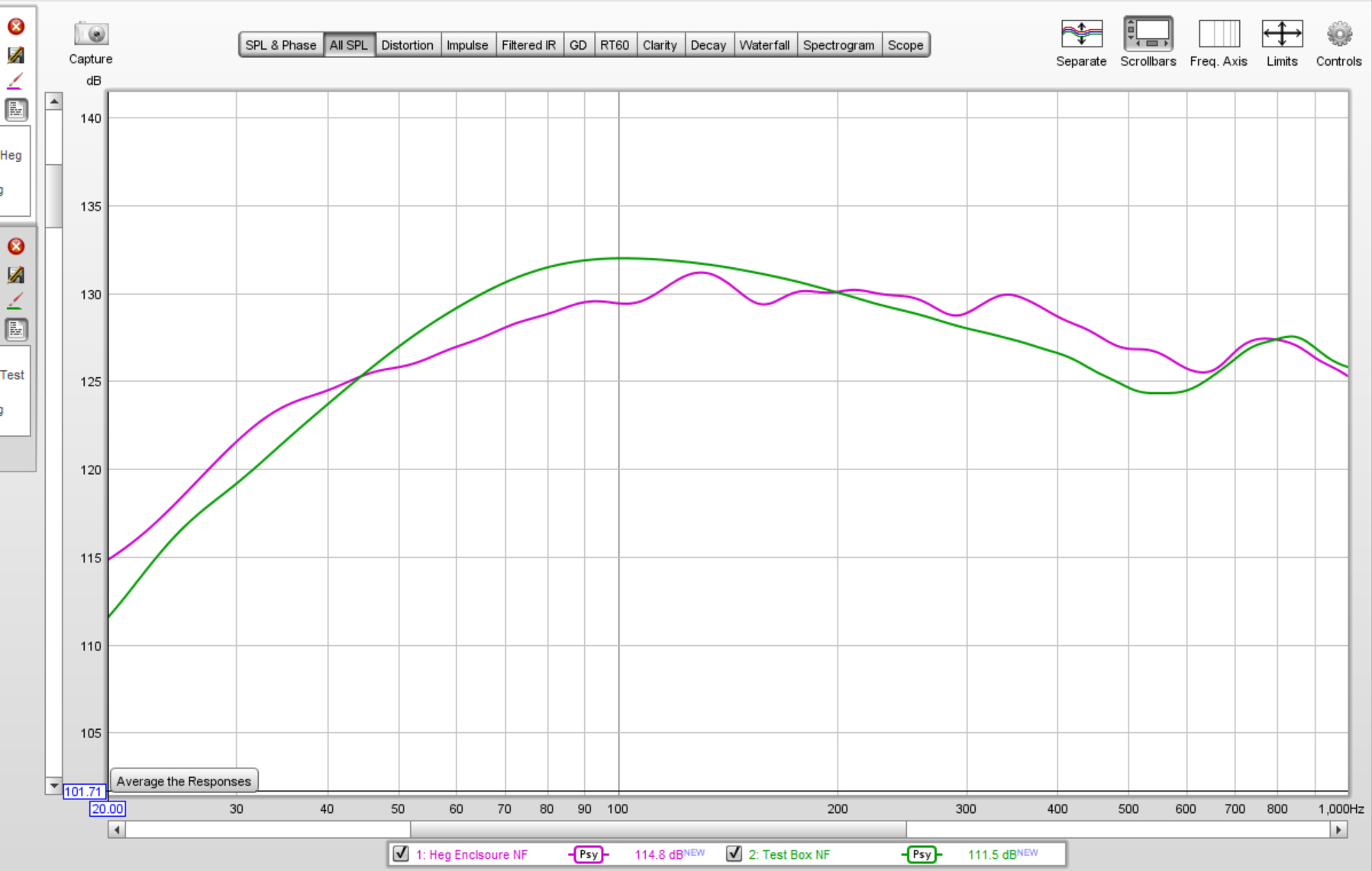

Dave, here's what I posted:
I own a pair of Hegeman Model 1 speakers (the inspiration for the Cornelius Morton article in AudioXpress).
I've read a bit of skepticism toward the Hegeman concept, namely: that an enclosure of this type would result in the same bass extension as a sealed enclosure of the same volume, but at the expense of nulls corresponding to the tuning frequencies of the stubs and significantly increased design/build complexity/costs.
I decided to test the concept to see if it really does provide lower bass response than an enclosure of the same volume.
I built an 18.1L enclosure (the same effective volume as Hegeman's enclosure) and tested an H1 woofer in it and in Hegeman's enclosure.
I'm aware that measuring bass is a crap-shoot, so I made sure to keep everything but the enclosure exactly the same, that way the only variable would be the enclosure. The results are attached:
- Impedance sweeps
- NF FR response of both enclosures with 1/48 smoothing
- NF FR response of both enclosures with psycho-acoustic smoothing
Magenta = Hegeman Enclosure
