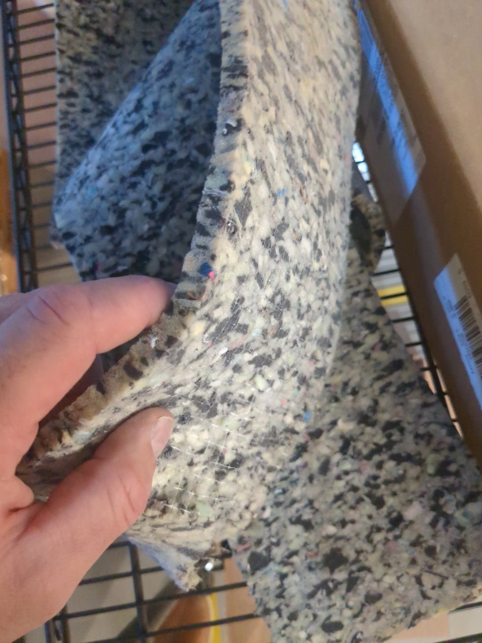

These are the mid woofer enclosures I was talking about in my other thread. They mount to the inside of the front baffle behind the mid.
You think I should stuff this with some wadding or just leave them the way they are?

By foam, I intend to convey open cell poly foam, like egg crate mattress material. What you are used was likely far superior, like a multi-layer product with a mass layer.
By residential insulation, I mean the “pink panther” bags of fibreglass, or the yellow type, both used as a thermal barrier.
I’ll look for the chart, but here are a few noise absorption product and material comparisons.

People often try to save money on damping material and get (1) cheap mattress toppers from Walmart or Amazon (open cell foam) (2) Polyfil from Joanne's or cheap pillows, (3) pink fiberglass insulation...
If you want you splurge on quality R11 or R13 felt (3/8 to 1/2 or more inch thick) from McMaster-Carr and Merino wool (Merino wool roving or batting?) from Amazon and probably other places that I'm not aware of.
So this is what I currently use. It is open cell and surprisingly heavy. It is underlayment for floors. I haven't tested it against anything but I feel like it works quite well. If you stick it to a board and rap your knuckle on said board it will ring out at a lower frequency.
I have yet to read the first argument in favor of a bigger enclosure. Seems that people like ringing mid frequencies.Seems like there isn't an agreed consensus on the subject.
Use proper acoustical wadding from specialist suppliers. And no, the stuff you have probably isn’t a good absorption material. Look it up, there are resources on that everywhere. Like here
