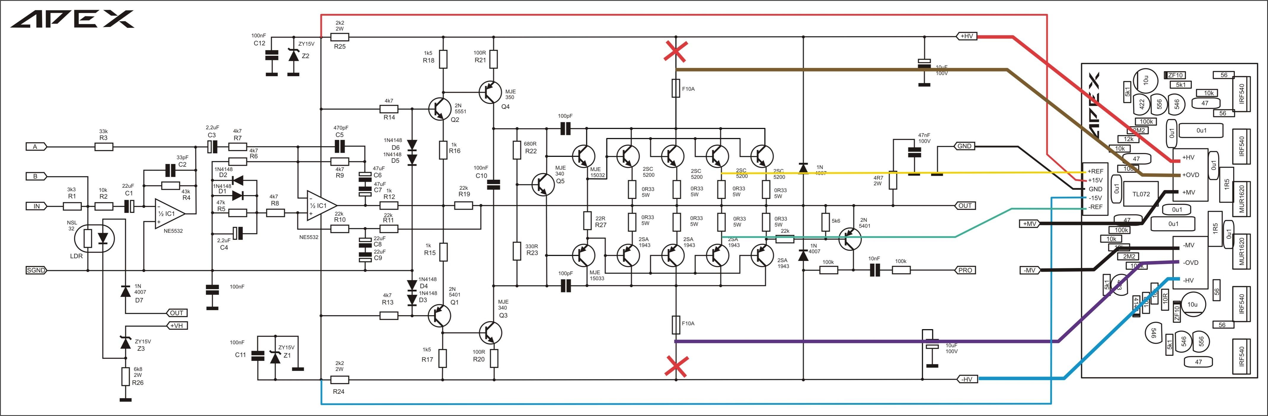

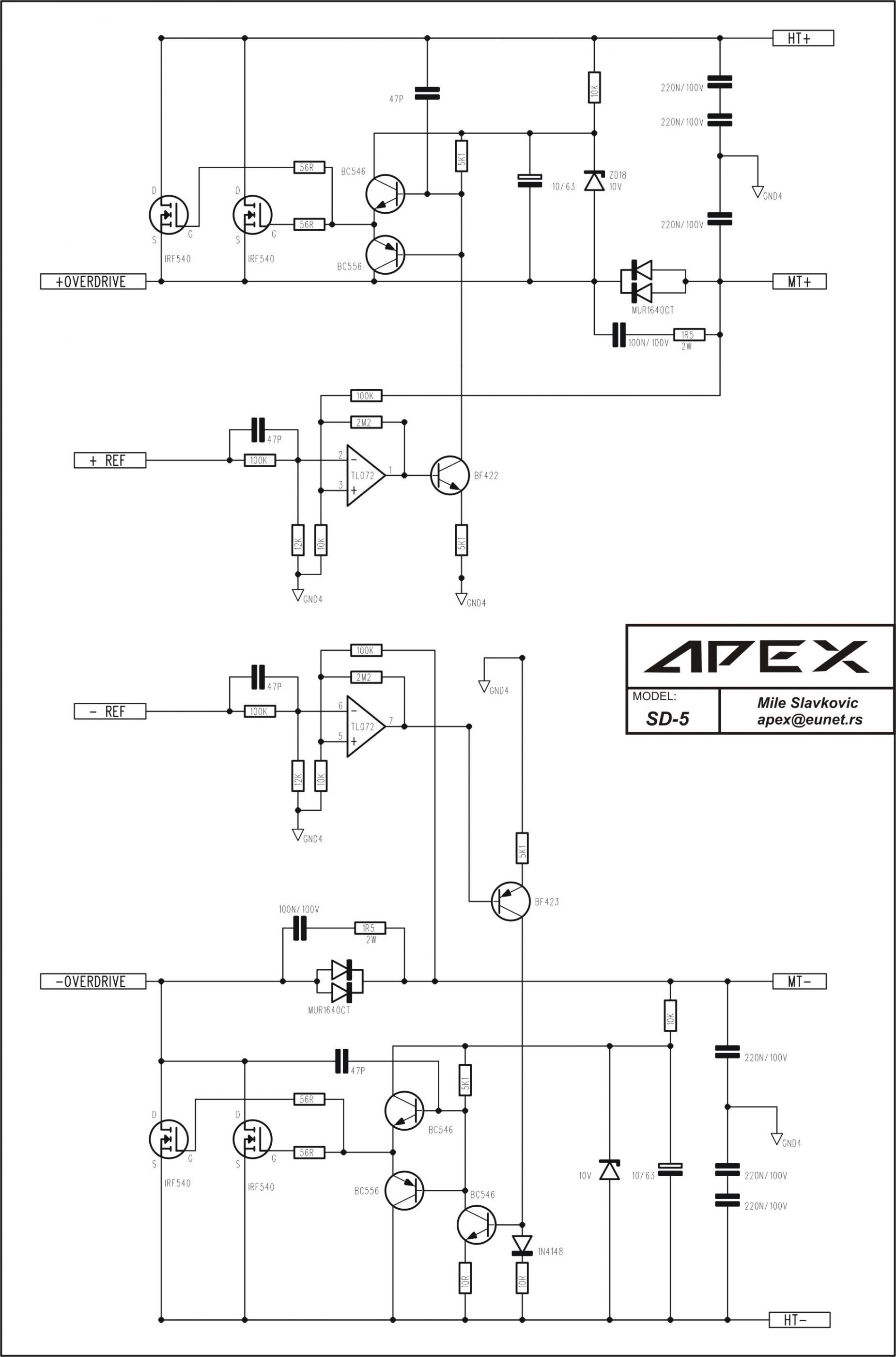

apex,
this is from thread h900 post #411
b500 using tlo72 step driver
from apex,
From PSU goes HV and MV. HV goes together on step and to amp for supply VAS. OVD goes to output stage, which is disconeted from HV. MV goes only to step driver.
please check my interpretation if correct
please see attachment
regards

That's correct, and dont forget +/-15V from zeners to suply TL072 in step driver, and +/-REF from output emiters,
