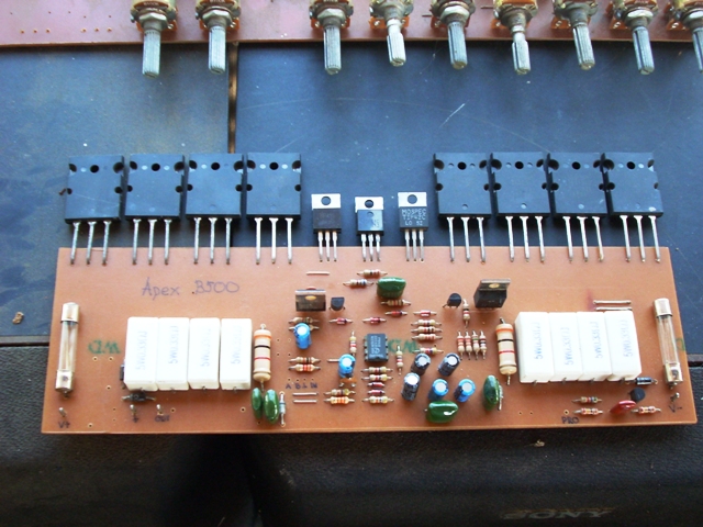

What did you use instead MJE, would you post some pictures?
Regards
oh sorry, thought i have it uploaded,im just new in posting
and im on and off on the internet since i aint got any means of connection at home...

For H900 you must use MJEs,hi apex can i use two driver transistors in parallel? coz im thinking of upgrading my b500 to h900. since the only transistor with about higher operating voltage available here i guess is 2SA1011 and 2SC2344....
Regards

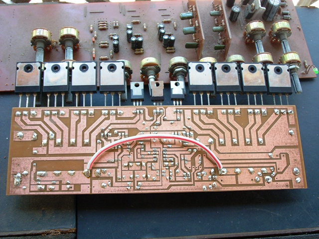

I like your pcb, profy look.okay...thanks i'll try if i could find mje's...anyway heres my apex b500 pics.hope i did post it correctly this time coz i had trouble posting it.![]()
No, but 2SC4793/2SA1837 can replace MJE340/MJE350apex,
what can you say about b649 and d669 can this replace mje340/350?
Only when rail voltage is less than +/-110VDC

mje's are nowhere to be found in our city... thats why i settled on using TIP's
but still thinking of H900....
hope Engel de la Pena would tell me where to find MJE's..
i'm located at Iloilo City, an hour of plane flight to Manila
