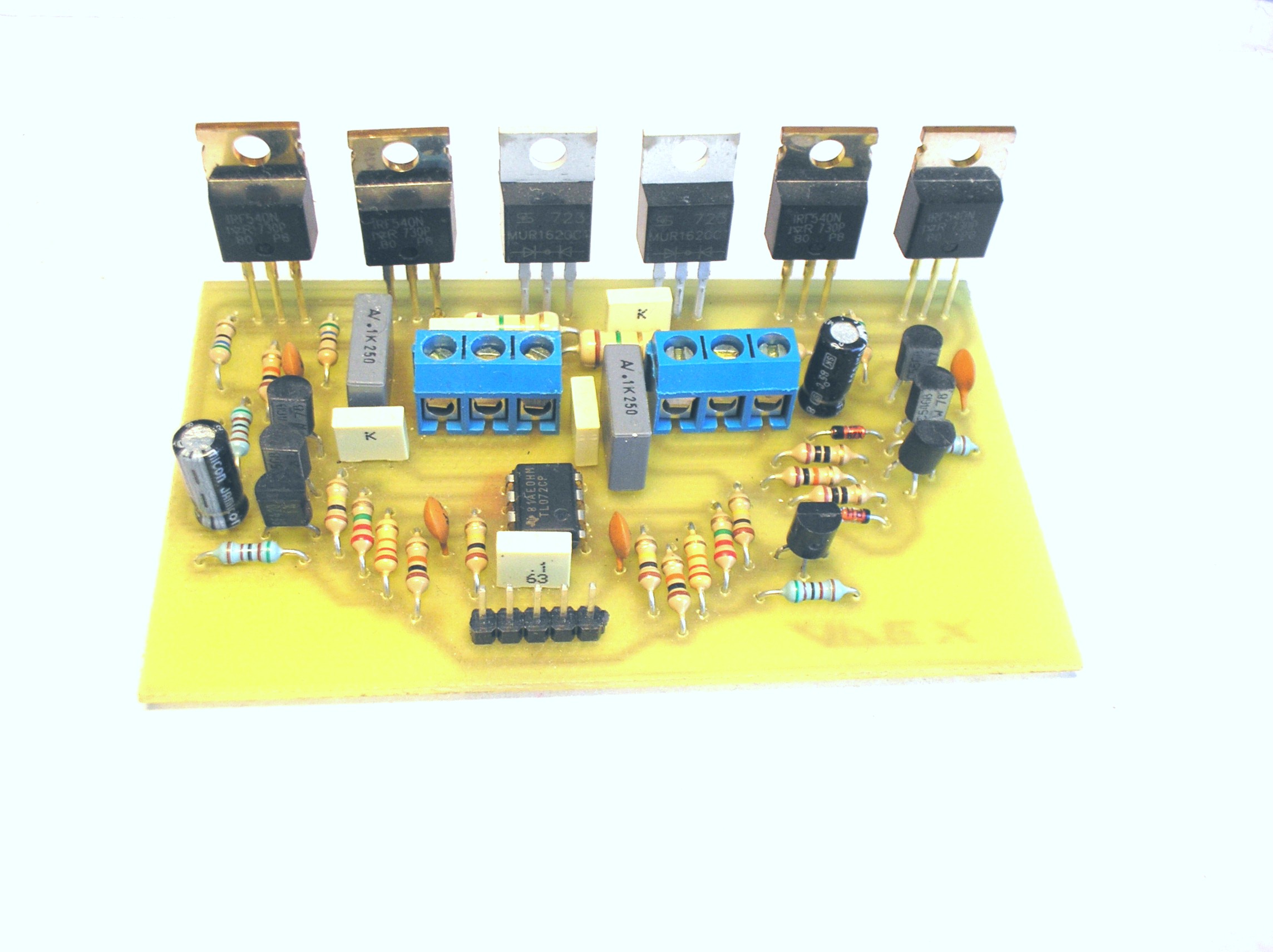

Yes, U can use this pcb without diode bridge for MV.yes +/-15 & ref not forgotten
hope this is fine
Regards
0u1 grey color must be 250V,tlo72 step
apex,
this Ou1 grey color .1uf? what voltage? 100v mylar is this ok?
the Ou1 white?what voltage?
and does this 47 in pf?ceramic
0u1 white color 63V,
47pF ceramic,
Regards

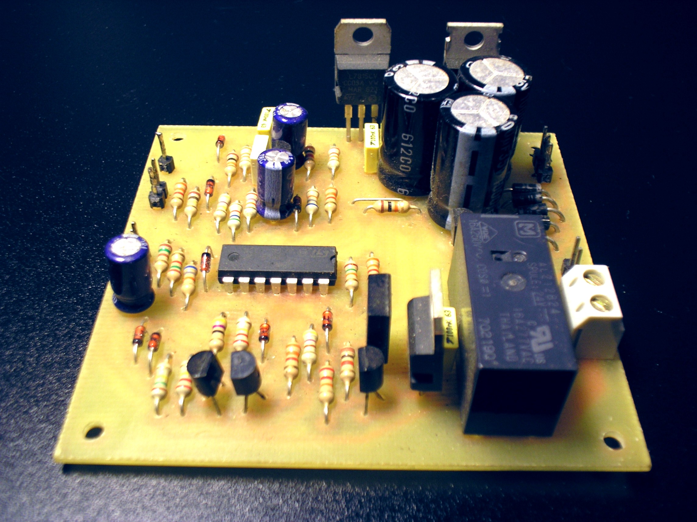

.......Soft-start
Hi..Apex...two question:
1. For soft-start supply 30VDC..are used separate transformator or from extra CT (20vac) main transformer??
2. For protector H900 (with TL 074) are used separate transformer too??
Sorry it's elementary question....

Protection pcb use 2x18v 1A ac from main transformer or smal separate transformer, and from protection board you can use +/-15v without gnd for soft-start.Hi..Apex...two question:

Thanks Apex...I understood now...

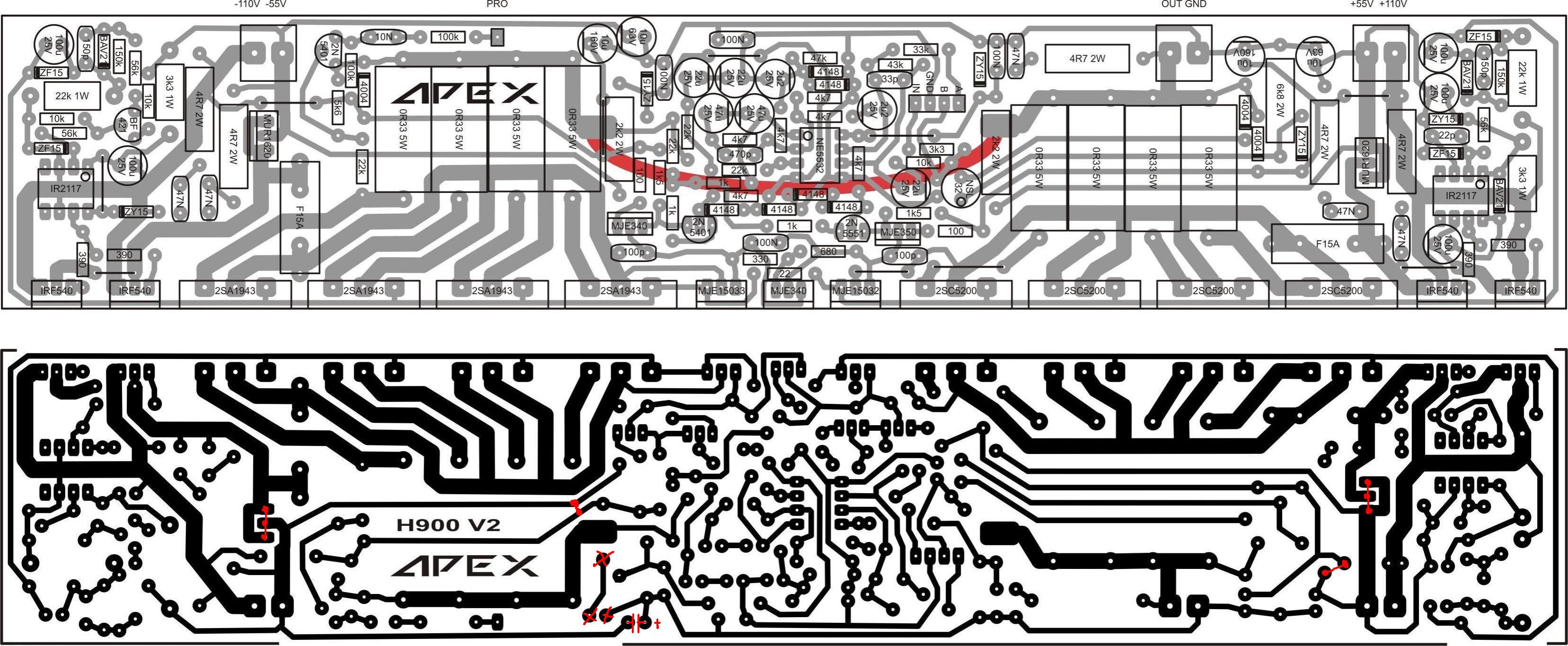

I wonder if this amp can be used in a truly professional system, I hope to use it for the middle way (between 100Hz and 2kHz)
He really can handle the heavy lifting? And sound? the good is that it already has limiter, so it's a big step, and as other protections? (Like DC and short?)
See posts #241 and #111,I wonder if this amp can be used in a truly professional system, I hope to use it for the middle way (between 100Hz and 2kHz)
PA Protect include:
1 Anticlick 5sec delay
2 DC cut-out
3 Thermal cut-out on 90deg
4 Fan high speed on 60deg
5 Over current protect (power-on reset)
Conectors:
1 2x18V 500mA AC
2 +/-15V DC stab for XLR circuit
3 PRO overcurrent detect
4 Protect LED
5 Thermal sensor BD241C as diode on heatsink
6 24V DC Fan cooler (12V for low speed)
7 Speaker IN/OUT

1200VA for both channels is ok,Thank you, I will build it with a transformer of 1200VA (for both channels) is good, ok?
One more thing, trasistores 2n5401 2N5551 can be substituted for some BC's more common, for example, BC556 ...
2N5401/2N5551 can be substituited with MPSA92/MPSA42,
Regards
All answers is in my threads. Better read if you want to build.ok, MPSA is easy to find
I will have no loss in quality is not it?
two other questions:
the limiter, LDR is a normal and a normal LED, some particular color?
500W at 4R?
You will have not loss in quality with MPSAs.
