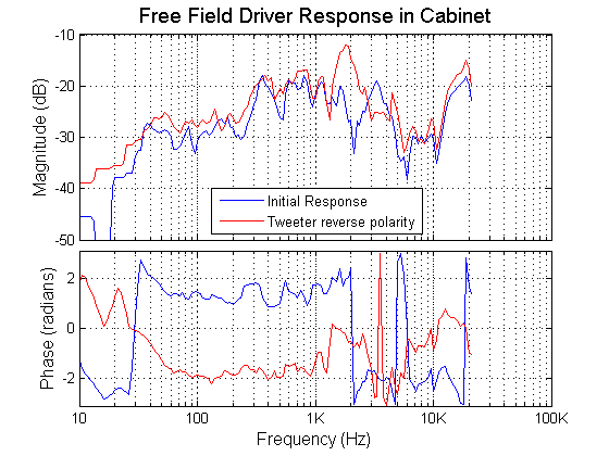

Here's the plots of the Silver Iris OB's before and after we flipped tweeter polarity. These aren't very good data sets seeing as we had major floor bounce and other reflections but if you squint in bad light I'd say you'd get some idea of reality.
It's not so much the discontinuity in the blue phase trace at 2KHz that concerns me (that's just a normal phase wrap as phase hits +pi) It's the phase shift between 5.5 ad 6.5KHz that seems wrong.
After we swapped the tweeters they did sound smoother, better integrated; made you want to listen to them forever.
Perhaps the owner (was it Dave or Bob?) can tell us what the XO frequency is. If it's 6KHz then I would say that we did the right thing reversing the tweeter. If it's something else - well, maybe we should re-evaluate the decision.
Any thoughts?
