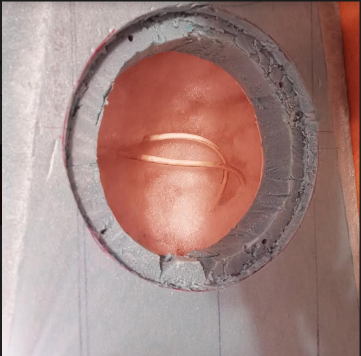

Vineeth, midrange driver is sensitive to baffle cutout contour on the inside. Straight cutout is prone to standing waves. Chamfering is highly recommended!

Thanks Juhazi for pointing Troels's article to me earlier. I will definitely have a generous chamfering on the inside contour regardless of the mid driver that I will use. The other interesting thing I noted regarding this is that in the satori drivers, the backside is tapering in dimensions and magnets slowly get out of the way of airflow to the back wheres in the regular CAC kind of drivers, this tapering is much less. Maybe this aspect may have got something to do with its suitability in deep baffles. Just thinking aloud.. 🙂

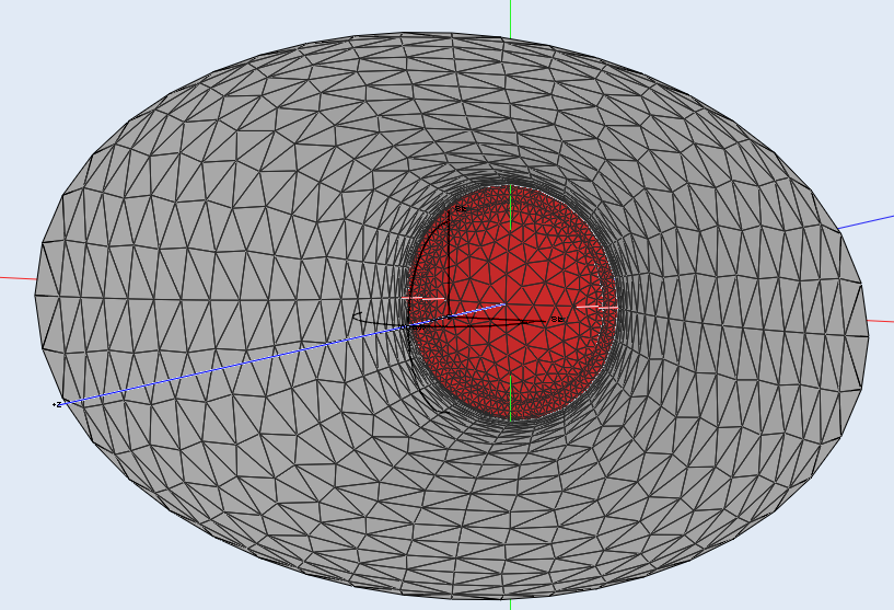

Thanks to augerpro I am off to a good start. I was able to reduce the mesh size quite considerably and still come up with the same answer which will make simulating the whole thing much more feasible. Solve time dropped from 36 minutes to 1:45 🙂

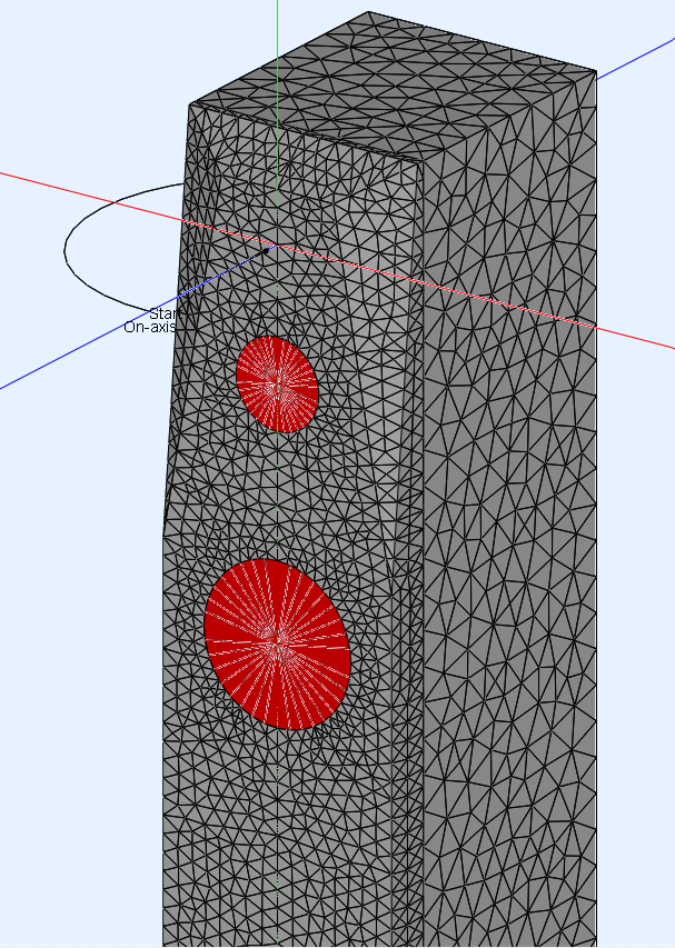

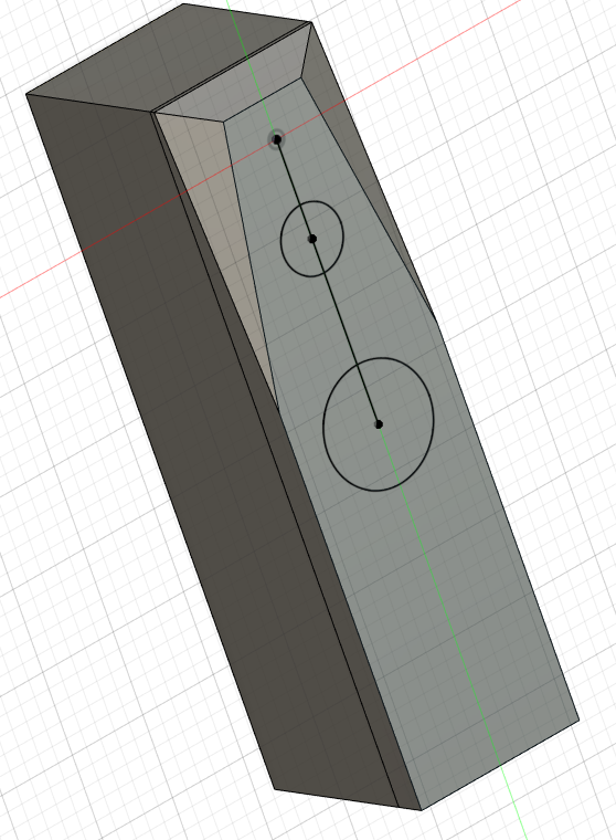

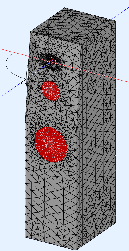

Simulated results will take a bit longer here is the next step in the journey

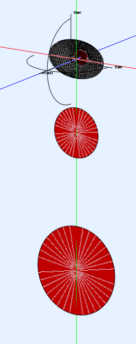

Driving elements, for now flat discs that represent the Sd of the drivers centred where the real drivers would be on the baffle
attachment.php
Simplified CAD model of the baffle and cabinet
attachment.php
I have to troubleshoot an issue that has occurred when placing the waveguide in a baffle so that part has stalled for now.

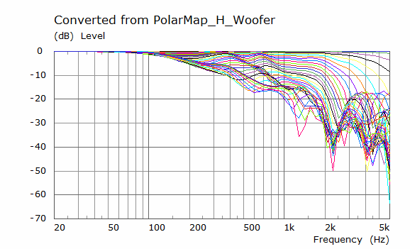

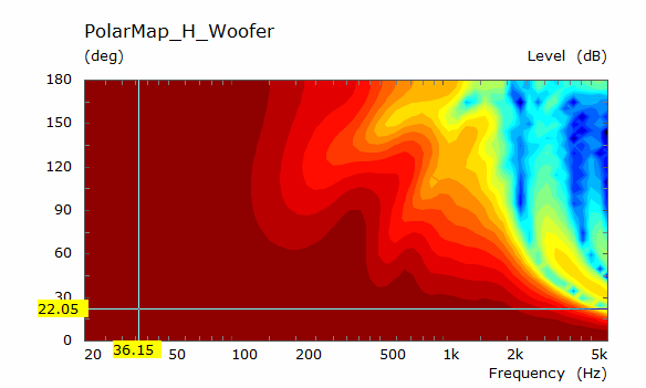

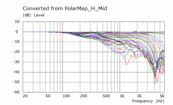

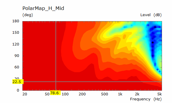

Here are some preliminary horizontal directivity responses for the mid and woofer when simulated as flat discs of corresponding Sd and driven with constant acceleration. Measurement point is at the tweeter axis.
As theses are simulated 0 to 180 degrees some of the far off axis responses dominate the view of the polar plot. The peaks that pop out show some areas of concern for the 200 to 500Hz range in the woofer. If these were gone the directivity would be more even.
The mid looks good if it's crossed over high enough.

Thanks Fluid. How do we try to understand what is happening in this scenario.
For example if the simulation is happening in free space, all drivers trying to radiate into 4pi space, how do we explain specifically about the first peak off-axis which occurs around 350Hz (approx. 1m wavelength) and a secondary peak with lower amplitude happening about 700 Hz (approx. 50 cm wavelength).
The only dimensions of the cabinet I can think of (in a horizontal plane) that relates to these kind of wavelengths is cabinet depth(side-1: 35.5cm) + baffle width (back: 28cm) + cabinet depth (side-2: 35.5cm), the total of which comes close to 1m.
Is it possible that an approx. 1m long wave, which comes back after traveling around the cabinet (side-1 + back + side-2) and constructively interferes with waves of same frequencies emitted by the driver itself and causes that first peak around 350Hz?
(The relative phase shifts of the waves around this wavelength causing the interference magnitude to decrease around the peak)
Similarly a wave of twice the frequency (the 50cm long one) does the same thing and causes the peak around 700Hz but diminished in amplitude due to the relatively less energy coming back after wrapping around the cabinet?
I dont know if the above explanation makes sense. I was just trying to come up with some reason for above behavior in this simplified setup. 🙂

That is a good question 🙂 I will create some observation fields so that you can see the wavefront movement around those frequencies which should make the reason clearer.
This is a free space simulation. There will be a transition from 2pi based on the baffle width to fully 4pi where the width and depth interact in the transition.
The measurement point being at the tweeter level also has a vertical component as both mid and woofer are below and you can see the black arc in the mesh drawing that shows the direction of the measurement arc.
So whilst it is horizontal directivity it is not centred around each driver, which would look better, but not necessarily be an accurate representation of how the speaker would be heard.
All of the peaks and dips come from specific distances or combinations of them much like you tried to hypothesize. Working out which ones is not always easy and it won't just be horizontal. The fields should help.

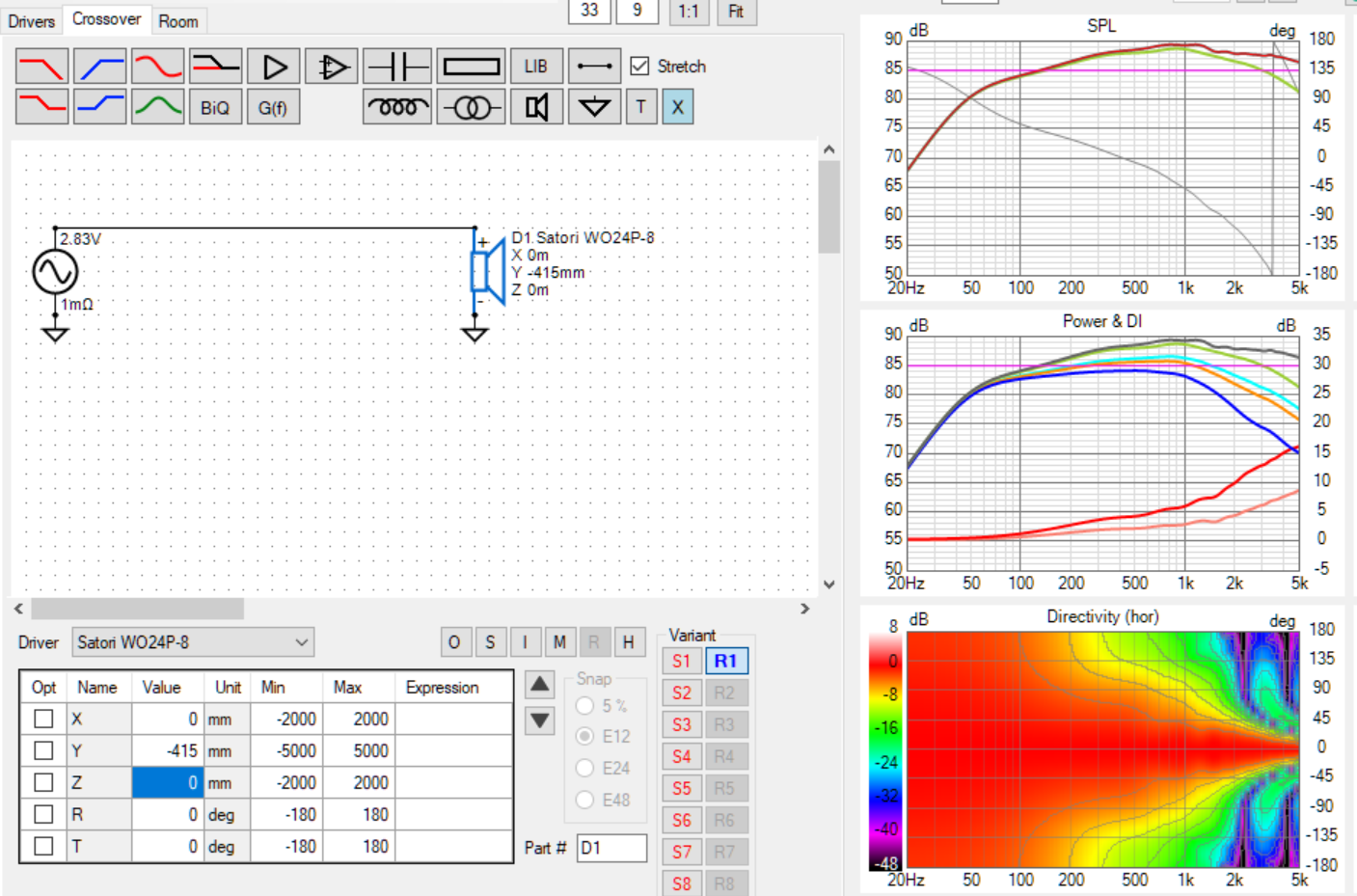

I tried to study a little more about this. I tried to see if I can see similar behavior in VituixCAD by using the diffraction tool to generate the frequency responses to off-axis angles as shown in attached pic -1 with the woofer radiation viewed from tweeter axis 3m away. But I saw only smooth variations in directivity (Maybe because the VituixCAD modeling doesnt take into account the effects of cabinet width and depth?)

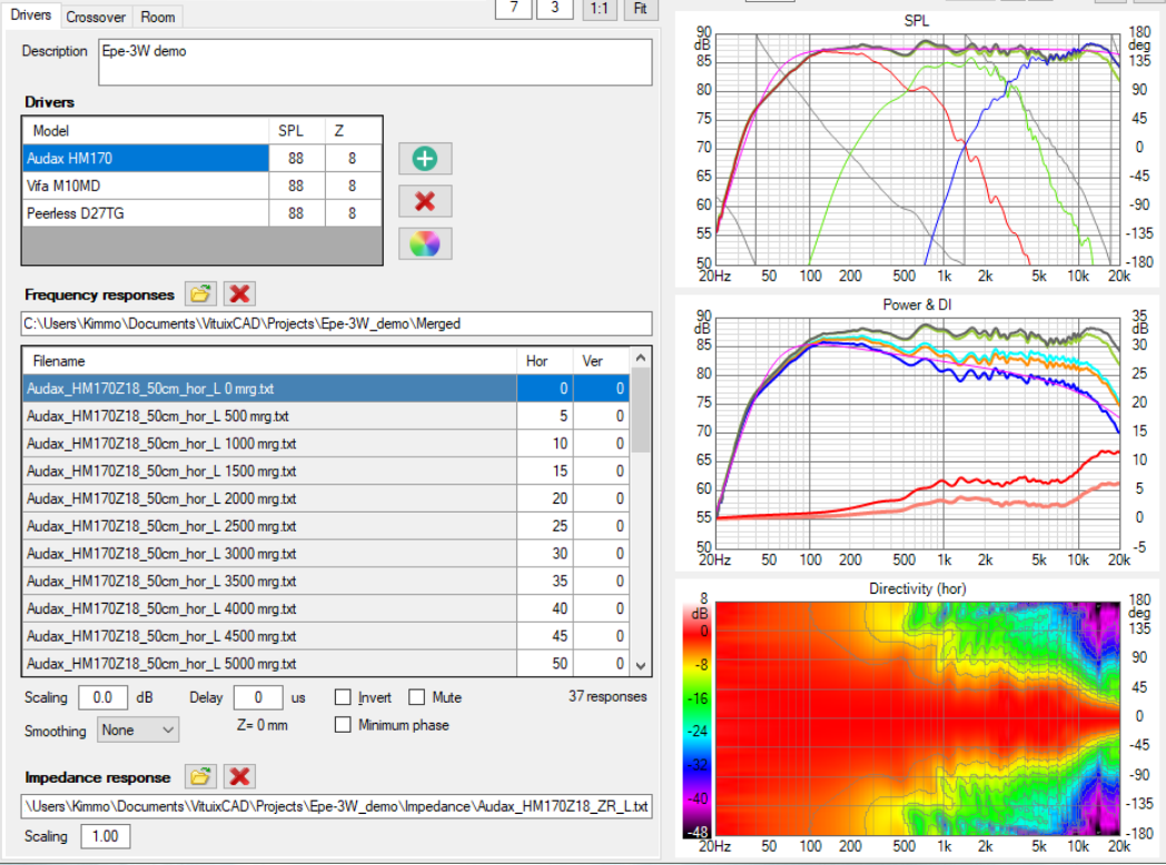

Next I looked at the 3 way example project given in VituiCAD website: VituixCAD Loudspeaker simulator
I have attached it in pic-2, I think I can see in the real measurements of the woofer response that is given in it, the kind of phenomenon that we are seeing here (peaks around 300-500Hz and 700-1000Hz). 🙂
So what is happening seems like the interaction of the depth and width of the cabinet during the baffle diffraction step transition for the woofer and similarly for the mid driver as you and others have been pointing out.
If this is the case, is there a specific combination/ratio of dimensions that will help us see smoother directivity transition at these lower frequencies (wider baffle + less deep cabinet?). Or we have to live with this kind of response if I retain the cabinet dimensions as I have currently. The other question I have is, audibly, what could be kind of impact
of this kind of peaks in the response since it looks like the kind of frequencies below which the room takes over. Also I have heard people saying that the 200-400 Hz frequencies are very important perceivably in setting audible levels for the rest of the spectrum etc. I don't know much about any of these yet. 🙂
